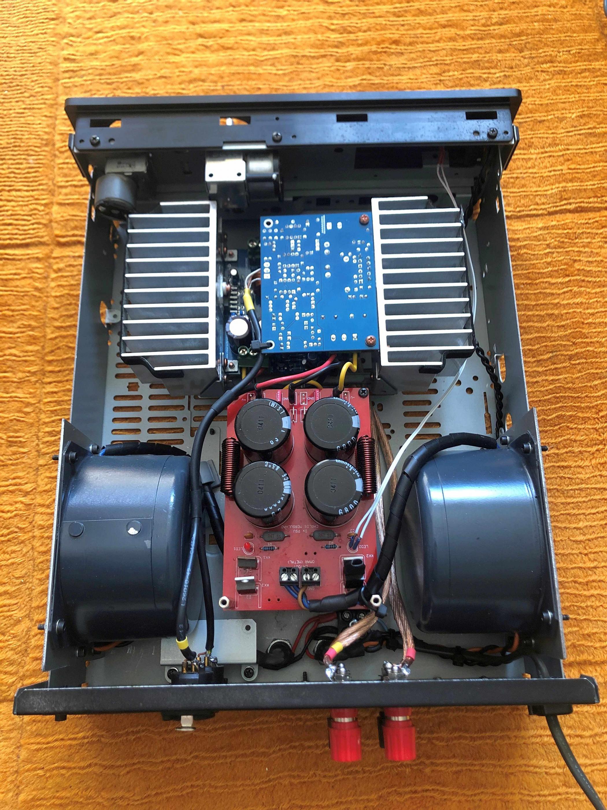

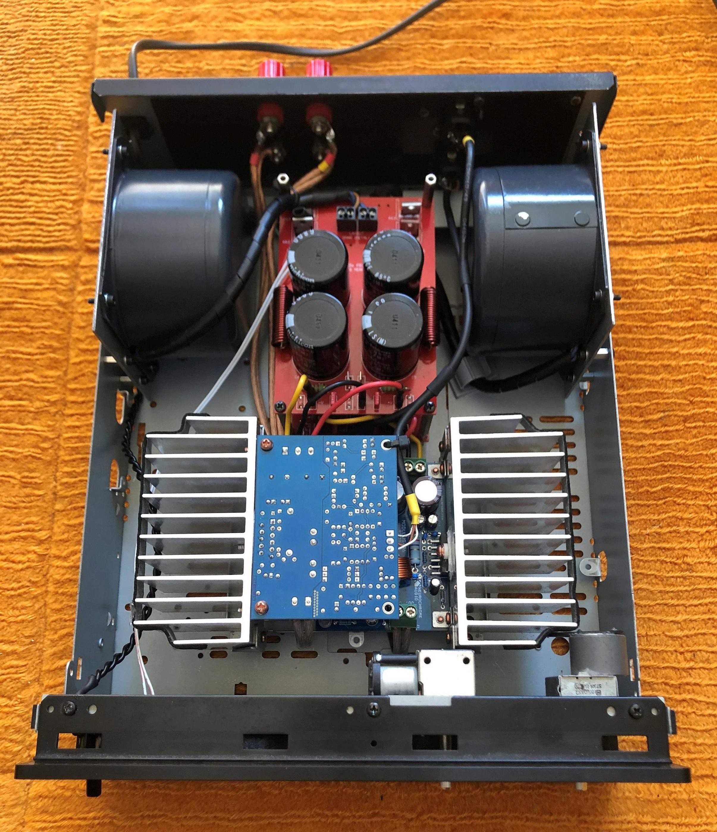

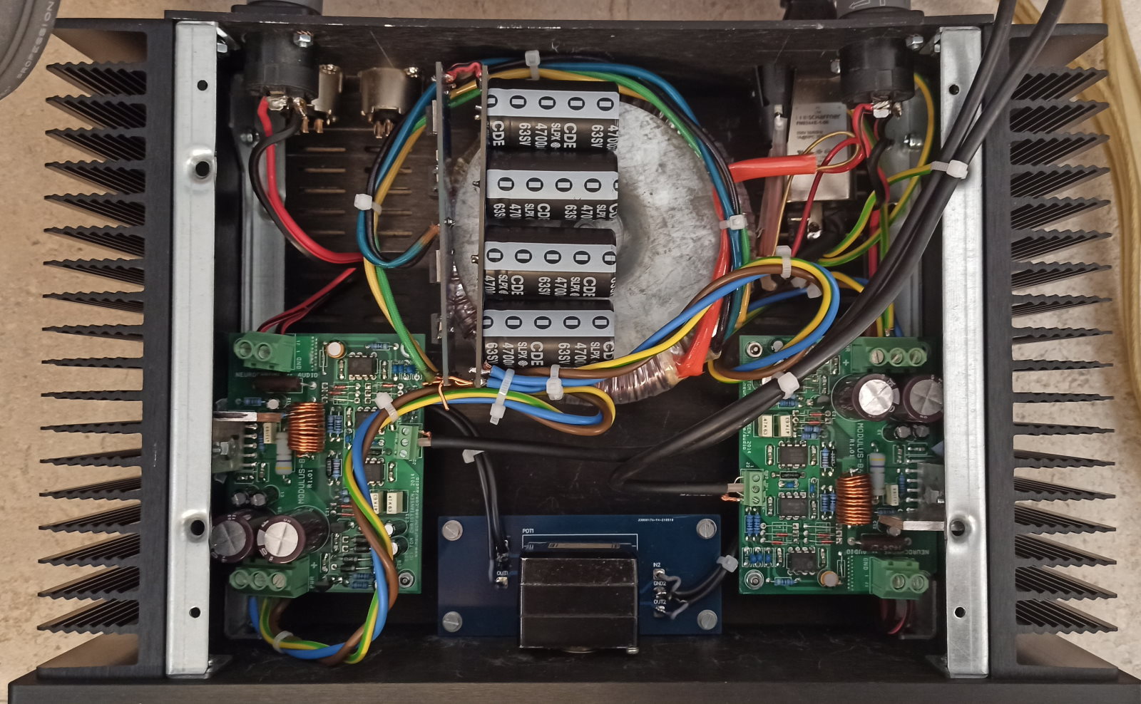

I just finished my dual mono Modulus-86. The casing and heatsinks are the leftovers of a dead Yamaha AX-10 integrated amplifier, 28 cm in width. The transformers are 160 VA CT, fully potted and shielded. The PSUs you may know from here. The volume pot and source switch are left just to hold the knobs.

Now as before I am still amazed of the Modulus' sound. I built and bought so many amplifiers and spent a fortune for those over my decades of audio addiction, but never before I was that satisfied. The spatiality is superb and actually in some pieces of music I discovered some previously unknown details. Somehow the Modulus-86 has more control over the speakers than other amplifiers. Thank you, Tomchr! :up::up::up:

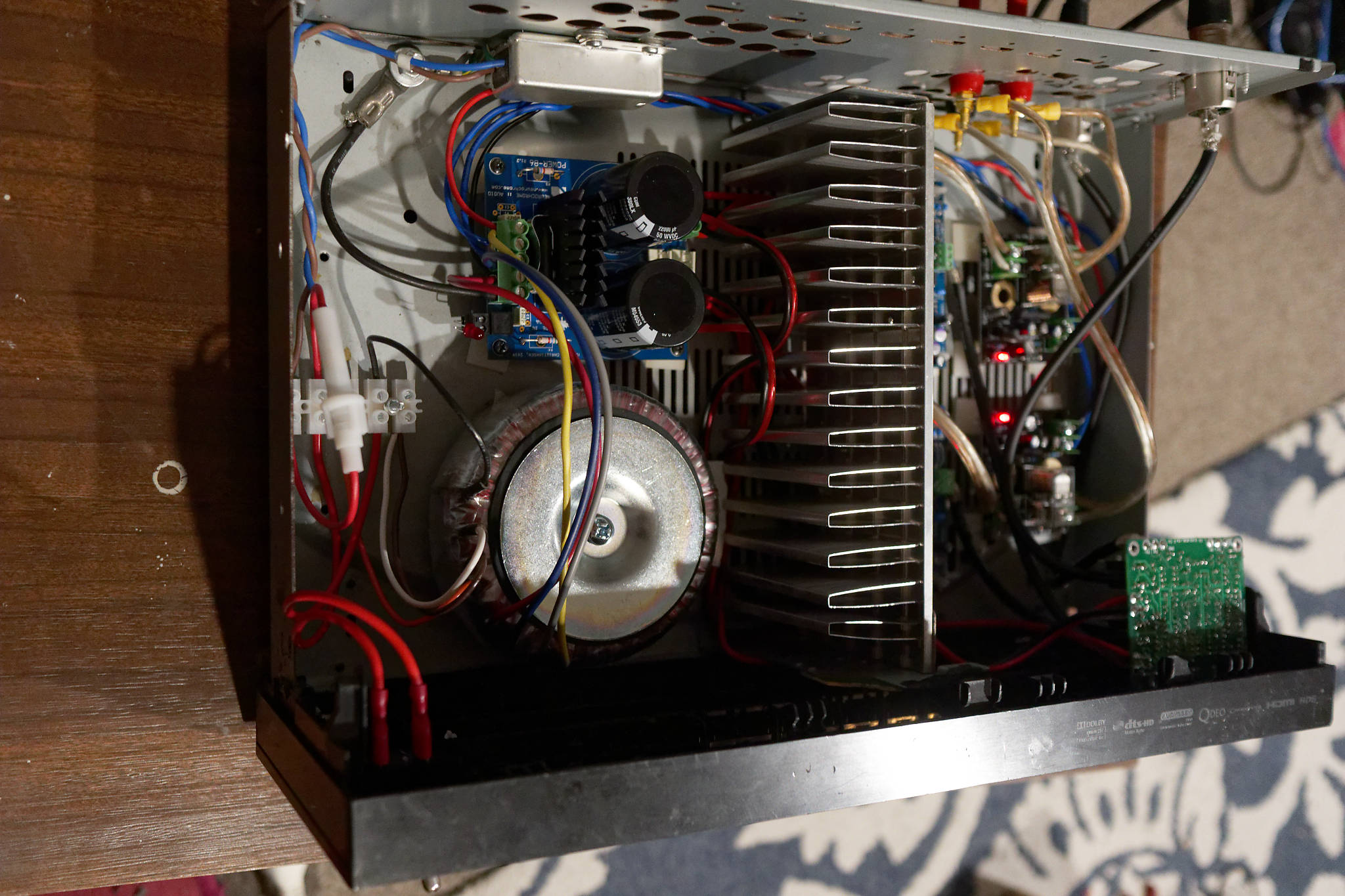

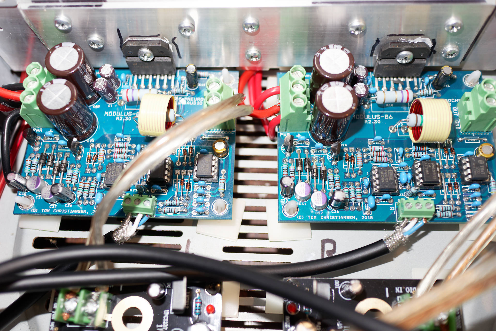

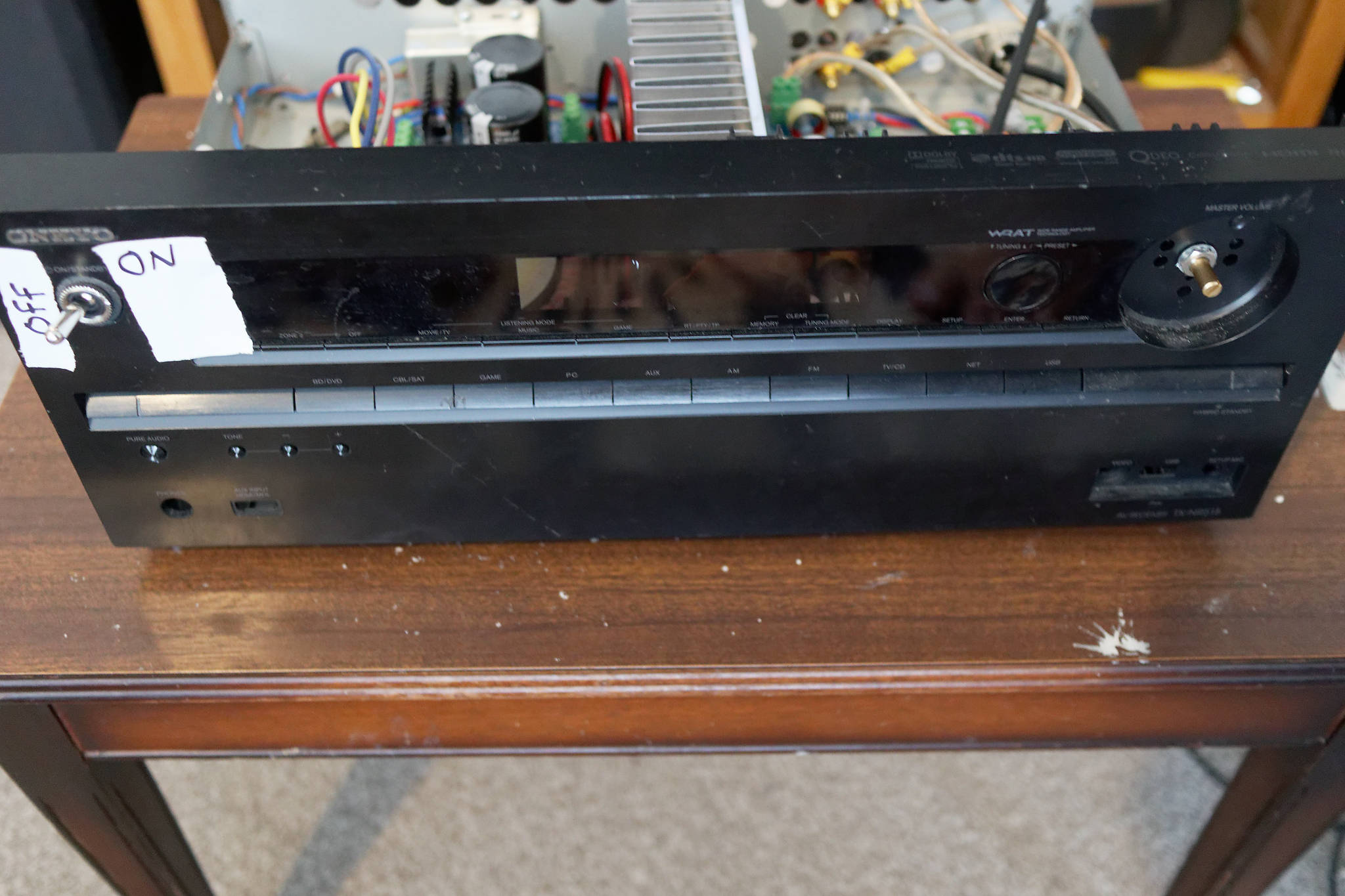

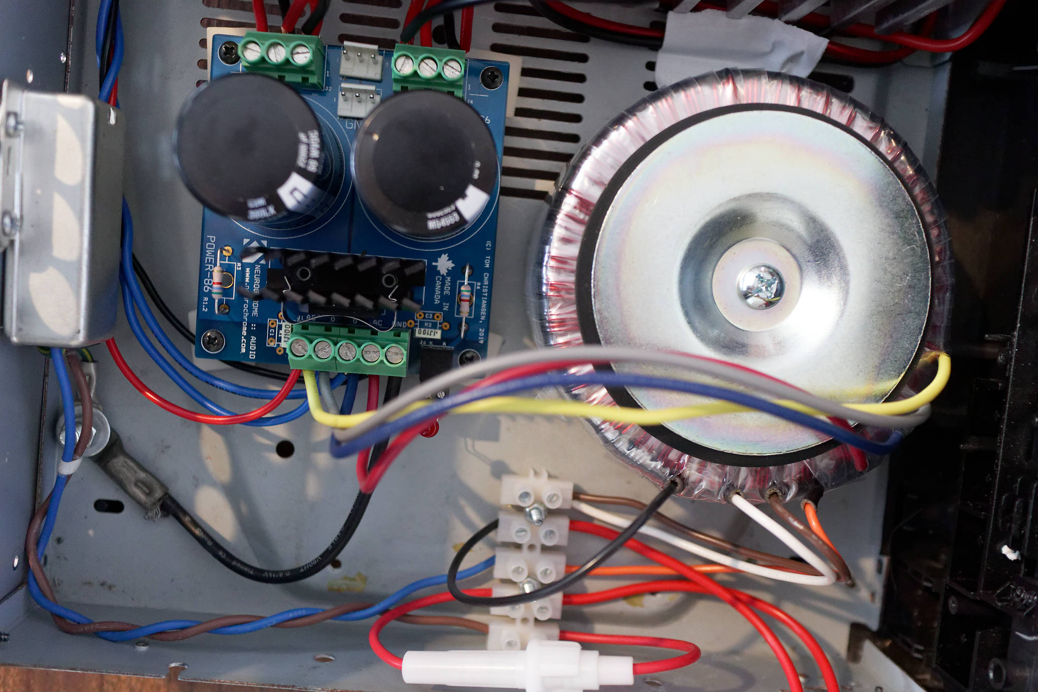

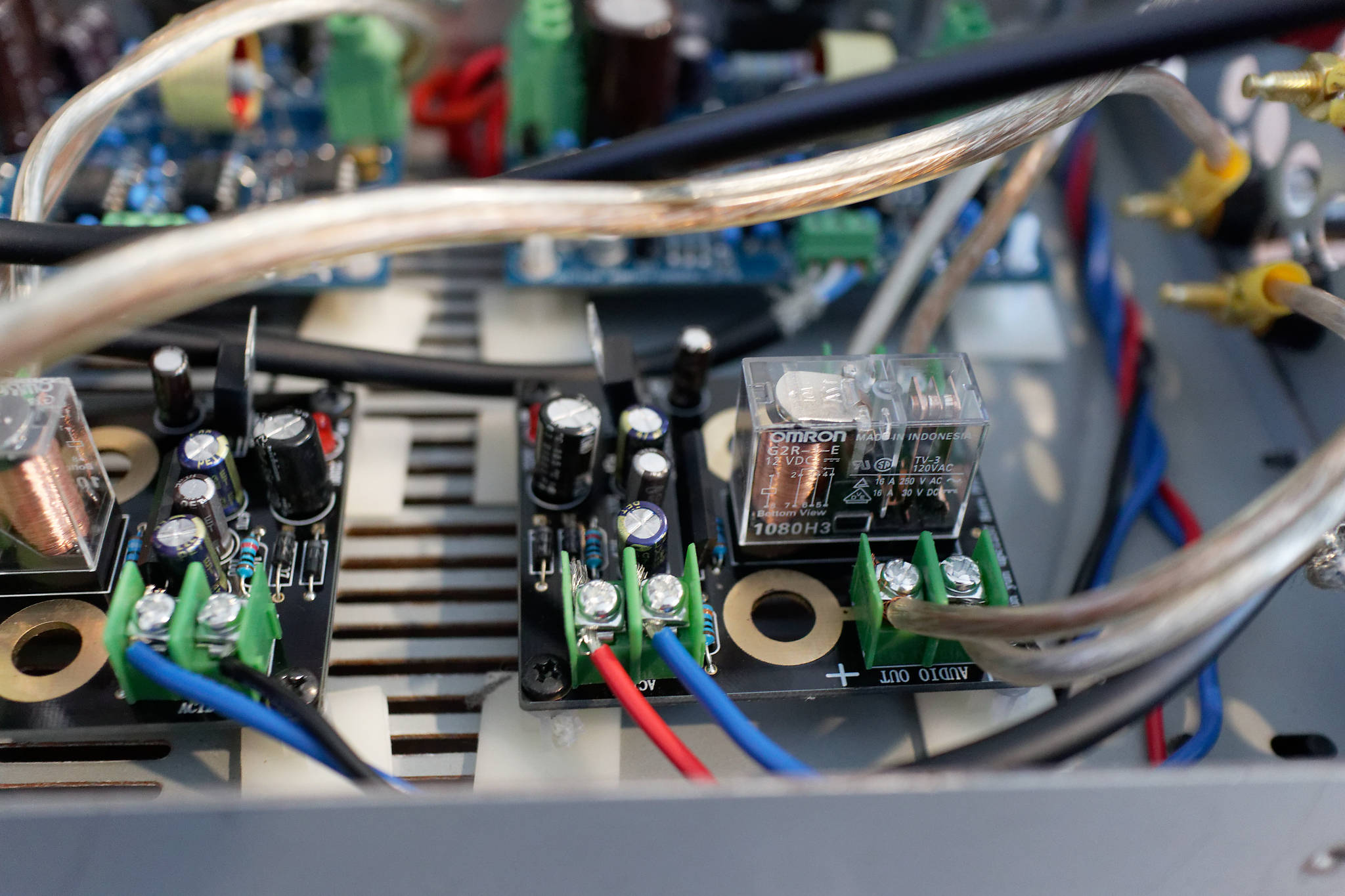

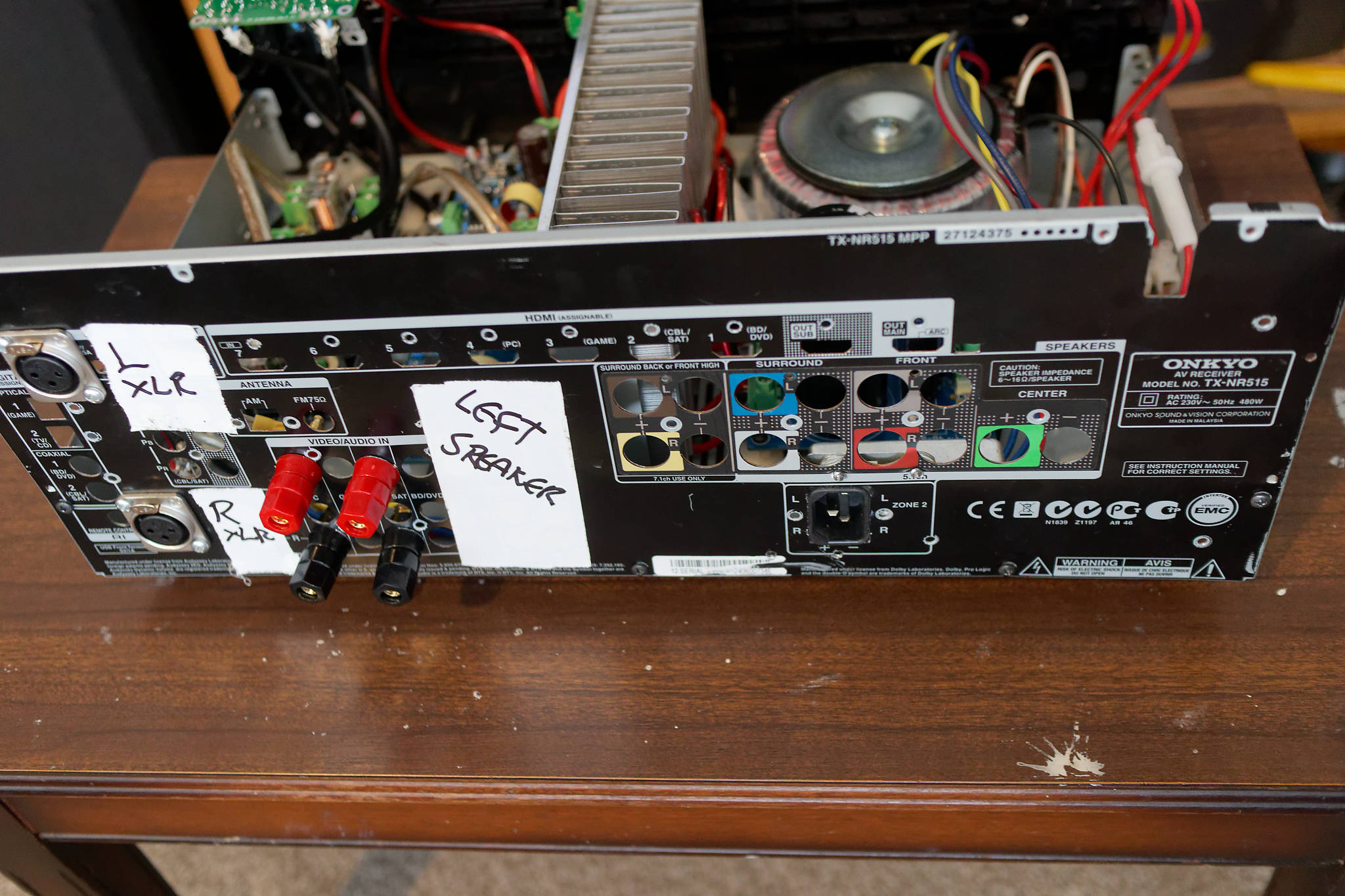

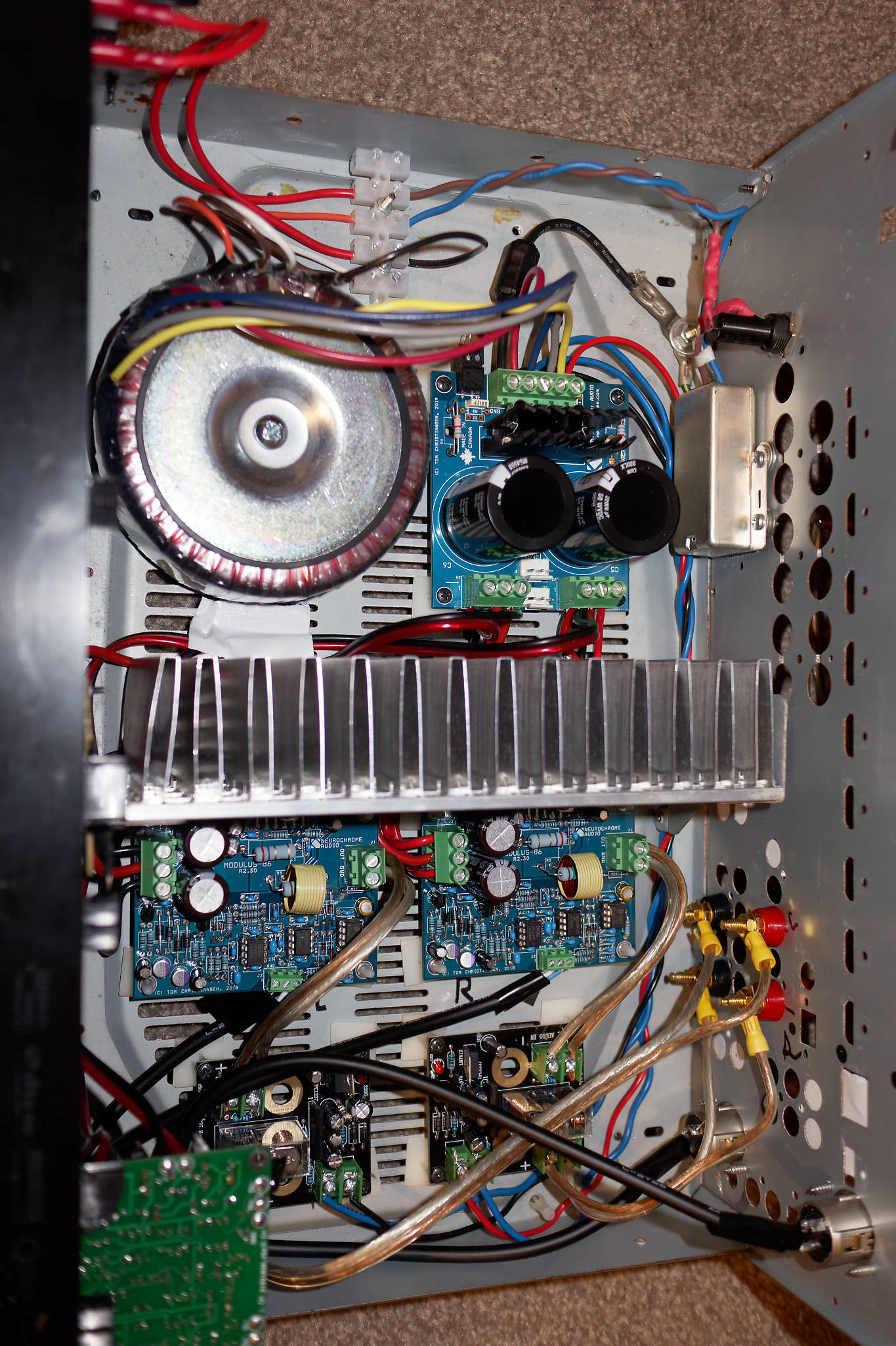

Hello all.
I have just finished a build with these amps, I'm really impressed. Clean and plenty of power. Awesome sound and sound stage. Best kitset amp I've ever built, and I've made maybe a dozen over the years.
I repurposed an old Onkyo amp for the case, had to shorten and reseat the heatsink and bore out new holes etc.
I used a 225VA Hammond xformer so this should never run out of oomph.
I used the balanced volume control that Alexcp made (Anyone tried that vs Tom's one?)
I used to work in Pro audio, I saw plenty of amps like this, sleepers that were shoehorned into any old case and sounded amazing. I've always meant to put one together.
Worked first time, perfectly.
Love this thing, and love your work, Tom. Building a composite amp like this (well, making it stable) sounds pretty daunting to me.

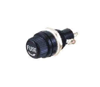

Hi MrCray,
Good use of the old chassis. But I have to agree with livistubby, that low voltage fuse holder give me the willies! I'm use to 120 VAC and you're at 240 VAC aren't you?
Please, use a chassis mount fuse rated for your mains voltage. At least you did use a fuse.
-Chris
I’m a big fan of IEC AC connections as well. Note that if there is a future rebuild of this, or other projects, there are IEC input blocks that incorporate switches and or fuses in one fairly tidy module.
Tom, should I be concerned that the Modulus 286 kit didn’t include an external fuse, or is there a reasonably accessible one in the Connex SMPS?
