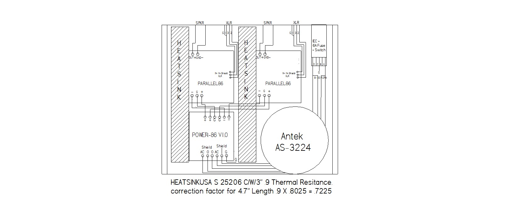

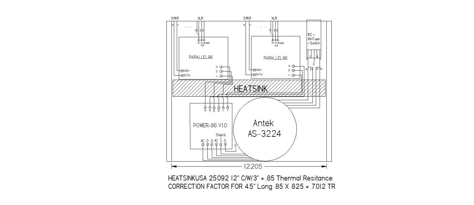

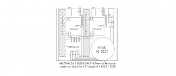

Parallel 86 build question
Hi Tom,
I hope you are well. I haven’t posted in a long time…just been enjoying my Modulus 86 for the last five years. I’m posting because I’m finally ready to build the Parallel 86 I bought from you in 2017 and would appreciate your thoughts and recommendations on my attached designs.
Specifically, one design has two chips on one heatsink with a 0.7012 thermal resistance. The other has each chip on its own heatsink, each with a 0.7225 thermal resistance. Is the two heatsink design overkill?
Thanks,
henrylrjr
TL;DR: I like the layout with the single heat sink, but the single heat sink might not be enough. Consider the 8.000" profile from HS USA or adding a thermal cutoff switch.

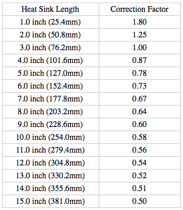

Note that in addition to the length correction factor, you'll need to apply a temperature correction factor (see attached). Heat sinks are commonly specified for 70 ºC temperature rise, which would make the heat sink close to 100 ºC at room temperature. That's way too hot. I generally recommend staying at 60-65 ºC or below so you don't get burns if you touch your amp after a 'spirited' listening session. The 65 ºC comes from a standard for external temperature of kitchen appliances. Controls (knobs) are allowed to reach 55 ºC and external surfaces 65 ºC. I find it reasonable to apply the same standard to amps.
So you're probably looking at either the 1.170 or 1.257 correction factor. This brings you to 0.7012 * 1.257 = 0.88 K/W for the single heat sink or 0.91 K/W per heat sink for the dual heat sink layout.
The Parallel-86 (and Modulus-286) will dissipate 50.2 W when running on ±36 V with music played at near clipping levels with a 4 Ω load. If you want to keep the heat sink below 65 ºC with 25 ºC ambient you need a heat sink with a thermal resistance below (65-25)/50.2 = 0.80 ºC/W = 0.80 K/W.
So technically neither heat sink is sufficient. Technically... Here's where it gets fuzzy, i.e., where experience takes over because engineering got us stuck. 🙂

I’m a bit confused. The parallel 86 designdocumentation.pdf states “A good candidate for a suitable heat sink would be a 3” section of Heatsink USA 12.000“profile”. That heatsink has a C/W/3” .85 thermal resistance. Based on that it would seem any heatsink with a TR of .85 or lower would work.
So based on that it seems, applying the correction factor for 4.7” length to heatsinkusa 24300 and 25206, with a C/W/3” 0 .9 thermal resistance, should result in a more than sufficient thermal resistance of 0.7218. Why wouldn’t that meet “the good candidate requirement?
That documentation was last updated in January of 2016. I've learned a lot since then. One of the many things I've learned is the compensation factors for length and temperature. I have no plans to update the documentation as the Parallel-86 was discontinued 3-4 years ago when TI killed the LM4780.
Heat sinks are commonly specified for 70 ºC temperature rise. Heat sinks are more efficient when they're hotter than the ambient air (i.e., a hot heat sink will have a lower thermal resistance than a cold one when operated at the same ambient temperature). I recommend staying at a heat sink temperature of 65 ºC or below, so unless you keep your listening room at -5 ºC you will need to apply the temperature correction factor. I gave the relevant factors in Post #5505.
Assuming 25 ºC ambient and 65 ºC maximum heat sink temperature, you're looking at 65-25 = 40 ºC temperature rise, so you need to multiply the specified thermal resistance by 1.170 to get the thermal resistance at 40 ºC temperature rise.
So a 3" chunk of 12" profile from HeatSink USA (specified at 0.85 K/W @ 70 ºC temperature rise) has a thermal resistance of 0.85*1.170 = 0.99 K/W @ 40 ºC temperature rise.
Then compensate for the 4.5" length. 4.5" is not specified in the table. It looks like you took the average of the 4" and 5" numbers. That's probably close enough, so you need to multiply by (0.87+0.78)/2 = 0.825. That gets you to 0.99*0.825 = 0.82 K/W.
So the heat sink profile specified for 0.85 K/W @ Trise = 70 ºC, L = 3" is 0.85*1.170*0.825 = 0.82 K/W @ Trise = 40 ºC, L = 4.5".
Last I checked 0.82 > 0.80, so technically the 4.5" heat sink is a bit too small. I've provided suggestions for what to do about that (including doing nothing) in Posts #5505 and #5507.

Tom I have no idea how two chips on one heatsink will be affected by a heatsink thermal resistance.
Each LM4780 will dissipate 50.2 W when operated with music (14 dB CF) at clipping levels into a 4 Ω load.
If you have one Parallel-86 on each heat sink, each heat sink will have to dissipate 50.2 W.
If the heat sink temperature is to stay below 65 ºC at 25 ºC ambient, this requires a thermal resistance of: (65-25)/50.2 = 0.80 K/W.
If you have two Parallel-86 on one heat sink and each Parallel-86 dissipates 50.2 W, the heat sink will have to dissipate 2*50.2 = 100.4 W.
If the heat sink temperature is to stay below 65 ºC at 25 ºC ambient, this requires a thermal resistance of: (65-25)/100.4 = 0.40 K/W.
Given that you operate the heat sink at (65-25) = 40 ºC temperature rise, you need to look for a heat sink specified for:
  • One Parallel-86 per heat sink: 0.80/1.170 = 0.68 K/W (@ 70 ºC temperature rise).
  • Two Parallel-86 per heat sink: 0.40/1.170 = 0.34 K/W (@ 70 ºC temperature rise).

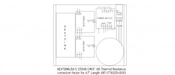

Applying factors to HSUSA 8" .66 TR heatsink results in .619 (.66X1.17X.802=.619). Would that work?
That would be quite comfortable for one Parallel-86 (0.62 < 0.80), yes. It would not be enough for two Parallel-86 (0.62 > 0.40).
