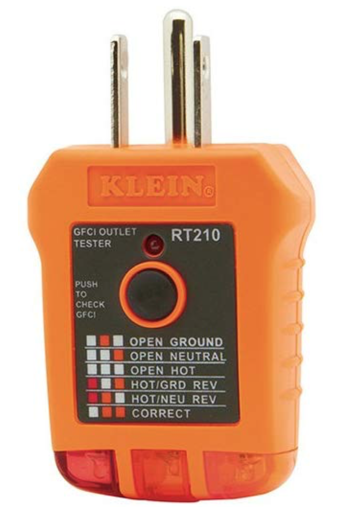

Sounds like you have a severe grounding issue in your setup. Have you checked your outlets with an outlet tester (see attached)?
