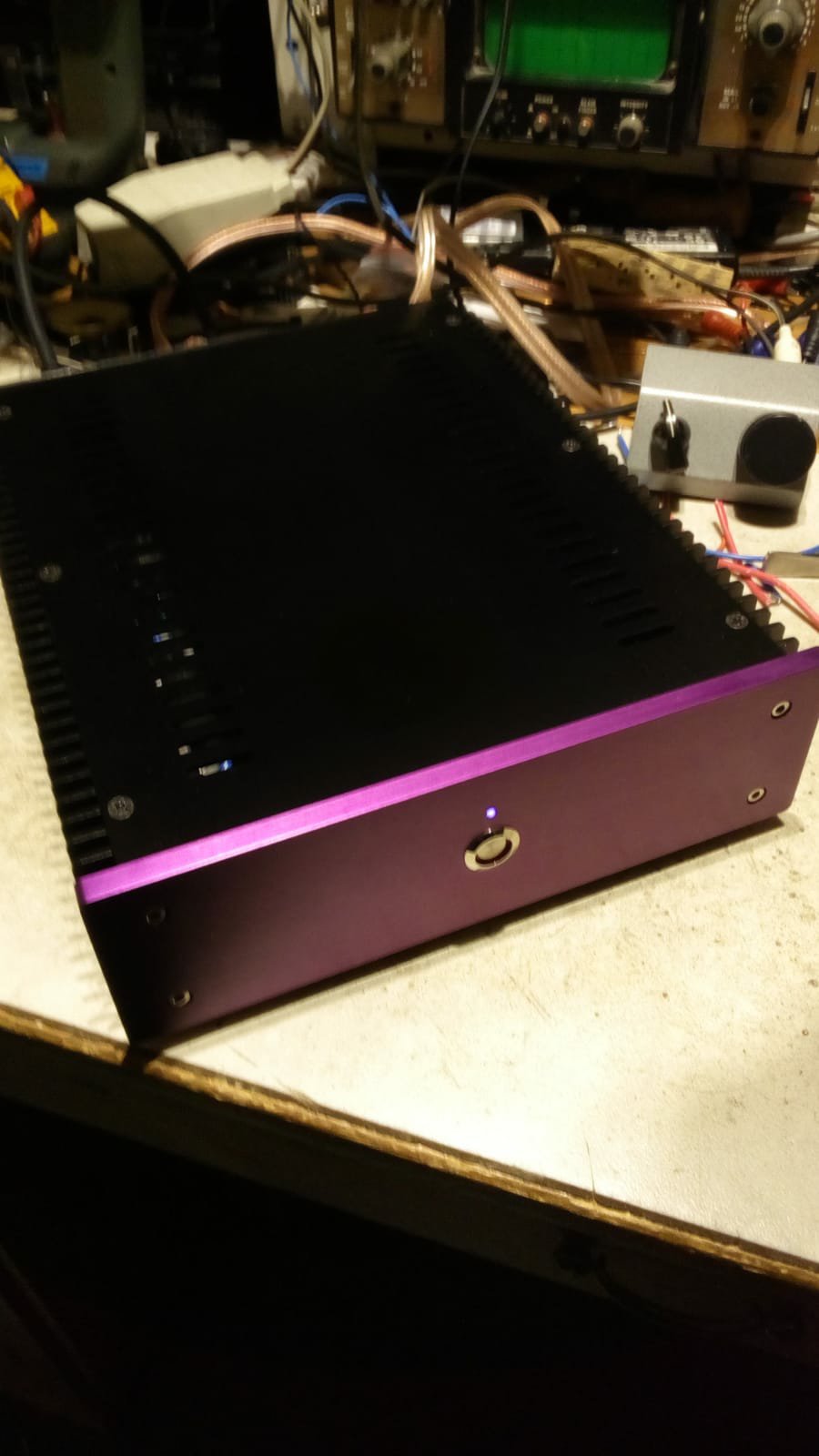

A friend of mine has rescued and repaired some broken mod86 pcbs and stuck them in this rather eye catching chassis.
He already has a 286 after hearing my 686 and he tells me that this 86 is as good as his 286 and in the coming weeks, I hope to compare it to the 686.
That'd be Firebottle then! He didn't tell me he'd got them working already damn cheek :)
Tom might remember I blew up a 86 board when I switched to monoblocks and decided I should keep well clear of electronics. Glad they've been made good again.
