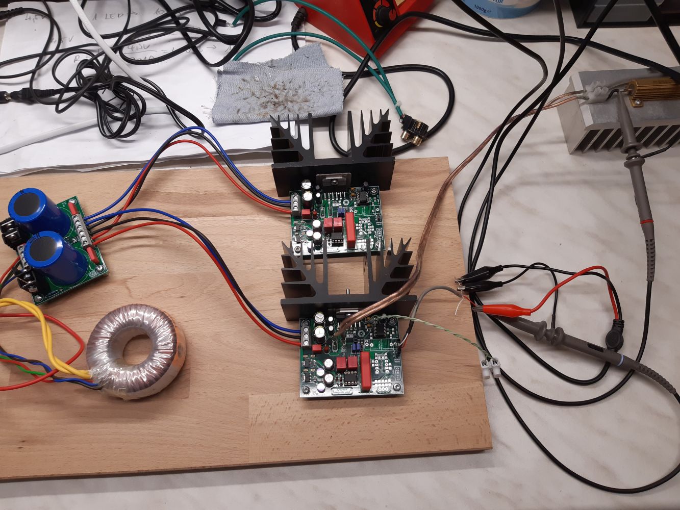

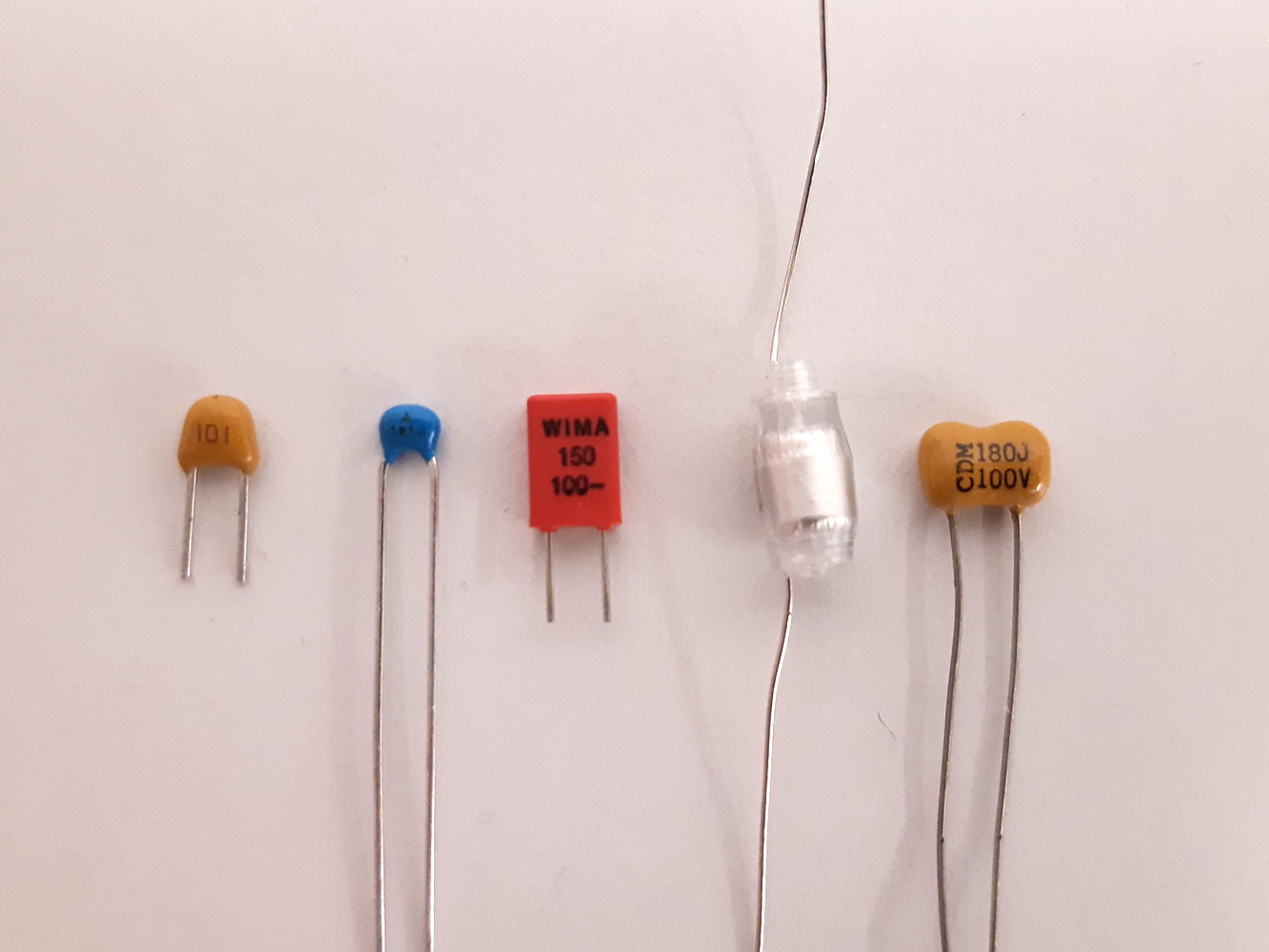

Just let me tell some of my experiences. I’ve built a composite LM3886 amp very similar to Tom’s Modulus, what gave me the basic idea. In the wintertime I’ve simulated-built-measured-listened, simulated-built-measured-listened and so on, made a lot of period and have my conclusions so far…
The amp is really good, but there are some things to consider. A big disappointment was that my favorite Wima FKP capacitors doesn’t perform well as HF filter. A lot of manufacturer use them, but they simply sound dull, without fine details. I’ve tried e.g. Murata-RDE tht C0G caps, they are definitive better, but a teeny cold. My bests are polystyrene types.
The slew-rate of the amp is about 5V/us. It is not too “fast”, but fast enough for >20 kHz. As Douglas Self writes, it is only one of the marketing slogans, that faster is necessarily better!
Phase margin in the simulator > 90 degrees, THD < 0.0001%. I was wondering anyway how good the simulator is! I can model the transient response nearly identical to my measurements.
Other discovery form me, that the capacitor (typ. 220pF) between the + / - inputs of the LM3886 doesn’t help too much, causes only trouble. The usable values here are about 1.5kOhm - 1.5nF RC combination, but didn’t tested it with my ears yet.
Another thing: I do not use a compensating cap in the global feedback like Tom. Tried it with 10-22-33nF values but sonically makes it only worse, the amp stays in any case stable.
And so on…
I would say, keep it as simple as you can, and be aware of component quality if you build it!

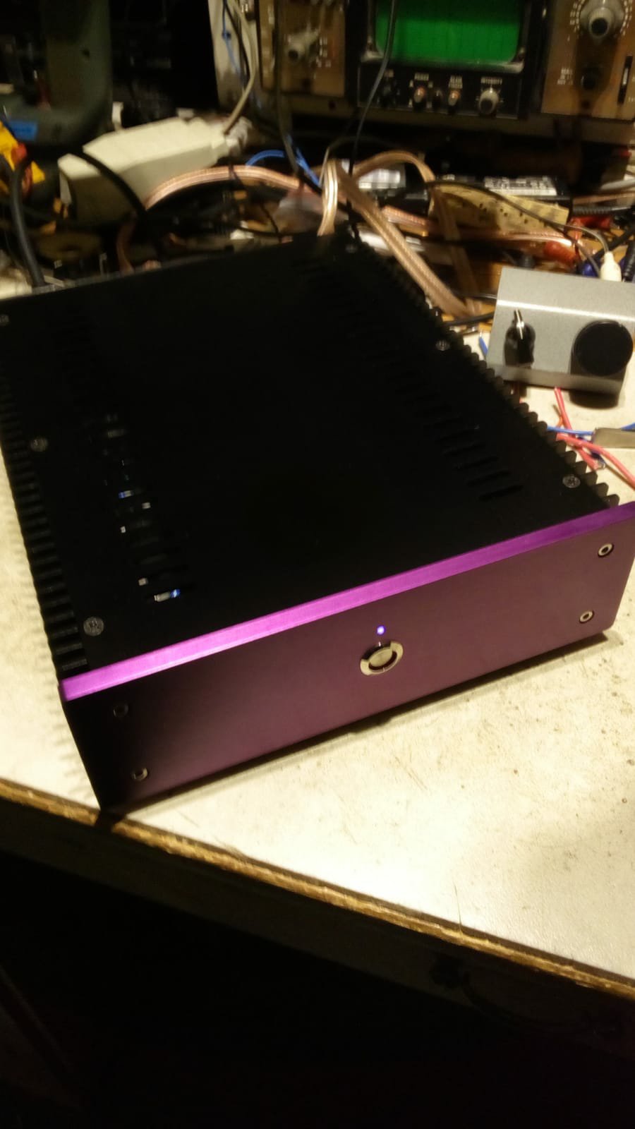

A friend of mine has rescued and repaired some broken mod86 pcbs and stuck them in this rather eye catching chassis.
Nice purple!
He already has a 286 after hearing my 686 and he tells me that this 86 is as good as his 286 and in the coming weeks, I hope to compare it to the 686.
The Modulus-86, -186, -286, and -686 sound the same below clipping. I.e. they don't make any sound. They just amplify.
