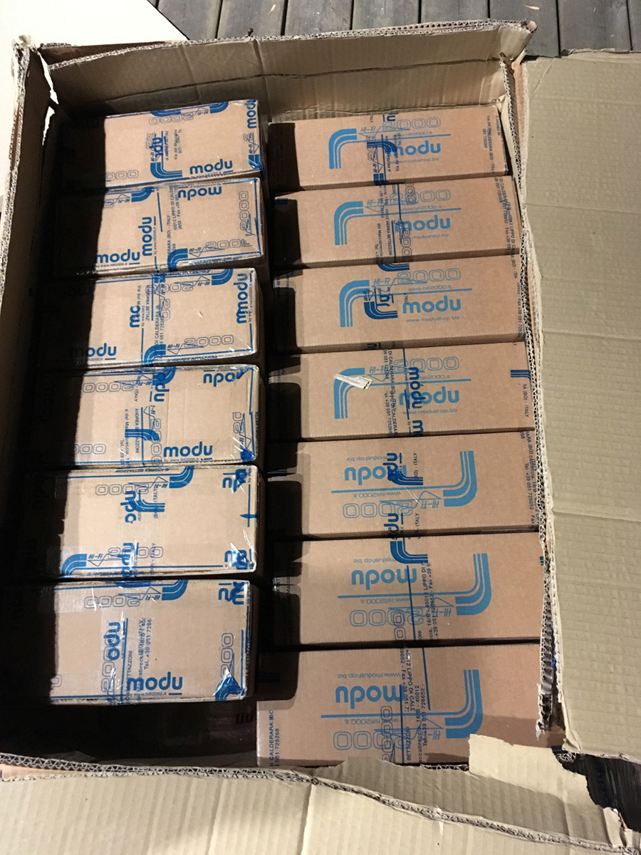

This is what 25 ModuShop chassis look like. I had FedEx hold the delivery so I could pick it up. I wasn't able to guarantee that I could be around for their delivery until Friday and I want to ship the chassis then. The two pallets just fit in my car with the backseat down.
I love the packing job. The large boxes were stretch wrapped to the pallets. The boxes had cushioning inside, which I removed for the photo. Then each chassis in its individual box. Awesome. I haven't cracked one of the small boxes open yet, but I suspect another layer of foam and/or bubble wrap. These guys are pros at this.
Aluminum... So much aluminum. 83 kg in all (though that probably includes the weight of the pallets). 🙂

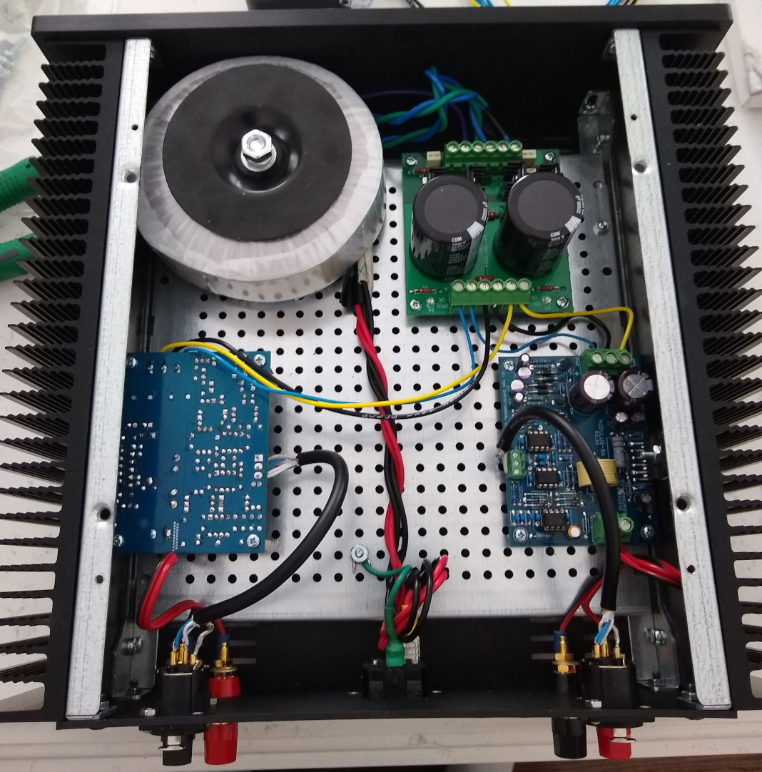

On a better note: I just finished my Modulus-86 Build. I had it almost completed last weekend, but somehow screwed up my Mouser order, and decreased the quantity of one resistor value from four to one. So only today did I receive the missing parts and finish assembly.
I've been using the "little brother" of the Mod86 for a while, see my LM3886DR build.

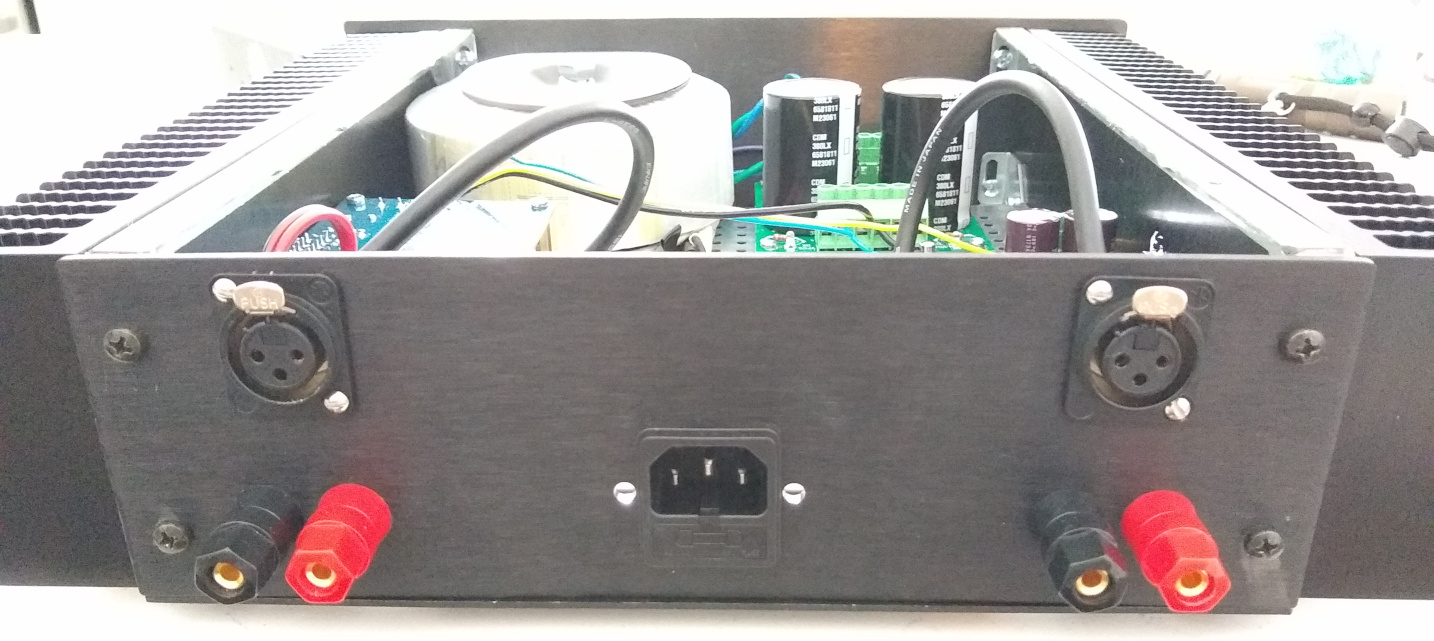

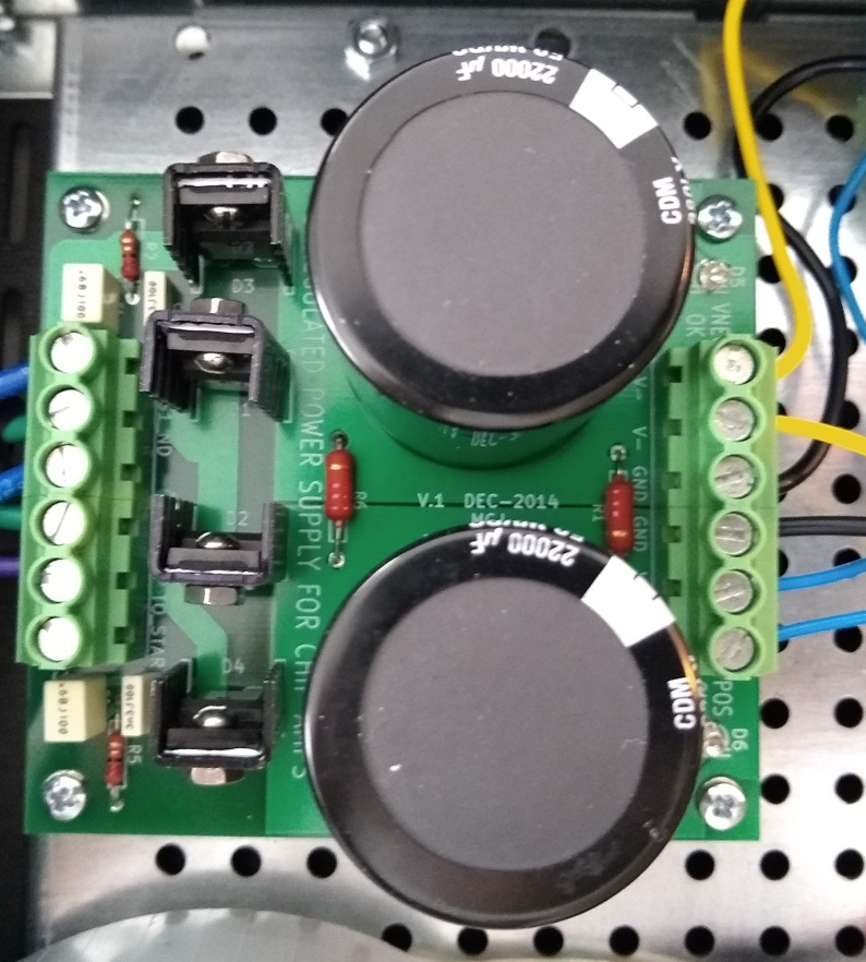

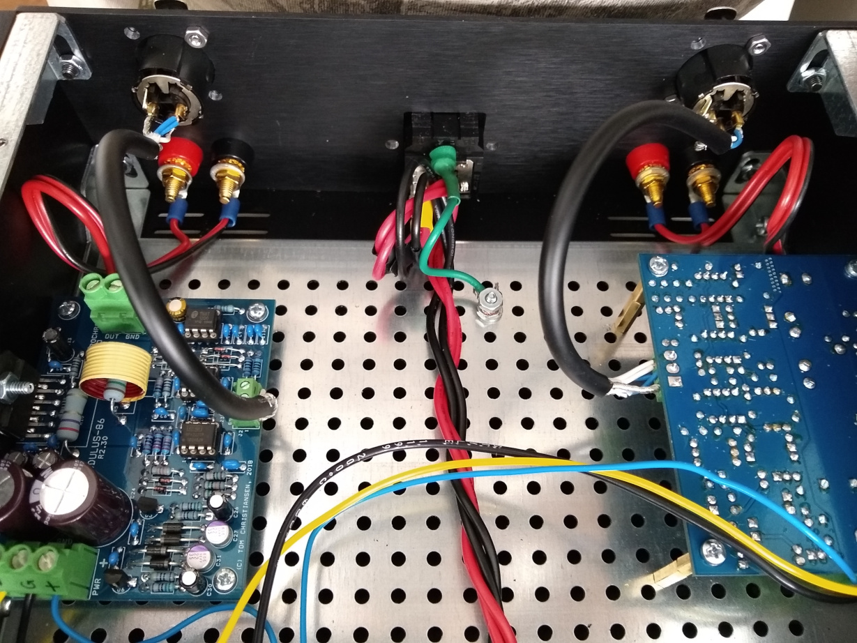

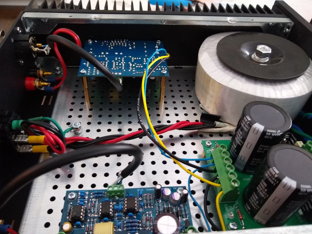

My Mod86 boards are built exactly to Tom's BOM and guidelines. The power supply is the RingNot, because I already had some of those boards on hand. Transformer is the Antek AS-2222. Case is from the diyAudio Store (Modushop), Mini Dissipante 2U 300x330. I had them do custom machining on the back panel. I created the design in Front Panel Designer, then exported to DXF. In the attachment list to this post is a zip file containing the FPD and DXF files for the rear panel cutouts, in case anyone else wants to use it.
Initial impressions are great! I don't think my ears are anything special, but I certainly don't hear anything objectionable. Has really "black blacks", which I like, and an overall incredibly "clean" sound. That's all I've got right now for verbal feedback; need more time with it to make any further commentary.

Very cool. Thank you for sharing. It looks like a pretty clean build. I'd add a couple of wire ties on the supply wiring to keep them bundled tightly. Looks like StarQuad cable on the input. Neat!
Tom
Tom
Nice build Matt, but two safety points. You have bare connections on the mains IEC socket and the safety earth connection to the case should be via a solder (or crimp) ring terminal rather than just the wire under a washer.

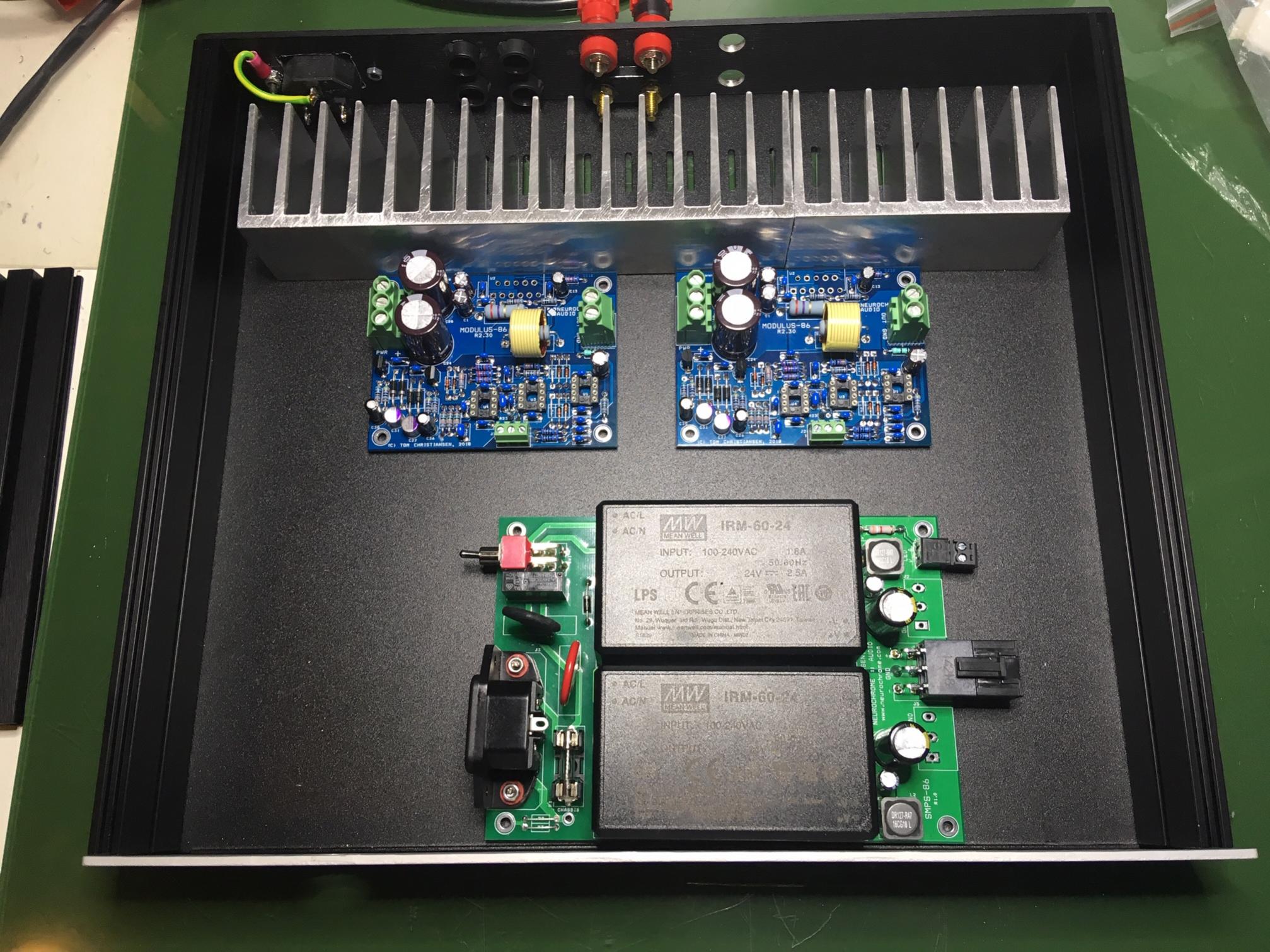

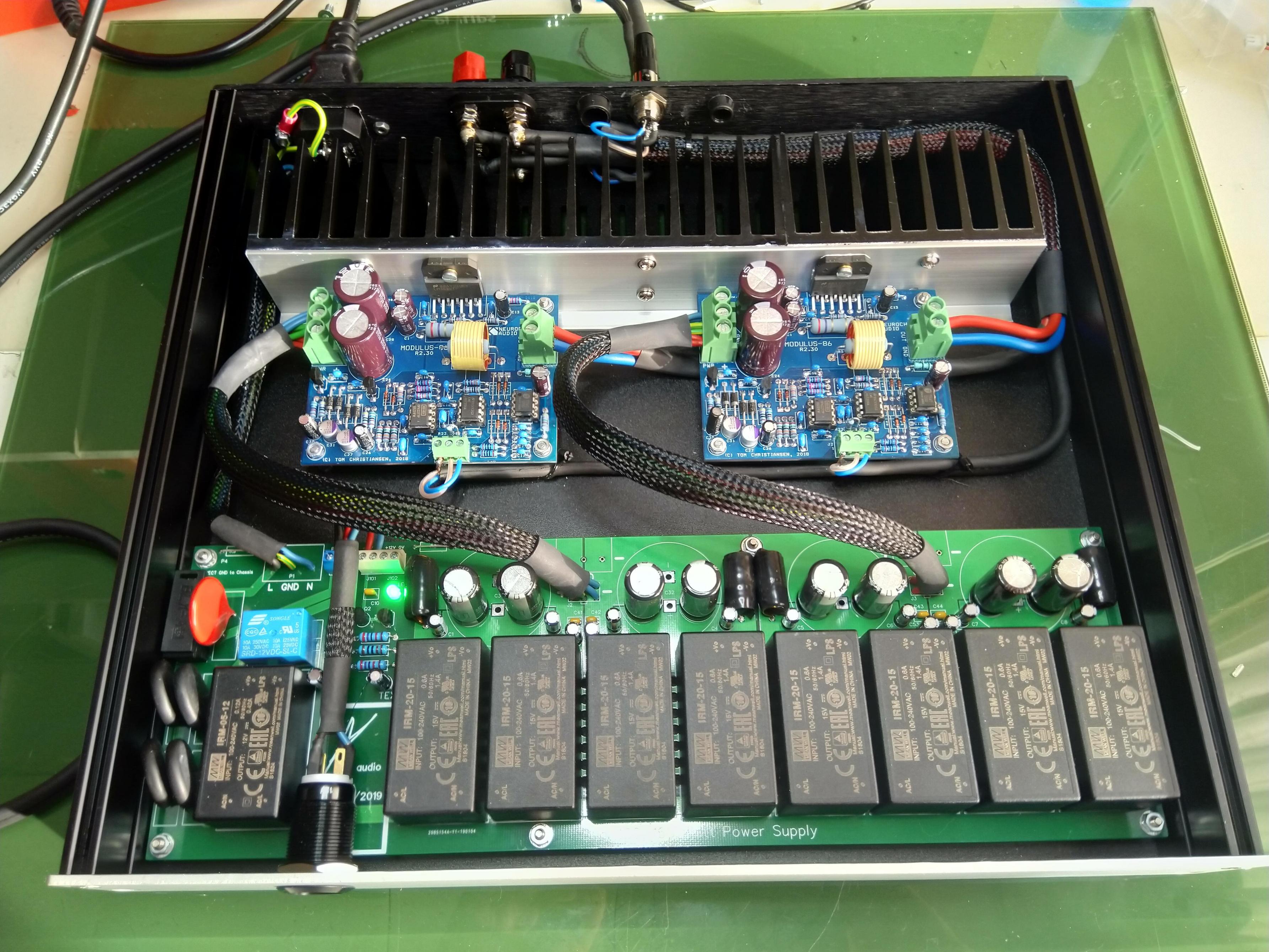

Finally

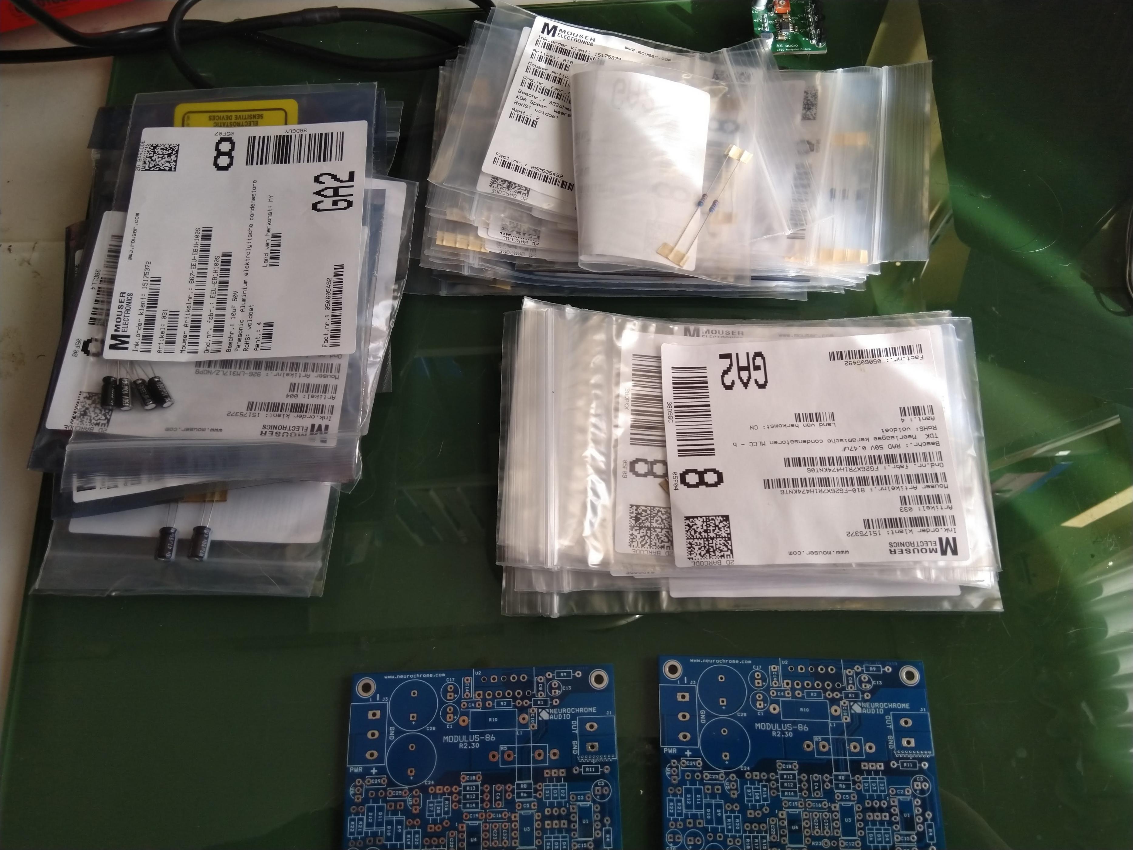

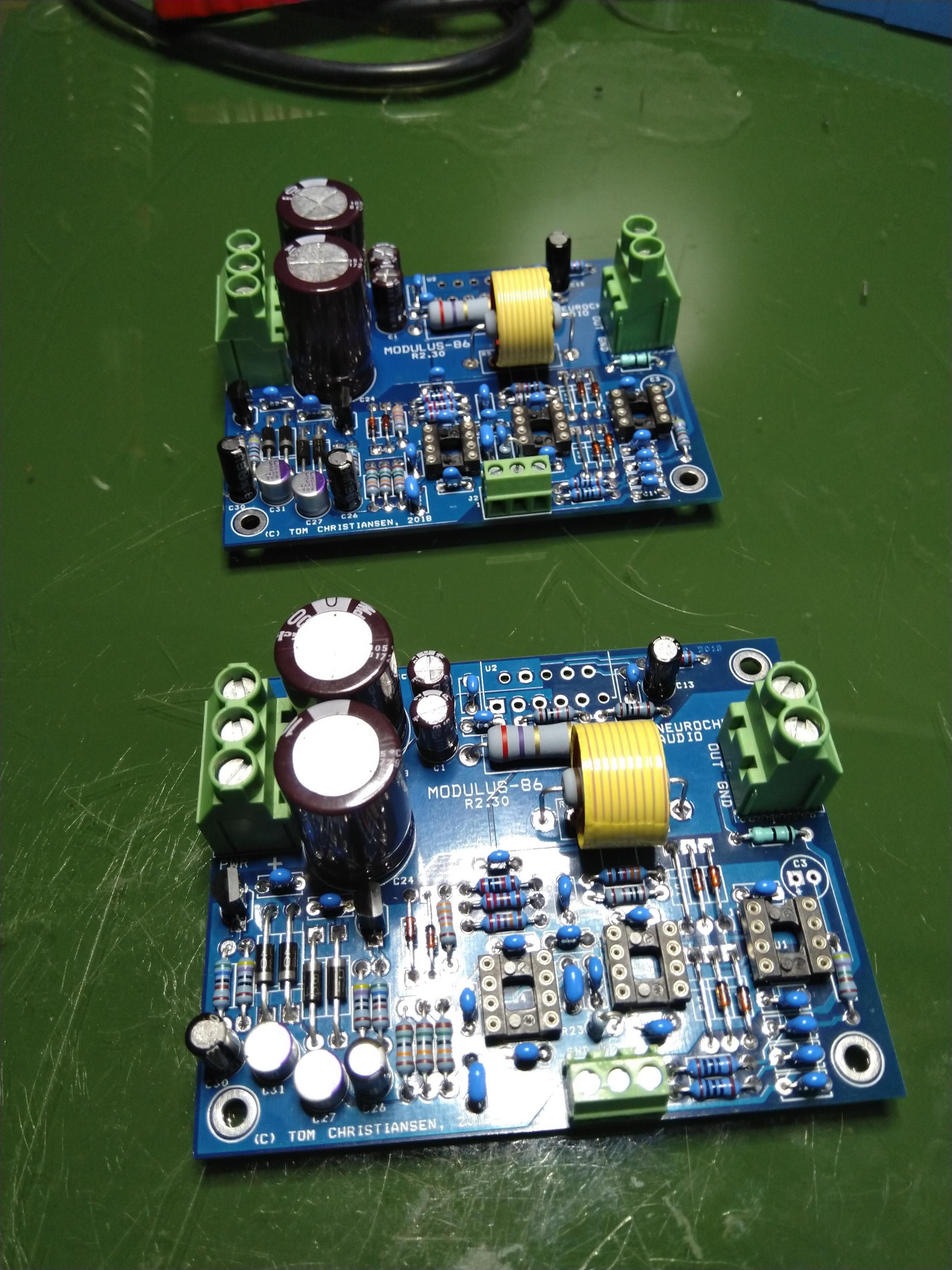

The PCB's (incl. coils) I ordered from Tom's Neurochrome website where delivered really fast. The Mouser part took 7 weeks for delivery (1).
The build was easy. Everything fitted like a glove (2).

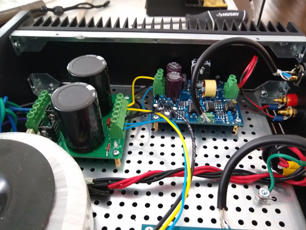

After some really big builds in the past, I decided a few years ago to challenge myself to use only the HIFI2000 Galaxy 40mm enclosures. So my plan was a little bit like the third picture.
In the 7 weeks, I had to wait for the Mouser parts I got the idea the 24V power supply wasn't enough. So I draw a new PCB power supply (inspired by Tom's SMPS-86) and ended with the fourth picture.
Now the Modulus '86 delivers really nice clean Watts to my tweeters (Beyma TPL-150).
After some changes to the DSP they sing and shine like never before. 😀
Thanks!

That's a neat build. If you haven't already, make sure to get some heat shrink on the mains connections by the IEC connector. I like the TechFlex. It makes the wiring harnesses look nice and tidy.

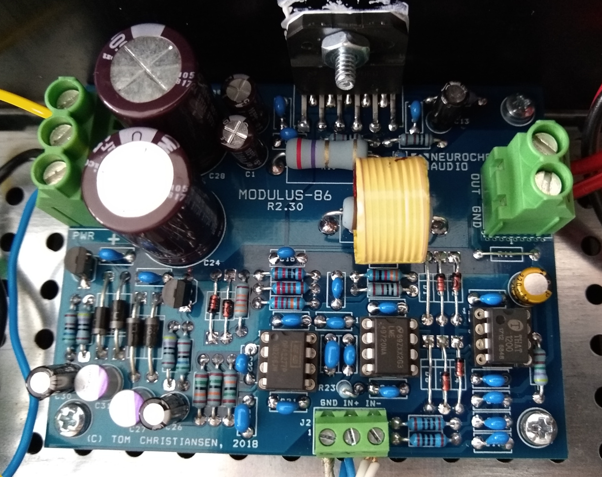

Hi - probably a stupid question, but Ive just received a mod 86 board in the mail (thanks Tom for the quick delivery). Great looking board and looking forward to the build. I cant for the life of me figure out where to find the component list however. I know there is a BOM in the documentation (mouser project) however how do I determine which resistor corresponds to R1, R2, etc?

THe BOM has a 3rd column, Reference. You have to match those with the markings in the board (see image)
