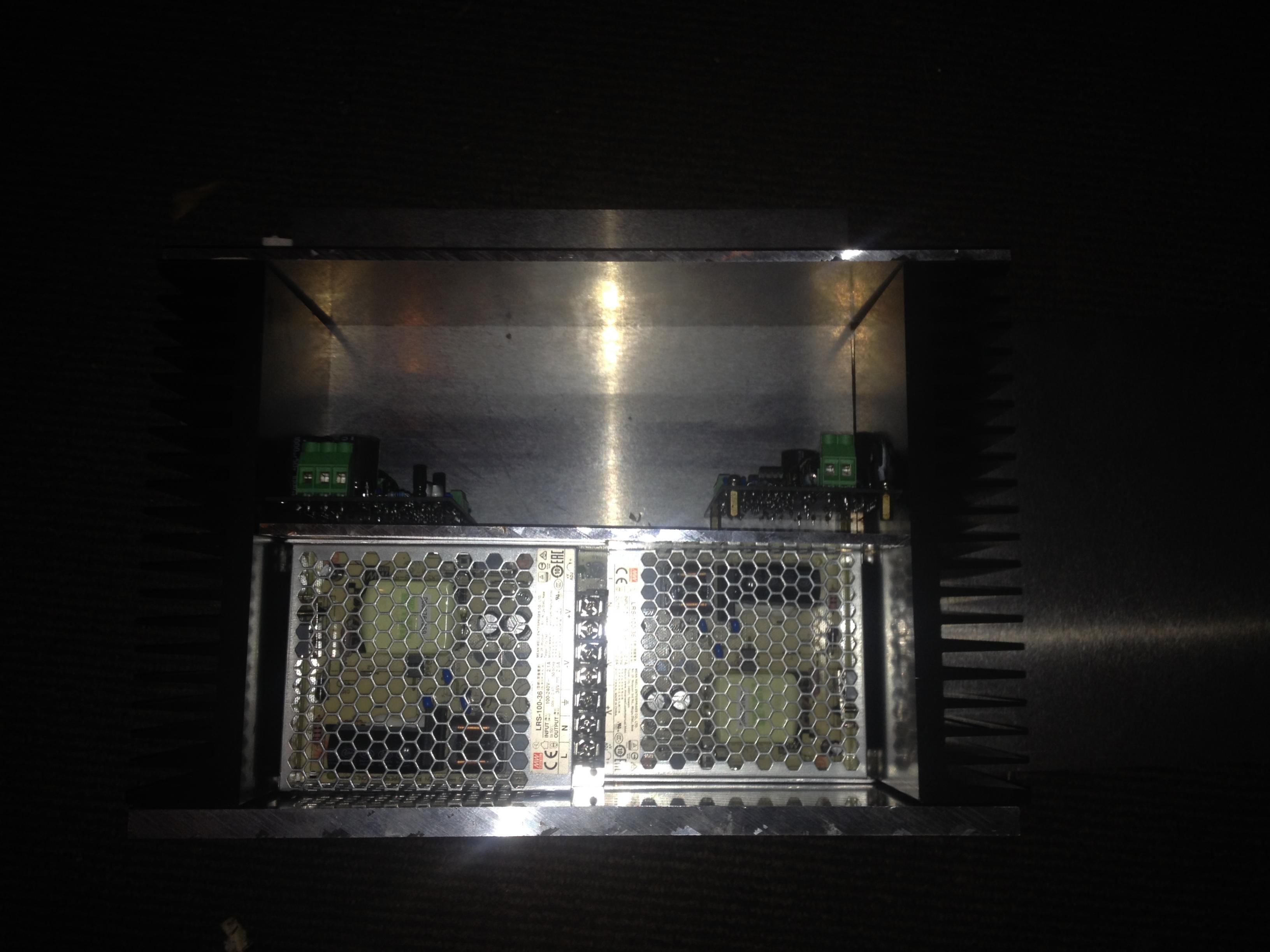

The case is a 3U/400 and each channel has a 300VA transformer and a Ringnot board, as with heatsinks and PSUs nothing exceeds like excess.
I have also added an soft start board, with the switch at the back as I have a toddler.

The clips came with the original amp, I kept them to keep some consistent clamping pressure on the LM4780s given I used U021041-15-U1 | Thermal Interface Sheet, Ceramic Filled Silicone Rubber, 1.2W/m·K, 101.6 x 101.6mm 2.03mm, Self-Adhesive | RS Components as the insulator.
The layout was really meant to try and keep the wiring logical and, as a result, as short as practical. One of those things that I always think is good practice even if it isn't always necessary.

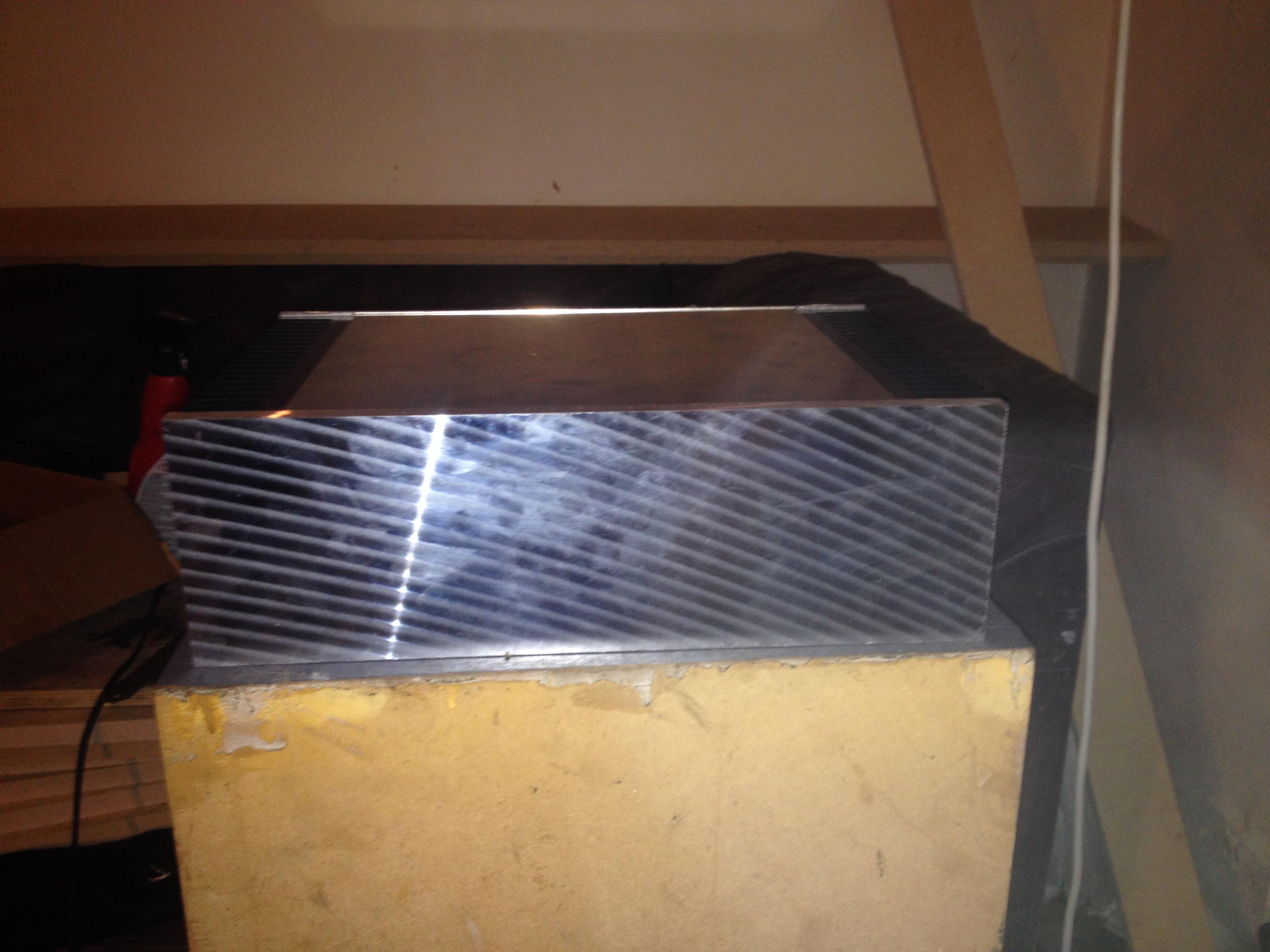

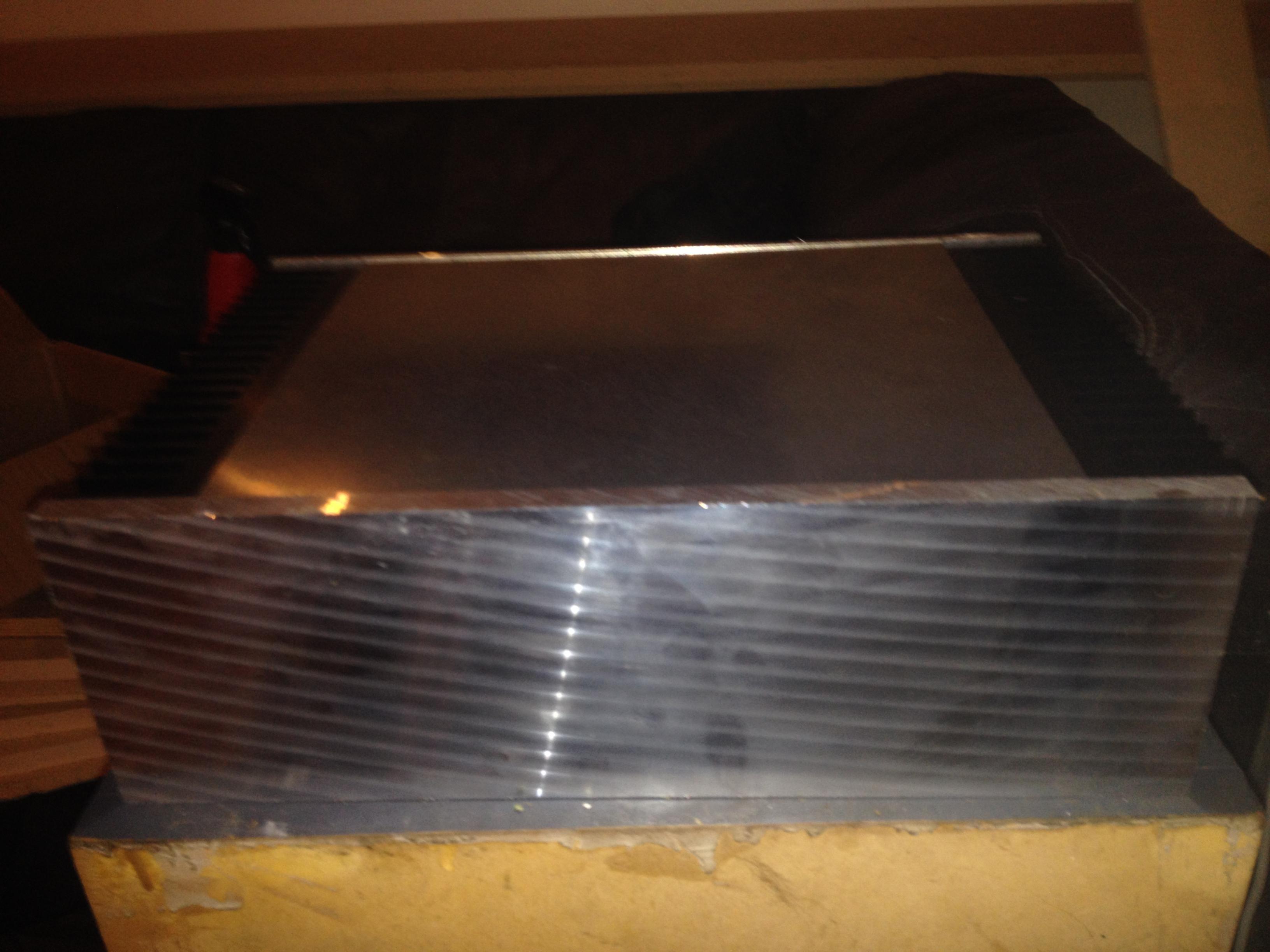

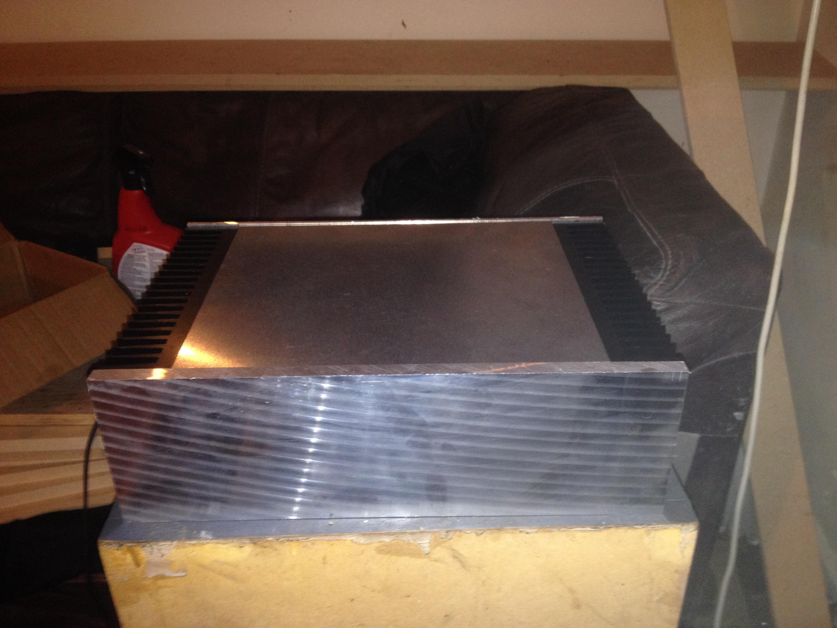

am i sat watching trailer park boys twiddling my thumbs i have all need to complete my mod 86 including the badly scratched aluminum im now waiting to be replaced so no final build until mid next week im gutted all i can do is build mock ups sorry for bad pics[/ATTACH][/ATTACH][/ATTACH][/ATTACH]
Dang! It looks like the front was cut from a piece of (very large!) bar stock. A couple of finishing passes with a fly cutter and some belt sanding should fix that right up.
Tom
Tom
yep thats 12ml eco cast very flat minimal tooling needed or should i say less ware shame the 5083 for the body was left too loose in package and the sharp edges left some very deep cuts on the eco cast also heat sinks had to be sent back for being chipped this has just been one of them builds
and yes i cant wait to sand and buff this baby
