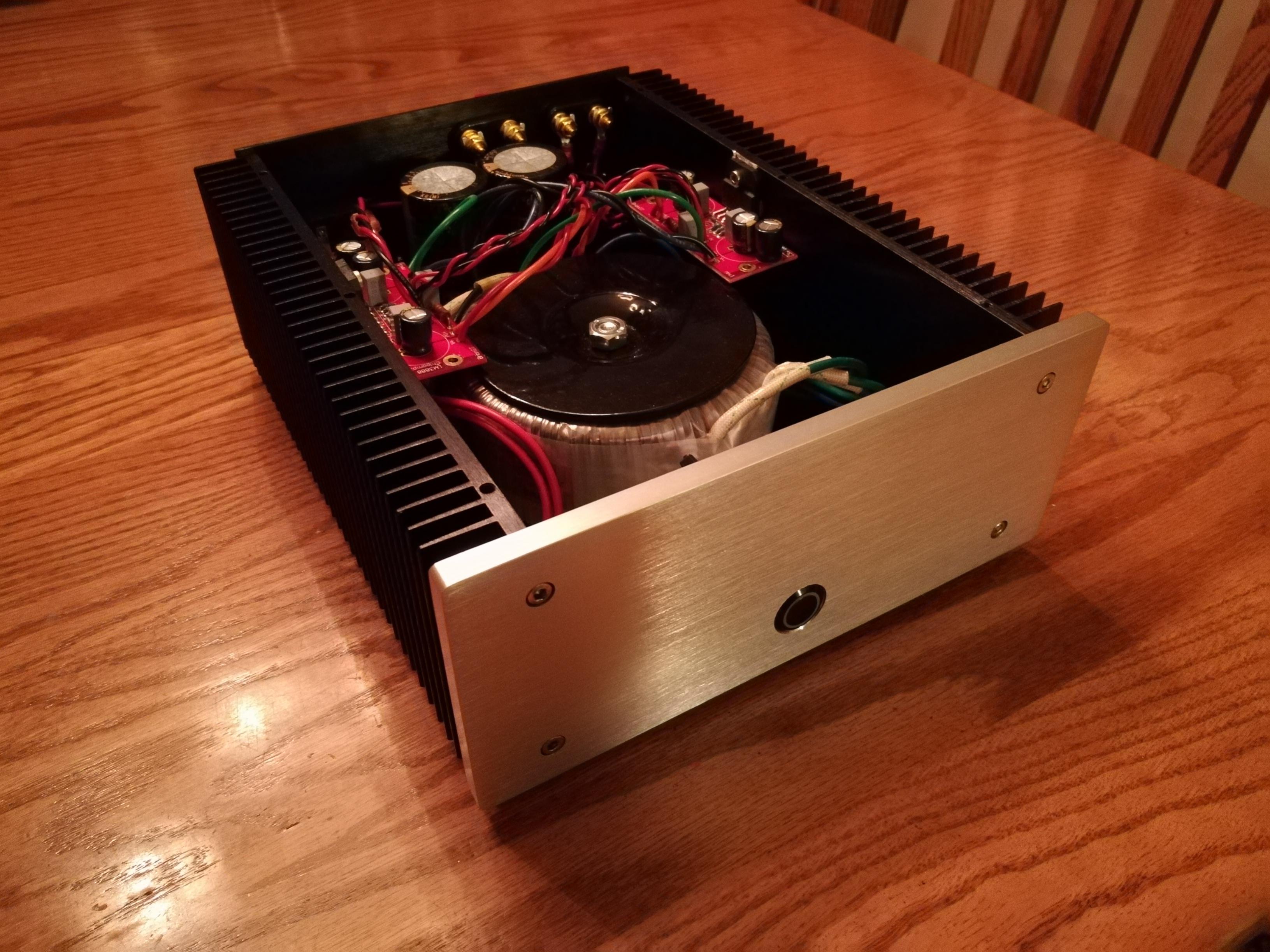

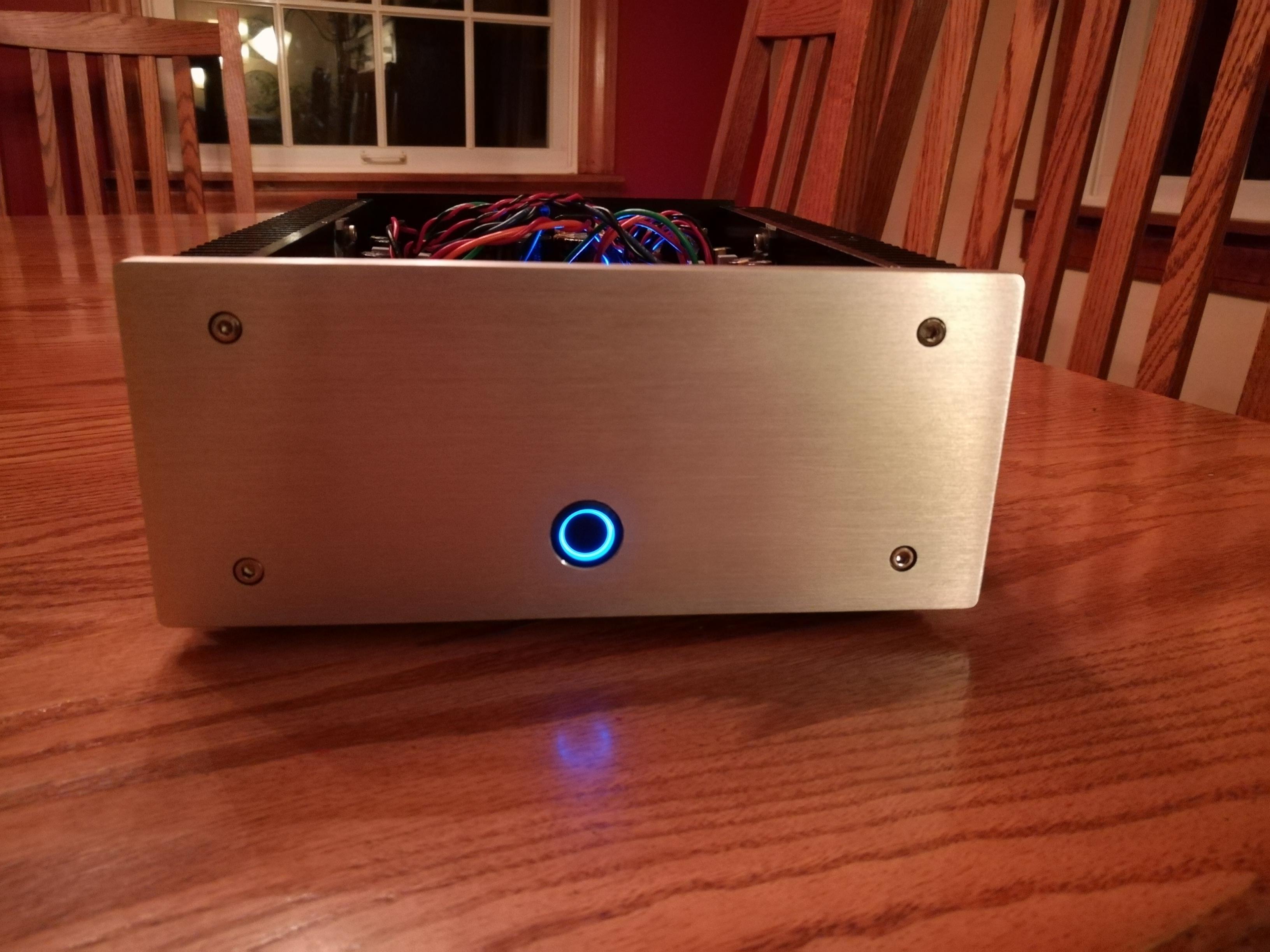

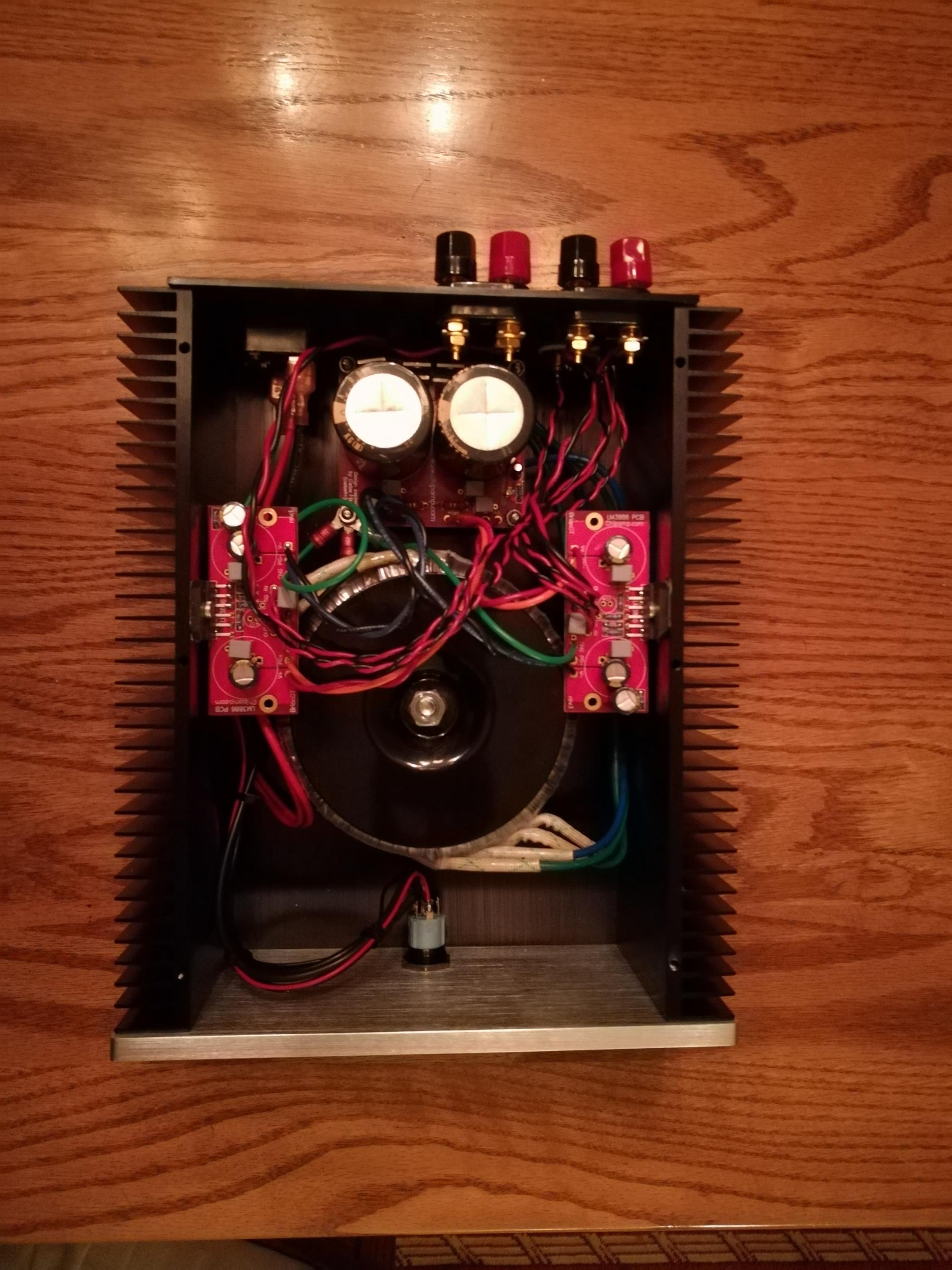

Longtime lurker on these forums. About 2 years ago my then 11 yr old daughter suggests that we do an electronics project together. Picked up an LM3886 parts and board kit, a friend donated a XFMR and bought a chassis on ebay.
One of the things I like about these forums is that many folks take as long as I do (or longer) to complete these DIY projects. We had the boards done over a year ago and bought the chassis and power switch at some point. Had something to listen to about 2 months ago and finally put the finishing touches on it a week ago.
I was surprised at how good it sounds. I expected it to sound OK with maybe some noise. But it is dead quiet with no signal. And the sound with some old NHT super zeros was quite good. I am also happy with how it looks with the chassis. Not bad for a first DIY amp build.

Looks like a pretty compact build there. I suggest tidying up the wiring a bit, though. In particular the supply wiring should at least be bundled together to avoid rail-induced distortion.
I suggest placing the LM3886 further down on the heat sink. You're not making good use of the heat sink with the LM3886es that high up. You might have been able to put the LM3886es lower if you'd moved the power switch over to the side and scooted the power transformer to the front of the chassis. That's obviously a bit late now, but I'm leaving this suggestion here in case someone is looking for inspiration for a chassis layout.
I also suggest adding a bracket to hold the board to the heat sink. Cantilevering the board off of the LM3886 is a recipe for metal fatigue and premature failures.
It does look like the chassis has adequate heat sinking. Good choice there!
Note, however, that this is the Modulus-86 Build Thread. A better place for your post would probably be in the Chipamp.com Forum or the Chipamps Photo Gallery. Unfortunately, chipamp.com is now defunct. Whomever bought it from BrianGT promptly drove it into the ground. In fact, that's a large part of the reason for why I now offer an LM3886DR.
