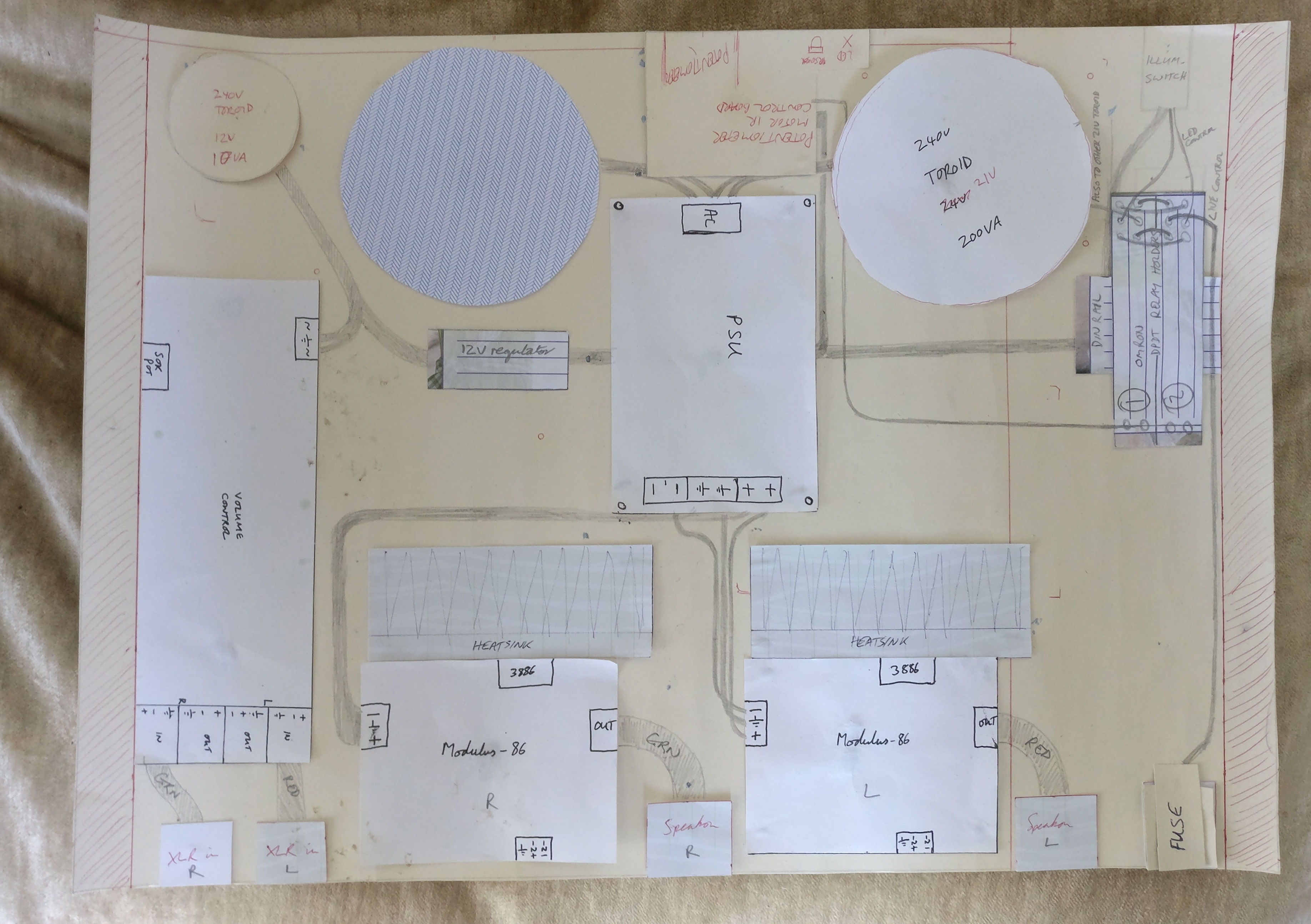

My build is going well. I've built and tested both the Mod86 boards and a power supply board, also a relay attenuator. Still waiting for delivery of a little 12v regulator board to supply a remote control volume control board that will control the relay attenuator, but I've finished the layout (designed using cardboard cutouts, see the photo attached). Then I can get the case fabricated (it'll be a custom aluminium and oak affair) and finally all put together. I'm using Neutrik powercon and speaking connectors and locking XLR connectors, and 2 Omron relays to allow power control via either a switch on the front or the remote control. Full power off (including shutting off power to the remote control) will be possible via a switch on the back.
(I'll edit this post to attach the layout photo when I've figured out how to upload photos....)

Layout planning
I've figured out how to attach pictures now. My layout will be as per the attachment: it tries to keep the power supply, mains voltages and transformers away from the signal and aims for a reasonably short signal path from the XLRs through the volume control board and the Modulus-86s to the Speakon connectors.
That's a good idea. It will certainly simplify the top and bottom panels as I won't need to machine convection slots in them. I've turned them round, and also moved the XLR and Speakons so that they're aligned vertically, with the Speakons in between the two Modulus-86s: that made the back feel a bit less cramped.
Tom, thanks for your reply. I had not thought of how to reach the rear pins with clippers, Folding it back after the front pins are cut is a great idea. Appreciate your support. Those are clear instructions I can follow. LM3886 should be here soon, now just hoping the voltage regulators will prove to be working, otherwise I'll be waiting on shipping again. Oh well, these are luxury problems, and I'm still having fun.
Adrian, I like your method to lay out a scale diagram like that. I should have thought of that. Your volume control looks cool too. Can't wait to see it as it progresses.
