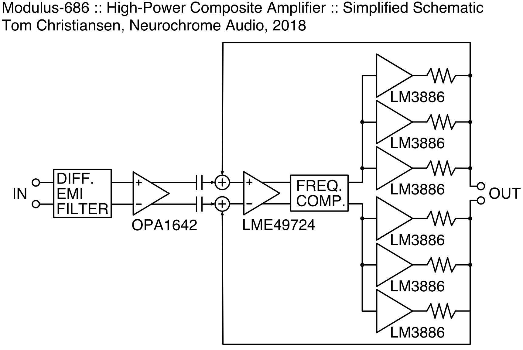

I'd still argue that the applications engineers at National missed the mark with the BPA200. It's not bad, but could be improved. It will drive an 8 Ω load just fine but will run out of steam with a 4 Ω load. If you want to drive a 4 Ω load, you really need to use six LM3886es. You can see my rationale here: Taming the LM3886 - Output Power.
There's also an interesting little quirk in the BPA200 design. If the negative supply starts up before the positive, the amp will latch up. It will draw a lot of current for a few seconds until it recovers and starts up. With a current limited supply, that's no big deal, but with two SMPSes with different startup times capable of delivering 16+ A, that could mean trouble. In most implementations you'd never notice. I found it by coincidence in the lab. That's why the final version of the Modulus-686 board contains a few extra components to make sure that the amp is shut down if the imbalance between the positive and negative supply is greater than 4-5 V.
Of course, I then went ahead and took the BPA topology to a whole new performance level with the differential composite topology. I've attached the block diagram of the '686 so you can see what the topology looks like.

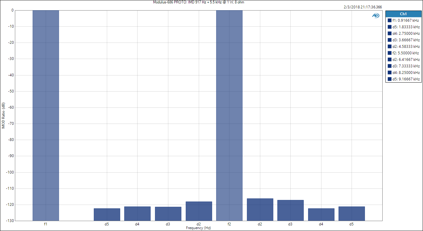

I'm trying a new measurement: 1 kHz + 5.5 kHz IMD. Siegfried Linkwitz seems to advocate for this measurement as in his experience it correlates especially well with the perceived listening experience. It is worth noting that the MOD686 performs 20-30 dB better than the best amps listed on his website: Amplifier Distortion
Note: I used 917 Hz + 5.5 kHz due to a limitation in the APx525 signal source.
FYI, Linkwitz added a couple more to the LXMini's Amp page, but the 686 still beats them all. VERY impressive results, Tom!
People who are skeptical about SMPS perfomance, please note that the ATI Ncore's performance there seems to be limited by its linear power supply.
