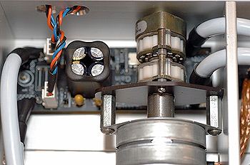

I use a balanced version of Bent Audio's TAP-X. The measurements are here:TAP-X measurements. Those measurements are a worst case scenario.
Maximum gain available is +7dB. Since my system is high sensitivity and since have decent output from my DAC as well as vinyl sources, I never have to go past unity gain.
For me, the measurements above and my sonic appreciation of this unit, match completely. For those who do not need or will ever use extra gain, i.e. only need unity gain, I would recommend a balanced build of Tortuga's LDR. I do not have any measurements on that unit, but my audition put it on par with the TAP-X unit which is great, more options! The Tortuga LDR is cheaper to build DIY however. The fully built version of the balanced Tortuga LDR and fully built Bent Audio TAP-X are about the same (~$2K-$3K, depending on options).
I did a diy build of the Bent TAP-X, seen here and called Poseidon's Voice Lazarus.
Until there is a preamp (with or without gain) that has distortion levels lower than the Modulus 86 or lower than my current Bent TAP-X, I am going to stick with the TAP-X.
You certainly don't want to build a preamp that measures much worse than the Modulus 86. What would be the point of that?
