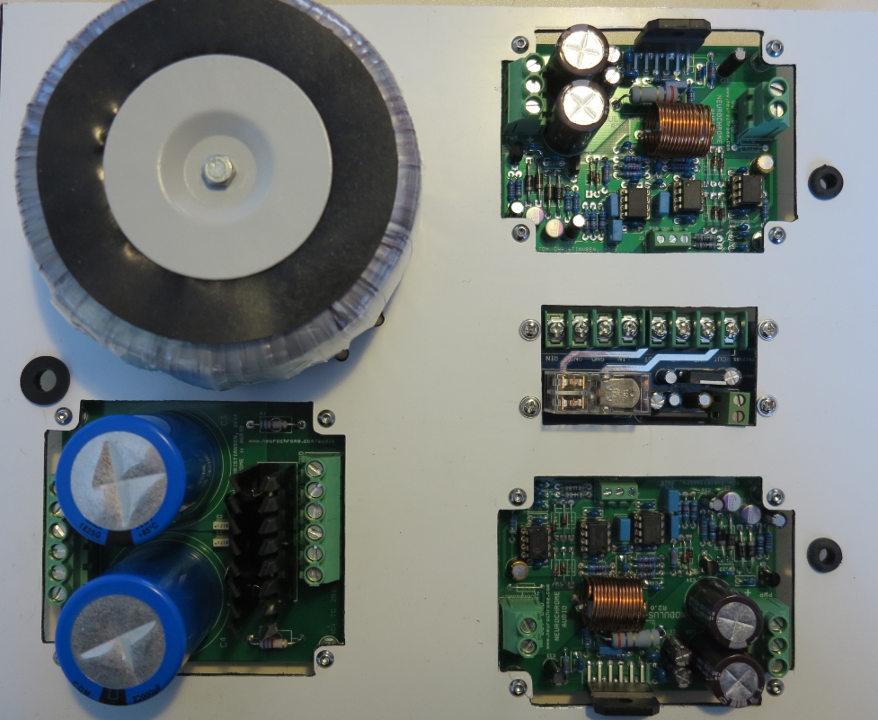

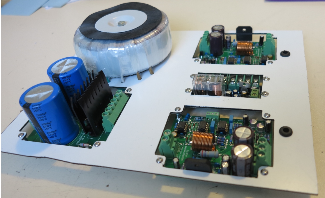

Finally assembled the boards and tried them out. It lives! This is my first amp build and I didn't have to redo anything! Yet.
I was bitten by the bug in the Mouser system (see Post #334) which causes two connectors and a capacitor (per channel) to be missing; watch out for this if you order the Power86 and the Modulus86 BOM together from Mouser.
.........it played music, and pretty well.
Now the questions:
1) The transformer has an annoying buzz. I had to put my ear close to it to localize the source, but it's audible in the room. I'm hoping this will go away when I bolt it down in a chassis. This is audible without connecting the Mod86 boards; it's not through the speakers, it's directly from the transformer.
3) The sound volume was relatively low. This may be because of my cell phone being the source. But even with the volume on the cell phone turned up all the way, the sound was , well, a quiet listen.
4) I had the feeling that the vocals were somewhat recessed and the instruments somewhat forward, especially the bass. Again, the source, the speakers and the room are far from ideal, but perhaps someone has some explanation independent of these.
And what would a report be without pictures of the war zone. Gentlemen, feel free to comment, criticize, but do avoid direct abuse...
Thanks,

The output volume will seem relatively low as the amplifier gain is set a little lower than most Hi-Fi amplifiers, you can increase at a cost of worse sound to noise ratio) but even if you increase this by 6dB you should not hear any audible hiss, unless your ear is right up against the loudspeaker.
The cell phone will have weedy output, coupled to the low gain structure and maybe insensitive speakers? you shouldn't expect mega levels.
I wonder if the transformer hum is being exacerbated by the resonant cardboard box. Sympathetic resonances can be strange. It may indeed disappear when bolted down in your amplifier chassis with the rubber damper in place.
Consider that if you do not have a loudness function or equalizer changing the balance of sound on your phone (so we assume it is set flat) then the sound quality you describe is down to the original recording, or the loudspeakers in the room. The amplifier comes way, way down the list if it is a competent design.
The quality of the sound will probably be entirely down to the balance of the loudspeakers and their position in the room.
After the recording itself the loudspeakers are by a country mile the component that makes the greatest contribution to the quality of the sound, assuming a competently designed amplifier (and source component) is in the mix loudspeakers (and room) contribute massively (almost entirely by themselves) to the colouration of the signal.
The contribution to the sound quality (for the real world differences, not audiophilia nervosa) the part the amplifier plays is extremely minor, but it is there. it's all important of course but what you describe is not down to the amplifier (unless we've all been duped!). 😉

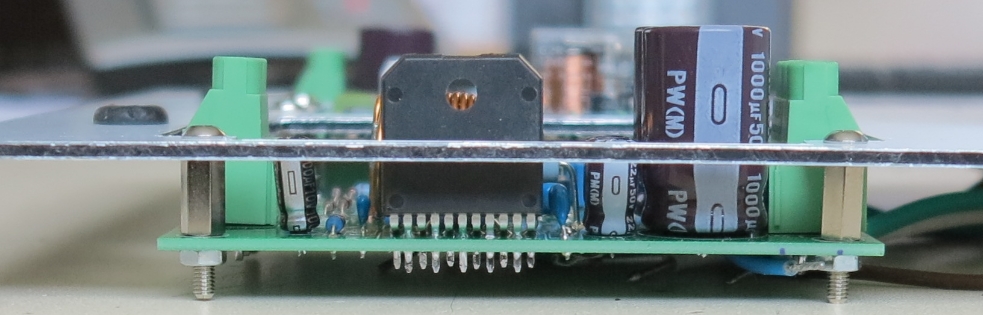

For the record, the power supply is -/+ 28V, so the maximum power dissipation is 18 watts and the output power is 28 watts into 8 ohms. That will be OK.
The thickness of the double bottom is inserted in the aluminum profile that serves as a heatsink and as a side of the case. On the pictures, it can be seen that the cooling area of the LM3886 "obscured" by the double bottom does not exceed 15% of the total area.Domi,

Thanks for the additional pictures.
With the additional picture of the heatsink (above and below) I think the combination will be fine, provided you can make the contact surface area nice and even, a flush fit.
It looks like a smart build. I'm just using a regular aluminium Hi-Fi case for the Modulus amplifier unit I am making for my Dad.
