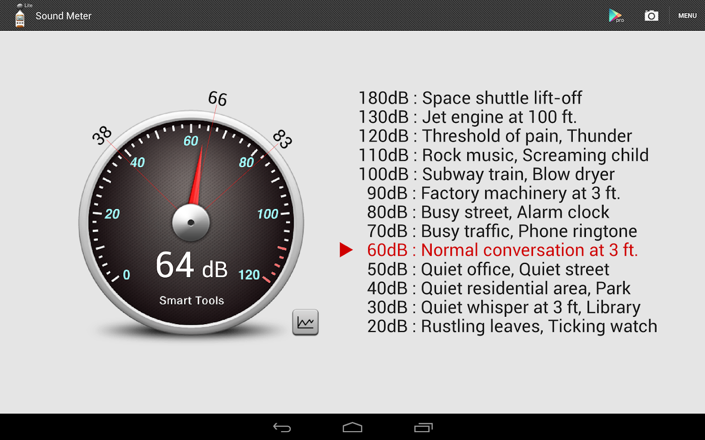

Sonómetro : Sound Meter
-> https://play.google.com/store/apps/details?id=kr.sira.sound

Playing loud
Near field
- Max 92 dB !!!
Two meters to left speaker
- Max 90 dB

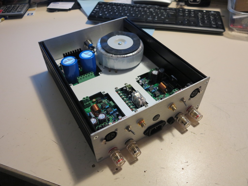

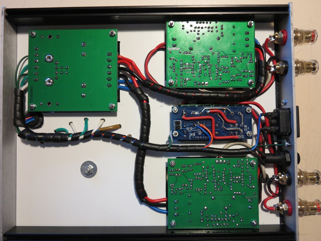

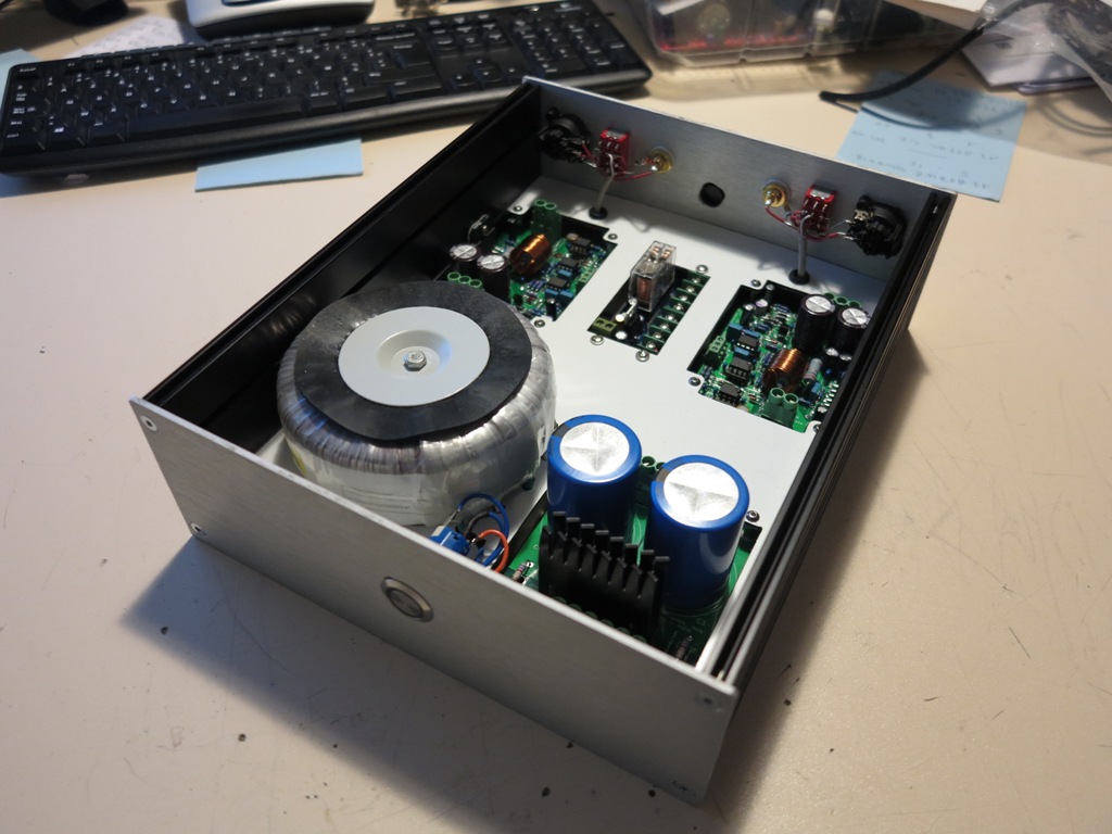

The wiring of my amp is now finished. The final chek is OK.
Now I setup my audio system (signal input, mains, loudspeakers, ...) and I press the on/off button... Because of the upc1237 chip, nothing happens during 4 seconds and then a relay is engaged and the electrons begin to flow into loudspeakers. In fact, I hope they do because the offset is at 0.000 mV on both channels.

Was that the maximum you could get away with or endure?, or do you actually regularly play that loud?
2m from the speaker is not really near field listening but it's close to it. Near-field listening is seriously close; Computer speakers; or BBC broadcast vans; the BBC invented the LS3/5a mini monitor for use on the road in cramped quarters in vans (you could touch the speaker when seated), that's real near-field listening!
With your present set up according to the Crown measuring tool you were using about 13 watts peak at 90 dB from 2m, but you can work that out for yourself. You should be fine with the standard build.

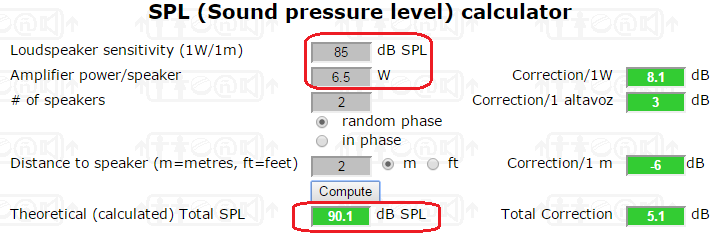

Actually, 13 W is for one speaker. For two (random phase), it's 6.5 W per speaker. Attached is the screen shot from the SPL calculator I linked to above.
Dude!! Nice build. I'm a little concerned that you didn't put a grommet on the wires coming out of the transformer, though. Hopefully you won't have issues with vibration causing the aluminum to cut through the insulation on the wires.

Thanks Tom,
I initially guessed this was per channel ( however Crown make mainly stereo amplifiers from what I can see) , but airing on the side of caution I worked on the assumption that this was a "system" figure. Your calculator makes that clear.
Either way looking at these online calculators this is lots of headroom for the little Kef's. It should be more than enough to potentially damage the drive units way before full output with head banging bass heavy material too.
