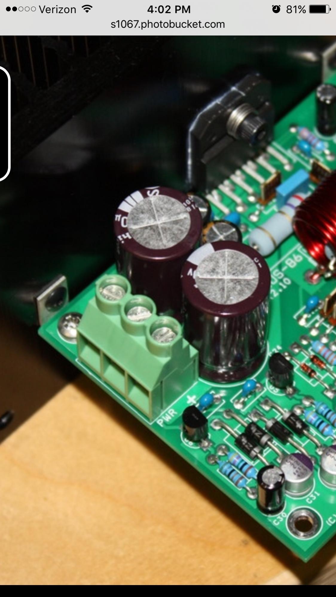

Bracket: Board to heatsink ???
Hello,
I noticed from one of the links on Neurochrome website, to a slideshow of Poisedon's Voice build.
He uses a small "L Bracket" to mount the Mod-86 Board to heat-sink.
Does anyone happen to know where to find such a bracket? Is it a part available at Mouser for example?
My next Mod86 amp will be complete in the next couple of weeks, and I want to use that method instead of standoffs, at least on the heatsink side of the board. I think that lining everything up, drilling, tapping, etc before I solder LM3886 chip in place will be easier with the brackets.
(The attached photo is from Poseidon’s Voice – Neurochrome Modulus-86 Rev. 2.1 Build. Poseidons Voice Modulus 86 Slideshow by nycavsr2000 | Photobucket)

The Keystone 4332 won't work with the MOD86. First off, it takes a #6 screw and the holes in the MOD86 board are sized for #4 (or M3).
The brackets shown above are not the Keystone 4332. I don't know what they are. Anand?
For the MOD86, you'll want brackets for use with M3/#4 screws. The distance from the mounting hole centre to the heat sink surface should be 0.219" (5.56 mm).

I don't remember the part number but you are correct, the L-bracket I used was made for 4-40 screws.
There are a few listed here:
https://www.digikey.com/products/en/hardware-fasteners-accessories/mounting-brackets/574
https://www.sparkfun.com/products/10228
Somebody will have to double check on the measurements.

I'll let you know how I make out with the brackets. I'm trying the keystone 521-612 listed above. I noticed the distance from center of hole to the bend is only 5.16mm, and I think it should be 5.56mm (or whatever Tom said above)
Half a millimeter isn't much, and it may work as is, so long as I'm able to get the board parallel and screw all the way flush to the bracket. I might need to open the hole a little more to get the room I need, in which case I'll need a little nut as well. Brackets will be here by next weekend.

The holes in the MOD86 board are 0.200" (5.08 mm) from the board edge. The LM3886 protrudes 0.019" (~0.5 mm) past the board edge. There's some wiggle room in the holes for the LM3886, so 5.16 mm will probably work. The mounting holes in the board are 0.130" (3.3 mm) in diameter so you'll have a bit of wiggle room there as well with an M3 and especially with a #4-40.
