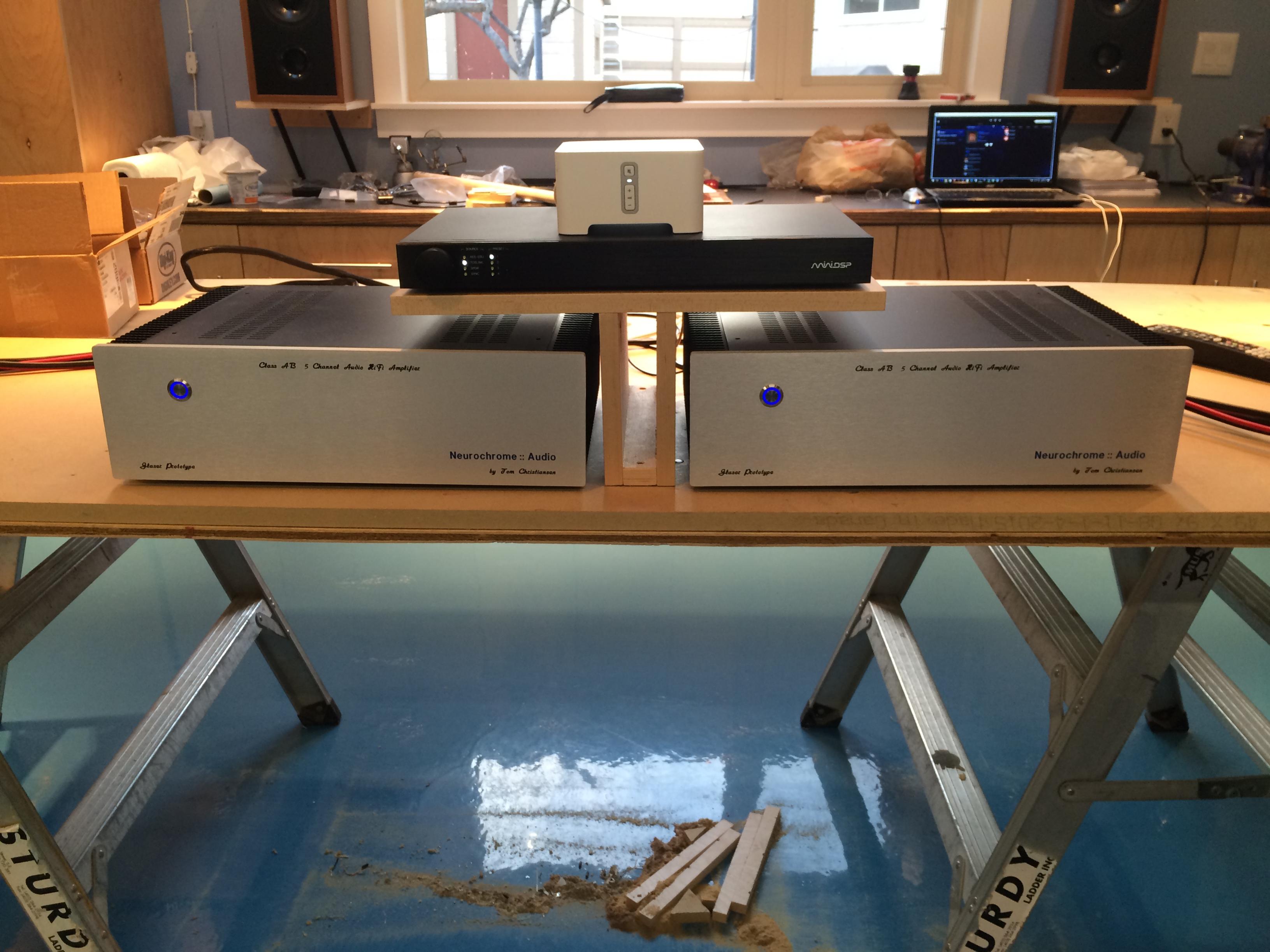

Hi Fellas,

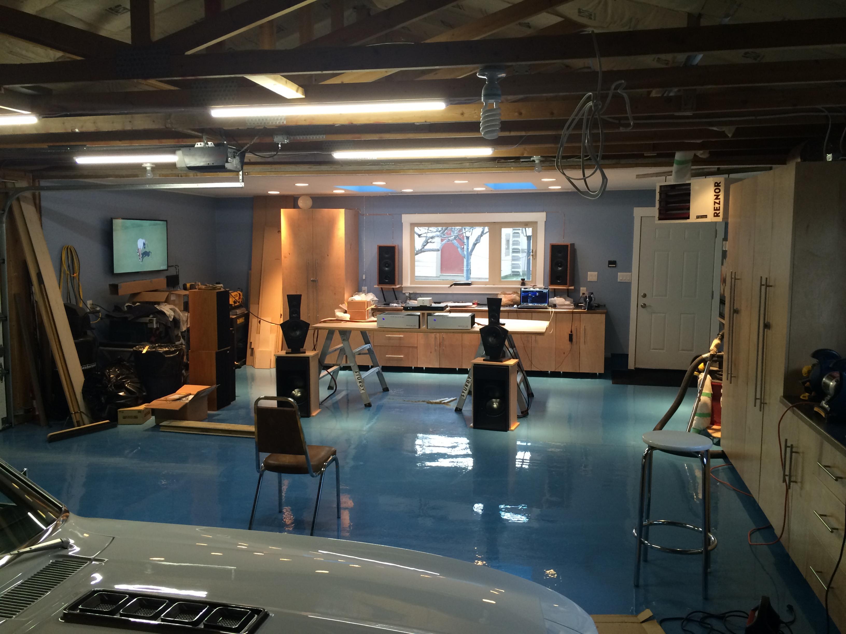

Thought I would share with you my project. I am an EE but zero experience building audio stuff. Always been interested in hifi though since I bought my first system in'78 (Harbeth + Quad 405 ... still have those). So the speakers I was using in my newly built shop had a buzz so I poked around looking for speakers to build. I helped a buddy build a set of KEFs in '76 and they were crap. I had no idea that a person could actually build a good set of speakers today from a kit, but from the various sites and reviews - wow - it sounded like there was some very high quality stuff out there.
So I gravitated to Madison Audio. I built a set of Zaph ZA 5.2s for the deck on my cabin. With a subwoofer - man - those things rock. Then I built a set of SEAS Idunn's for my shop. Those also rock.
My curiosity continued and I saw these bizarre Linkwitz things - the LX Minis. So after spending a lot of time on his site and poking around I decided to build a set of those. I found a used NAD T773 7 x 100W amp for cheap and managed to get it to work with the LX Minis that require 4 channels. Wow - blows my mind how those things sound - just incredible sound from such an odd looking package. My wife even likes them.
So my curiosity continued to build. On the Linkwitz OPLUG forum there is a seeking auditions section - turns out a fellow had a set of LX521's and he lived nearby me. Turned out to be OldMike2 from Canada. So I went to his house. He's got the most unbelievable man-cave home cinema. Better than the Odeon. I don't want to tell you all the stuff Mike has there but holy cow it is impressive. Was it 17 monoblocks Mike? He built all of it too.
So guess who was there the same day ... Tomchr. Ya. So the three of us talked for a while and in the end I decided to build some LX521's and ... some custom amps using Tom's Modulus 86's and Par 86's. Never soldered a thing in my life but how hard could it be?

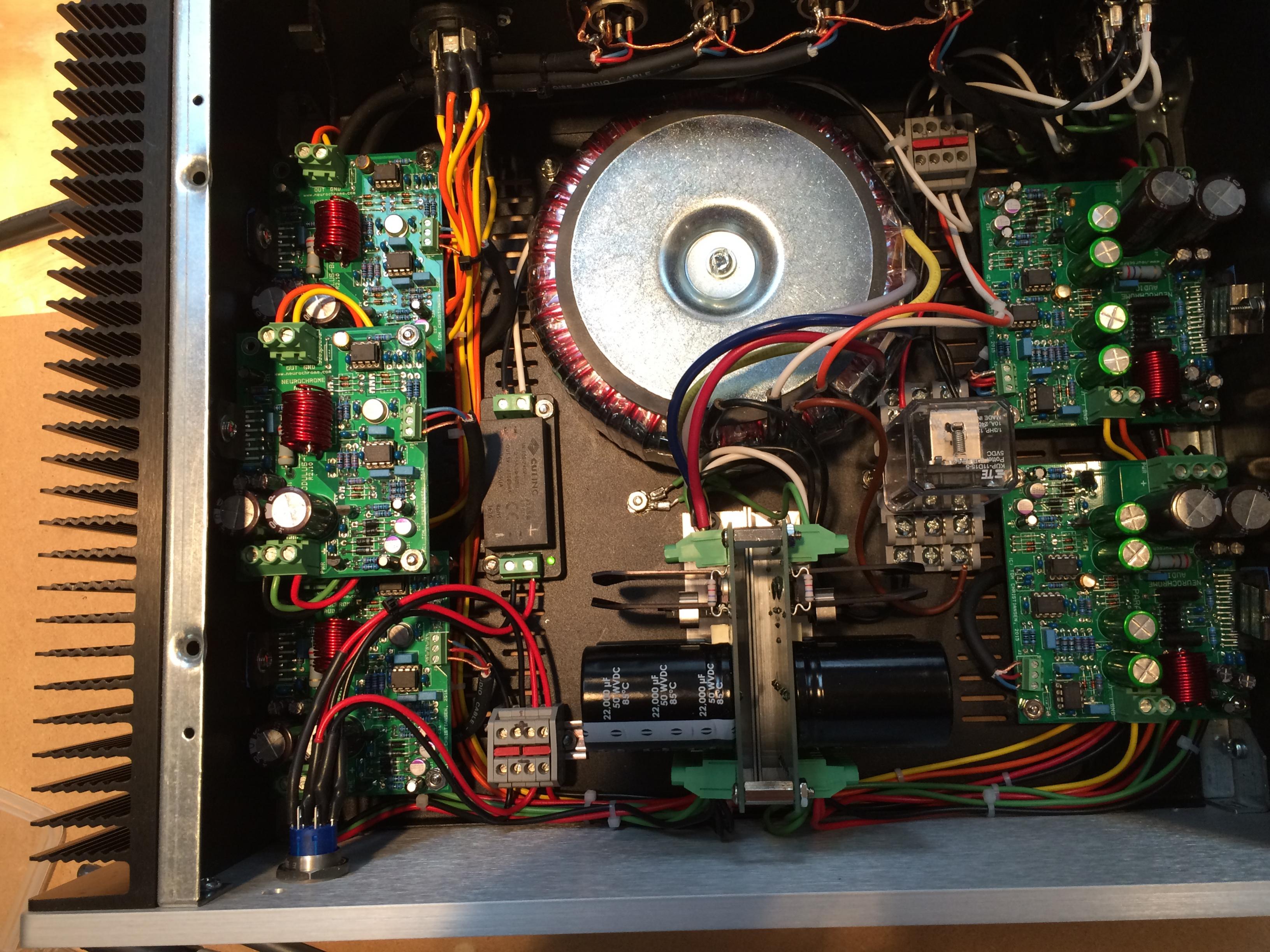

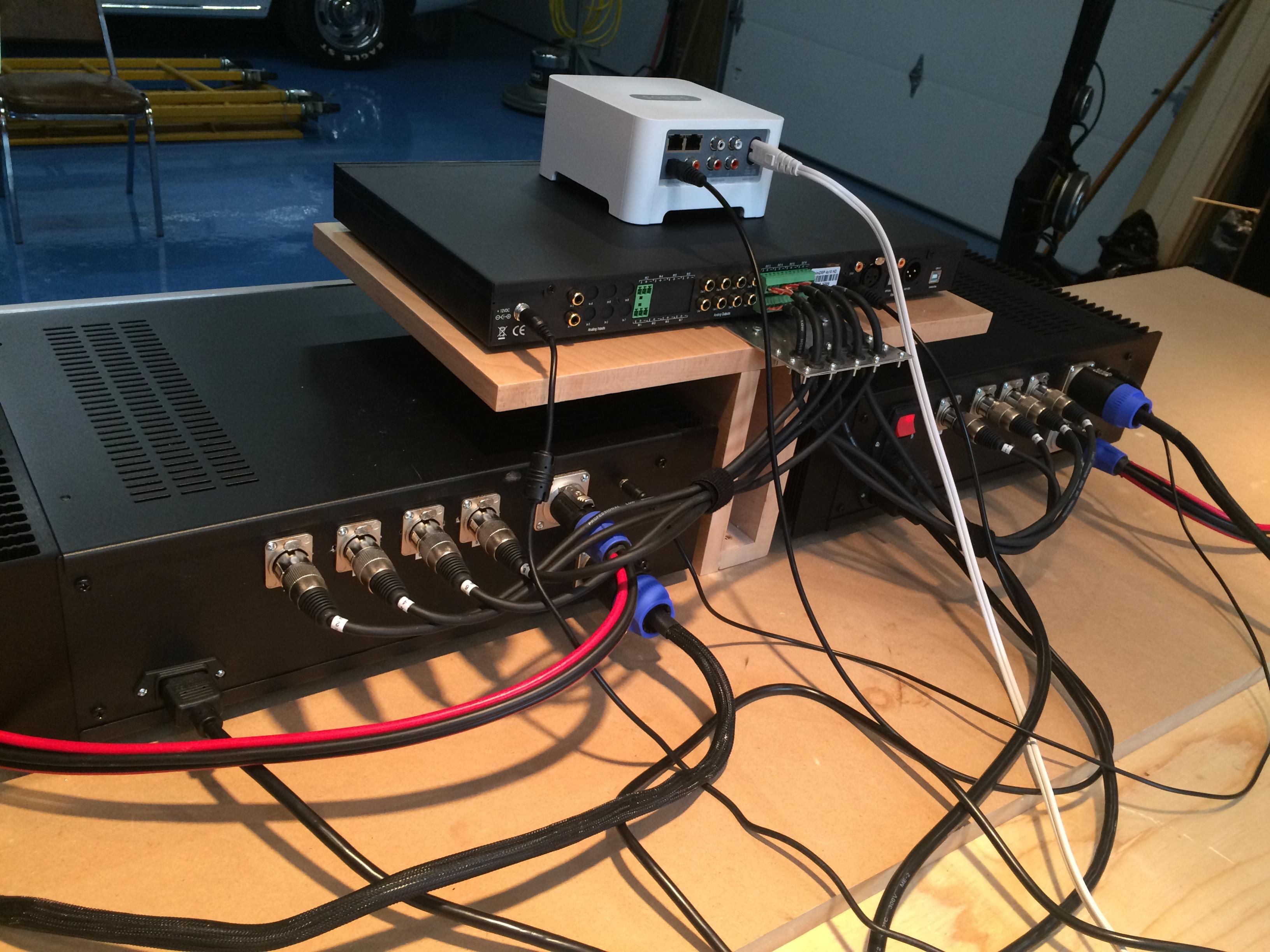

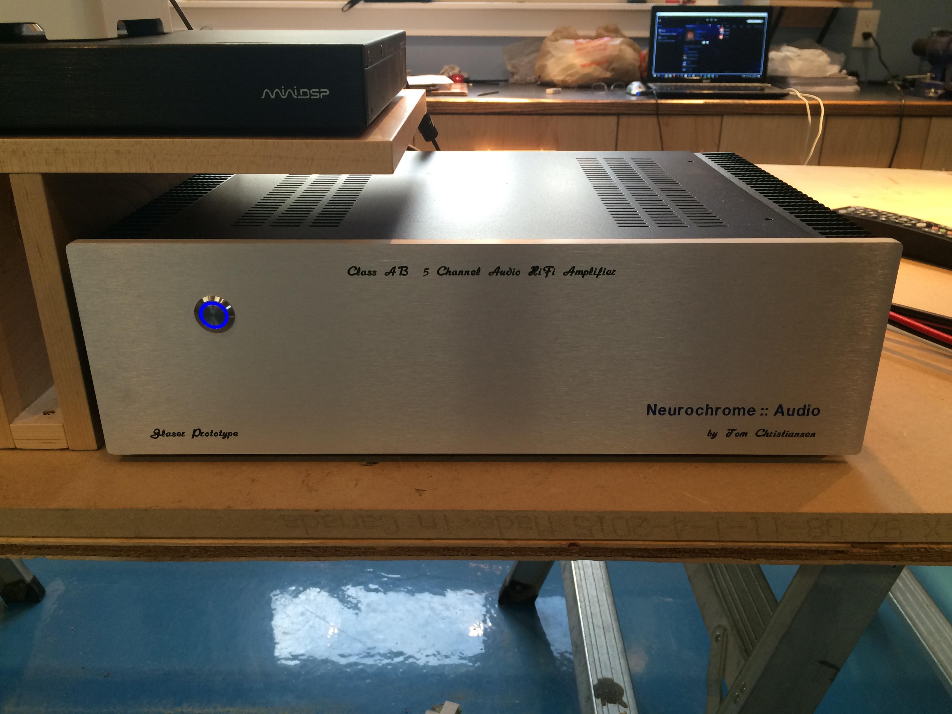

For now my source is Sonos only. It runs through a MiniDSP 4 x 10HD into the amps. The amps are 5 channels apiece. Each amp has three Modulus 86's for the upper LX521 baffles and two Parallel 86's for the woofers. I also used Tom's Pwr 86's for the power supplies. Tom and Mike recommended the chassis from Modushop in Italy - so I bought those too.
The front faceplate on the amp chassis is 1cm brushed aluminum - just plain. I found this place where you can design your front panel and they mill it - frontpanelexpress.com in Seattle. I designed the front panel using their software then shipped the panels to them, then they shipped them back. Turned out real nice. It was about $150US total. You will see from the front panels that I wanted to give Tom some credit for his incredible designs so with his permission I put his name there along with Neurochrome :: Audio. He seemed to like it.
I used balanced XLR connections from the MiniDSP to the amps. I also used Speakon connectors. Very happy I did so. Nothing like good connectors. The balanced connections probably helped achieve a very low sound floor. The system is dead quiet at idle with no hums.
Tom and Mike came over for an audition - and I think they liked. Really, the sound is incredible even with the concrete floor in my shop. The amps are pure, clean and effortless.
By the way, Tom is a half decent goalie too. I had him out a couple times for a senior's hockey team that I run.
Thanks again to Tom and Mike for the inspiration. OK here's the pics.

Thanks for posting, Ed. Nice build! I really like how those front panels came out. Thanks for the credit.
Your attention to detail really shows in the soldering you did on the board. Everything came out nice and clean. I hope those who are doubting their skills take note. 🙂
The Modulus-86/Parallel-86 combo driving the LX521.4 was amazing - even in the garage. I'm glad you got in on the last group buy of the Parallel-86.
Tom
