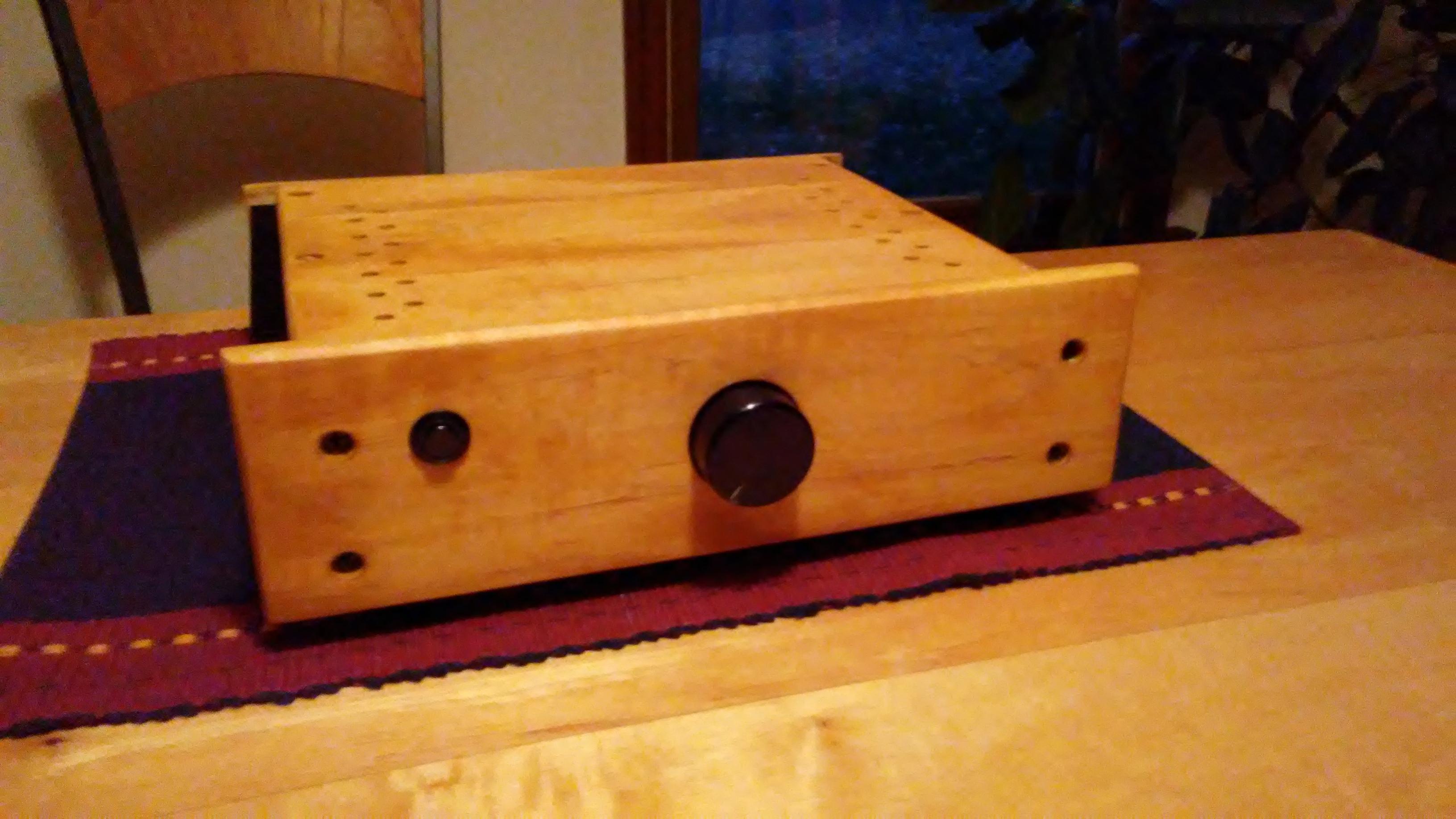

Hum after adding THAT preamplifier
I have been very happy with my Mod 86 for the past couple of years. Recently, I added the THAT preamplifier and a potentiometer to the circuit, and put it in a box. Somewhere in the processs I introduced a low volume buzz into the sound from the speakers.
The buzz appears to be about 420 Hz (crudely measured with a smartphone app), is present when nothing is connected to the inputs, and increases in volume when the volume is raised.
The case is built from wood. Consequently, the potentiometer case is not grounded. Should it be?
The input wires from the RCA plugs at the back to the potentiometer and the THAT board are unshielded. I just twisted them together. Should I use dual conductor shielded cable?
Also, it may be that I got the connection from the THAT board to the Mod 86 wrong. I've connected them as follows: XLR pins 1 & 2 to V+ and V- on the Mod 86 and XLR pin 3 to GND on the Mod 86. Is this correct?
Any suggestions will be appreciated.

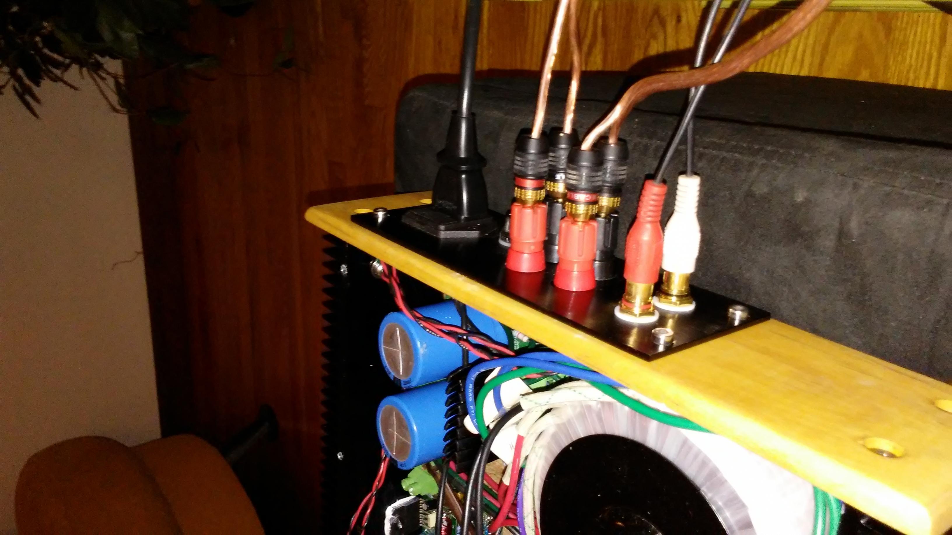

Start by making a grounding plug. Take a regular male XLR cable connector and short pin 1,2,and 3 together. Plug that into the amp input and see if the hum goes away.
If the hum goes away when the input is shorted, the hum issue is further up the signal chain. If the hum remains, it's coming from within the amp.
Tom
Thanks much, kevin and tom, for pointing out the incorrect connection. After fixing the connection, the buzz is still there, though somewhat lower in volume. I tried to do another measurement of the frequency and it showed up as 65Hz this time.
Anything else I could try?
How about posting some close up pictures of your build, particularly the wiring.
Make 100% sure that you do not have cold solder joints of course.
What Tom said is also right on target in figuring out where the hum source is.

Still humming along
Tom
Thanks for the suggestion, Tom. Also, thanks, Anand. Based on the results, described below, I'm thinking the hum is outside the amp case, but I'm not sure how to get rid of it.
The stereo input to the case is supplied by a pair of RCA cables, shown in the photo.
The hum is present when these cables are disconnected.
It's also present when they are plugged in to the amp, but disconnected from the source (a TIVO, incidentally).
The hum is present when the cables are connected at both ends, but the character of the hum is different.
If I disconnect the RCA cables from the amp and short the female RCA inputs on the case, the hum disappears.
If I disconnect the RCA cables at the source (the TIVO) and short the two connectors of the cable, the hum disappears.
The TIVO has a two pin plug, not a three pin plug.
Hope this information leads to some ideas.
