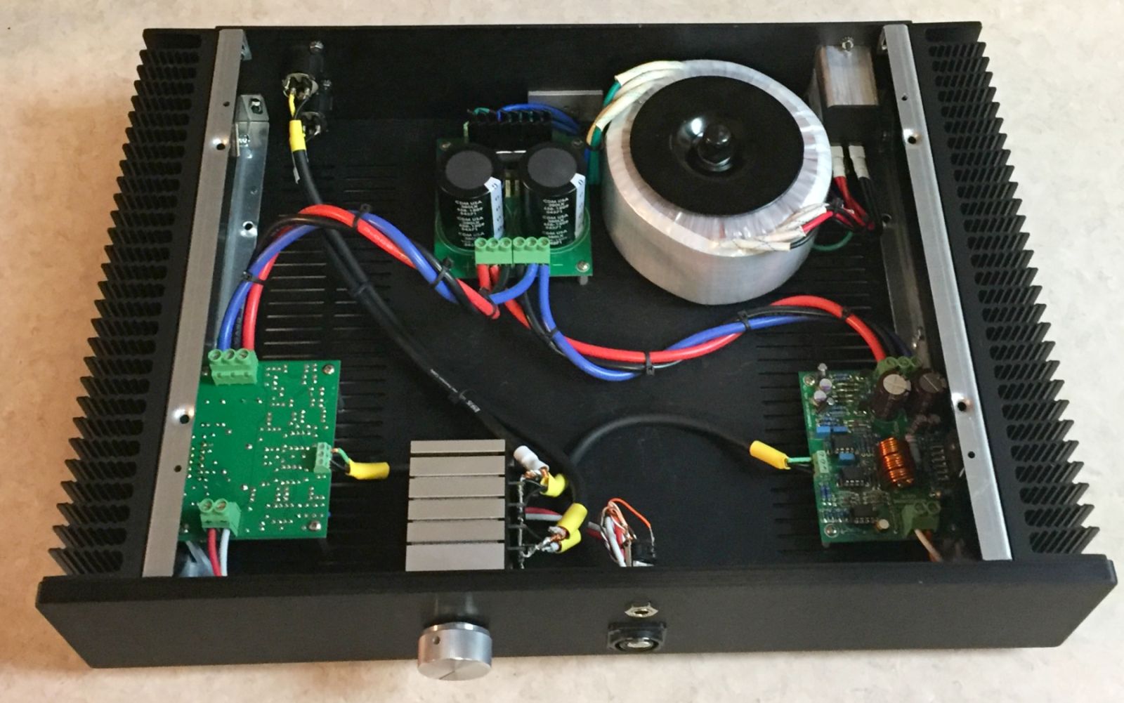

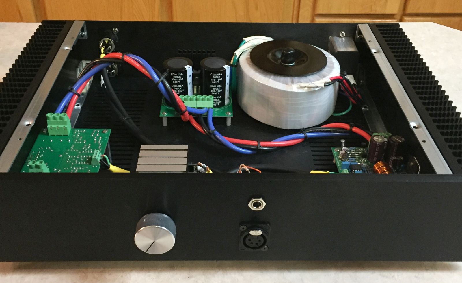

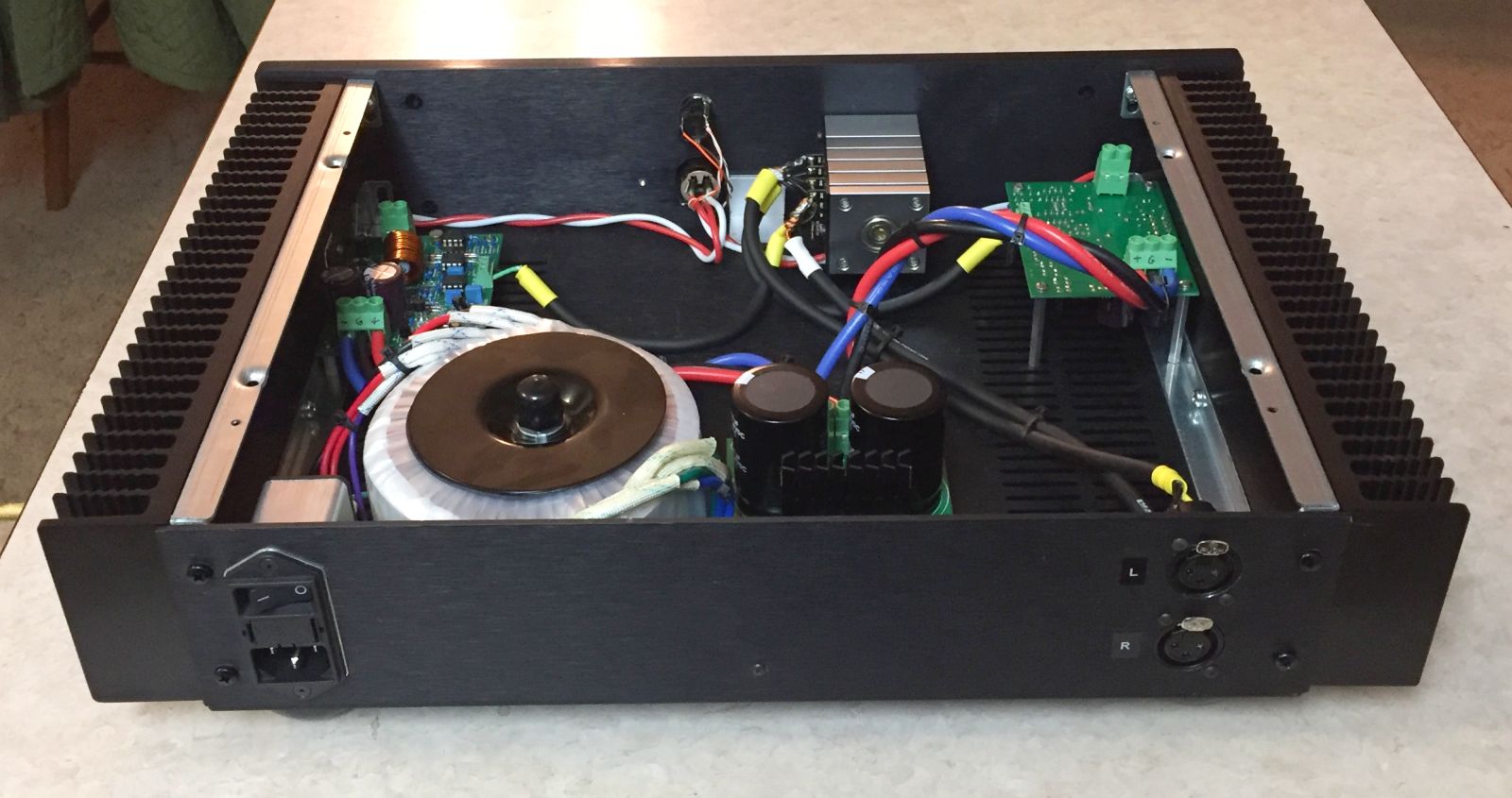

Well, finally got around to stuffing the Mod86 into a box 😀
Yes, I'm one of the few (I've seen one other) using the Mod86 as a headphone amp. Works quite well for the application, actually!
XLR and power inputs on the back. 4 pin XLR and TRS on the front panel along with the volume control. Volume control is a 100k Khozmo 48 step stepped attenuator.
Chassis is the Dissipante 2U
Pics attached...

That's pretty cool! Nice build. Are you running ±28 V on that? Or did you lower the supply voltage to a somewhat saner ±20 V?
±28 V would give you around 10 W into 32 Ω and 1 W into 300 Ω. That's **A LOT** of power for a headphone amp. Careful on the volume knob. 😉
±20 V would give you more like 5 W (32 Ω), 500 mW (300 Ω).
Tom
Tom,
Thanks 🙂 Actually, the rails are sitting at ± 35 V. I was looking for ± 30 V, but transformer choices... So, I ended up with a bit higher. No worries on the volume. LCD 3's are about 9:30 - 10:00 with highly compressed rock (Muse, for example). AKG K7XX actually want a bit more at 10:00-11:00.
The absurd headroom is to attempt to drive the HE-6 to their potential.
Probably could have gotten away with 28 V rails with no problem, but, hey... Why not splurge? 🙂
HE-6 sits at about 2:00 with Muses' Supermassive Black Hole...
And a solid 3:00 with thier Supremacy... Very happy 🙂
