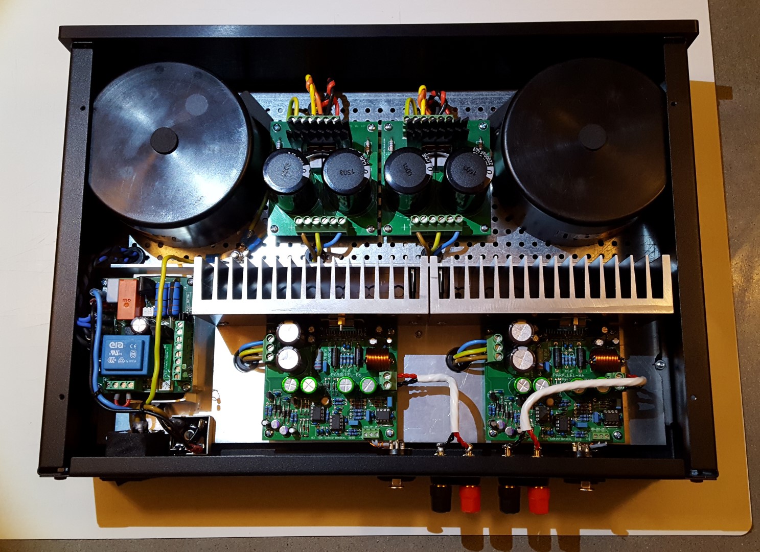

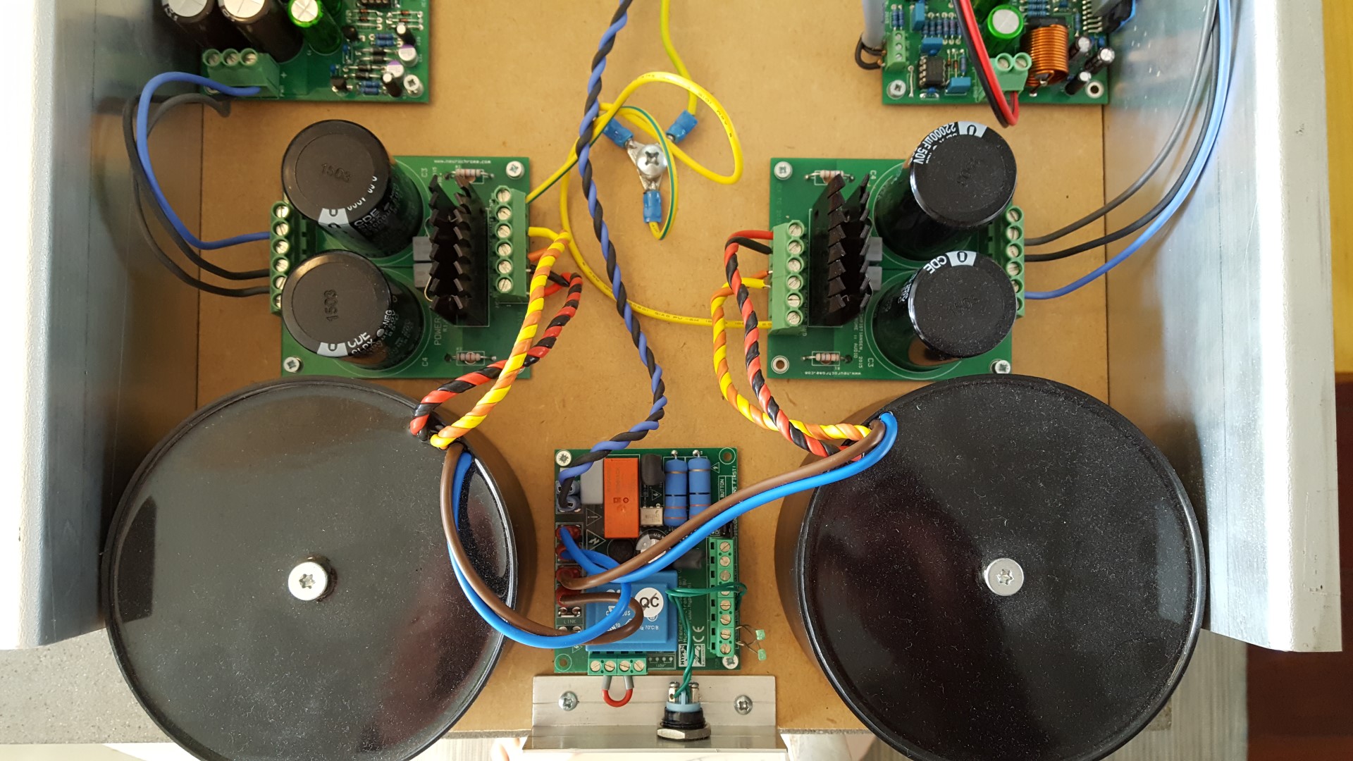

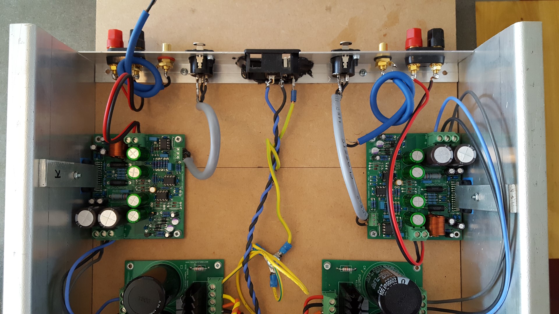

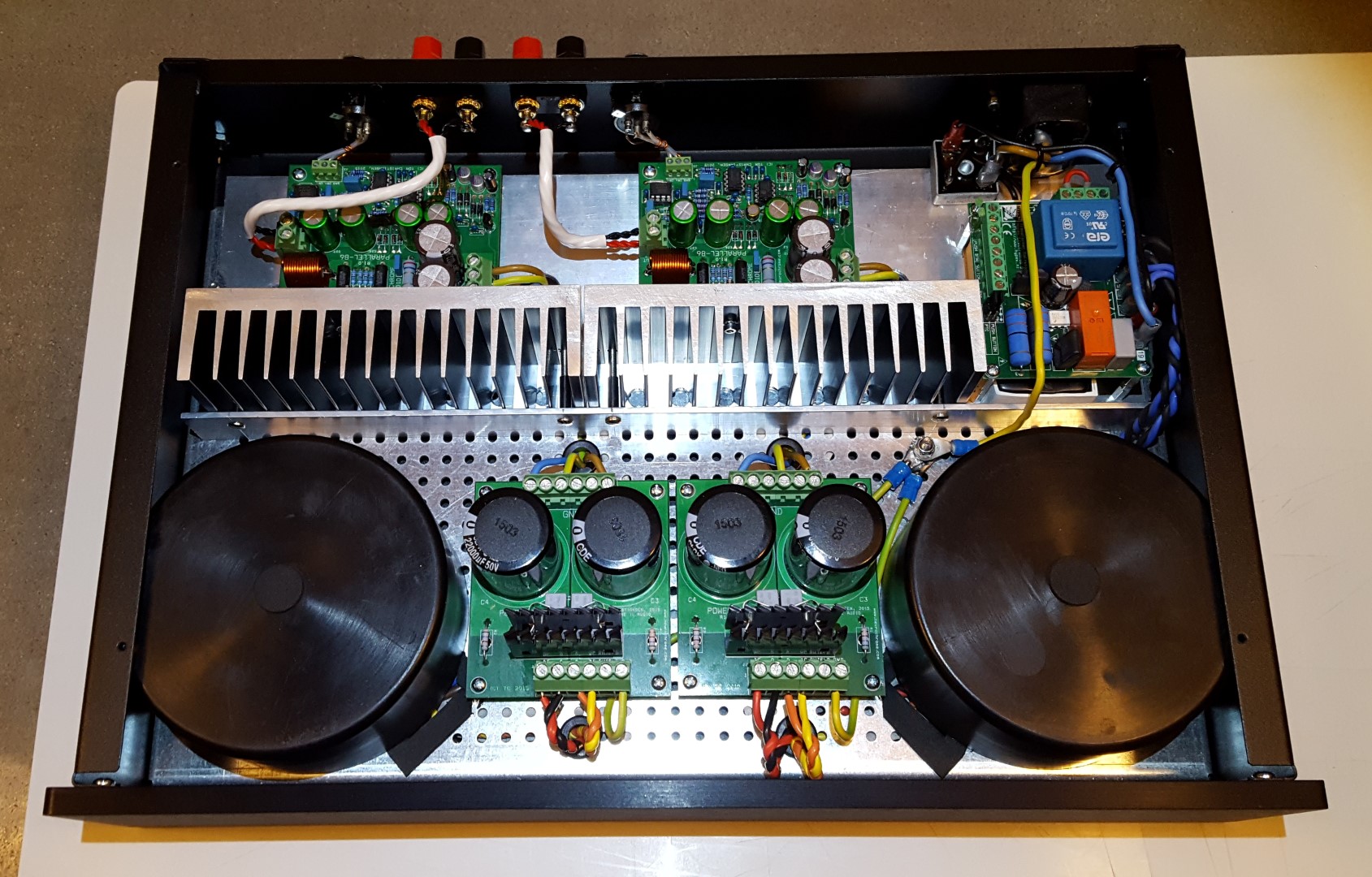

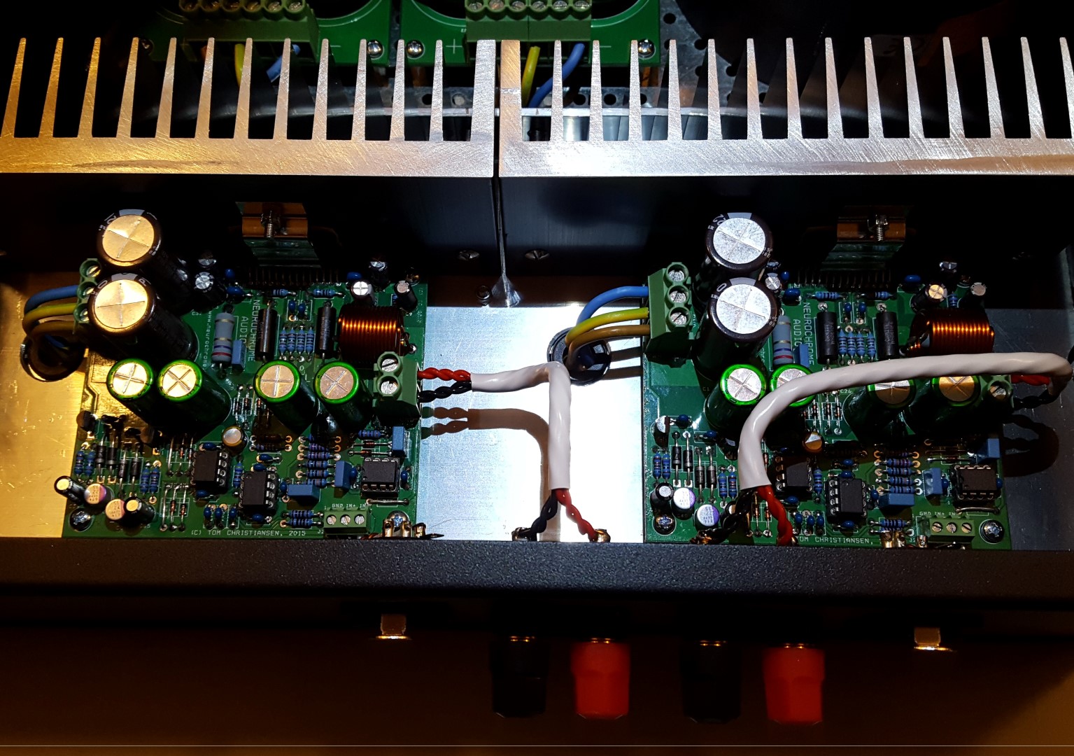

Hi guys,
Going back OT with my build of a Parallel-86. Not many of these in this thread so i thought this might be a nice addition. First to introduce myself; tinkering with electronics since i was 10yrs old. I have been building all sorts of audio related equipment for the past 15yrs. Tube, solid state, amps, pre-amps, dac's, audio streamers etc. etc. Not only because i love music but also because i seem to find a zen like pleasure in building. Have owned all sorts of audio equipment from very expensive to very cheap depending on the monetary situation of my life 😉 Before ordering with Tom i had been reading about his work and design philosophy and got more and more curious. So when my last amp-project for a friend was finished i decided my next build was a Par-86.
As usual i first build/test the amp and ps boards and put the amp together in my regular mock-up. Its basically an MDF board with large heatsinks on the side, a hypex softstart and a backplane with power, se /xlr and speaker posts. Then things slowed down considerably and it's all Tom's fault 😛 Even in it's temporary form with shabby connections it sounded truly amazing and i just started listening to lots of records, alone and with audio friends. Finishing the build got paused for a while...
But eventually i had to put it into a case and finish with better/shorter cable connections etc. I used the well known galaxy enclosure from italy. Simple and clean. I use the additional perforated bottom plate. Most of the power wiring goes underneath to keep things neat and short. The sound quality hasn't changed a bit!
I'm not much of an audio reviewer but here goes anyway. First i integrated the amp into my current audio setup: Roon Audio streamer (diy) - DDDAC 1794 - RelaixedII preamp - Par-86 amp - JM Reynaud Bliss speakers. This turns out to be a match made in heaven. I cannot fault this combination in any way. I have a large music collection in flac format comprising of all sorts of genres, classical - jazz - soul - pop - metal - electronic. Using my usual set of test flac's this amp just does it's job without adding or leaving out anything. Bass is supertight, mids are fluent and engaging (female vocals are magic) highs are extended without being harsh. In short; a well balanced cohesive sound which reveals a lot without being analytical. I simply enjoy it, it puts my music front and center. What it's all about for me. This could honestly be my last amp without being sad about it. (my arcam is up for sale)
Currently the amp is on tour (i hope i get it back😉) with some of my friends who are all in love with it! Some of them own serious audio kit including Naim pre/power, Classe and Devialet. I guess it proves my point that most of the money you pay with the name brands goes into marketing and the bling-bling of the enclosure (milled from one piece of unobtainium blahblah). With the design Tom made it seems to be the opposite. I salute you and thanks.

😱 Fantastic build dude...wow...A++++
Kudos & enjoy the fruits of your labor
Thanks for the nudge. 🙂
That is a very nice build indeed.
Very cool. I'm glad you like it.
You're welcome. Thanks for sharing your build pictures.

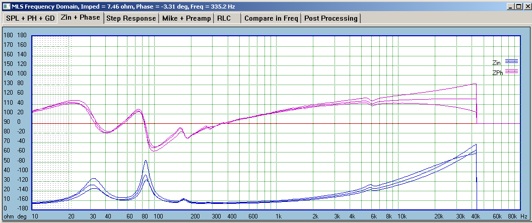

I have not really compared whether coiled cable in different direction are audible or not, only did measurements. When both hot and return leads are coiled in the same direction, the measured impedance amplitude and phase of the driver would change, either increase or decrease above a certain frequency; however, when each coiled in opposite directions, this will not happen.

I happened to have some data with me, so I looked into some.Would you post a link to those measurements?
Tom
Three conditions for the speaker internal wire coiling, one with both live and return counter clockwise, one when both clockwise, and one with both coiled in opposite directions.
The enclosures have some different damping characteristics, but this was just a quick and dirty comparison as part of other efforts.
I don't recall any capability to simulate this in spice, but it would be interesting if possible.
What you're describing would have enormous impact for RF engineers. No RF circuits would work if the wires coiled the wrong way. Are you sure you aren't chasing a ghost in your measurement setup?
20 dB difference at 20 kHz from the direction of a wire coil is absurd.

You mean you had physically seperated wires (that is, not a twisted pair and close to zero mutual coupling) with arbitrary and unknown amount of coiling in each wire?Three conditions for the speaker internal wire coiling, one with both live and return counter clockwise, one when both clockwise, and one with both coiled in opposite directions.
I would suspect that all you found is that wires coiled up have inductance that depends on geometry. Unless you are controlling variables tightly (the exact geometry of both wire routings) no way you will see the same total inductance in repeated measurement.
Orientation of the corkscrew/coil pattern in each wire does not have any influence once this is the only variable, try it and you will see. Or course you should short out the driver (another point of getting rid of variables not needed for the subject of evaluation).

Those are impedance curves. I was surprised myself, that is why different directions were slipped in just to see what would happen. Which led me to wonder about amplifier output inductors.

Not really intentionally controlled, but the number of turns on each side are the same, I would say the c-c distance between the corkscrews winding is around 120mm and the diameter of each would probably be 50mm. These are stiff wiring.
This was really not part of the original plan, but since it happened it just made me wonder. Maybe I will explore this more some other time.
