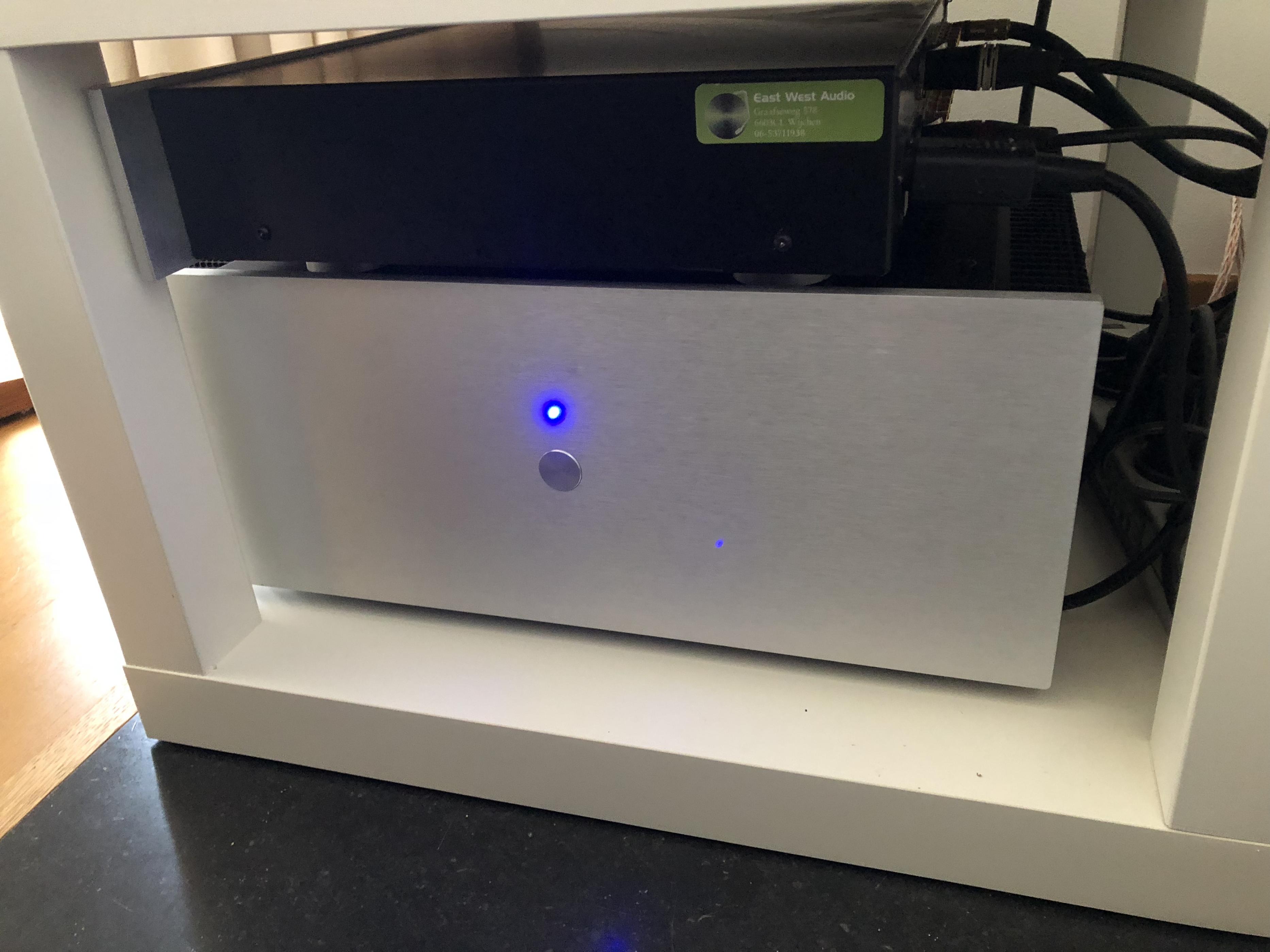

Holy crap! What a superb build with execution! Really happy and proud of you! Enjoy the fruits of your efforts and get yourself a serious dac!

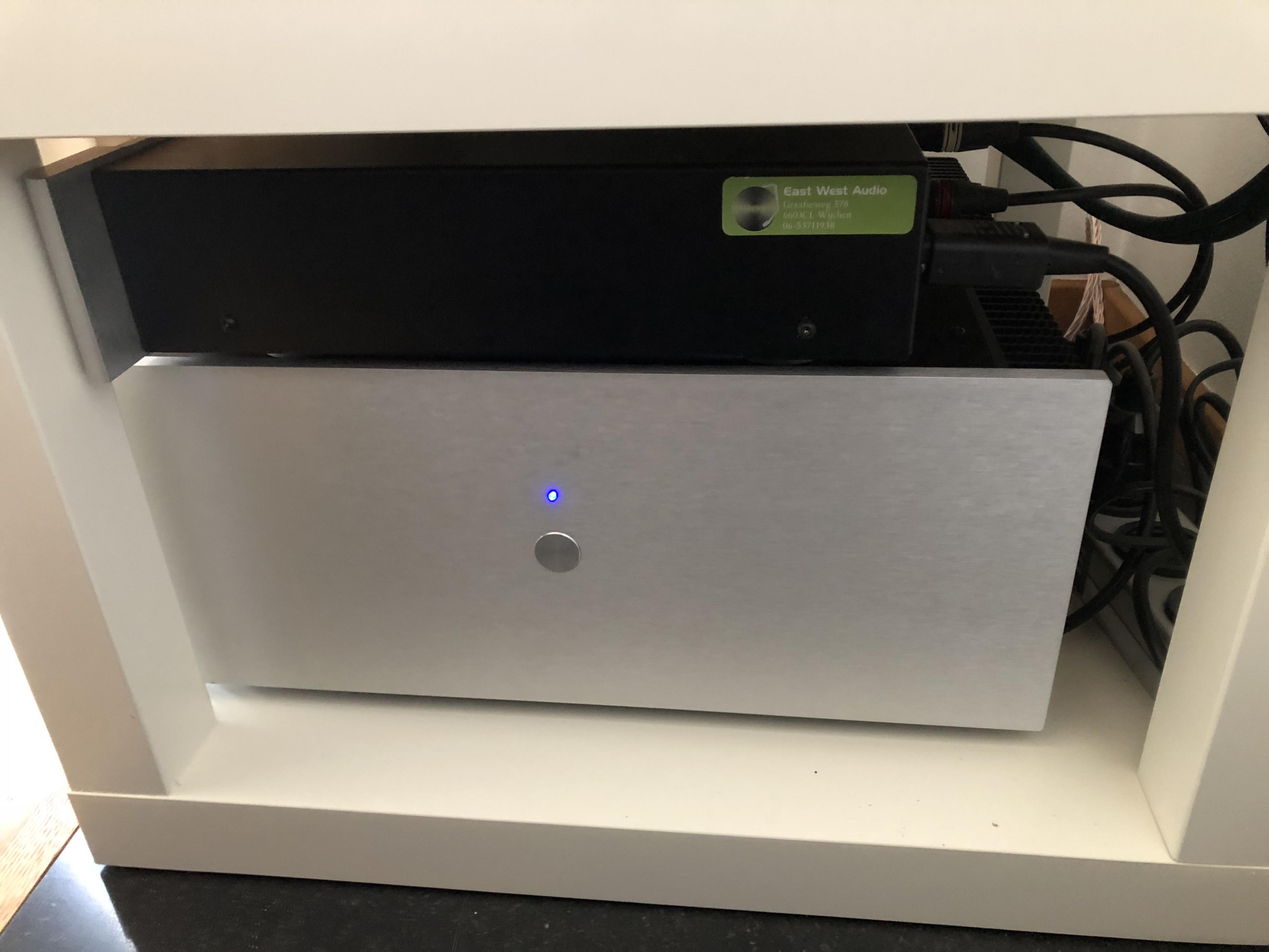

Do you mind posting a pic with the power on?
Best,
Anand.
The amp is in a temporary enclosure but i’ve made two pics:
- one in standby
- one with the amp on
But i must say the blue led doesn’t show well on the pictures

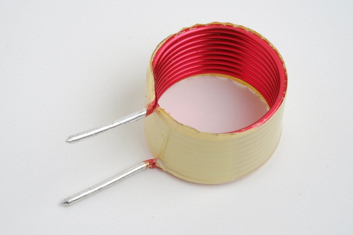

Any issue with us making our own inductors? I will have quite a bit of magnet wire left over after I build the inductors for my Mod86 boards.
If I remember correctly, Tom has specs for the coils in his construction manual. Winding them is a bit of a pain, but still readily done.
Make a couple of practice inductors you intend to discard, before starting on the for-real, it-goes-in-the-audio-equipment inductors.
Teach yourself how to wind tightly on the coil former you've chosen. Teach yourself how to secure the windings while still on the coil former, so they don't flop apart when removed from the former. If you choose an adhesive, be sure it's rated to operate at a temperature above 105C without deforming or losing its "grip" or catching fire. Same recommendation if you choose an adhesive tape.
Teach yourself how much wire you'll need to wind the coil. Teach yourself how to remove the insulation from the ends of the wire, all 360 degrees around the wire, so it can be soldered in place. Teach yourself how to do this without deforming the coil in the process.
Then measure a practice coil on an LCR meter and verify you're getting what you expect from those Wheeler Inductance Calculator websites that amateur radio operators have helpfully sprinkled around the web.
Then make the coils you need for your actual audio build. Consider making a couple of extras, spares which you store in pill bottles so they won't be deformed by the weight of other random junk in your Spare Parts box.

Now you know why I chose to sink money into having inductors professionally wound. You can find them on my website: Output Inductor
If you'd rather wind your own, I suggest winding about twice the number of turns you need. At least for me, the last turns always turn out better than the first. Then just unspool the unneeded turns by pulling on the wire and letting the inductor rotate around the coil former. It works well enough.
I've built quite a few Modulus-86 boards through the years and consistently find that winding the inductors takes about one third to half of the total build time. So I chose to outsource that.

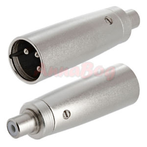

You could also use a Neutrik combo connector in lieu of a switch. Only one type could be used at a time. This is what I am planning to use.
That's still a balanced connector. The TRS plug connects the Tip, Ring, and Sleeve to the XLR pins. You'd have to use a 1/4" phone jack rather than an RCA.

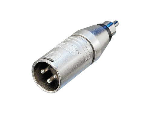

If you're using an adaptor, I suggest using a male RCA to male XLR adapter. That'll convert to XLR at the source and allow you to run an XLR cable from there to the amp. That'd replicate the pseudo-differential cable. The Neutrik NA2MPMM is an example.
I really dislike RCA connectors. 🙂
I'm not a fan either. There are so many crappy RCA connectors out there - and the cost of the connector is often not an indicator of quality. The best RCA connectors I've found to date are the Neutrik ones.

Winding the inductors is not as complex as Mark intimates. Tom tells you what to wind on (a AA battery. last time I checked) and how many turns of what gauge. Yes, it's worth doing a couple practice runs to get the hang of it. There's no reason to hunt down an LCR bridge to measure. The exact value of the inductor is not that critical and the laws of physics dictate it based on the physical dimensions. If you get the right number of turns of the correct gauge wire around the battery and those turns are reasonably 'tight' to each other and fit between the mounting holes on the PCB, you should be just fine.
Yes, it is somewhat of a hassle and takes a little manual dexterity. If you do more than a couple, you may come up with a few tricks to get them more uniform. But, this is DIY after all! Yes, your coil may not look as beautiful as Tom's pre-made ones (which are a good value), but will be entirely serviceable.
Combo Jacks also can use TS (Tip-Shield) plugs which are unbalanced. I like the 1/4" phono jacks much better than RCA's. I have to every so often jiggle the RCA connectors to make contact from my Marantz AVR to my ACA amps because I lost a signal from one of my channels.
I was planning on using those Neutrik RCA panel connectors on my phono preamp.
In PA applications, I've learned to intensely dislike those neutrik adapters (as well as the xlr-jack ones). They're not only very heavy by themselves, which is not good for the panel mounted connectors, they are also long (when combined to another xlr connector) and create a nice lever effect if you hit them, easily damaging stuff. Much better to have properly terminated cables. They won't cost you any more than those neutrik adapters anyway.
I find it's actually pretty easy to wind coils number 7 thru 15, after discovering pitfalls and learning techniques on coils 1 thru 6. I recommend asking yourself: what tool do I wish I owned, to perform the step I'm doing right now? Then buy that tool. Move on to the next step and repeat the question. Same goes for toolrests, workpiece supports, vise jaw slippers, little well-shaped jigs, and so on. What 3D mechanical shape do you wish you had, to make this step easier? Then fabricate that, or feces-bodge up a close approximation from handy bits already on the bench.
Yeah. There is that. I mostly use adapters for testing.
I wholeheartedly agree.

Winding the inductors is not as complex as Mark intimates. [...]
All true. It took me a few years of building Modulus boards before I finally had enough of winding coils. Also, for the professionally assembled modules, I need to provide my assembly house with components. Delivering a spool of wire and coil former won't go over well. Or maybe it will. They'll just charge more. 🙂

Finally i completed the last things in my build of the Modulus 686 and it is time to share some pictures and experiences.
Thank you very much for posting. It looks like a very nice build. I'm glad it came together nicely despite hitting the Mean Well 'speed bump' along the way.
