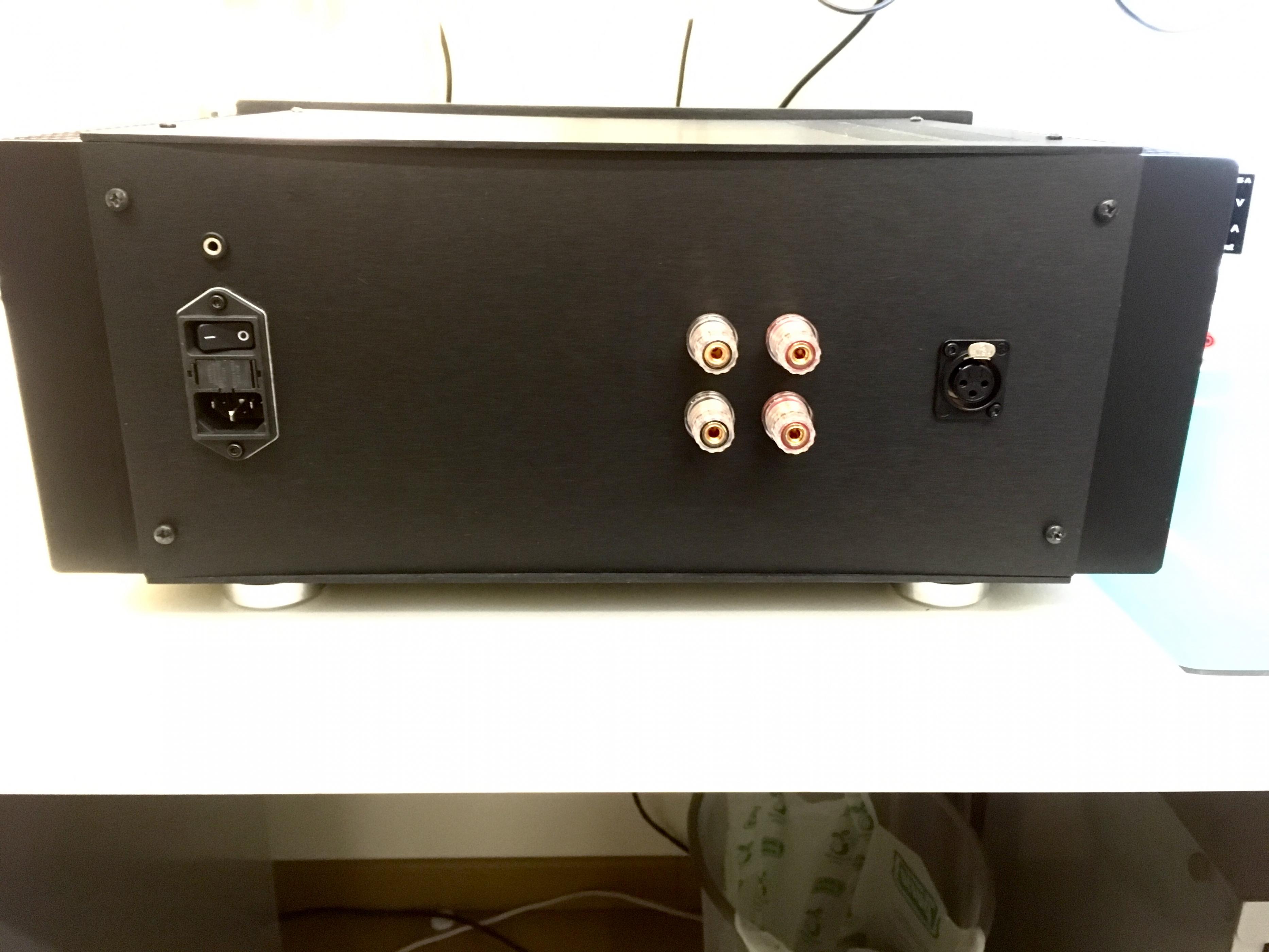

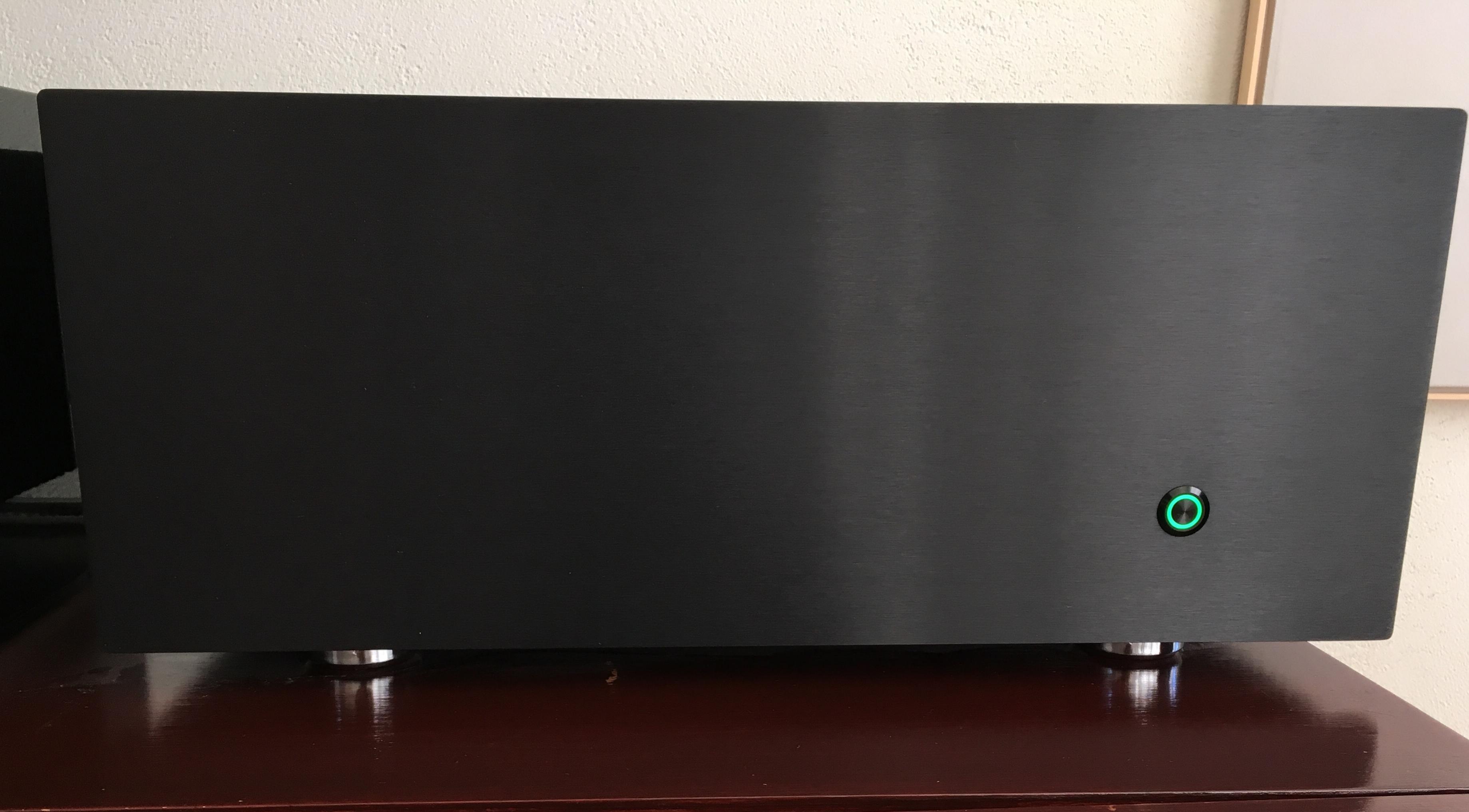

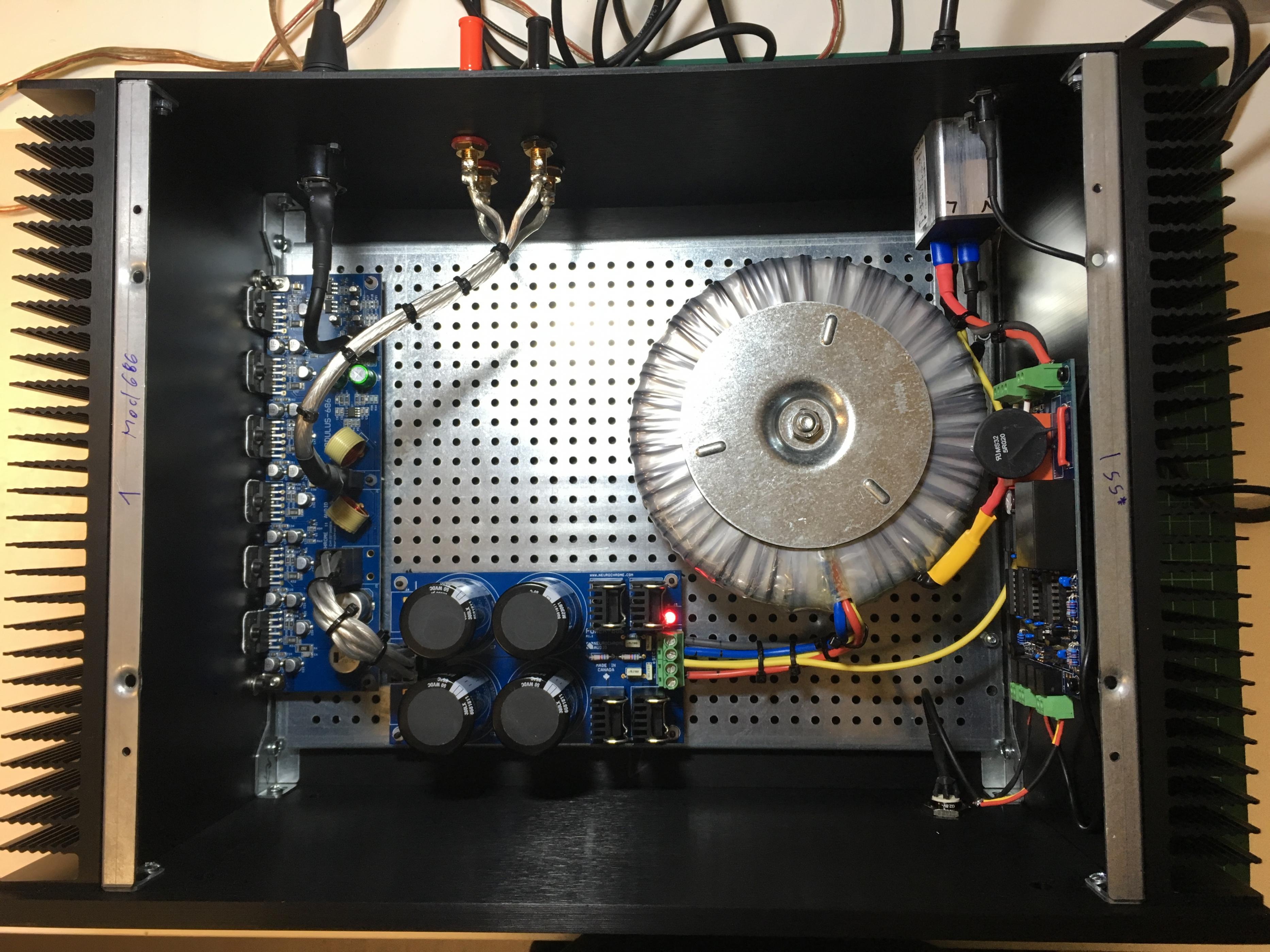

Here are my new addition to the family - two new Mod686s. Finally ready and making some wonderful music. I have built two monoblocks, each using a 800VA, 2x25VAC Amplimo toroid, a Neurochrome ISS softstart to get the beast going and a Power686 (2x36VDC)linear power supply. All that tamed inside a Modushop 4U Dissipante housing. The 6DMF powerswitch awakens the whole thing from its standby mode, while switching the LED ring from red to green. Alternatively the backside contains a 3.5mm phono plug for the 12V remote start trigger signal. See pics below. Each Mod686 operates in the 20dB gain setting with the lower noise floor and is being fed by the Auralic Altair providing up to 4Vrms via balanced XLRs. This gets me a maximum of 200Wrms into 8ohms - plentiful I would say for the KEF R700s speakers (to be replaced by the Reference 5 soon - which was the motivation for the additional power and current capability of the Mod686 vs the existing Mod286s). .
If you like, I’d be happy to share first (subjective) listening impressions in comparison to my two Mod286 monoblocks (also 20dB gain) once I had some time listening more intensely.
That is a super nice build you have there! Congratulations on a job well done. I especially like how you have all exposed connections (input connector, AC mains inlet, etc.) covered in heat shrink. It also looks like you've minimized the routing and loop areas of the various connections. Excellent!
The low-mounted, off-centre power switch is a nice aesthetic touch.

It'd be nice to find an easy way to let the other heatsink participate, at least a little bit. (the one on the right side of photo3 post844).
On the theory that mass transfer is often more efficient than heat transfer, a copper slug on the left that transfers heat from the left heatsink to serpentine water tubes, which pump water to a copper slug on the right with its own serpentine water tubes. Hot water flows from left to right, heat gets transferred to right heatsink, cold(er) water flows from right to left.
Or else just a big aluminum bar straight across the chassis, bolted to both heatsinks.
True. Though, the 4U heat sink is sufficient for one channel of Modulus-686 on ±36 V, so I'm not overly concerned.
I must admit that I got a pretty good chuckle out of this. Now we just need an aquarium pump to circulate the water. It'll have to be an audiophile aquarium pump, of course ... with its own regulated power supply. Preferably also with a temperature dependent speed controller to avoid any noise.
On a more serious note: Water is certainly a good medium for heat transfer and one could likely borrow much of the pumps, tubing, and hardware from the water cooling of PCs. I'd personally hesitate to include water cooling unless it was absolutely necessary. I don't see any reason to include a corrosive liquid and another source of failure, but it can certainly be implemented.
An alternative would be to use heat pipes to connect the two heat sinks. They work by condensation and evaporation of a substance within the tubes themselves. You can buy them from Mouser/Digikey/et al. and they're actually not all that expensive. From what I understand, they can be a bit hard to work with (the copper tube is really thin-walled), so if going that route, I'd suggest approaching one of the many "pimp my PC" computer customization places and have them form the heat pipes. I'd also implement some sort of coupler that would allow from some slop in the heat sink to heat sink distance as the ModuShop chassis isn't exactly machined to the micron tolerance levels.
In reality, however, I generally find that there's quite a bit of thermal conduction through the front panel as well as top and bottom panels. Obviously, the heat sink with the amp on it will be warmer, but the other heat sink gets to participate a bit too - even without fancy coupling shenanigans.
Interesting thought, though.
If you wanted to make a complete mess, you could also seal all openings in the chassis and fill it with mineral oil... Yes. I have seen that done on some $50k amplifier. Just because! Just saying.
Tom

Why did I build monos? Just because. I guess I just liked the idea of having completely separated amps and short speaker cables and it looks cool doesn’t it ;-)
I like the Aquarium idea - put some tasty fish in it and when you’re hungry just crank up the volume to cook. ;-)
This is the BOM for one monoblock. Sorry I hope it formats ok as I tried to copy it over from xls which I couldn’t attach here.
Total cost for two monoblocks ca 2.000EUR, ca. 2.300USD just so new builders get an idea what to budget. However compare that to commercially available amps. Granted with commercial amps you cannot screw up during your build and you get warranty, but I guess as long as Tom is around that isn’t a real concern.
