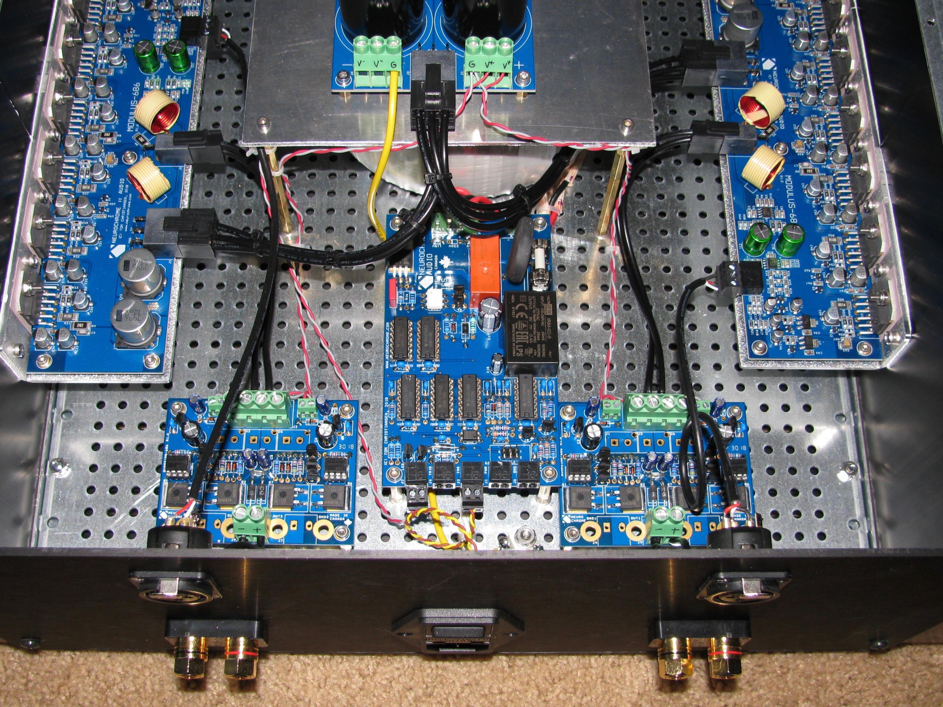

Pictures of my new build
Just wanted to post a few pictures of my new Modulus-686 build.
Thanks to Tom for the great amplifier!

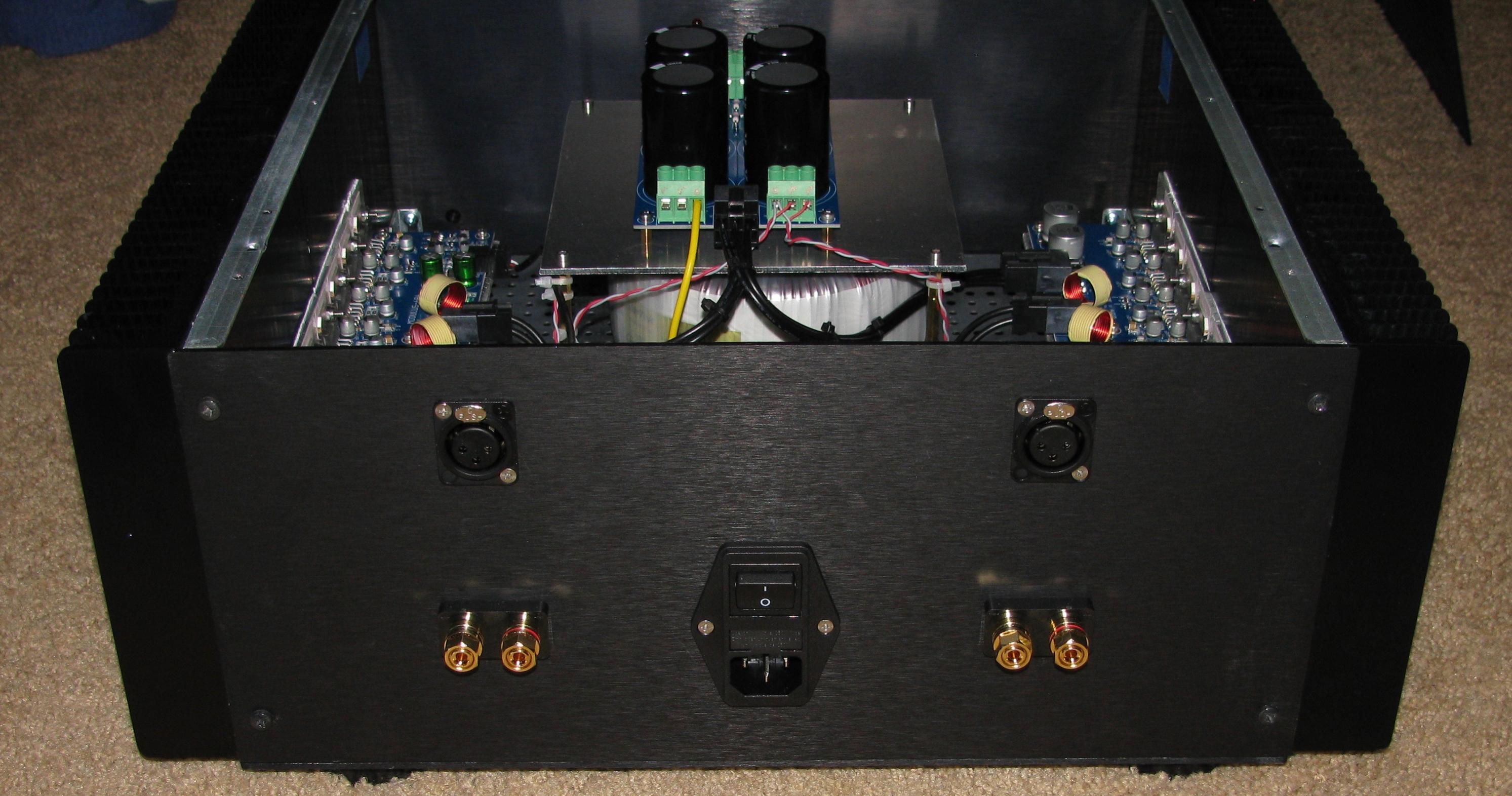

Dissipante 5U x 400 chassis
ISS into Power 686 with Antek 25v 600VA transformer (had it already, no need in my system for the full 800VA)

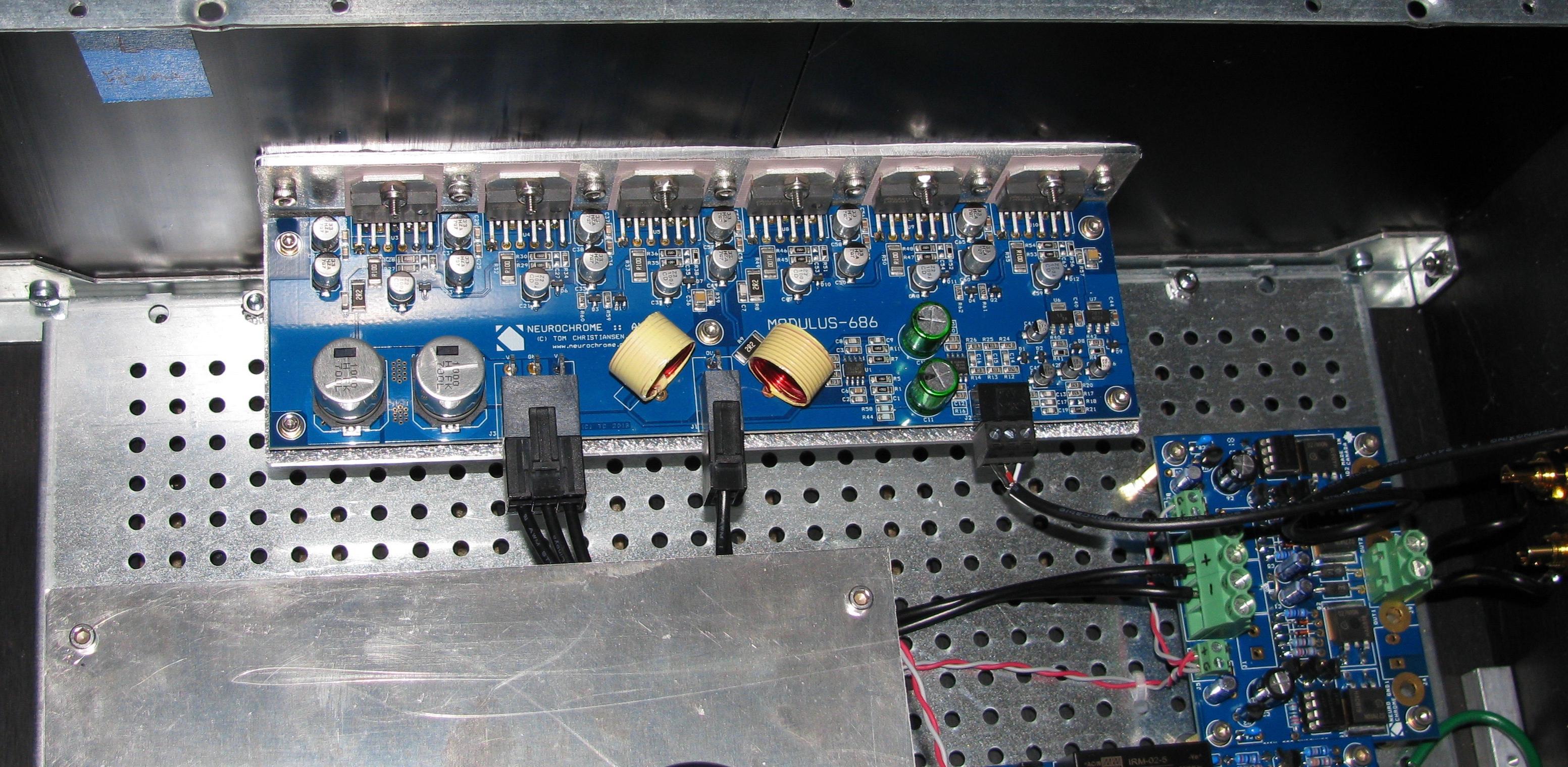

Original style mounting brackets with metal backed LM3886s.

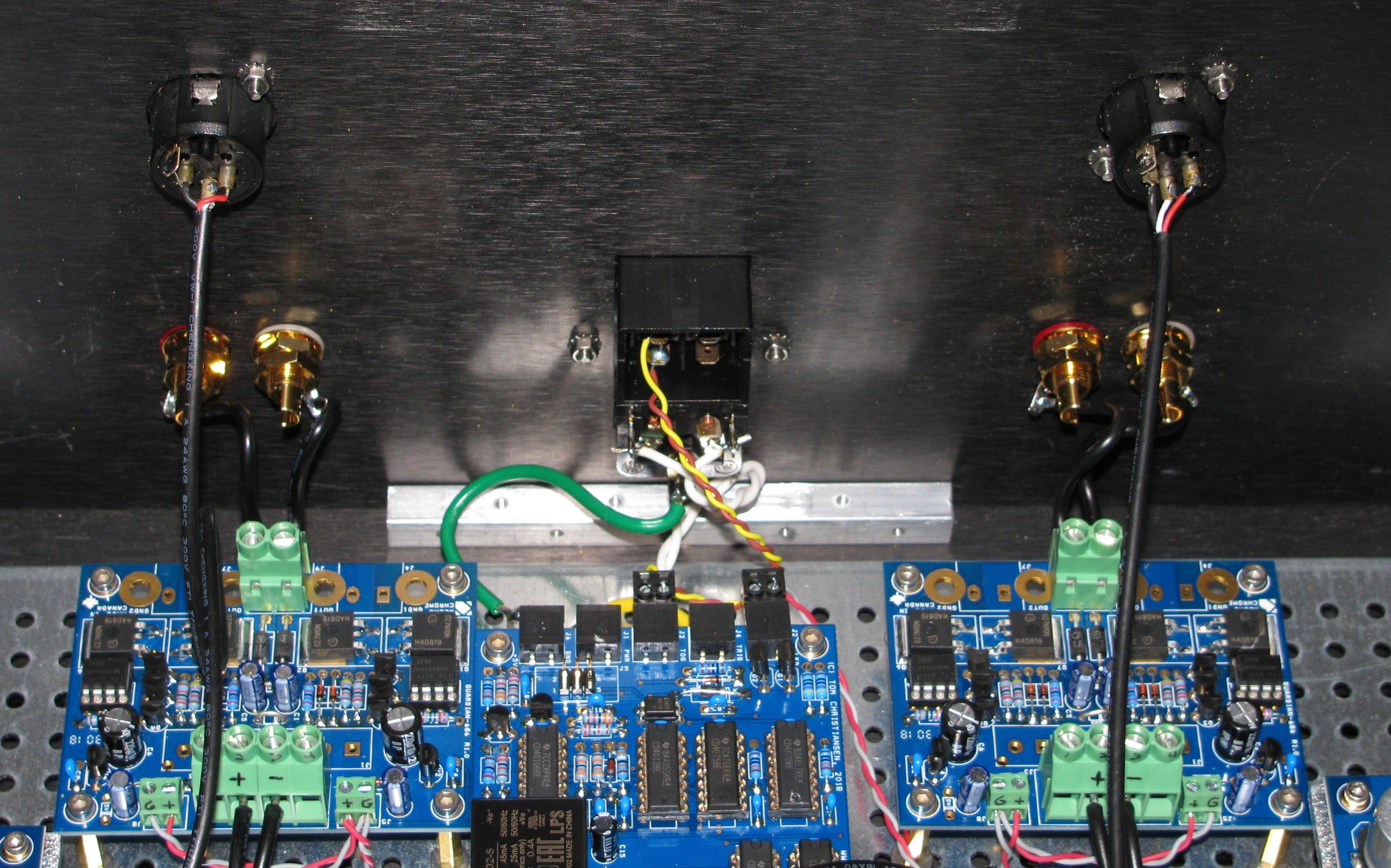

Standard 16ga wiring, Guardian 686 boards.
All boards tested perfectly and the amp fired up first time without a hiccup.
Compared to my Modulus 86 it is just a quiet, but seems to have just that little bit more authority I was looking for.
It seems it was a good idea to go with the standard power supply in the 686, rather than the Meanwells I used in the 86 build.
Matt
Very cool. Thank you for sharing. I'm glad you like it.
Good choice. Pretty packed too. It's nice to see the full ISS+PWR686+MOD686+Guardian-686 in action. Nice touch with the mezzanine plate atop the transformer too.
If you haven't already, you might want to add a little heat shrink on the mains connections of the IEC inlet. That's a rather small detail, though. Nice build!
That's awesome. Just the way I like it.
Tom
