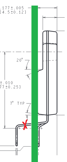

Is there a layout where the 686 board can mount parallel to the heatsink?
Not really. The LM3886 sits perpendicular to the board. I do know of one build where the builder bent all the leads to allow the PCB to be mounted parallel to the heat sink, but that's not something I'd recommend.
[...]wondering if such layout can allow 4 of these modules+heatsinks to be placed inside a single enclosure for a 4 CH amp.
It's not a matter of physically fitting the boards in the box. Two MOD686es will physically fit on a 4U heat sink. They'll just overheat as a 4U heat sink doesn't have a low enough thermal resistance to get rid of the heat.

Just as info, I've spotted one build with an interesting trick to mount the lm3886 // to the pcb without any leg bending: JLM Audio Shop (you have to cut the leads though).Not really. The LM3886 sits perpendicular to the board. I do know of one build where the builder bent all the leads to allow the PCB to be mounted parallel to the heat sink, but that's not something I'd recommend.
It's a pretty trick because, looking at the package, the leads from the back row are indeed flat with the body. So no need for bending.
That is a neat trick. I also like how they use the back row of holes both for the horizontal mount and the vertical mount. Very neat.
I don't like that they require you to cut pins off of the LM3886, though. That's expensive in production!
Look again! The back row of pins are bent close to the IC package and hit the holes in the regular PCB footprint. Then the front row of pins are bent flat against the board to hit the oblong pads.
Mmm we might label back and front differently... To be clearer, it looks to me that pins 1-3-5-7-9-11 are just cut and stuck in their normal row of holes. Then the pins 4-8-10 naturally fall on the oblong pads. There might be a tiny bit of bending needed so that the odd numbered pins are hitting the holes with the proper 90° angle.
This being said, you're right. It's labor intensive and I wouldn't suggest it in a production amp. Just a little bit of lm3886 trivia.
