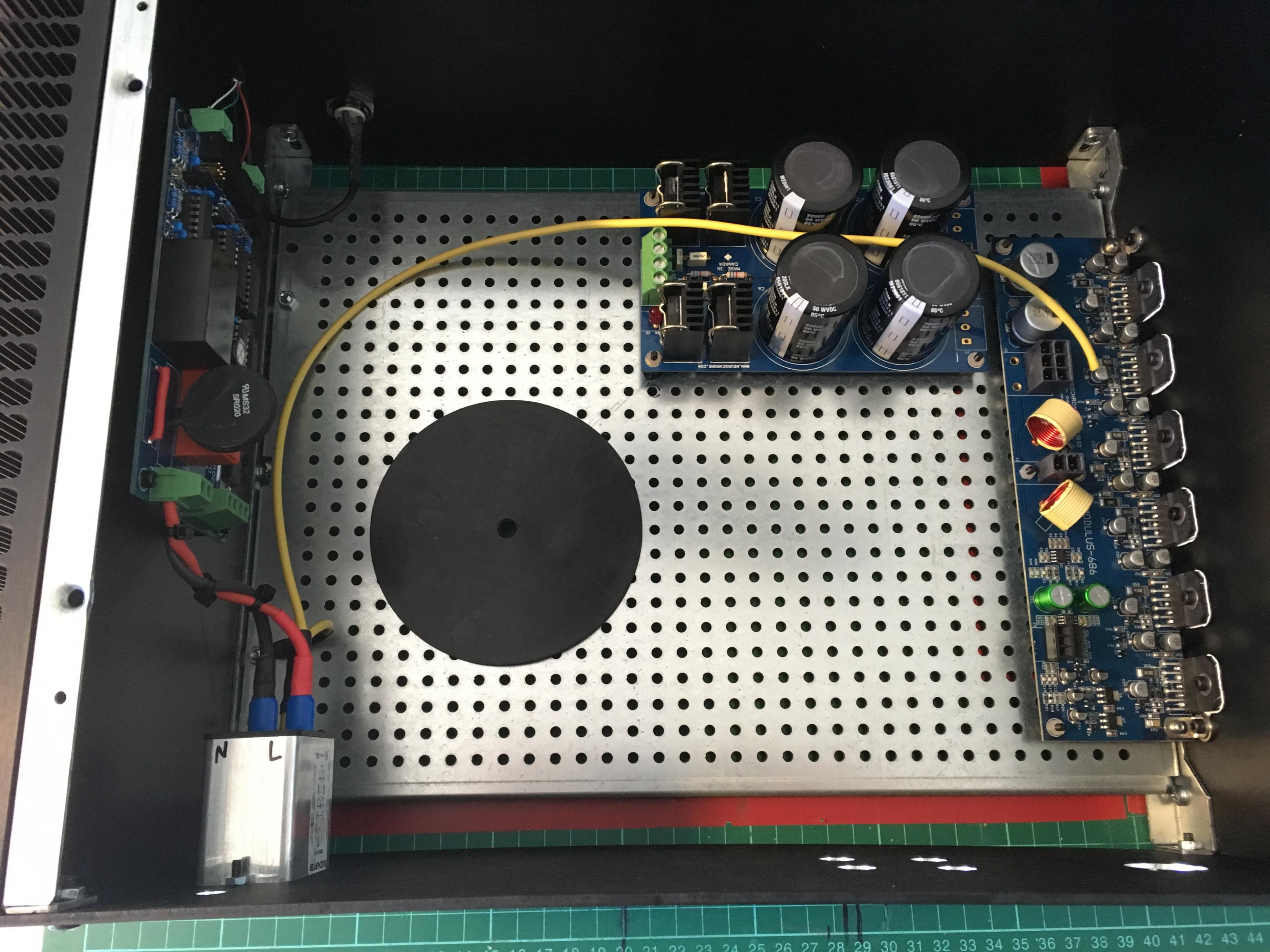

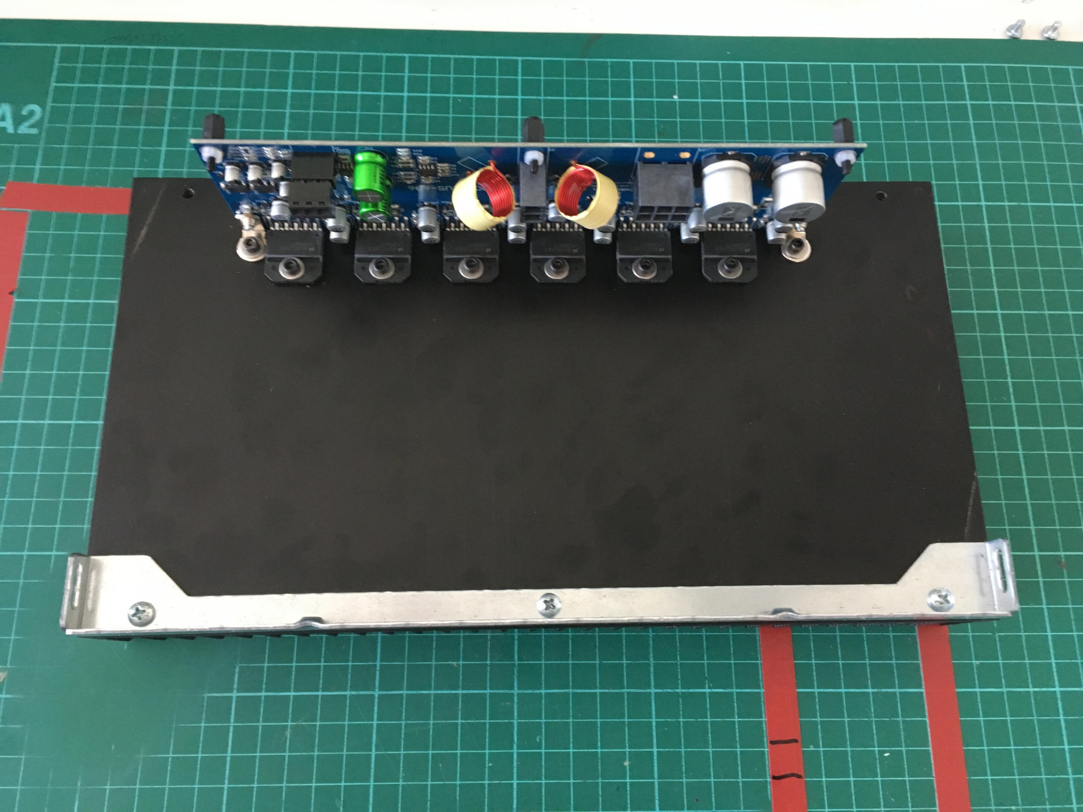

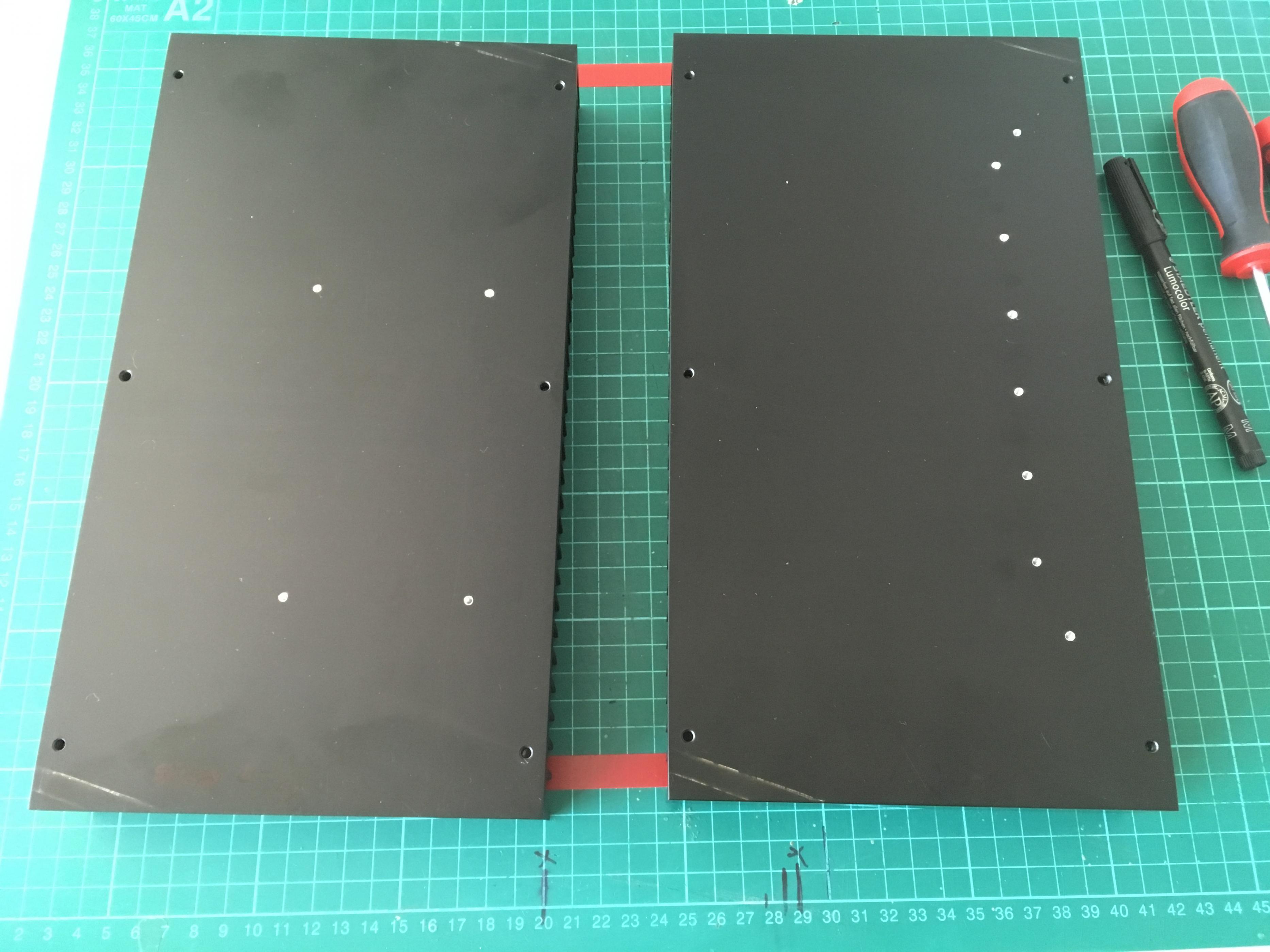

Here some progress pics on my two Mod686. I am currently somewhat busy at real work and progress is limited to Sunday‘s mainly. Well I am getting there.
You can see the tapped heat sinks of the Dissipante4U case and the mounted Mod686 board. Boy I wished I had known about Toms new bracket earlier. Tapping gets kind of dull.

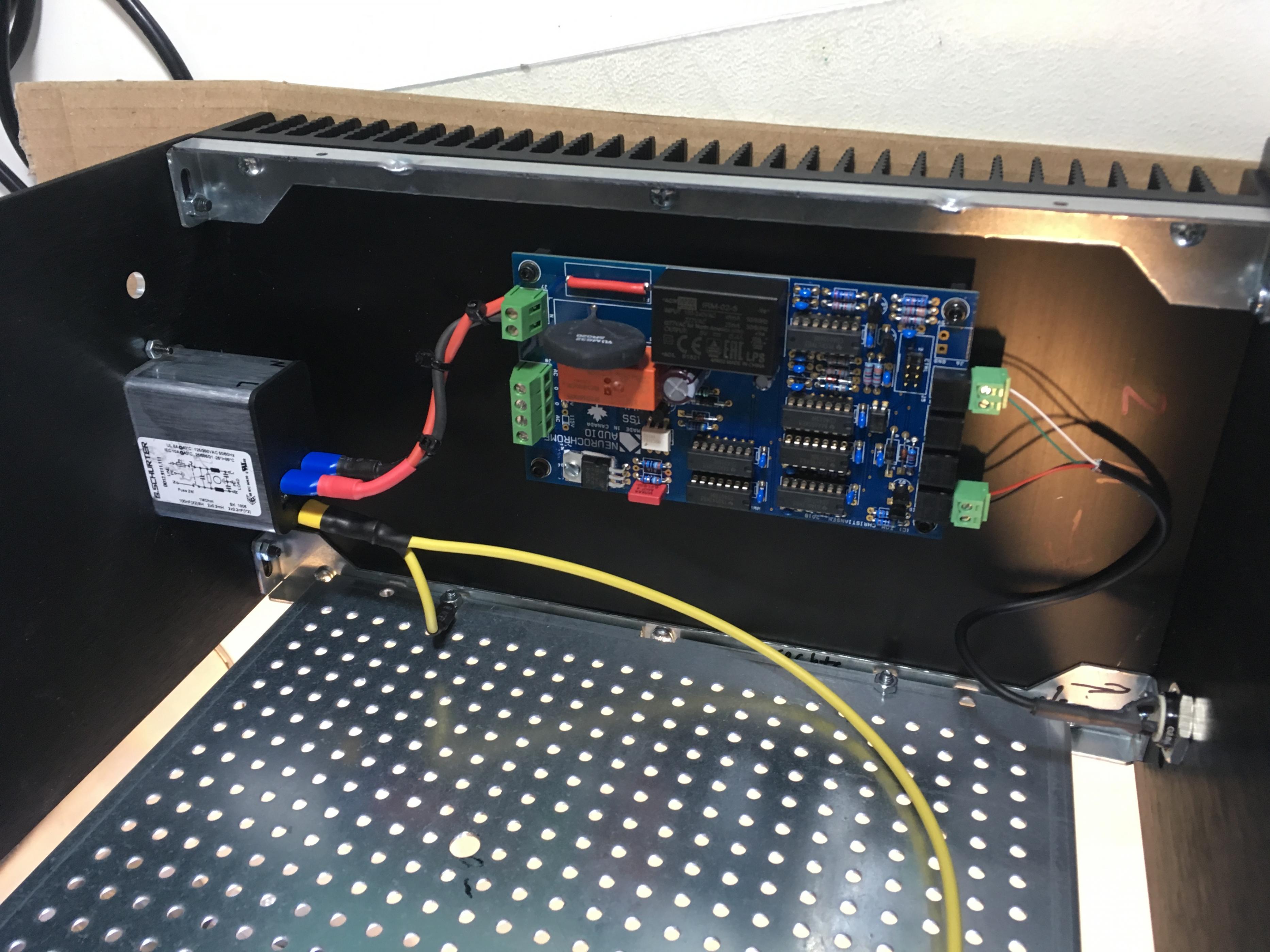

Now here is a view of the ISS, the PSU and the assembled case shortly before the transformer was dropped in. Notice ground has not been fully hooked up yet and the connection to the amp is also still missing.
Let me know if you see something you would do differently (which doesn’t involve tapping more holes ;-))

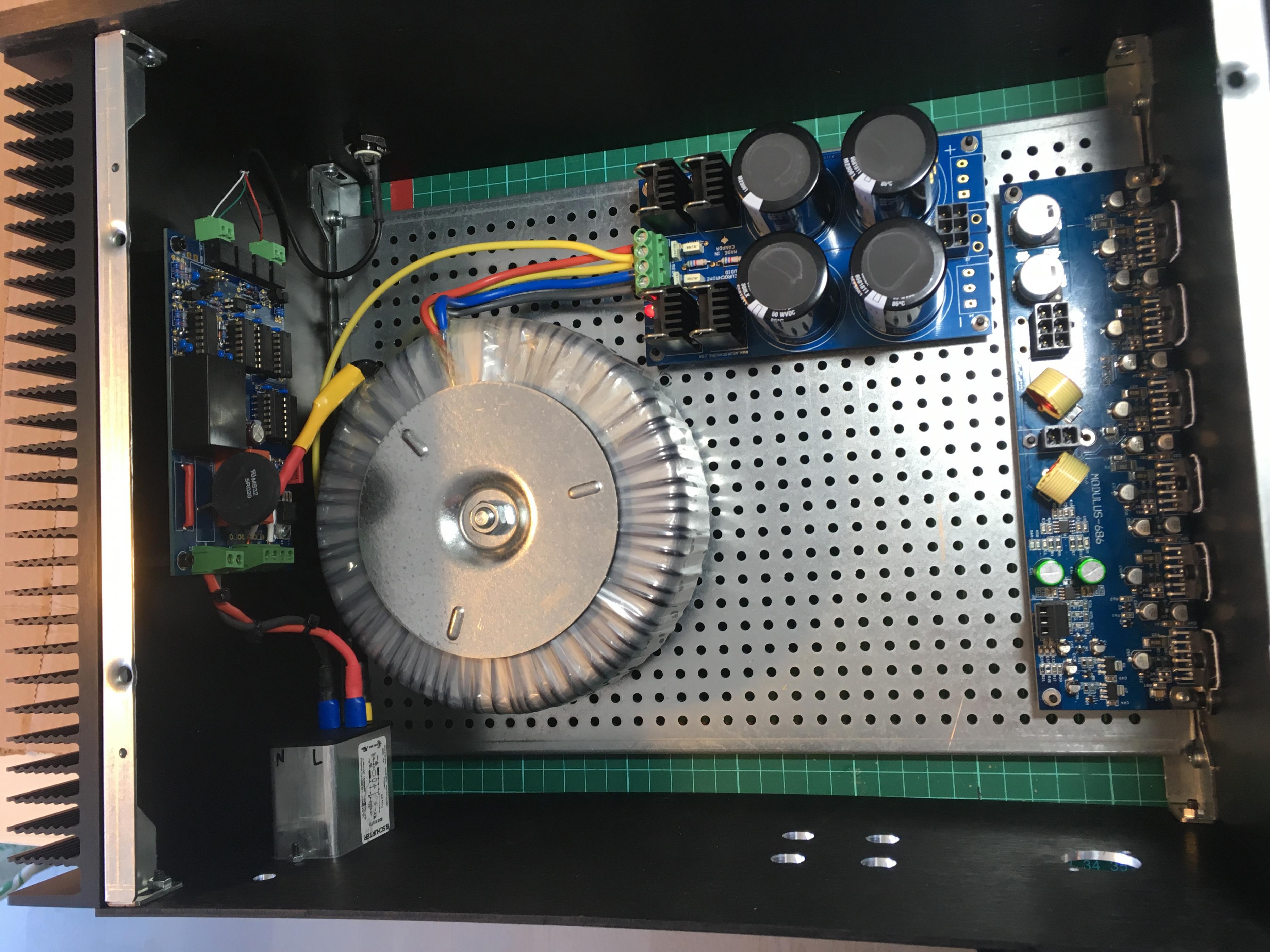

... and here comes the big guy. Boy I that 800VA is heavy when maneuvering it into position to hook up the PSU and the ISS.
Both amps are in this building state now. One is causing me a little trouble and I haven’t figured it out yet (Tom once your are settled back in from your trip, I could do some troubleshooting over the coming weekend).
Next is attaching the output speaker posts, the XLR, improving the flimsy cable hookup of the MDF6 momentary switch and connecting the 12V trigger input.
