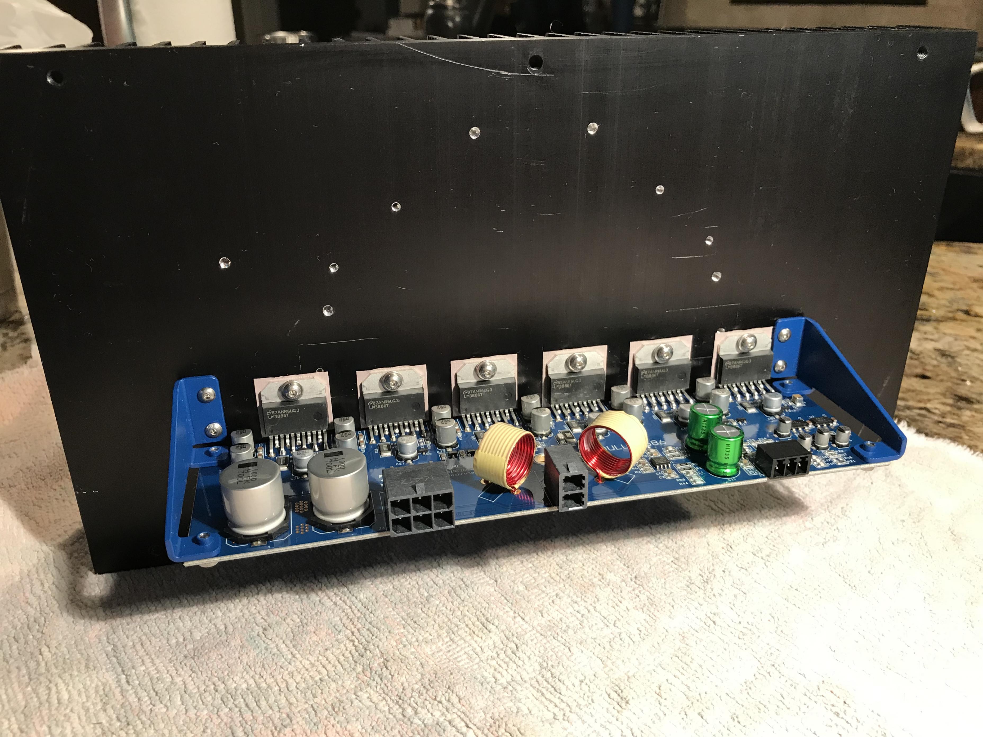

Brian:
Those dimensions are based upon locating his new brackets relative to the PCB to provide adequate lead length above and below the PCB, as shown in the photo I have attached. It really is a moot point what the numbers are if you use the template as intended...Tom has taken the measuring out of the procedure.
For those who may worry about the center punch maybe slipping or just being off a bit when aligning it to the center cross-hairs, here is tip/trick I use. Before center punching, tape the pattern to a piece of card box and then use a straight pin to pierce a little hole on each center point. I do this using one of those goofy looking headband magnifiers (aging eyes). Now you have a self-aligning template for the center punch. If you mess it up a bit, just print a few extra templates.
You might want to move down slightly the top screw hole in the brackets so that they are in a line with the LM3886 screw holes. It would be much easier to have all 8 in a row. Also move the bottom bracket screws down slightly so that the spacing is still 0.5". There's no reason to make the measuring and drilling harder than it needs to be.
All you need to do is to print the .pdf at 1:1 and tape the template to your heat sink. Centre punch at the ten crosshairs. Drill, tap, done.
If you'd rather do the measuring work yourself, you're more than welcome to. You can always slide the LM3886es up. It'll give you a bit more lead length, but that should be OK. The additional 0.05" shouldn't be a big deal even for hand measurements, though. If you have access to a height gauge, you can make it even easier.
You could argue that I should have placed the holes in the bracket 0.05" lower. I do need to provide enough space that you can get a screwdriver in above the PEM nuts (and any components in the way on the PCB). Those considerations drove the hole placement in the face of the bracket that faces the heat sink. I could drop the top hole down 0.05", but that makes the hole spacing 0.450", which is harder to find on a ruler than 0.5". 🙂

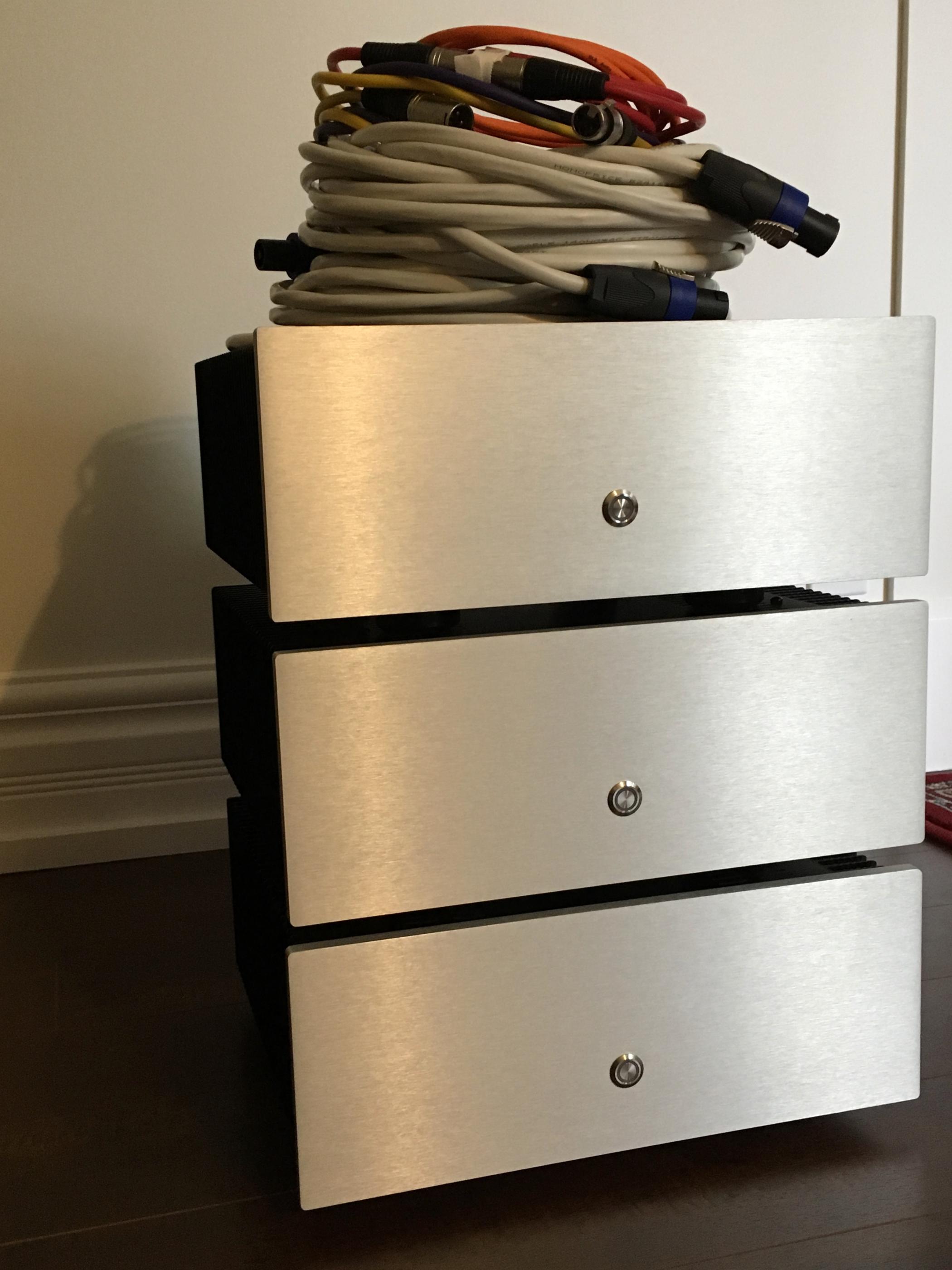

Eris,
4xMod686 in a single enclosure makes for a very large enclosure.
Tom built a pair of stereo Mod686 in matching 3Ux300 mini dissipante enclosures with SMPS.
I was originally planning on building two stereo Mod86's for Lx-minis. I decided to pivot and build the Mod686/Mod86 combo amps. I already have the Mod86's and parts. I will try to fit them in a 3Ux300 mini disspante enclosure with a linear PS. It should just fit. I plan to put the analog crossovers in enclosures under the amp. So from my DAC/preamp I run a single XLR cable to analog crossover than 2 XLRs from the crossover into the amp. Then a single speakon connection into the Lx-mini. The amp and crossover will be sitting on the floor somewhat behind the Lx-mini.
That it would. The enclosure would likely also need to be water cooled if all the channels were to be run at clipping levels into a 4 Ω load.
Make that a quad of stereo MOD686es. 🙂 I built a pair for the Vancouver Island DIY Fest. One will head to San Francisco with me on Saturday. The other is on its way to Quebec for a test drive. I need to bring a total of three amps to BAF, so I built two more. All four are 2x MOD686 with 2x Mean Well RPS-400-27-C.

New brackets were very easy to install and provide good support of the board and wil definitely keep any loads off of the 3886 leads.
Awesome! I'm glad you like them. I just took delivery of 20 pairs of brackets today. Have 16 left...
Tom
