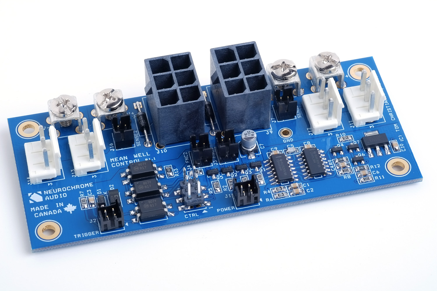

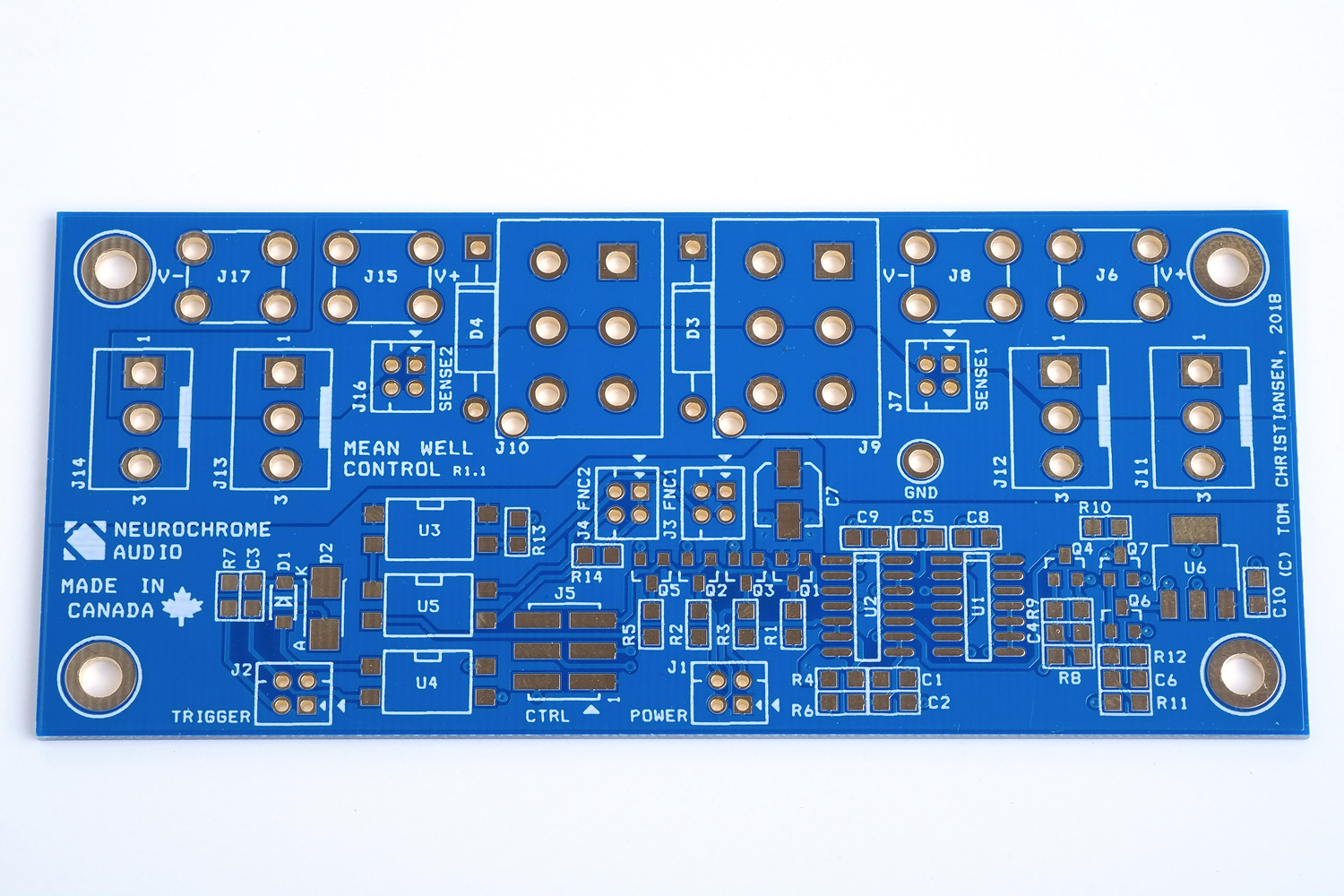

Those of you who are looking to use the Mean Well RPS- or EPP-series switching supplies with your amplifiers may be interested in my latest: Mean Well Control. I've wrapped up the last loose ends in the design, received the first stack of boards, and will be filling the pre-orders this weekend.
The MW Control handles all the connections between two Mean Well RPS/EPP 300/400 series supplies and the Neurochrome Modulus amps, including the MOD686.
More information on the Mean Well Control is available on my website: Mean Well RPS/EPP-series SMPS controller for use in audio amplifiers.

If I was to pop the top off the 686 currently on rotating loan here, would I be finding one of those inside?
Yep. You'd find Rev. 1.0 of the Mean Well Control in there. You can even see it on the build pictures in Post 601.

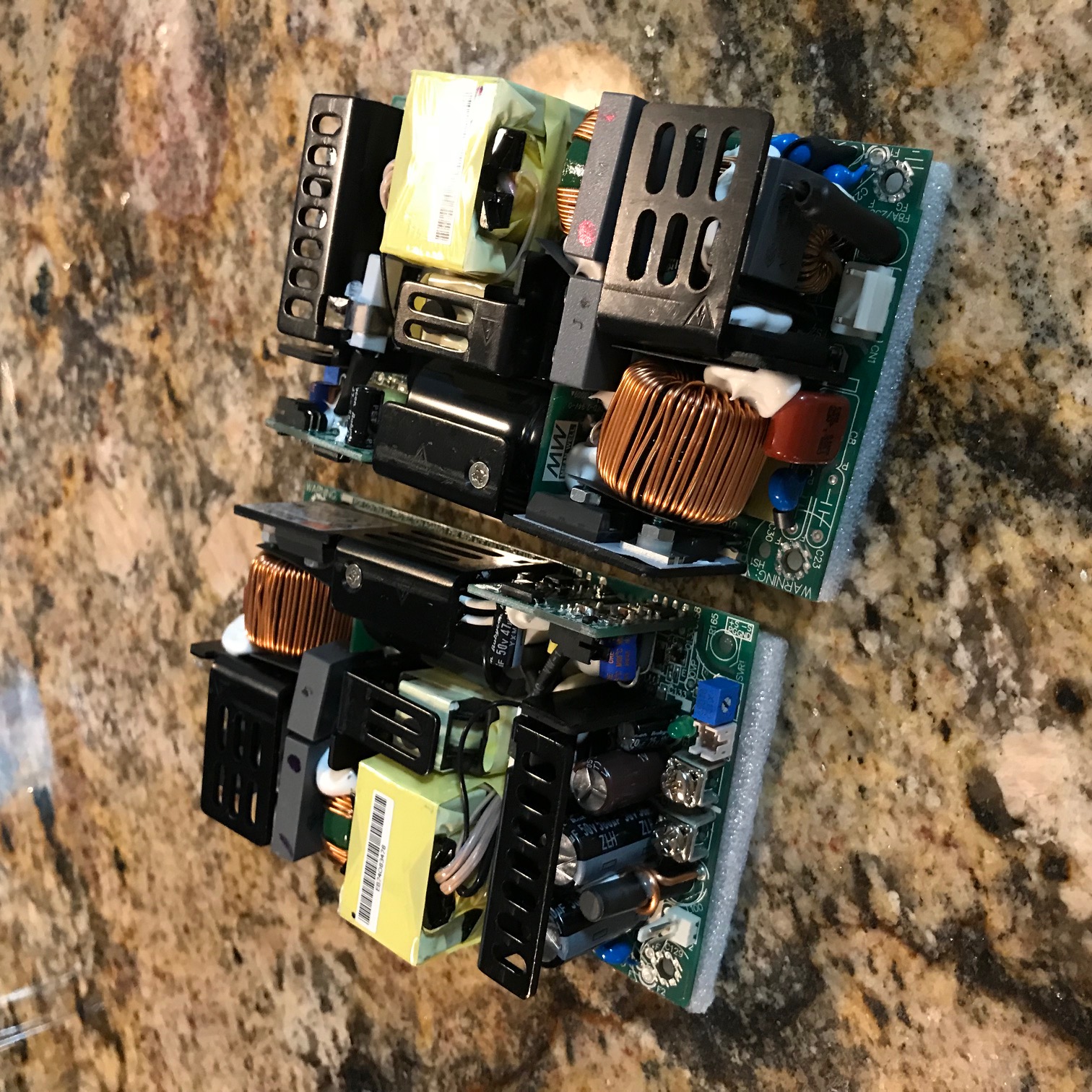

Started Mod686 Build
Just received all the parts for the 686 main boards and two Meanwell RPS-400-36 SMPS's, PCB mount version. They sure do cram quite a bit of circuitry in a small space. According to a Meanwell product support person, there are actually 2 fuses on the board. I could only locate the 8A fuse by the mains input. Consequently, I am not planning on using an IEC outlet with a fuse. It looks like the user could replace the leaded main fuse if required, although it would take some work.

Yeah. The Mean Wells are fused. I still put a 10 A slow-blow fuse in the IEC inlet just in case the wiring from the IEC inlet to the supplies short to the chassis. The odds of this are obviously extremely low, but the fuse doesn't cost much and makes me sleep better at night.

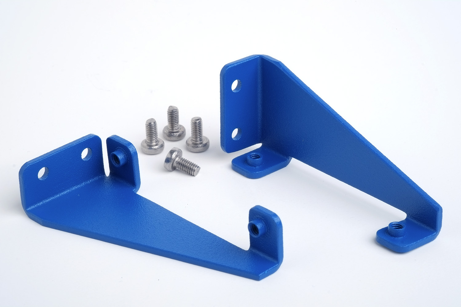

A while back I mentioned that I was planning to offer a less expensive mounting bracket for the Modulus-686. Please welcome the Modulus Bracket. It'll fit the Modulus-686 (and Modulus-286 Rev. 2.0 and Modulus-186 when they become available).
The new brackets are almost 40 % lower cost. Unfortunately, reality is that custom metalwork is still expensive, so the brackets are $25 per set. One set will hold one board to the heat sink. The set is delivered with the four M3 machine screws necessary to hold the board to the bracket. You're on your own for the screws that hold the brackets and LM3886es to the heat sink. The mounting holes in the brackets are 130 mil in diameter (3.3 mm), thus will fit M3 and US #4 screws.
As always, I started with a small batch of brackets, so I'm out of stock already. I'll have more in stock in about two weeks. You can preorder through my website. The bracket set is one of the options on the Modulus-686 product page. If you don't see this option, please hit reload in your browser.
