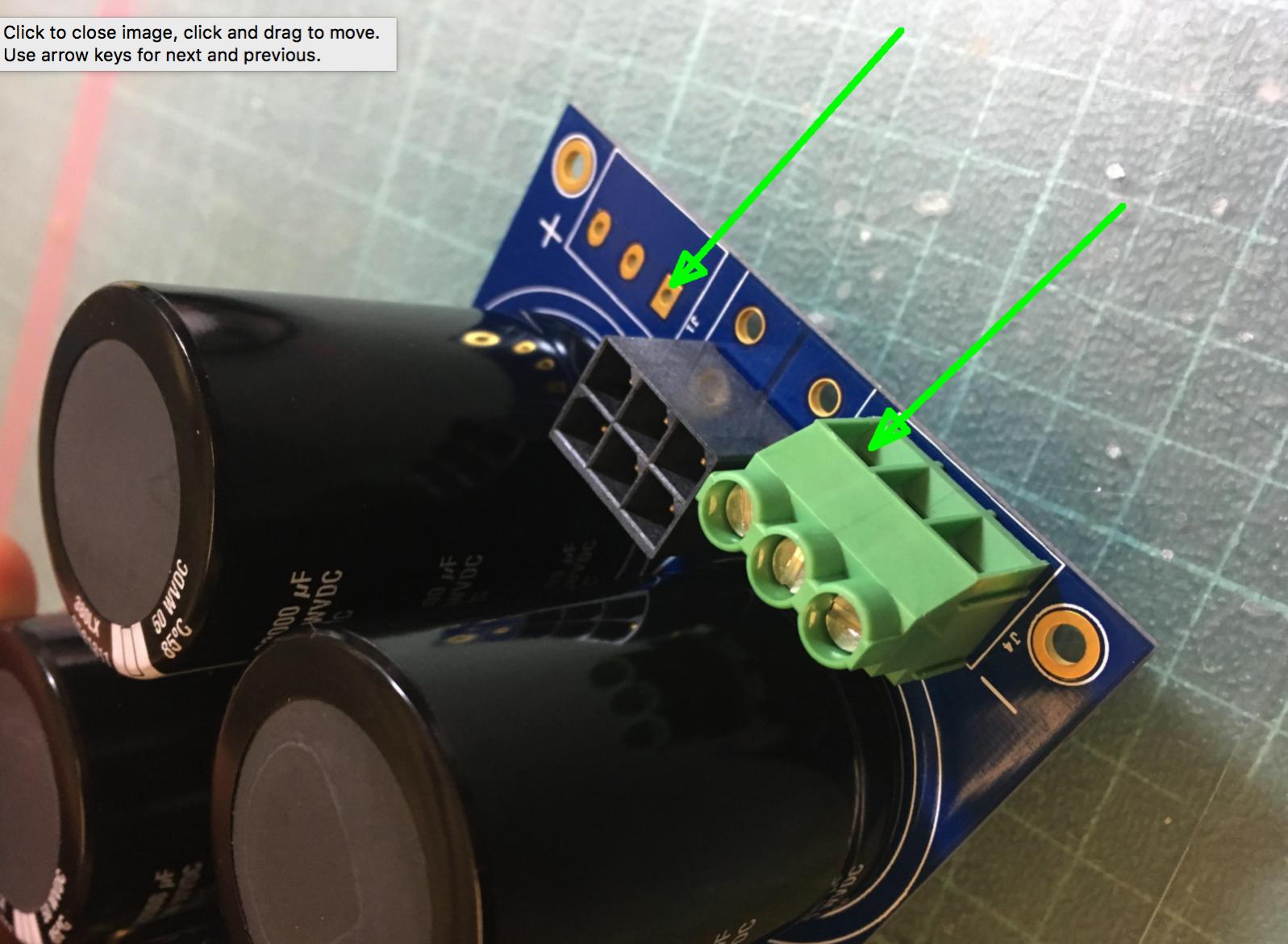

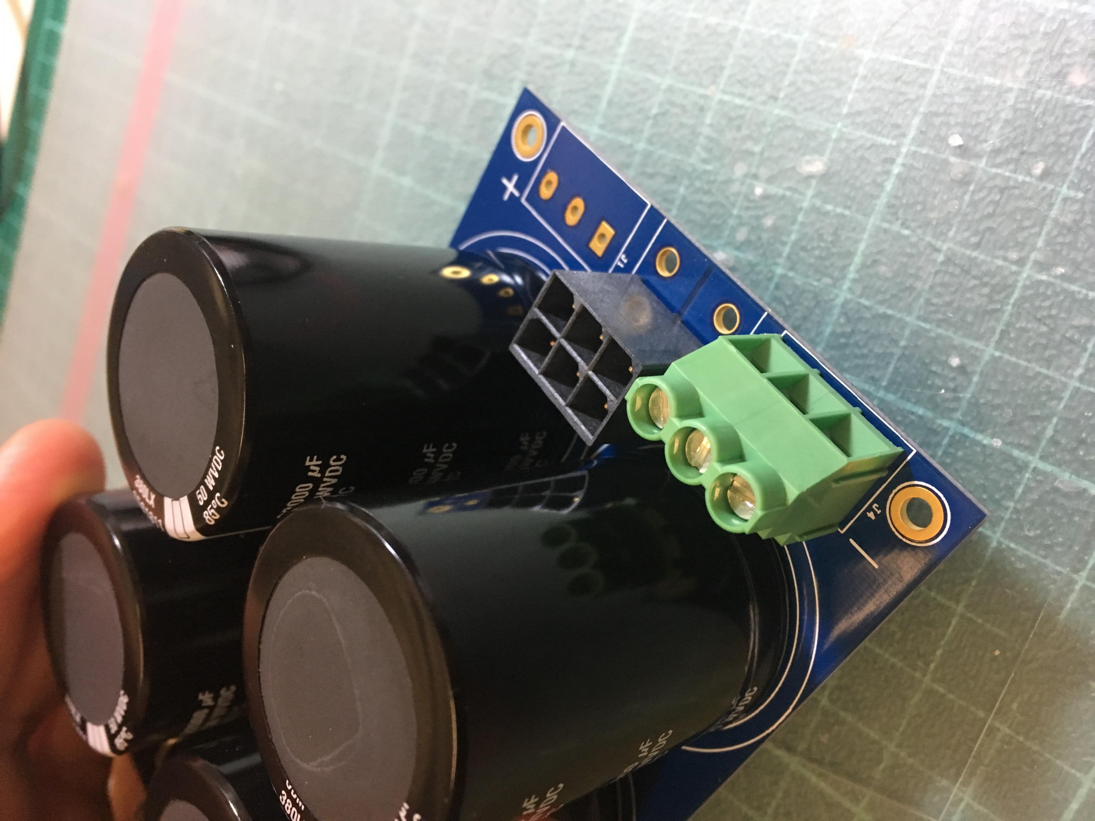

Hi Tom.
I have got a question for the Power686 safety ground hook up. The older Power86 had a six pole connector which took the safety ground wire next to the four wires of the transformer secondaries. The Power686 has only a four pole connector and therefore no extra space to connect the safety ground.
Question: Do I squeeze in the safety ground together with the transformer center tap wires or do I connect the safety ground on the Power686 output side where is more space?

One more please. Could you please confirm, the ISS doesn’t get connected to safety ground?
