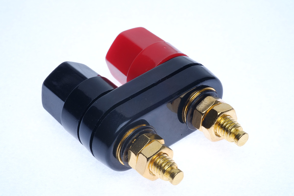

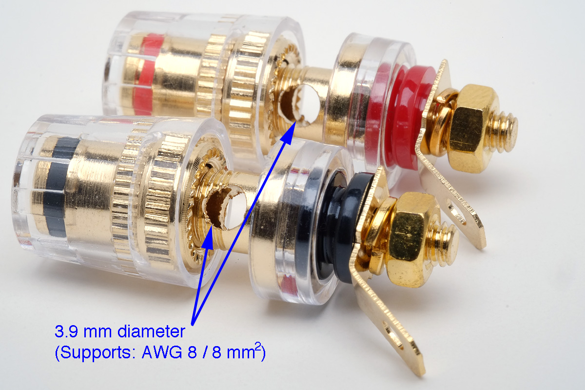

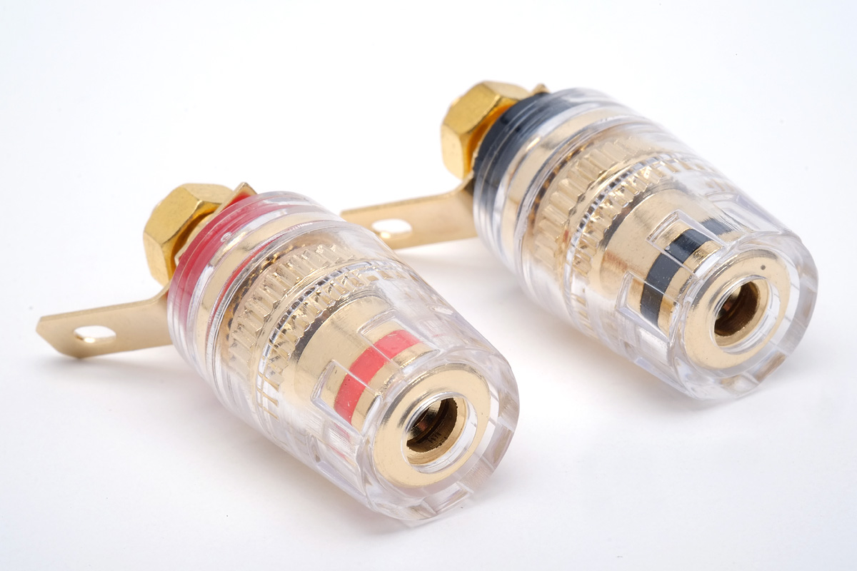

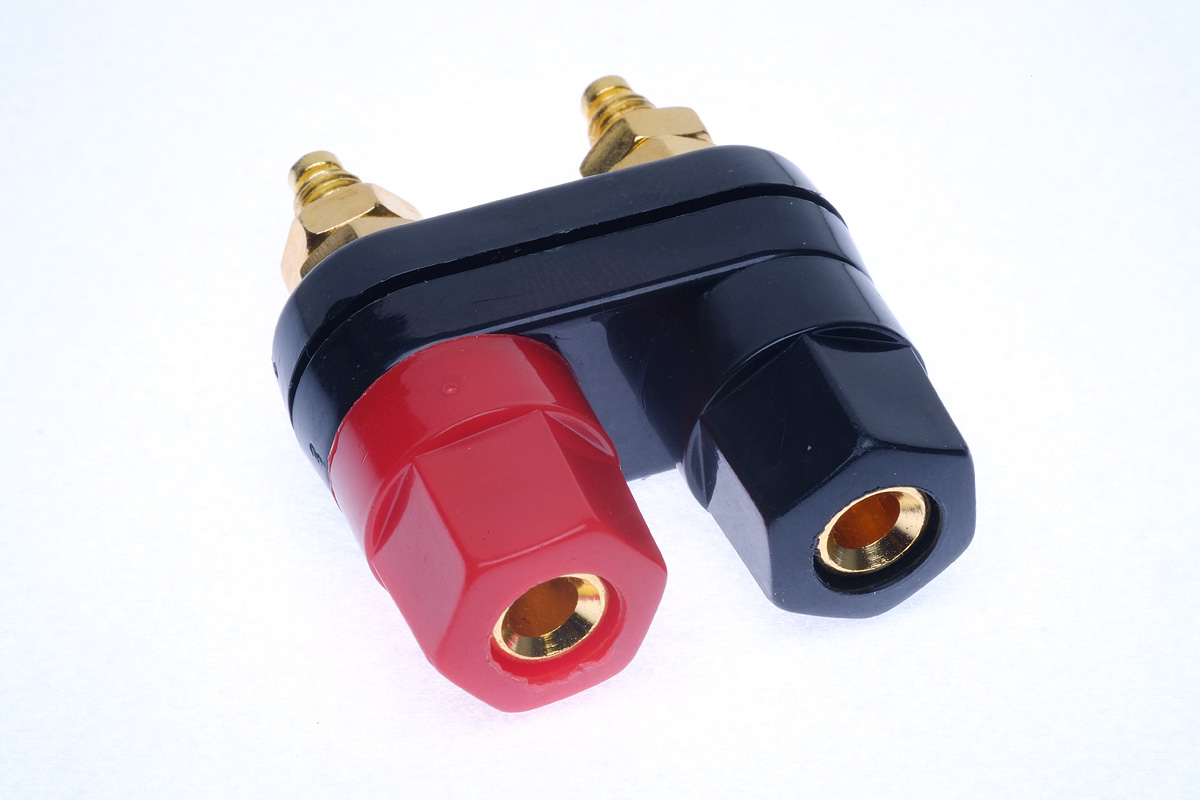

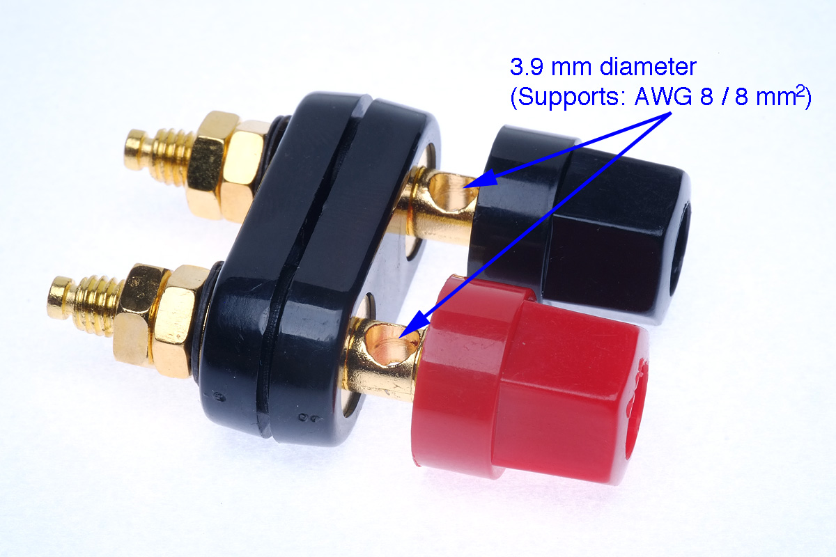

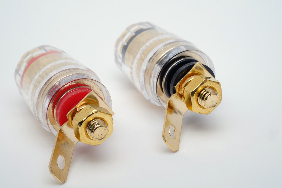

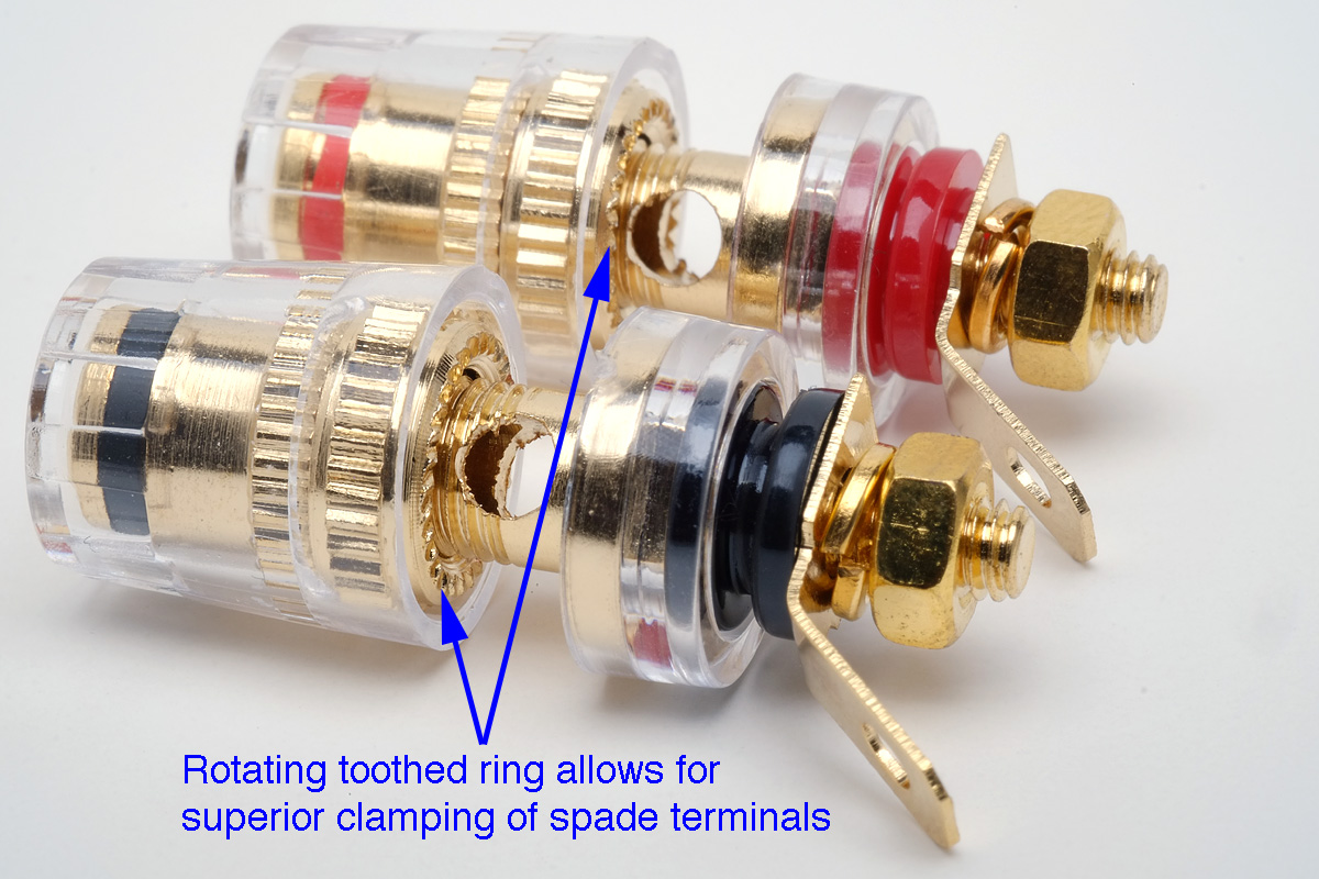

BTW: If anyone needs binding posts, I now have a couple of types in stock. You can find them in the Solid State Amplifiers & Power Supplies section of my website.
I got tired of chasing down vendors on eBay, Amazon, etc. and buying in onesie-twosie quantities, so I found a good one and worked out a bulk deal. I'm one step closer to being a one-stop shop for high-end DIY audio. 🙂

The plastic units on top look pretty much like those included in the ACA kits, while the duals on the bottom are something I’ve used for decades, and are spaced at 3/4”.
The duals I've used for decades as well. They're pretty good. I actually bought them from Parts Connexion but decided I liked the single ones better for the Modulus-286 kit. Rather than returning them (and paying return shipping), I figured I might as well sell them. I have 20 of them... The single ones I can see myself stocking more permanently, especially if the Modulus-286 kit takes off (they'll be included in the kit).

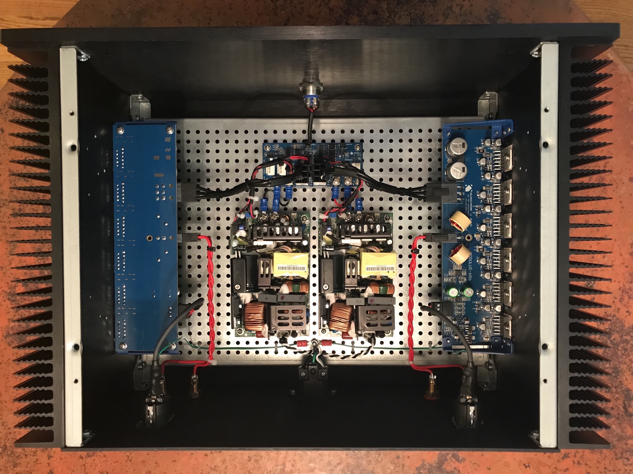

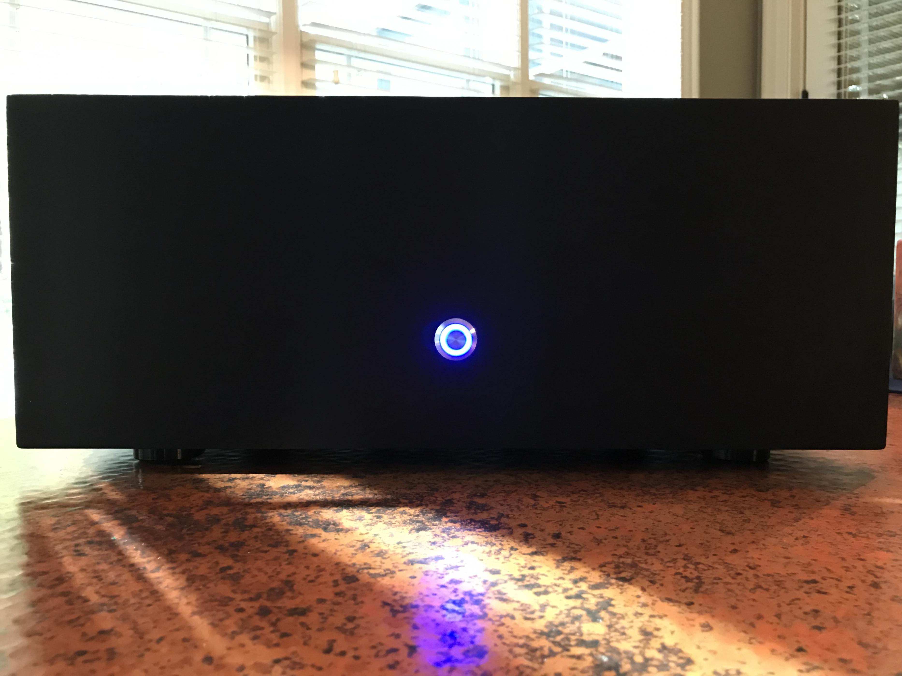

Mod686 Build Photos and Listening Impressions

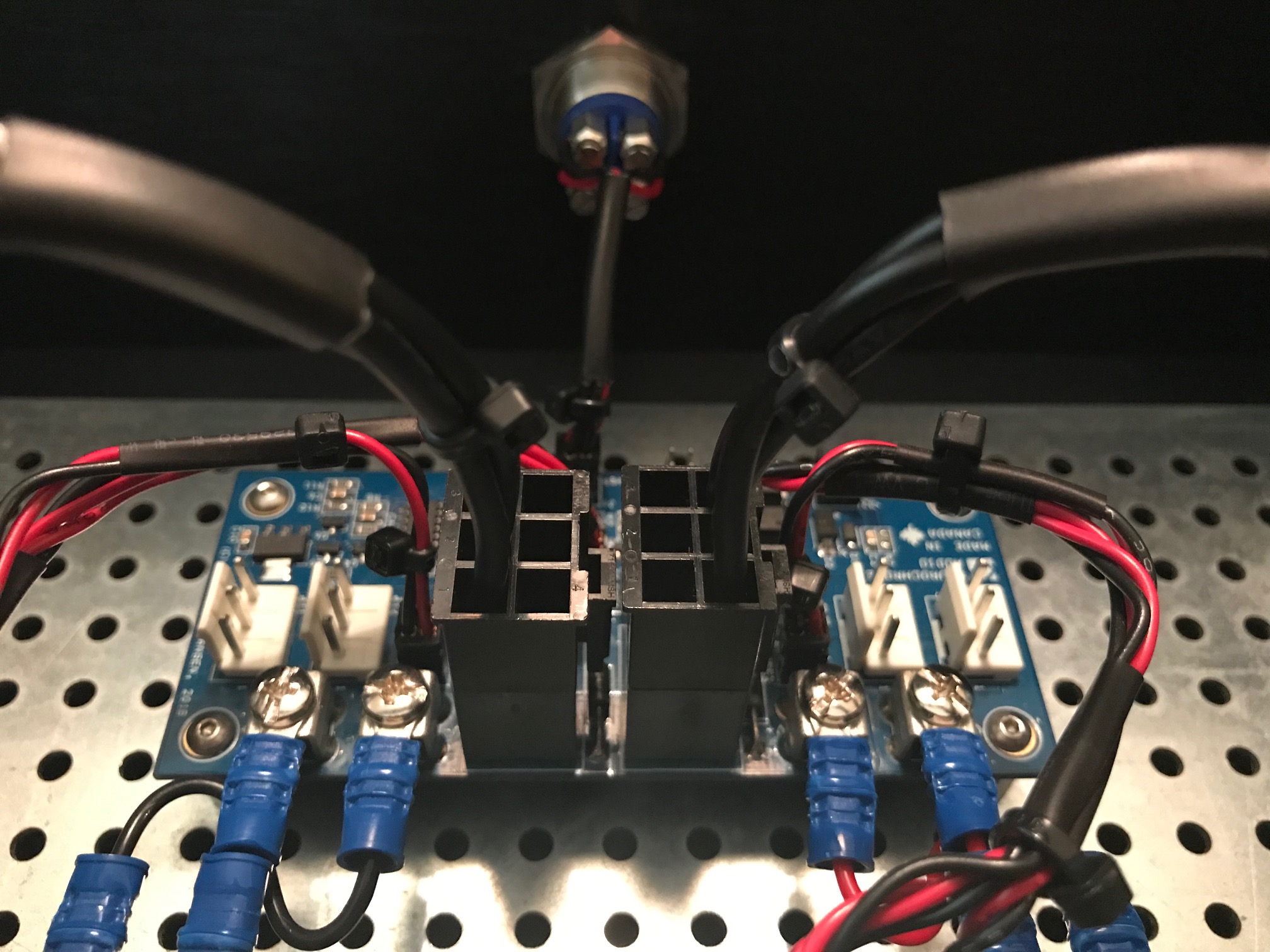

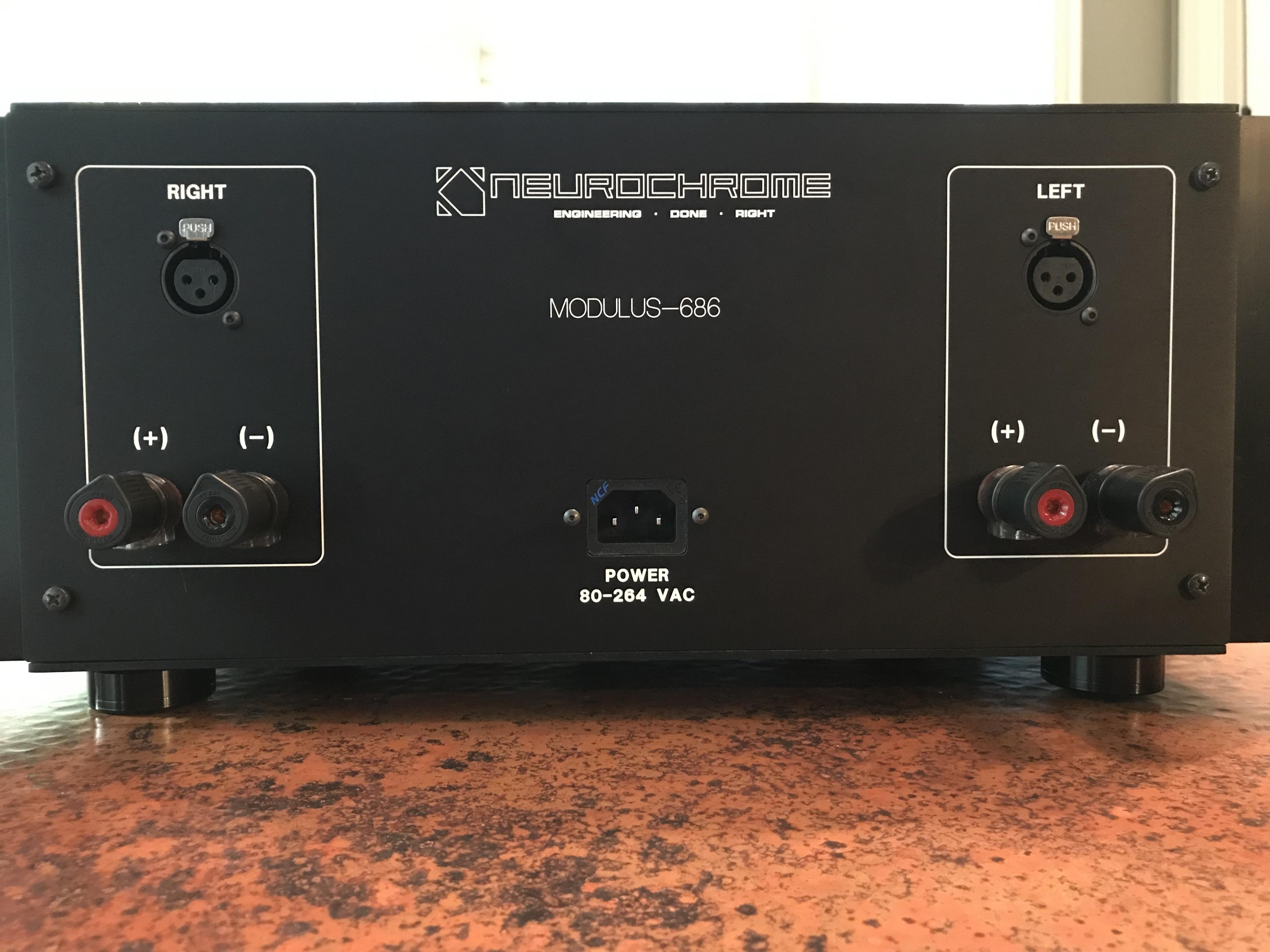

It has been three or four weeks since I completed my 686 build and I thought I would share some of the details. The chassis I used was a Dissipante 4U, 300 mm deep, which I re-purposed from a previous build. I started the build process determined to use a pair of RPS-400-36 supplies. With Tom's support, we came to an apparent solution to prevent the slight whine radiating from my tweeters. Long story short, things did not work out quite as planned and I ended up using the RPS-400-27's; slightly less output power for my stereo amp, but dead quiet. So that being said, the amp runs extremely cool, so cool you can probably chill your beer if you hold it against the heatsink.
Beyond the two Meanwell power supplies and Meanwell Controller, here is a list of parts unique to my build:
XLRs: Furutech FT-786(R)
Binding Posts: Furutech FT-807(G)
IEC: Furutech FI-06 NCF(R)
Wire: Neotech UPOCC Stranded, Teflon Jacket (Speakers: 14AWG, XLR's: 24AWG)
Rear Panel: Front Panel Express (Neurochrome logo courtesy of T.C.)
And for the sound…Very engaging, dynamic and still retains and overall neutral tonal balance. I am comparing a bit to the Mod86 I once owned. I liked the overall presentation of the Mod86, but it did not grab hold of you quite like the 686 does. I am not sure what Tom put in the secret sauce, but I am really enjoying the music. I mainly listen to jazz and acoustic guitar. Currently, my ICE Power AS1200 amp is sitting quietly on the sidelines. Eventually I will put it back into the system for a point of comparison. I think I can stop building amplifiers…for now.
With looks that could kill! Super clean wiring, routing and construction! Awesome!!!

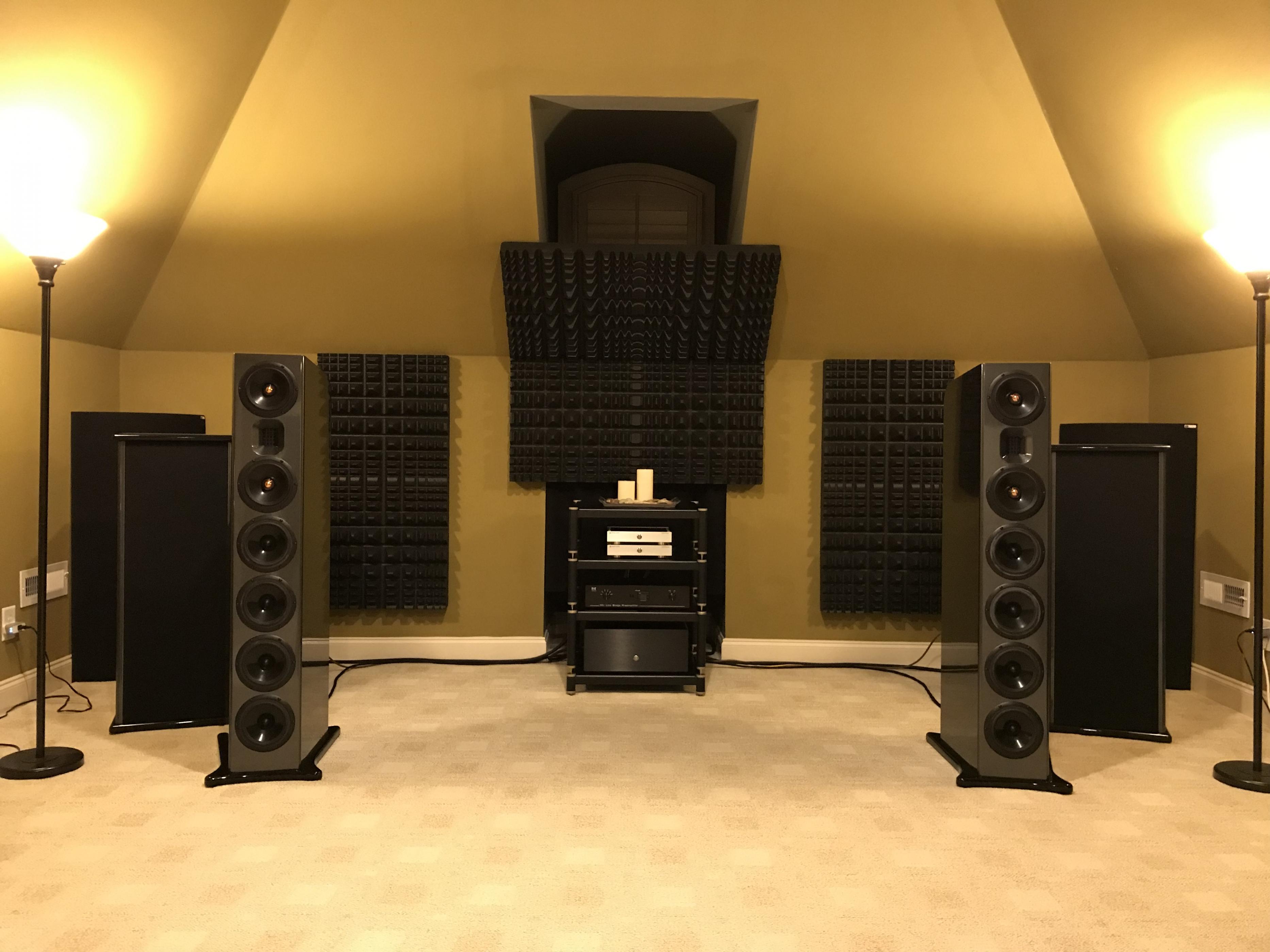

Please post a photo of your speaker system so others can see the context in which you have made your subjective comparisons...

Your whole set up looks top notch.
About the Mod686, when mounting the chips, did you do the tapping by yourself or you ordered with pre drilled holes?
Wow! That is a stunning build you have there! I love the attention to detail that you clearly paid on all the wire routes and such. The back panel is awesome. The logo turned out quite nicely! Too bad it's on the back... 🙂 I like the black front panel with the silver power switch. I'm planning to do something similar for the Modulus-286 Kit (I'll offer both black and silver front panel options but only silver power switch as the model I've chosen for the MOD286 kit is not available in black).
Yeah. I'm still wiping the egg off my face on that one. 😱 I'm glad we got the amp working well for you, though. Should you get the itch for more output power, you should have plenty of room in the chassis for an Antek AN-8225 and a Power-686.

I echo the sentiments shared by Asuslover, Anand and Tom... top notch build (and setup), attention to detail, neatness, and symmetry is pretty stunning 🙂. Very well executed, and as a fellow Mod-86 owner, you make me want to build a Mod-686 too!

I don’t know why I didn’t clue in to what the advantage of installing one channel board would be, but it certainly made for a very tidy wiring job. Nicely done indeed.
