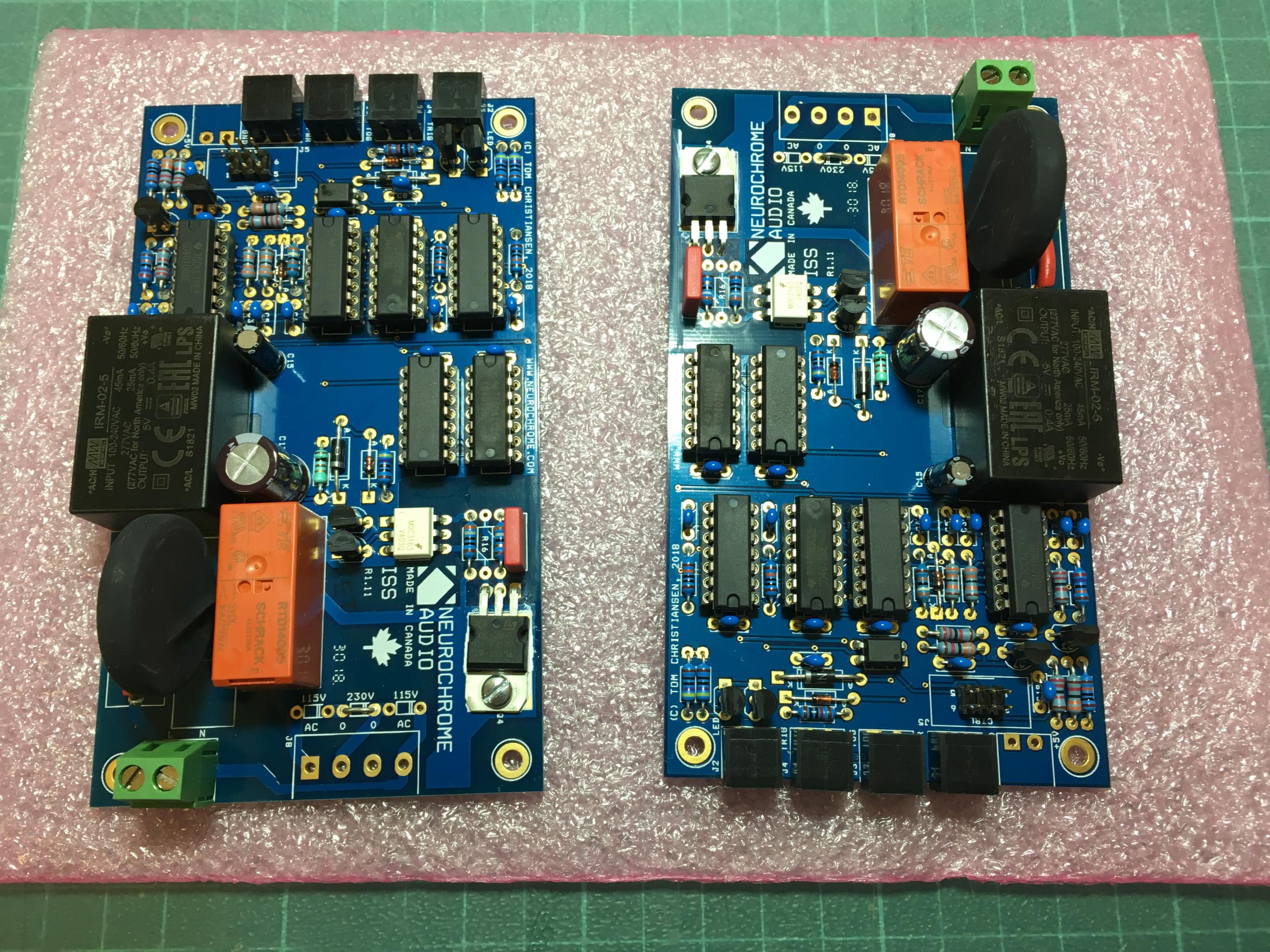

After finishing the two Power686 a few days back, tonight I completed the two ISSs (int. space stations;-) ). Plugged it in with my bulb protector and bingo, both are working perfectly. Tom big compliment - you just make it easy and error proof.
Today also the two 800VAs arrived and I hooked em up too for an ISS test. All good. Man those things are big and heavy🙂. See some pics below of the beauties.

Holy crap! That's what I call a transformer!
I love how the (probably pretty stout) primary leads look itty-bitty compared to everything else. I'm guessing it's a 230 VAC, single primary. If yes, you connect it to terminals 1 and 4 on the output of the ISS.

Yep that’s what I thought too when I unwrapped it today - and there are two of them It is indeed a 230V single primary but thanks for the hint. I already connected it for testing.
Yes the secondaries are so unwieldy they keep the Power686 suspended in mid air once it is hooked up. I guess I need some hefty tools for final assembly.
Why the 800VA, 25V (Amplifon) you may justifiably ask. Well, the costs difference vs the 500va was some 40EUR however given the overall cost of ca. 1900 EUR for the entire project (2 monoblocks) the difference started to appear small. And of course it delivers the 16A the 686 can maximally cope with ;-) (but not my speakers yet;-)))

Has someone been able to properly test their Guardian 686’s?
When i supply 25v to the power supply connector i measure no voltage at all across R1 and R5, not even after having waited for a minute.
The weird thing is that it is consistent on both my guardian 686’s..
Pardon my belated response. I'm on vacation and only have intermittent access to the internet.
You'll need power connected to both power supply connectors, both 8-pin ICs installed, and the appropriate (SD, GND) jumpers installed for the circuit to work.
The circuit which drives the LEDs in the photovoltaic gate driver ICs is a simple RC with a bipolar transistor detecting the voltage and turning on the LED. If you have all the components installed correctly, there isn't much to to go wrong there.

Like we already discussed via email i've found out I need to power both halves 🙂 Will do final testing the coming week.
