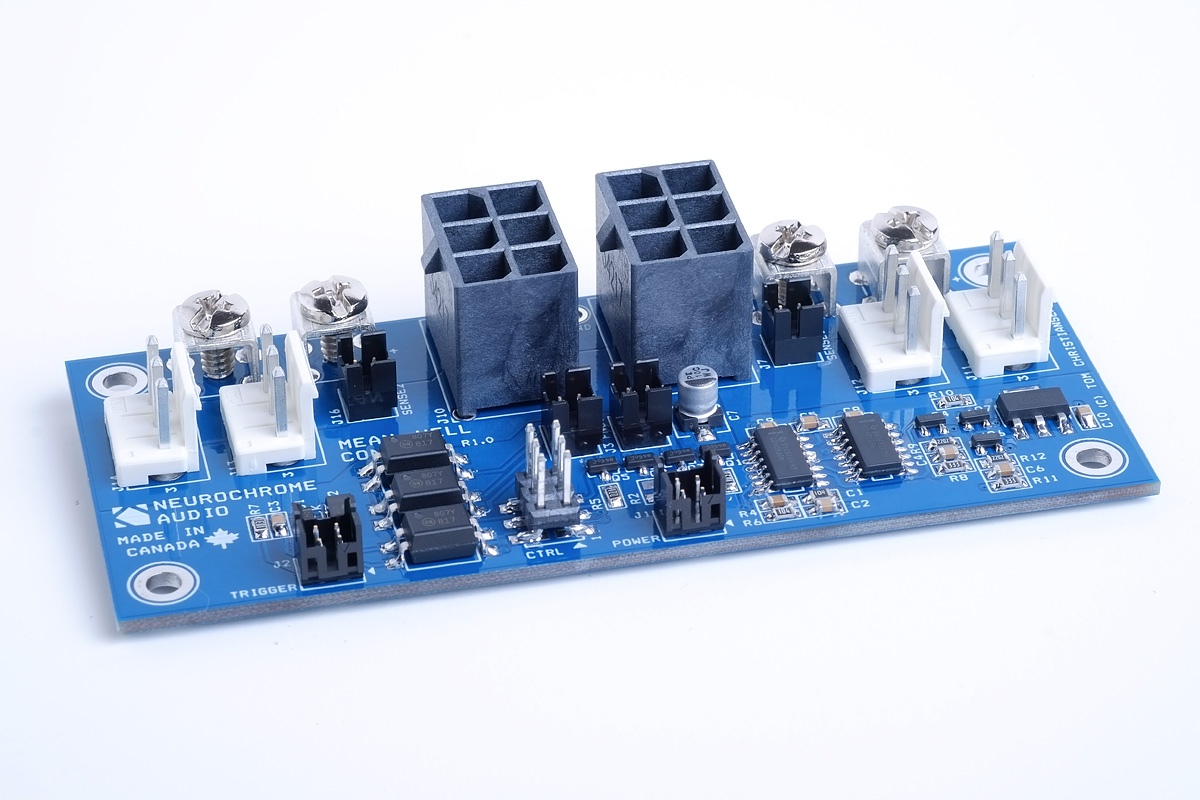

I just tried changing my location to an EU country (Denmark) on Mouser's website. I'm not seeing any messages about the supplies not being able to ship. Does this only show up during checkout?
Should Mouser or Digi-Key not be able to deliver the Mean Well supplies outside the US, I suggest contacting your local Mean Well distributor. You can find your distributor here: Distributor Network-MEAN WELL Switching Power Supply Manufacturer
Select "AC/DC enclosed" for the RPS/EPP-series. "Modular Power" for the IRM-series.
It looks like RS-Components carries the Mean Well products as well. That'd be a good option for folks in the EU.

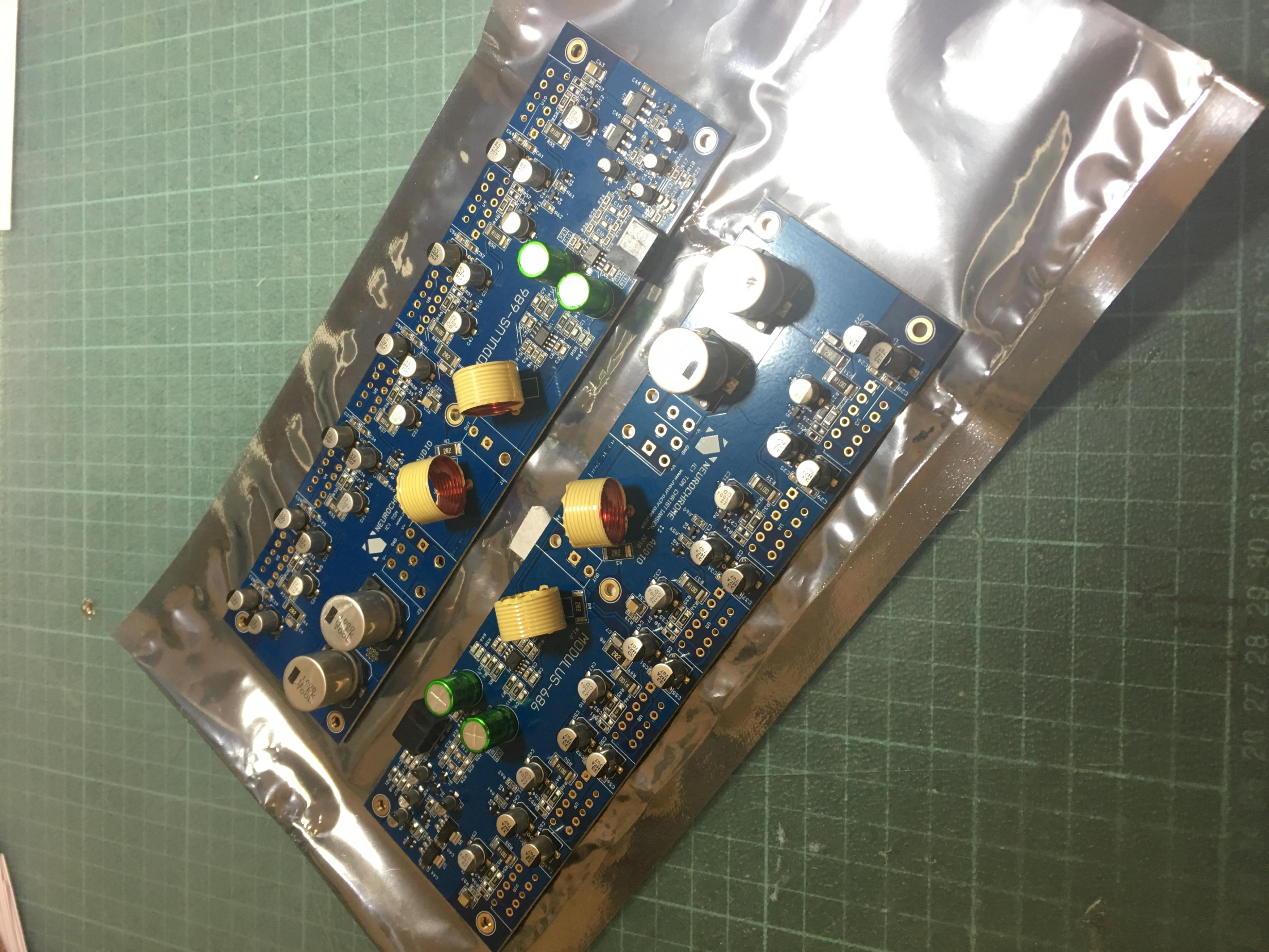

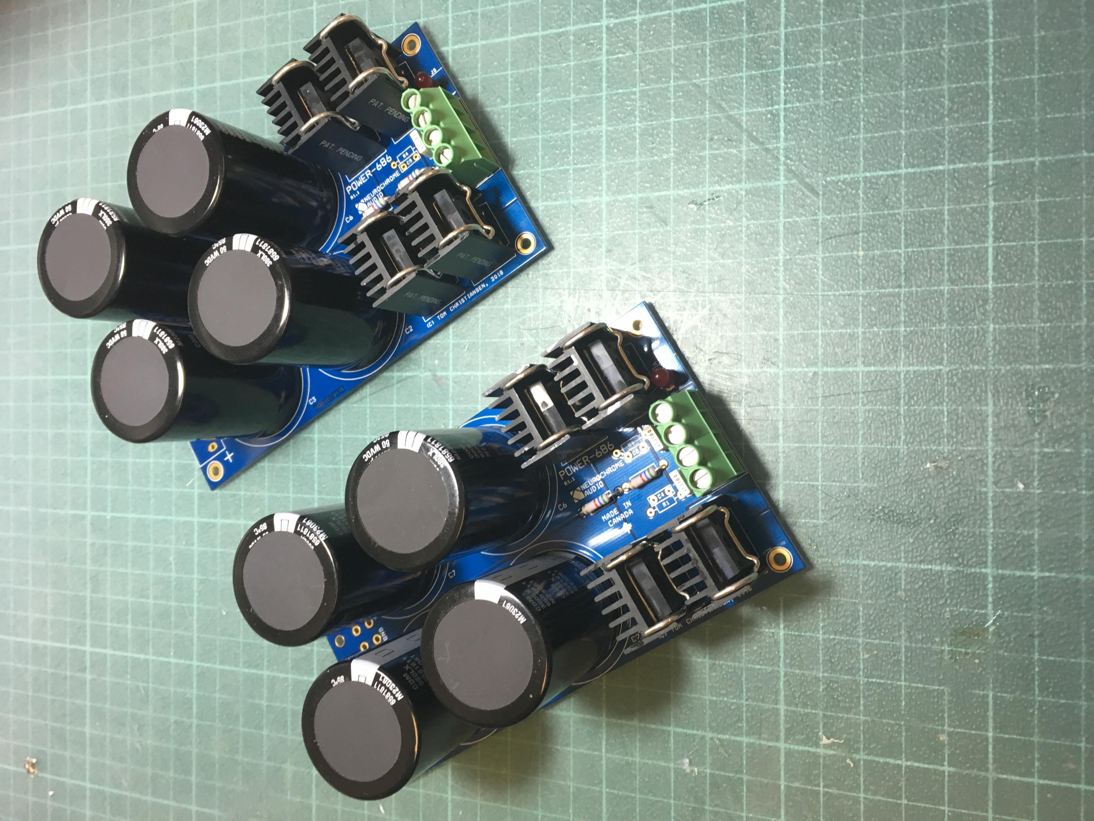

Tata... look what the cat dragged in 🙂. Ordered last Thursday from Tom and last Friday from Mouser ... this is how a lot of fun work looks like.
Tom thx for the speedy delivery. The boards look wonderful. As usual, the Mouser Project provided by you made ordering a breeze.
The trafos are still on their way - I have chosen the 800VA, 2x25V Amplimo, which are easy to procure in the EU (ship from NL).
Just one hint, possibly add the board mounting hardware to the BOM (same as with the Mod286 BOM) - Mouser No. 534-4332 and -9307. I guess it would simplifiy attaching the boards to the heat sink. The costs are just pennies and people can remove them if they chose a different mounting method. I now have to accumulate 100USD in order value just to avoid paying 20USD shipping for 5USD items.
Sweet!
You're welcome. Thanks for your kind words.
The reason I did not put those on the BOM is that I don't really like that mounting method. First off, you want to support both the front and back edge of the board. Secondly, the brackets aren't perfectly right angle, so sizing the standoffs for the edge away from the heat sink is a pain and even if you get the size right, they still cause some stress on the board. I did put the mounting holes towards the heat sink at the correct distance so that you can use the Keystone 4332 brackets. Just make sure you work out a way to support the opposite edge of the board.
A much better solution is to use the angle bracket I had made. The only drawback is cost. I'm exploring some options for reducing that cost, but fact is that custom mechanical work is expensive, so I won't make any promises.
Tom

See your point. It worked fine for me though in the 286 build with a little bending to mount them stress free including the standoffs to support the board. See pictures in the 286 thread.
HarmonicTHD,
Looking forward to your build - nice to make your acquaintance off line.
Best,
Anand.
Likewise. Also thanks for your hints during my previous built.
I saw that. Nice build. In my case, I have to provide a solution that comes together easily for a group of people with varying technical skills and tools. There's a big difference between doing that and building a one-off.
Tom

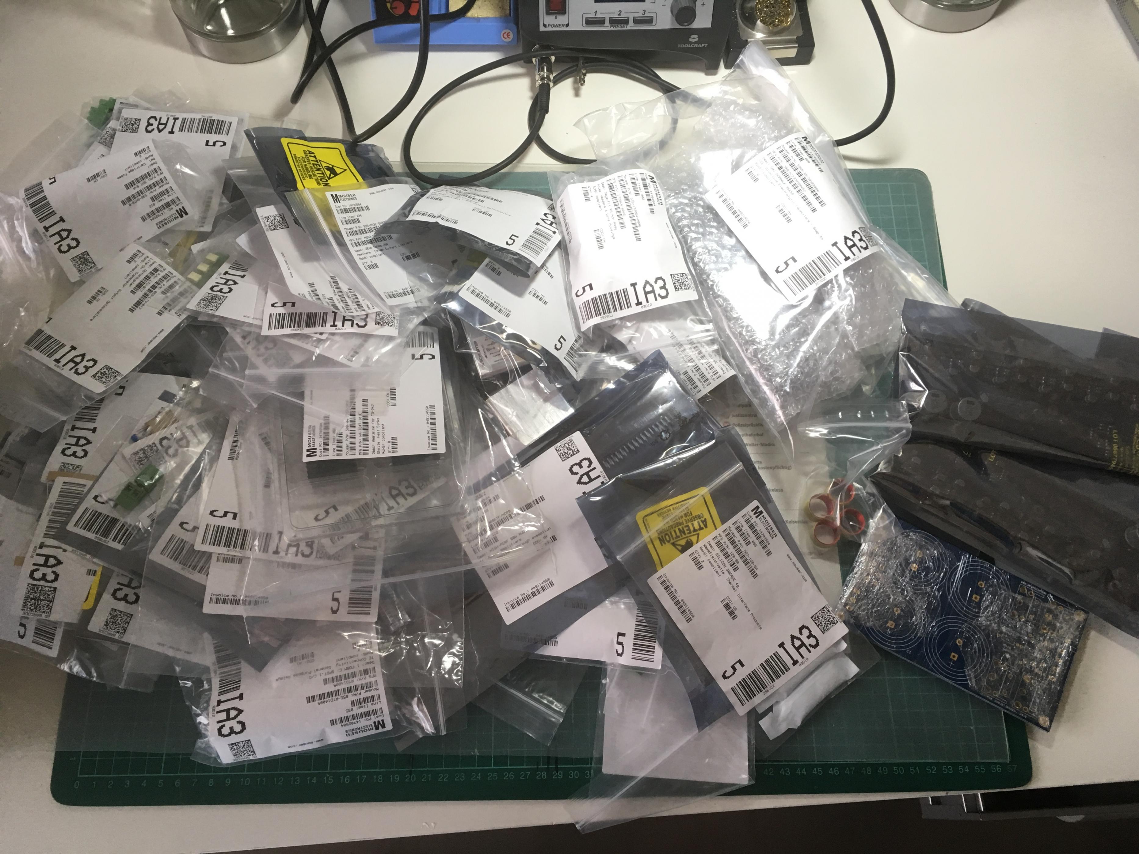

A start....
All came together perfectly. And by the way I am so happy that the Mod686 features the preassembled SMD parts - after all the nitty gritty work on the Mod268, where I got the self solder version.
Also the prewound inductors from Tom, although not cheap, are really a work saver. It’s not only the winding which is cumbersome but even more the removal of the wire coating is quite tedious.
Fantastic! A good start so far.
That was exactly my reaction when I received the quote from the inductor manufacturer. It seems like a lot of money for bent wire (even at QTY = 250!), but man... I don't miss winding inductors. I'd usually spend an hour winding inductors for a stereo pair of MOD686 (or MOD286) boards.
