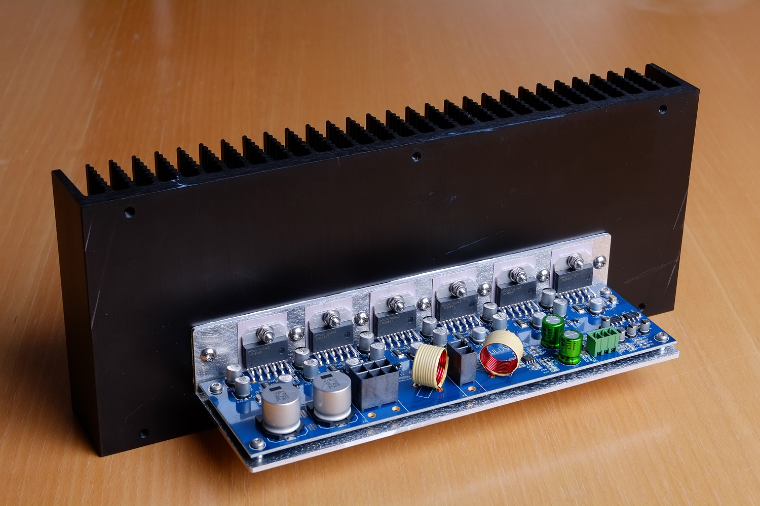

If I've appeared a bit stressed lately, it's because I've pushed very hard on getting a Modulus-686 build together before I head out on vacation (and Vancouver Island DIY Fest). Today, I received the last bits from Digikey, hardware from McMaster-Carr, and - more importantly - two chassis from ModuShop.
Let the building begin!

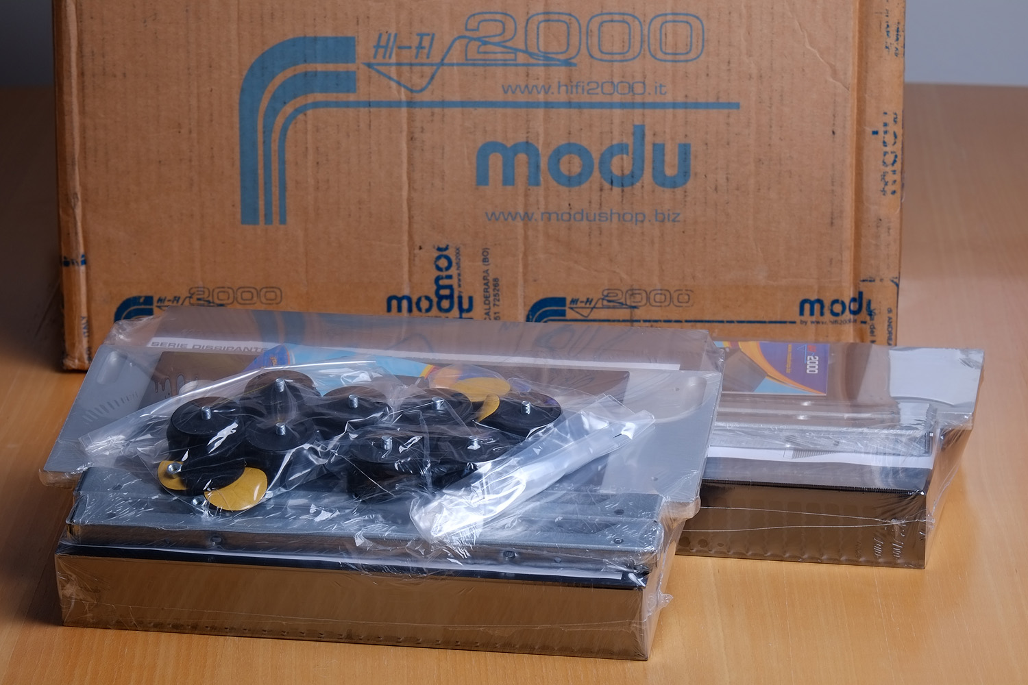

You know you're a small business owner when you geek out over packaging. I love how ModuShop packages things. Each panel is covered in shrink wrap plastic so it doesn't get scratched. Then all the panels and heat sinks are packaged together in more shrink wrap so they don't bang around inside the box. Some may argue that it's a lot of plastic, but it sure is nice to have everything arrive in pristine condition.

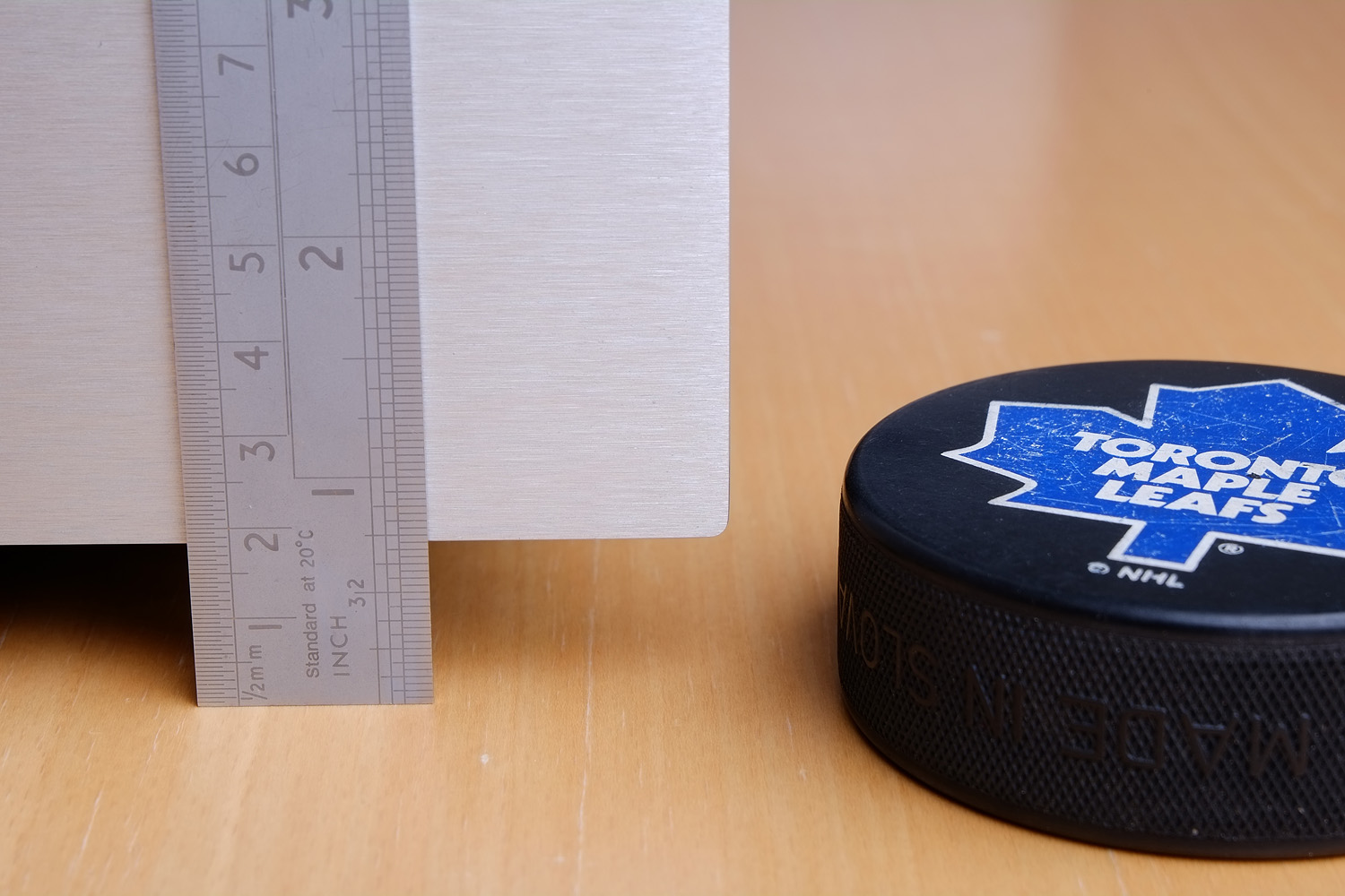

The chassis comes with a basic set of self-adhesive feet. They'll do the job, but I wanted something fancier, so I ordered the vibration dampening feet from ModuShop. They stand pretty tall, so we'll see how they work out. I would have preferred a basic pair of larger round feet (like the vibration dampening feet but without the height added by the rubber used for the dampening action), but it looks like I'll have to get those elsewhere if I end up not liking the vibration dampening feet.

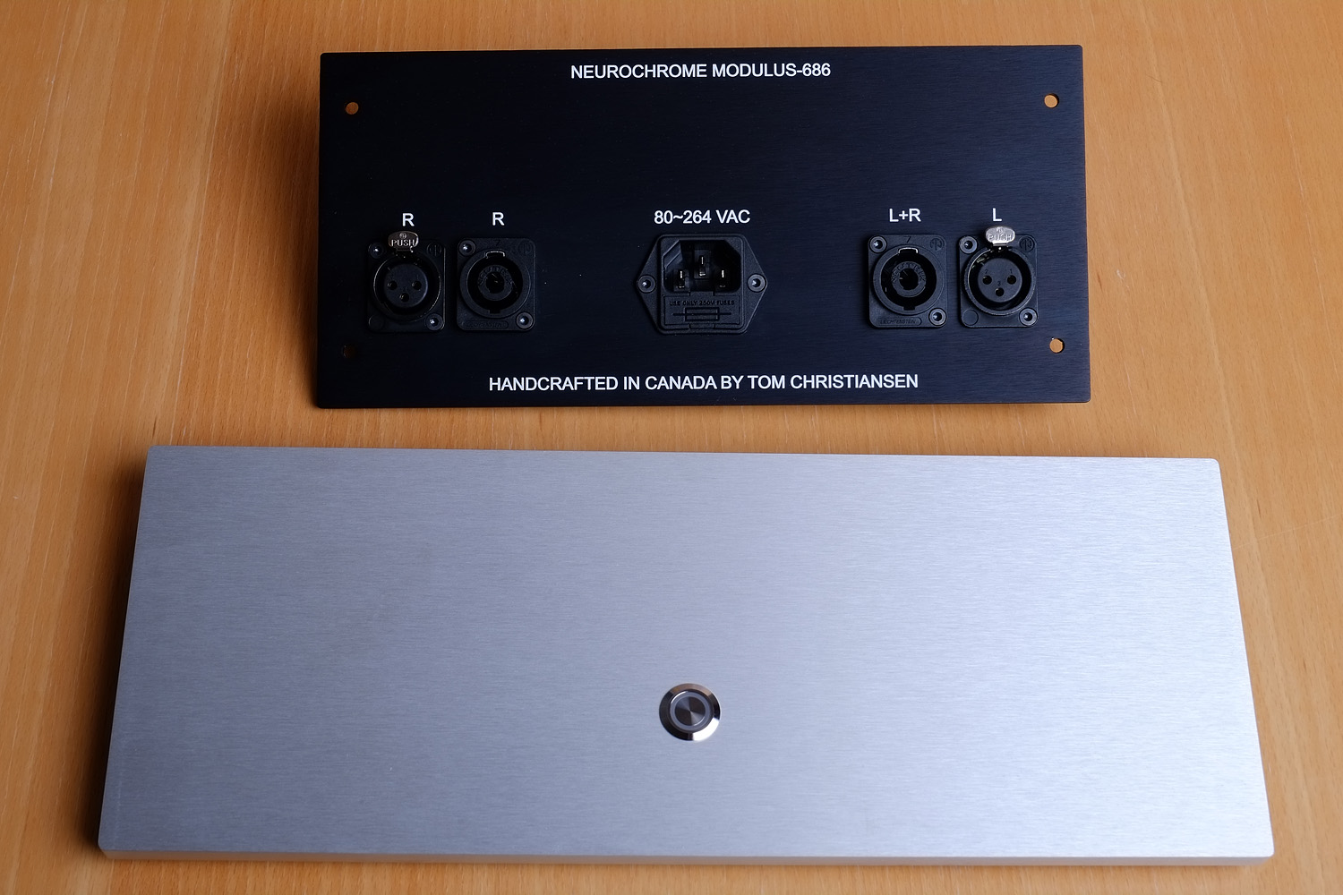

My starting point is a ModuShop Mini Dissipante 3U x 330 x 300 mm. I went with an anonymous front panel and a fairly basic digital print on the rear panel. The print is pure white and stands out very sharp on the panel. I like it.

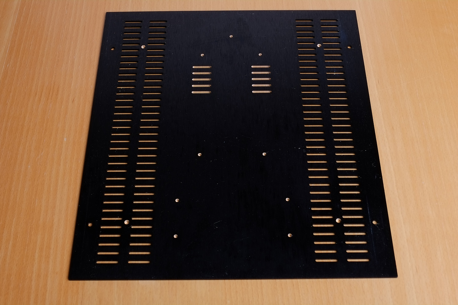

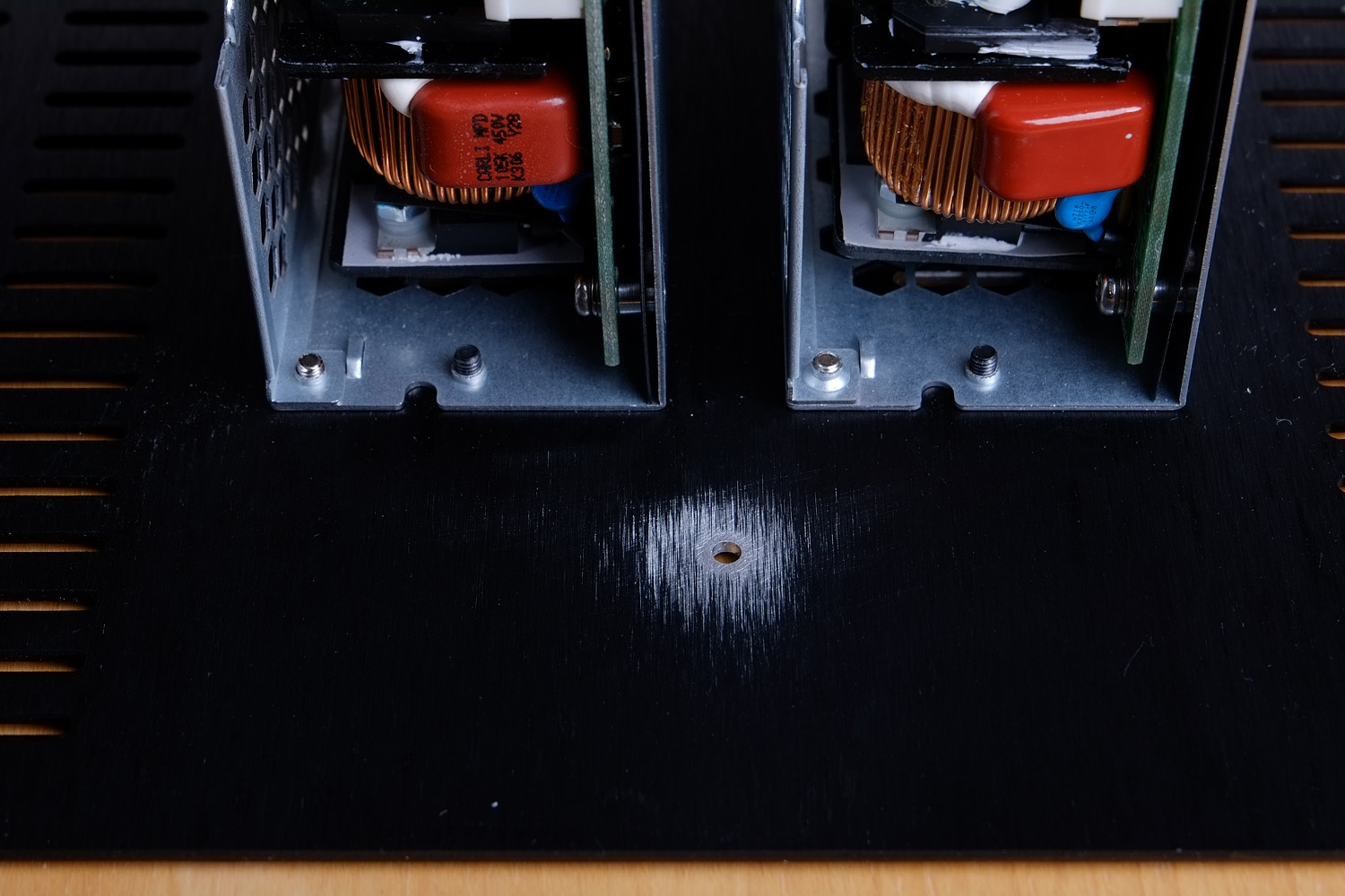

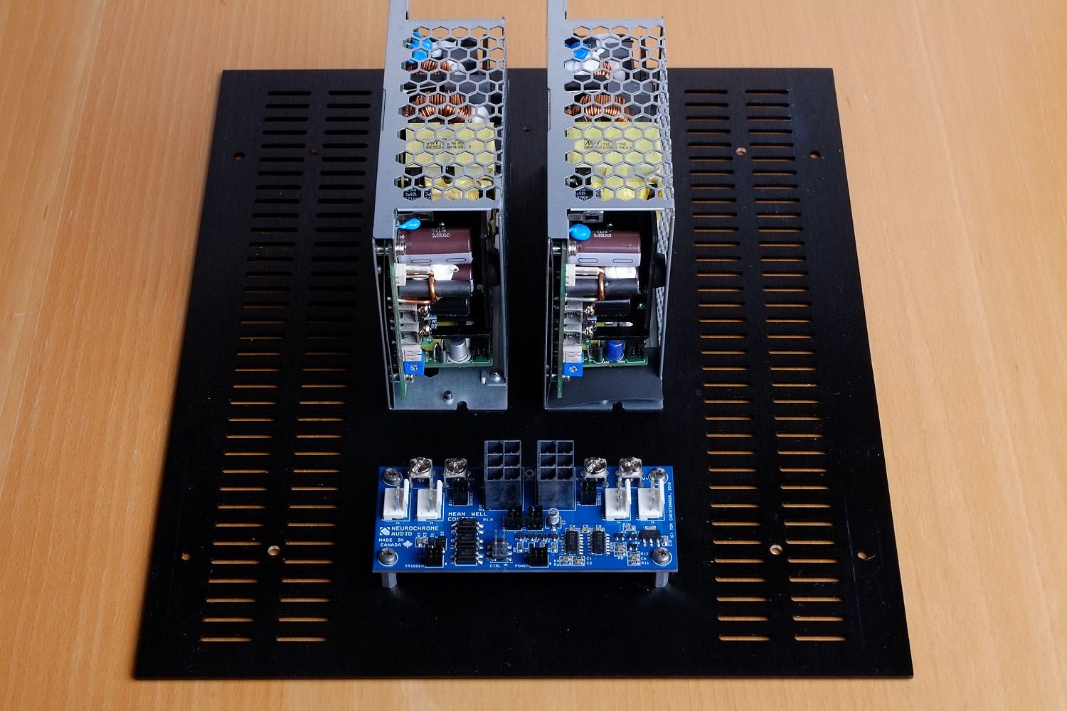

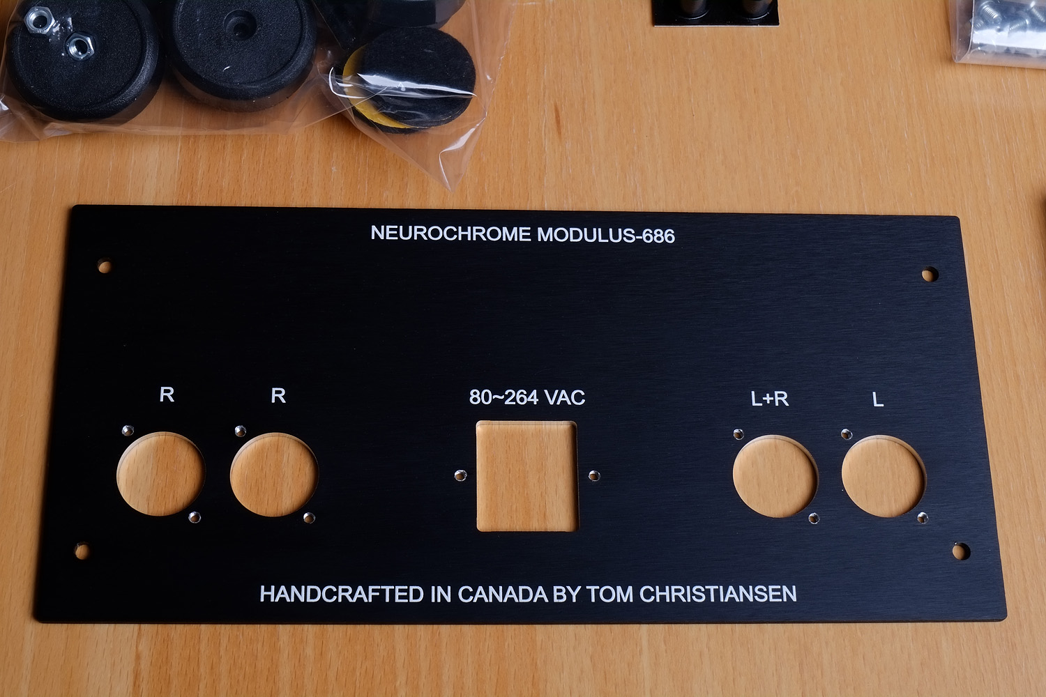

The rear and bottom panels are the most modified. I had ModuShop cut all the holes and thread the 3 mm holes for the mounting screws on the rear panel. I also had them add some ventilation slots on the bottom panel along with a few holes. The last hole in the bottom panel where I've sanded the anodized coating off is for the grounding lug.

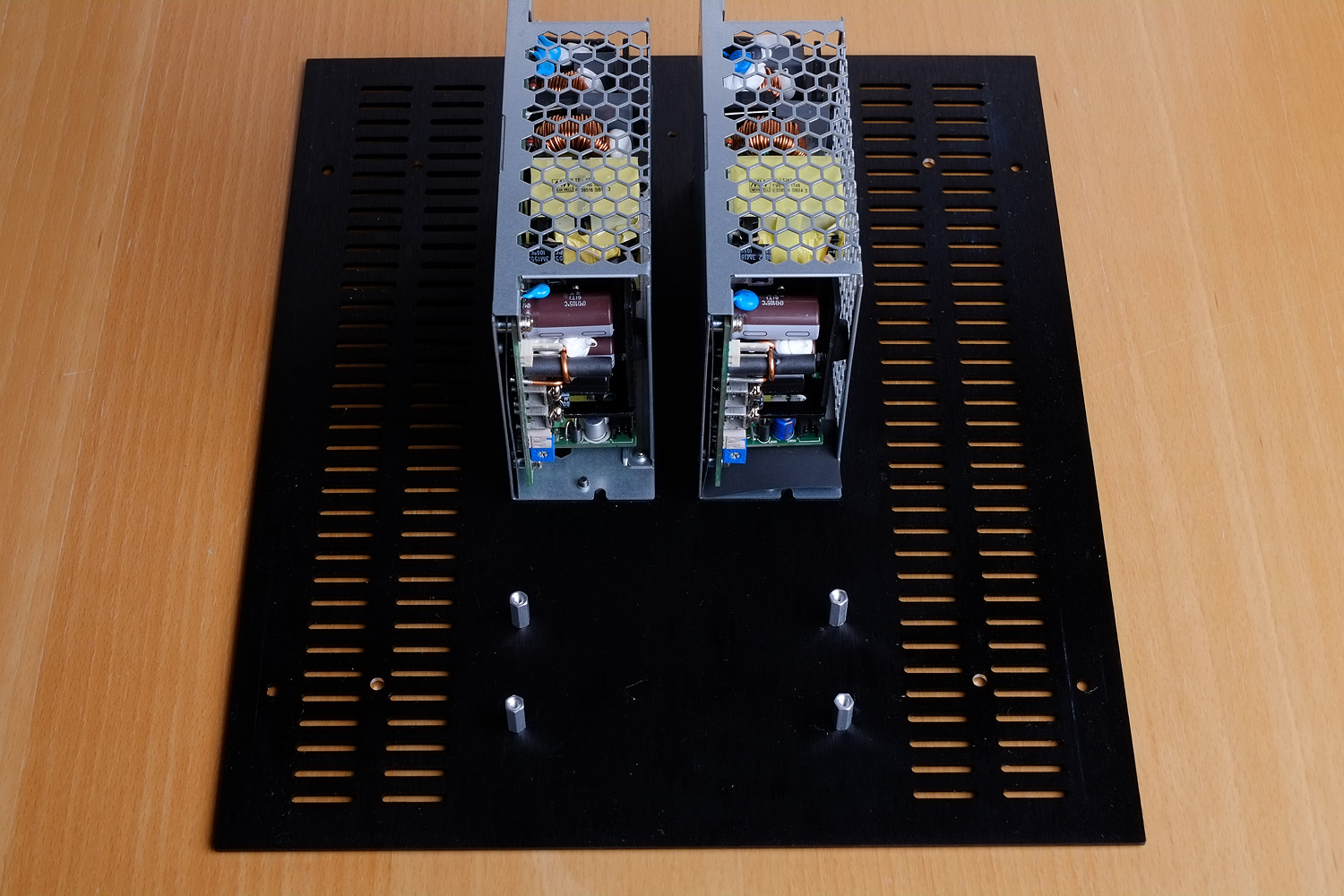

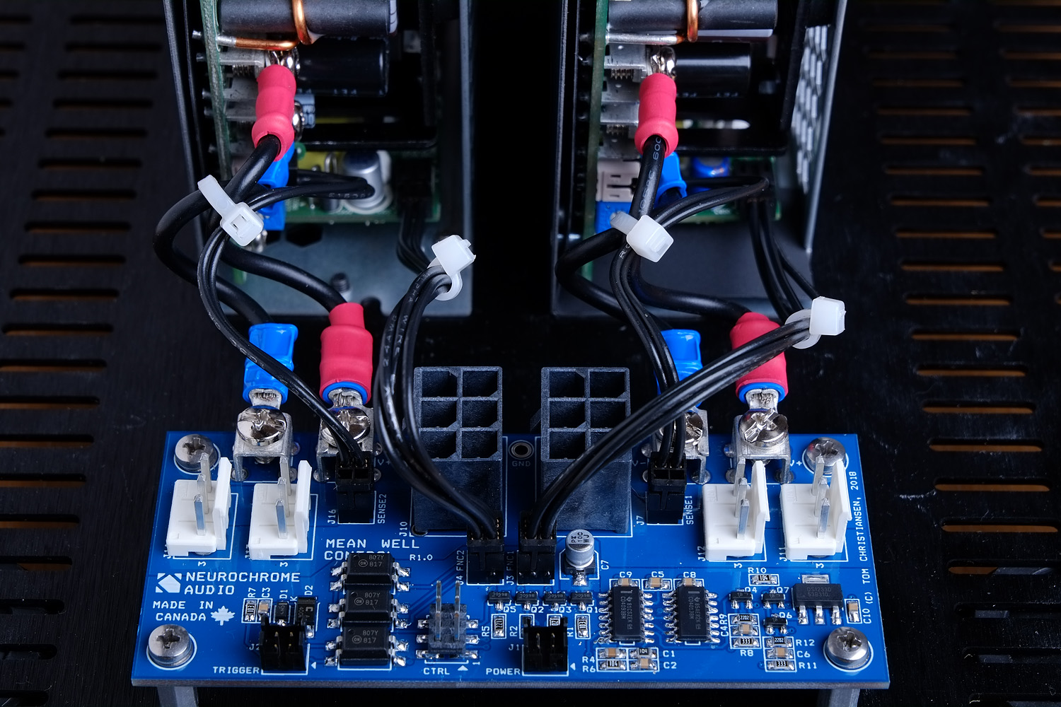

The two supplies are Mean Well RPS-400-27-C and the li'l board in front is the Mean Well Control.

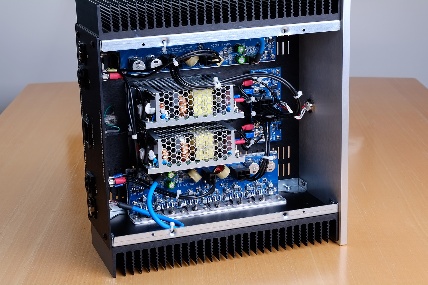

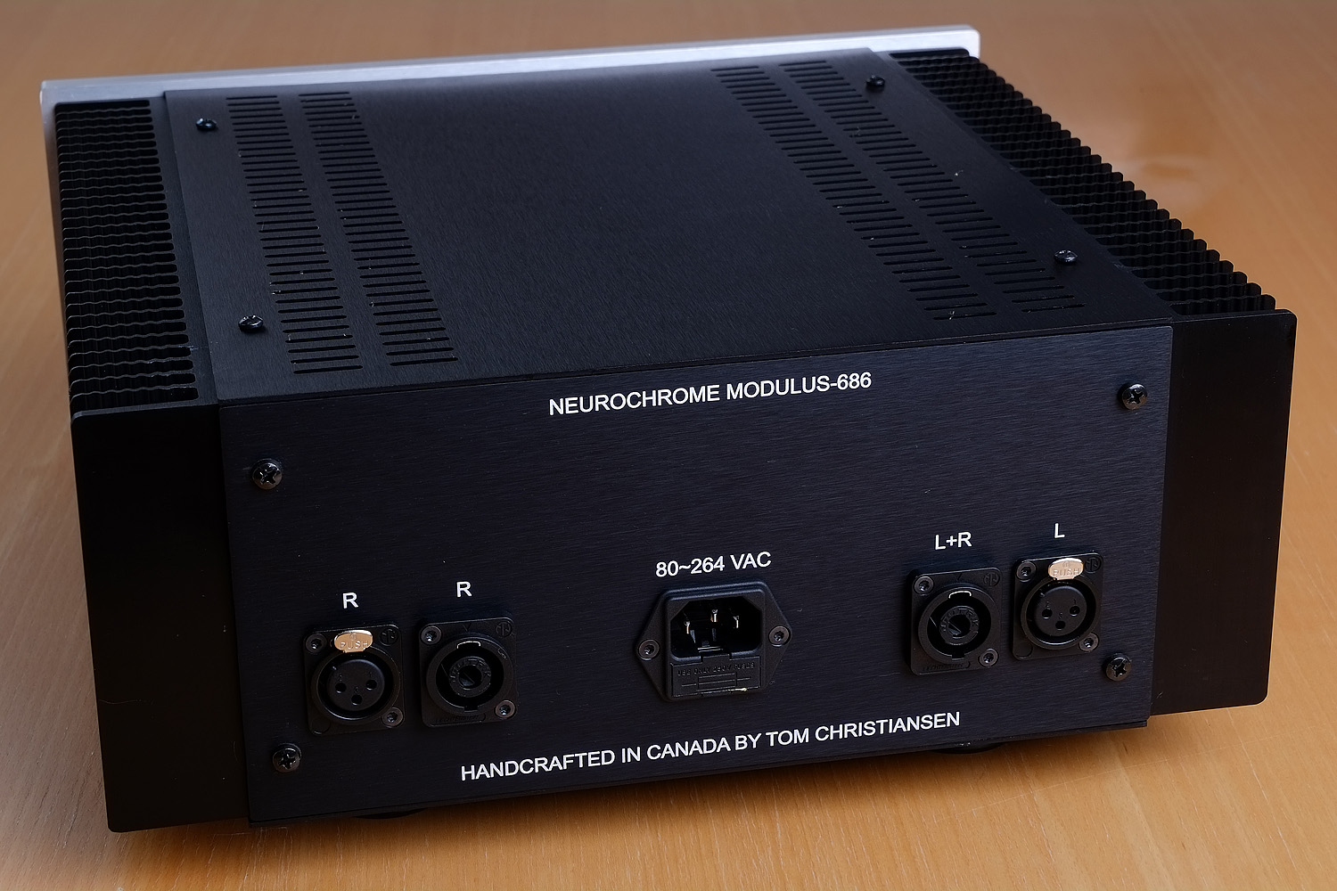

The box is pretty densely packed, but there is enough room for everything. The completed amp weighs in at just shy of 8 kg.

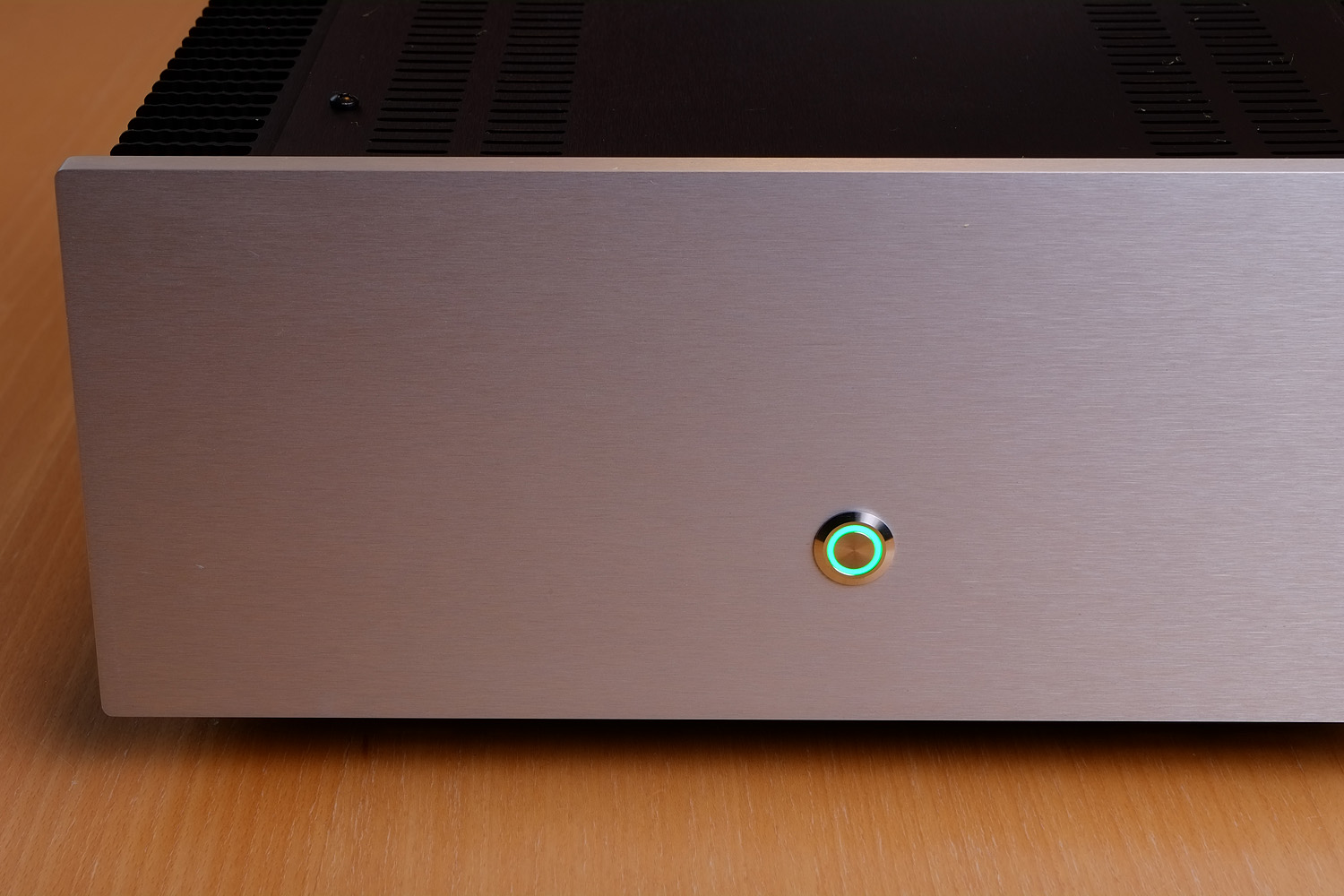

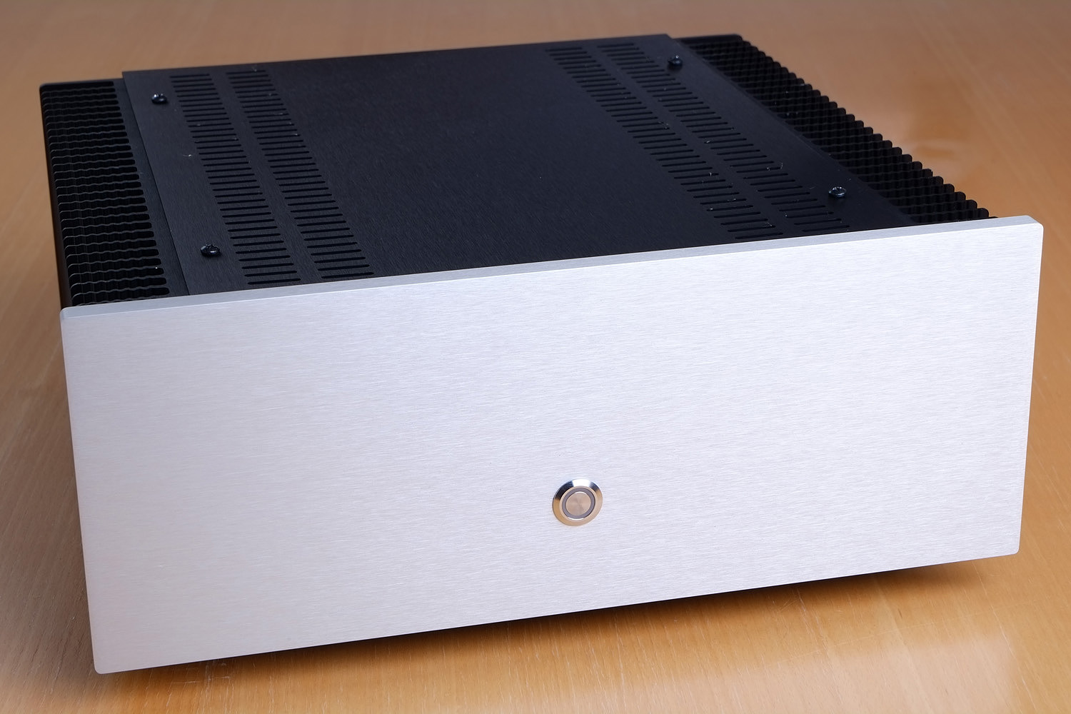

As expected the feet are rather tall, so the amp sits a little proud. I think I rather like it actually. It goes well with the compact form factor of the chassis I think.

Not quite Tom, you forgot the Guardian-686s 😛

By the way I noticed you changed the Molex connectors from 90deg to upright. I considered the same for my built precisely due to space reasons. Could PM my the Mouser part numbers please?
Hockey pucks ?
True. I did consider adding them to the rear panel (or the heat sinks), but ran out of time.
The Molex P/Ns are: 172065-0202 and 172065-0206. There's a slightly less expensive tin plated version, but it's out of stock at Mouser. The tin plated ones are: 76829-0102 and 76829-0106. They're easy to find at the various distributors if you type in Mega-Fit and use their parametric search to narrow down the results.
The compact vertical connectors are new from Molex. They have a little locating peg that it supposed to go into a hole on the board. Well... These didn't exist when I made the footprint for the connectors on the MOD686, so the PCB does not have these holes. You'll have to cut the peg off (which is super easy) and maybe file down the stub a bit if your end cutters leave a bump.
Without the locating peg, you really have to really pay attention when you mount the connectors as if you get the orientation wrong on the power connector you will fry the board. Guaranteed! The locking tabs on the connectors face the heat sink. It's pretty obvious once you have the parts in hand, but you do have to pay attention.
Hockey pucks ?
I like using hockey pucks as a scale indicator. 🙂
I wouldn't be the first ever to use pucks as feet on equipment, though. I've seen them used as door stops as well.
I went with the ModuShop vibration dampening feet. They do the job. They even come with felt pads that you can stick to the bottom, which is nice. They just seemed a bit overwhelming when I looked at them in the bag they came in.

At ±27 V with 4 Ω load and "music" (AP 32-tone) signal played at clipping levels, the heat sinks on the ModuShop Mini Dissipante 3U x 300 chassis reach 62 ºC with 23 ºC ambient. This is hot enough that you can't hold on for more than a second or two - so if you need to move the amp, you'll need gloves!
Thus, I stand by my recommendation of using the 3U ModuShop Mini Dissipante or Dissipante chassis.
If you're using 8 Ω loads only, you'll likely find that the 2U chassis is enough. However, I cannot with good conscience recommend that people build an amp that I know will not operate for hours with music at clipping levels with a 4 Ω load.
All that said, the MOD686 passes with flying colours.
