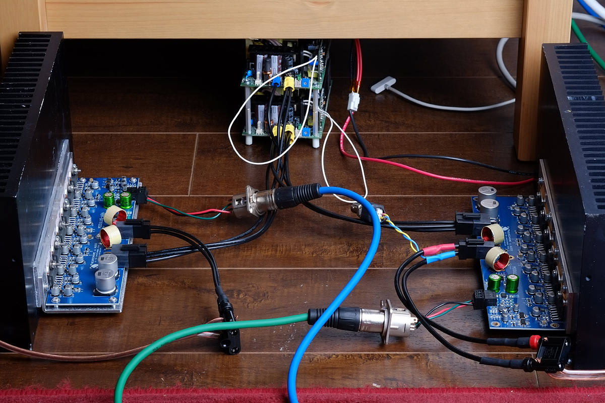

Today I took delivery of two Mean Well RPS-400-27 power supplies from Mouser. I connected them in series to form ±27 V. Plugged in two Modulus-686 modules. Man.... That's a nice amp.
130 W into 8 Ω; 200 W into 4 Ω. Plenty of power. I have each module on a 0.4 K/W heat sink, which reaches a bit over 60 ºC after about 20 minutes with the amp delivering 65 W (sine wave) into 4 Ω (1974 FTC test). I would not go smaller on the heat sinks. Coincidentally, the thermal resistance of the heat sinks on the 3U, 300 mm ModuShop Mini Dissipante is 0.4 K/W. How 'bout that.
A pair of MW RPS-400-27 provide enough power for a stereo amp intended for music reproduction. With both channels running in phase, the supplies don't quite have enough oomph to drive the amp to clipping with a 20 Hz sine wave and 4 Ω load. You "only" get 150 W (4 Ω) at 20 Hz with both channels running in phase (worst case test condition). For music or mono operation, I have no reservations.
Spinning Dire Straits, "Brothers in Arms" (which should surprise exactly no one). Man... What an amp! And what a recording.
Tom
