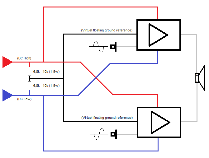

Hi Tom,
Because Modulus-686 is a bridged amp come to speculate if it can run from a single supply and virtual ground as Sansui used lot back in eighties, wearing my audiophile glasses 😀 (get your audio off the ground) have always thought about below single supply block diagram that it looks very clean and beautiful, no common modes and no cold dirty speaker returns anywhere, cost of higher voltage capacitors for linear supply will take a hit but if performance numbers also increase a little bit some will probably like that.

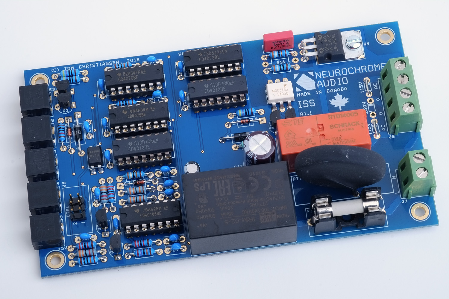

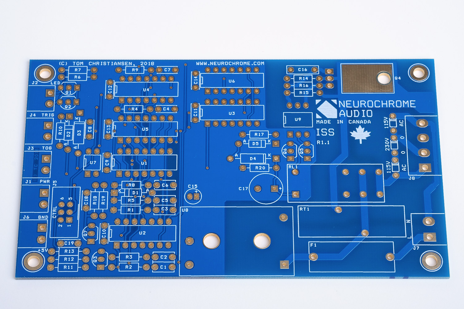

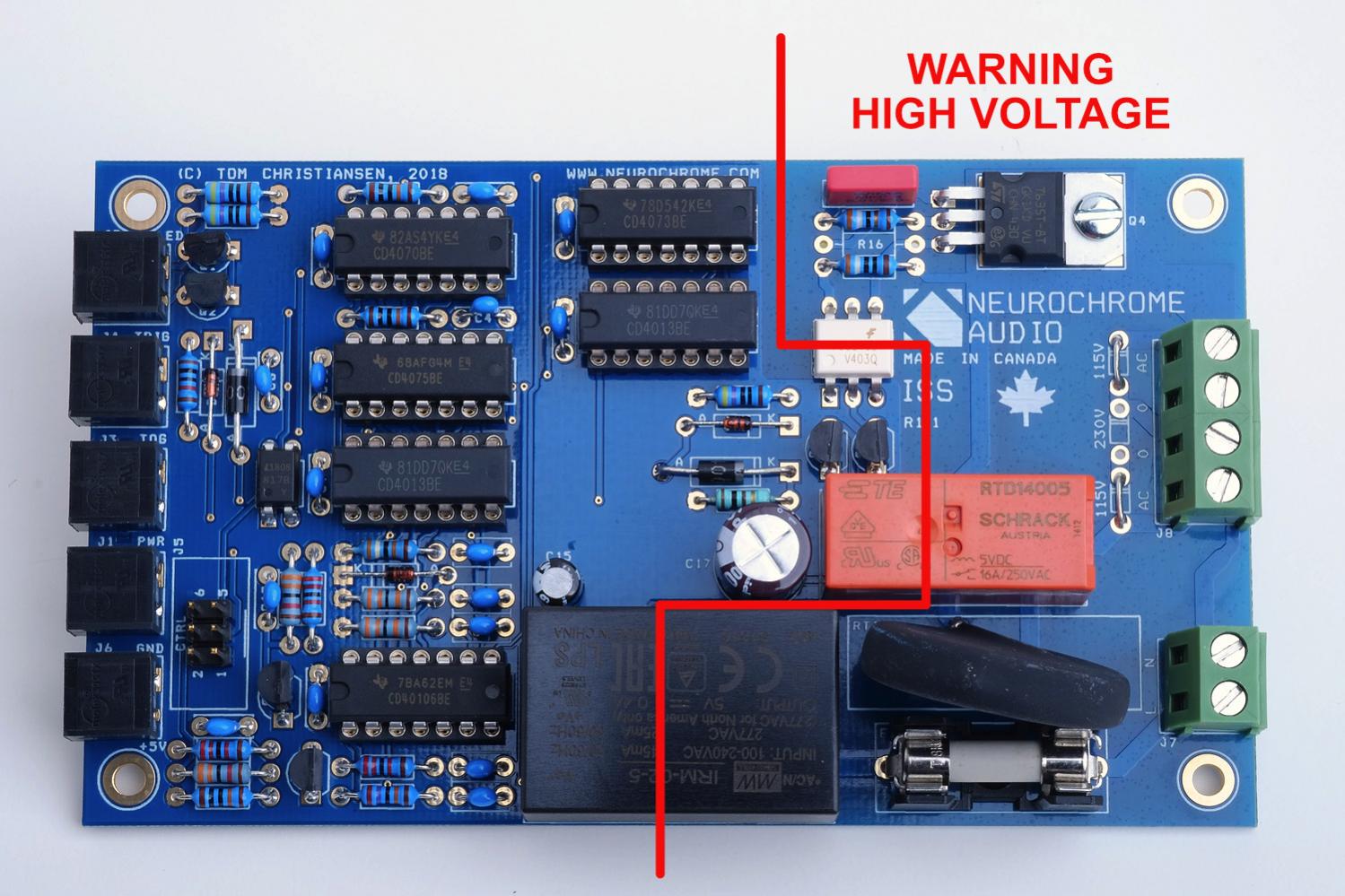

The Intelligent Soft Start is now ready for prime time. Boards are in stock! Images attached. Description here: ISS: Intelligent Soft Start
I've learned quite a bit building that circuit and discovered some failings of the commonly used resistor-based soft starts. I'll need to gather my thoughts and start a separate thread on that topic.

The Intelligent Soft Start looks good. Tell us more about it vs other solutions when you get time.

You'll get the highlights of the ISS vs other solutions by following the link to its page on my website that I linked to in Post #505. Also note that the description page has a link to an old HP Journal, which details the HP 14570A power controller. The ISS can be viewed as one channel of a 14570A power controller and the HP Journal is a good read.
In addition, considerable effort went into the selection of the NTC resistor used in the soft start. I optimized the circuit to ensure a fast startup while also limiting the inrush current.
Part of my design process was to compare the NTC-based solution with the more common (in DIY circles anyway) power resistor-based solution. I found the solution based on power resistors to be inefficient at limiting the inrush current as the current limiting resistor is usually way too large. While this does limit the initial inrush, the second inrush, which occurs when the relay closes and shorts out the resistor, is almost as large as the inrush current without any limiter. Basically: The power resistor-based inrush limiters are inferior to the NTC-based limiters, even when optimized.

I'm about to start populating the ISS board, but I cannot find the detailed component mapping in the ISS docs.
The Mouser project lists all the components but does not list where to mount them (R7, R7, etc..)
Am I missing something?

Another question is regarding the connection from the ISS to my 4 meanwell RPS-400-36 PSU's..
The ISS documentation states to either configure for 115v or 230v.
I am assuming this configuration has to do with connecting the ISS to transformers as they typically need the primary wired in series
If I omit the wire bridge for 230v, am I correct in assuming that the output of the ISS will have two 230 VAC outputs (J8 --> AC | 0 | 0 | AC)?
Or do I also need the bridge for 230VAC above J8 when using the Meanwell SMPS's?

Argh!! It looks like I forgot to include the BOM in the design doc. I'll fix that when I get home. I travel on July 3rd, so expect the doc to have been fixed by July 4th or 5th. Sorry for the omission.
Yes. The BOM... 🙂

Configure the board for your local mains voltage. Then hook the Mean Well supplies to the two AC terminals (terminal 1 and 4). I forget which is the live and which is neutral. You can easily trace the neutral on the board. If I recall correctly, terminal 4 (oval pad) is the Neutral and terminal 1 (rectangular pad) is the Live.
I should add that to the doc as well.
