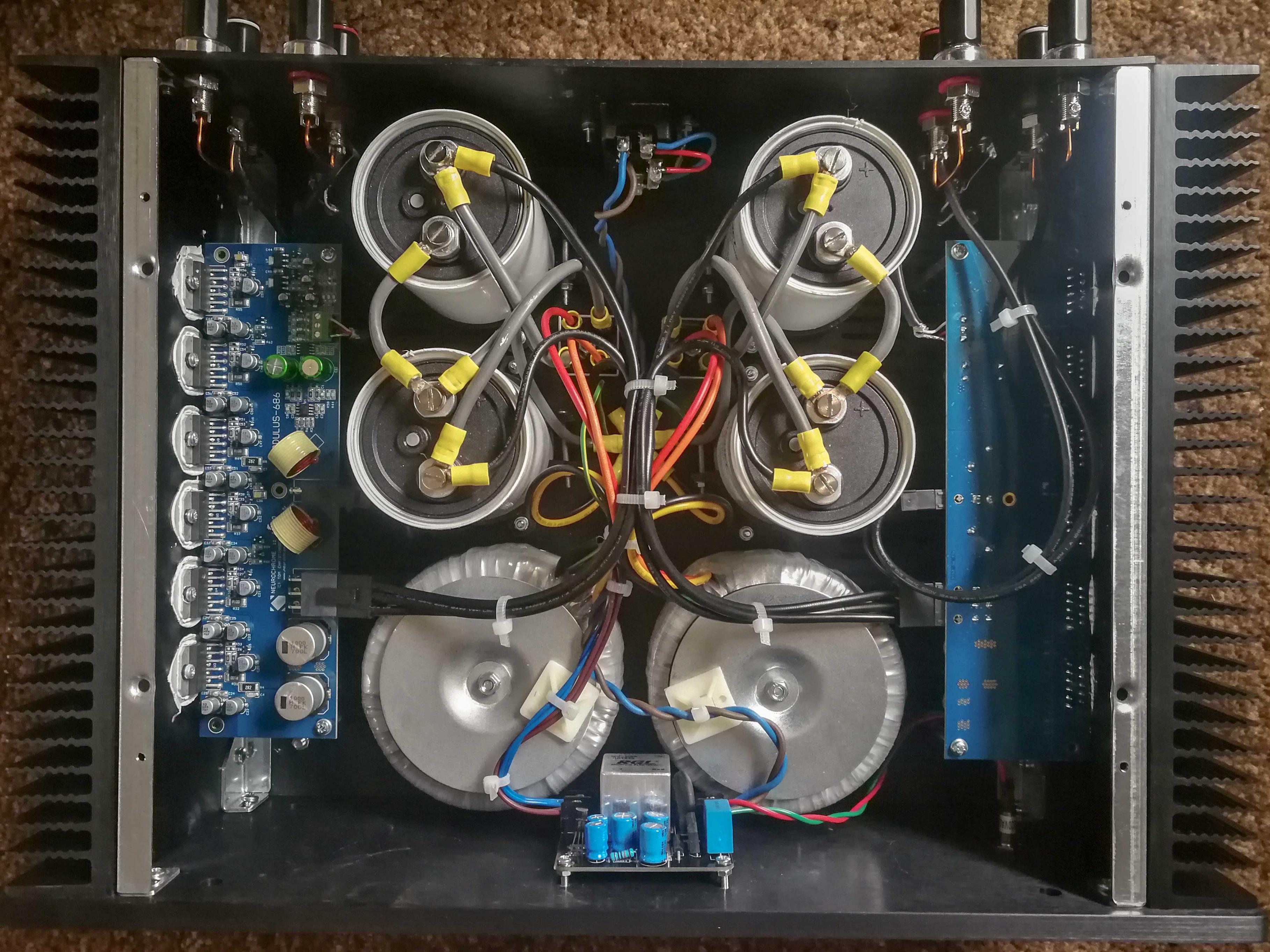

I've decided I'm going to need more room to install speaker protection, so I've installed a pair of 32v switchers instead of transformers and capacitors. I'm getting approximately 200w into 8ohms, and 300w into 4ohms with this combination. I'm pushing the heat-sinks (and my dummy load 🙂) at this power into 4ohms I know, but I'm never going to go anywhere near 300 watts playing music at home.
Hopefully ill now have enough space to fit a pair of Guardian 686s when available.
Nice! ±28-32 V is my favourite operating point with the MOD686. You get a good amount of output power with a thermal system that isn't quite unwieldy yet. Nothing wrong with the ±36 V if you really want to max things out, but it does push the thermal system a bit further. Physics and that... 🙂

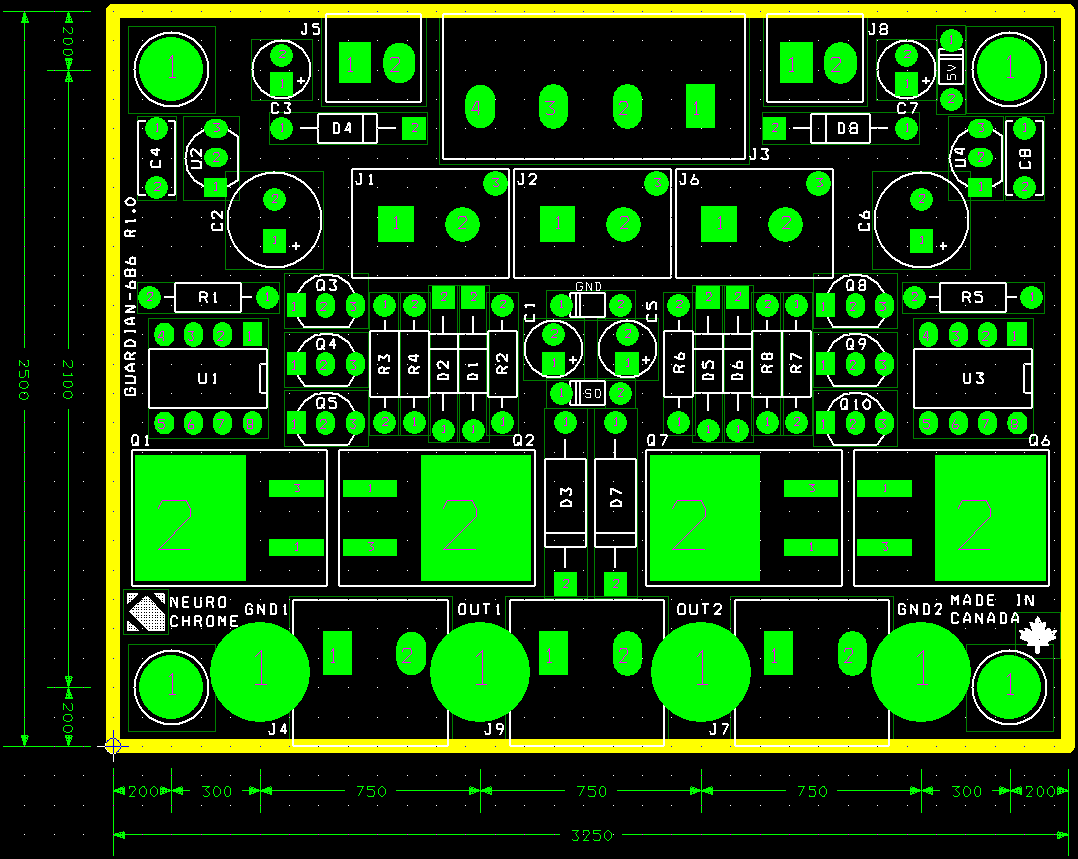

That'd be cool. I seem to recall the board dimensions landing around 3.25 x 2.50 inches. I forget exactly where I ended up with that project, but I seem to recall being ~90 % done with the component placement, so the board size shouldn't change by much from this point.
The Guardian-686 is two Guardian-86 on one circuit board with provisions to operate the board in stereo, dual mono, and bridged configurations. The latter is what you'd use with the MOD686.
As with the Guardian-86, the Guardian-686 will feature both terminal blocks and holes for binding posts (at 0.750"/19mm pitch) located along edge of the board.

Do you perceive any audible differences with these SMPS’s compared to your previous PSU with torroids?
Condolences Tom. I lost my Dad in very similar circumstances.
Dave.
Nice one!
To be quite honest and to my relief I would say there was very little difference. If I was pushed to make a decision I would say the switchers sound better.
One plus though, my amplifier is now totality silent, as I was getting some mechanical hum from the toroids.
