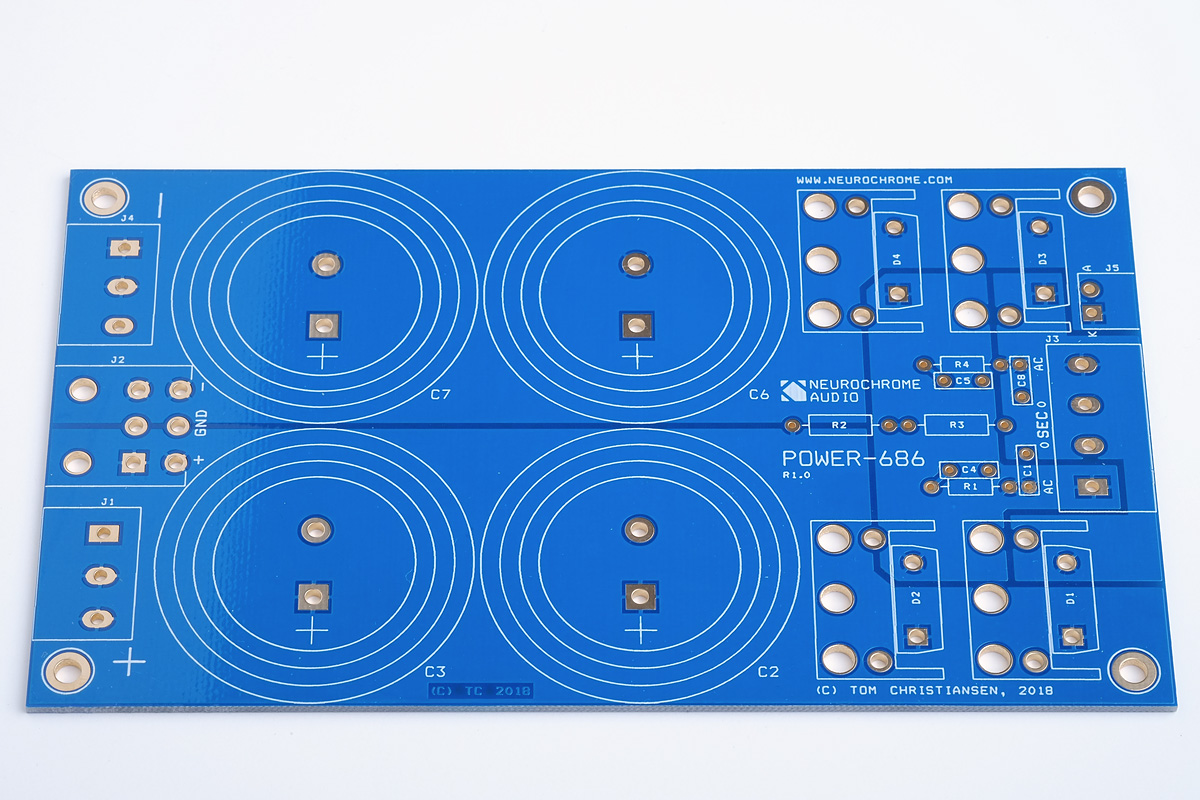

The Power-686 is taking shape.
I decided to spin the soft start circuit off as a separate board as it made the supply board really unwieldy. Something tells me it'll be easier to sell the boards if they actually fit in any available chassis... 🙂
The Power-686 measures 3.30 x 5.70 inches. The assembled height will be just shy of 60 mm, including the pins that protrude through the board.
Tom
Tom
It’s a bo👍ard. Nice. When does it go on sale?
When do you estimate will the softstart board be ready?
Tom
Can you use indifferently transformers with two separate secondary or with one secondary with central wiring?
Thanks! Gimme a couple of hours. I plan to get it on my website tonight. $59 for the bare board.
Early July. Maybe sooner if the prototyping goes well.
Absolutely! You can use a transformer with two secondary windings and transformers with one centre-tapped secondary with the Power-686.

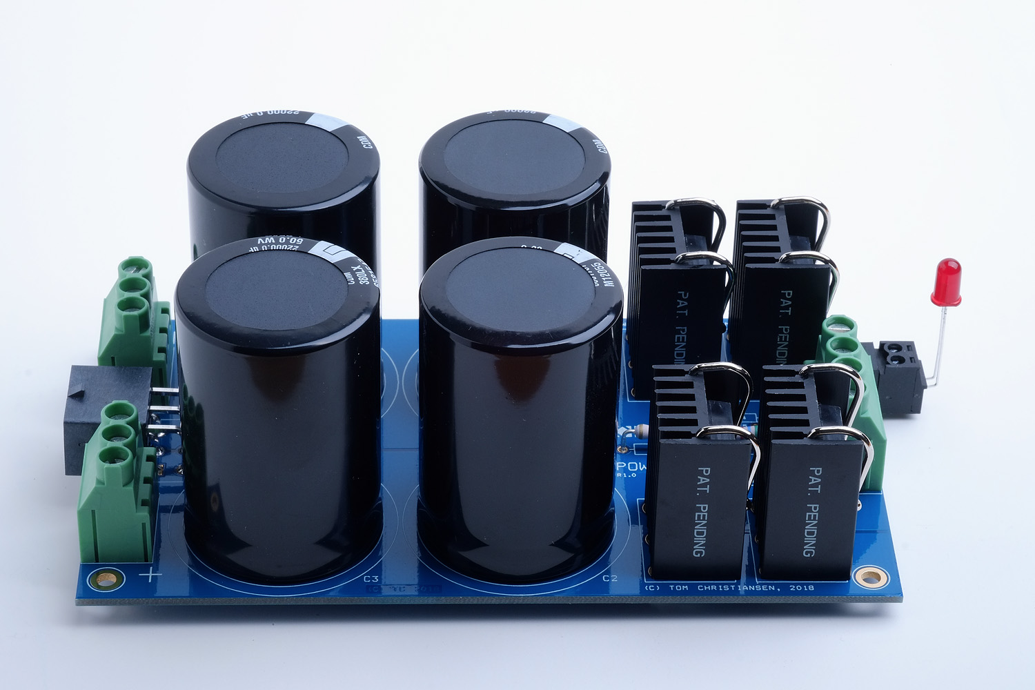

The assembly is shaping up.
Tom
The Power-686 is now available for purchase on my website: Buy your Power-686
You can find the list of features and other details here: Power-686
Tom
