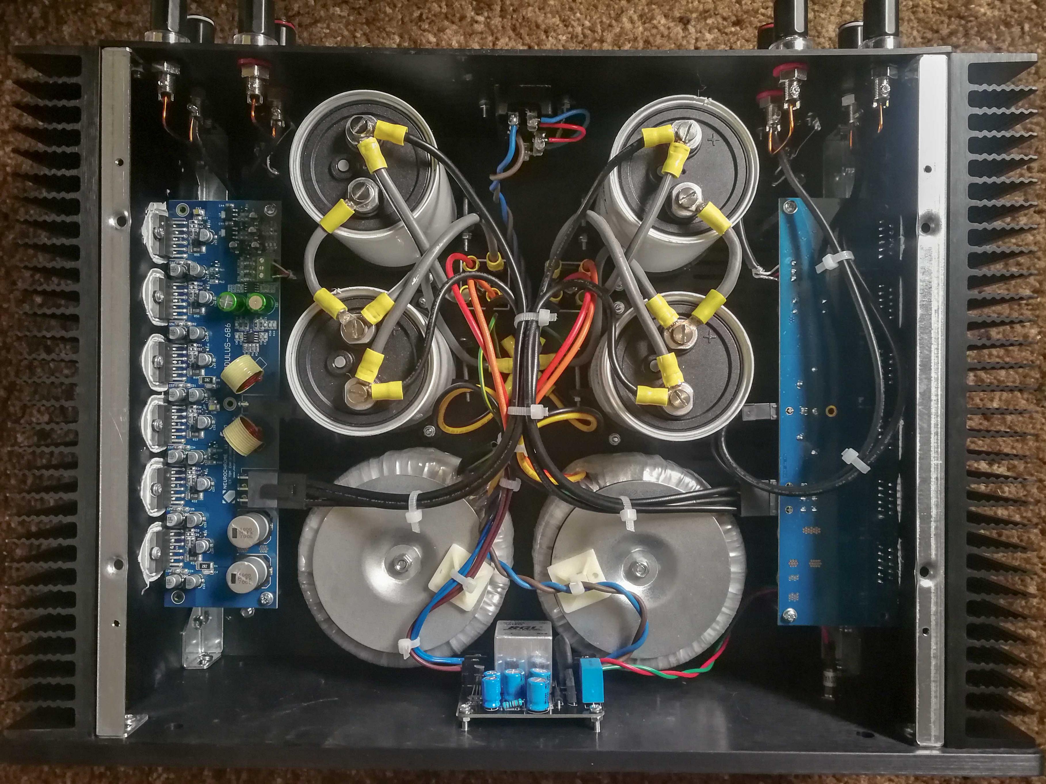

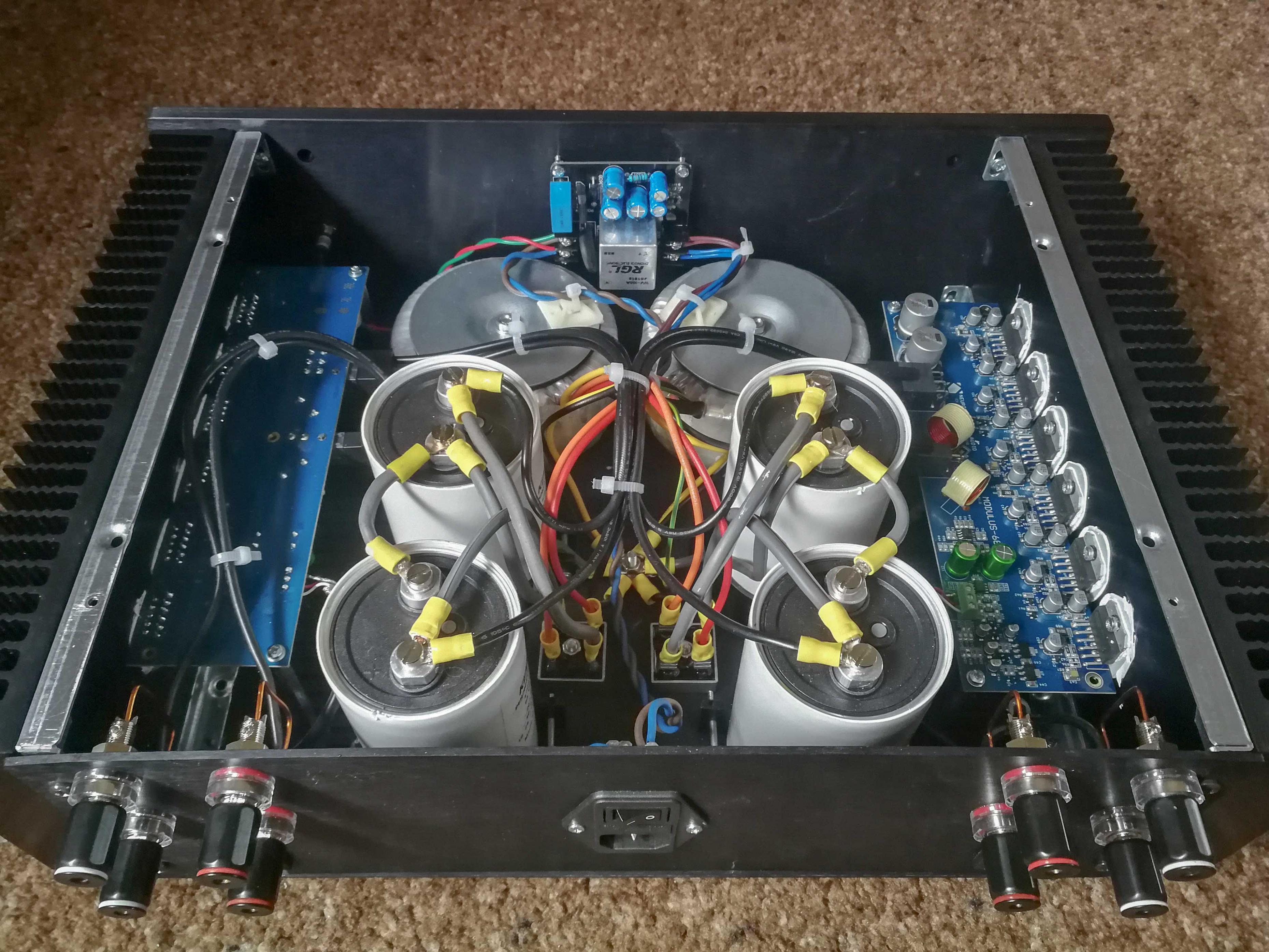

My version of this amazing amplifier. I thought id share my experience of building this amplifier.
I went for a 3U Modushop case, 300VA 22V Airlink transformers, and 47000uF Kemet PEH200 capacitors. The soft start and speaker terminals came from Ebay, capacitors from Elektro Dump, most of the rest came from Farnell.
Anybody that has experience of using basic tools such as, Soldering iron, tape measure, pistol drill, files, screwdrivers Ext is capable of building this amp.
It was a bit of a squeeze fitting everything in due to the large capacitors I chose to use, but managed to just fit everything in. I mounted one board upside-down to keep the wiring symmetrical and the input away from the transformers. Mounting the Lm3886's was a bit messy as I used far to much thermal grease with the mica insulators. I soldered in the Lm3886'S by just to pins at first, marked out the holes and soldered the rest of the pins when the chips were fully mounted on the heat sinks. Most of the power supply wiring was done with some old speaker wire that I had left over. Everything else was fairly straight forward marking out drilling and filing.
After double checking the speaker terminals and Lm3886's were not shorting to ground, the polarity of the capacitors and rectifiers, I powered up, much to my relief everything was fine with only .5mv at the output and sweet sounds emanating from my speakers.
Huge caps! What are they? Looks like evox rifa.
Directly from the text you quoted: "47000uF Kemet PEH200 capacitors". A Google search for exactly that term returns the data sheet: http://www.kemet.com/Lists/ProductCatalog/Attachments/391/KEM_A4034_PEH200.pdf

At that price I had to use them. They only just fit vertically in a 3u case though. The terminals are only about 5mm from the top of the lid. I've stuck a piece of sheet rubber on the underside of the lid for safety.
