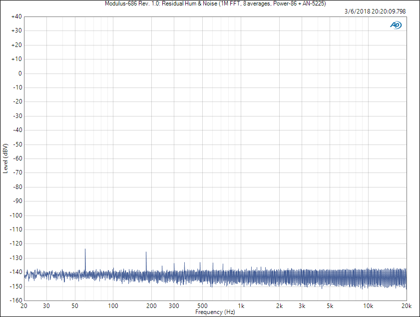

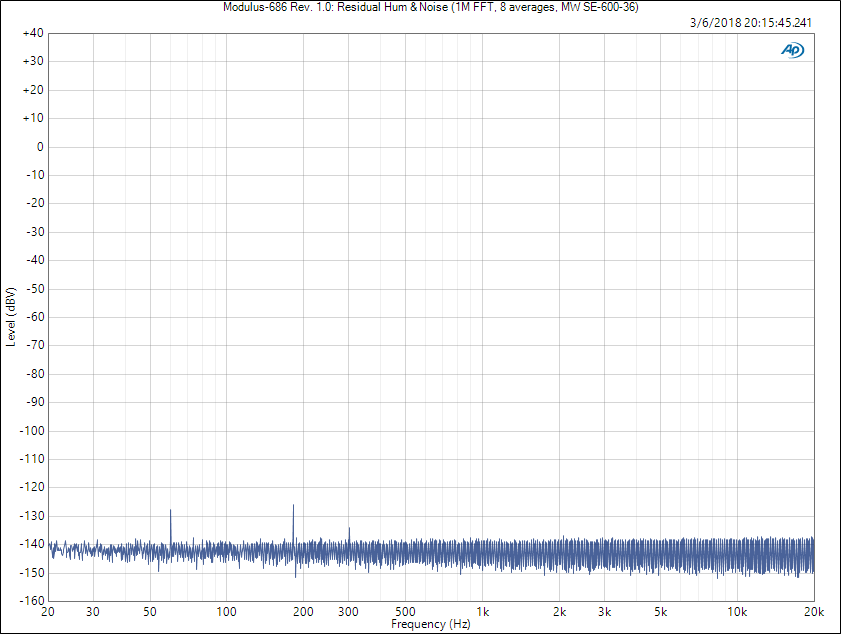

Speaking of measurements: Here's a pair of residual hum/noise measurements. One with the SMPS. The other with the Power-86 and Antek AN-5225 transformer.
The integrated noise measures 31.5 uV (unweighted); 25.0 uV (A-weighted).

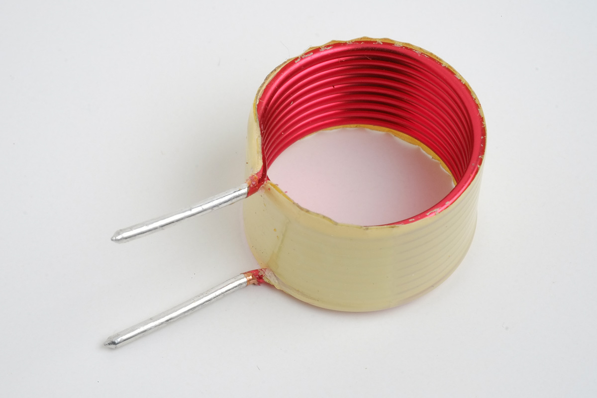

In the meantime, are the inductors the same size / number of turns as those used in the Para 86?

The inductors are the same as those used in the LM3886DR and Modulus-286. I had a bunch professionally wound and am selling them on my website. You'll need two of these per Modulus-686 board. I'll provide instructions for how to make the inductors for those who'd rather make their own.
In future designs (think Modulus-286 Rev. 2.0) I'll use this standard inductor.
Excuse me, Tom, these are only the PSU measurements or the Modulus powered with two differnt PSUs?
The noise measurements in Post #245 shows the residual noise and hum of the Modulus-686 when powered by the Mean Well SE-600-36 and Power-86 + Antek AN-5225, respectively.
Tom
-125 dBV (~500 nV) isn't quiet enough for you? Many amps, in particular tube amps, have approaching 1 mV of mains hum.

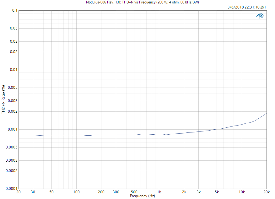

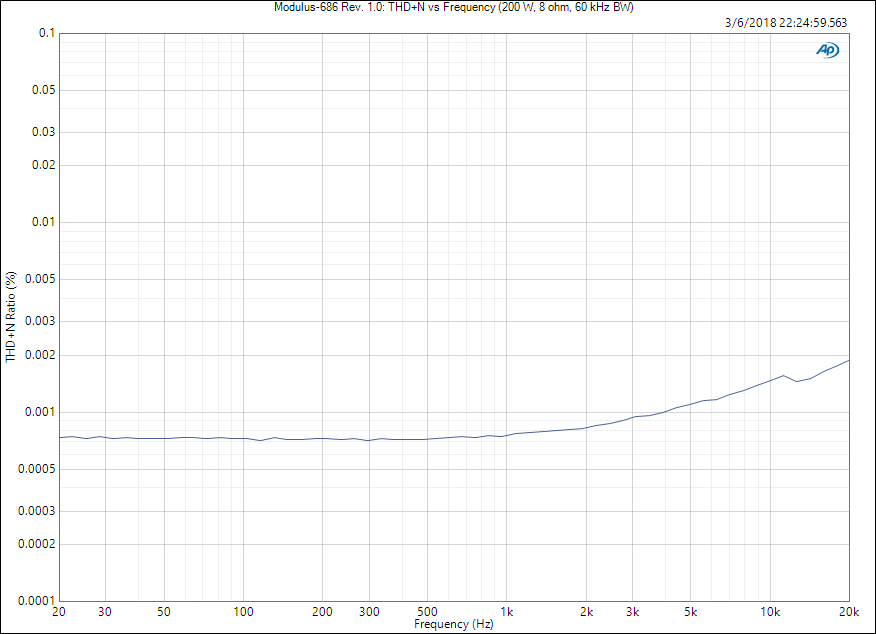

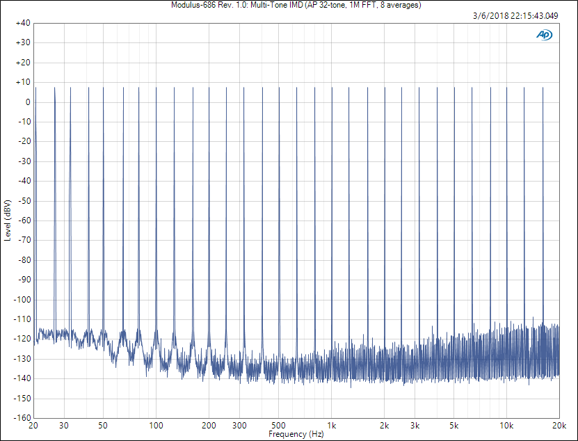

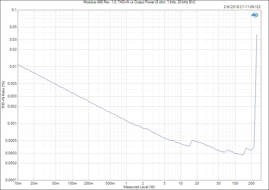

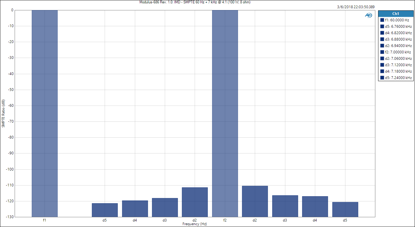

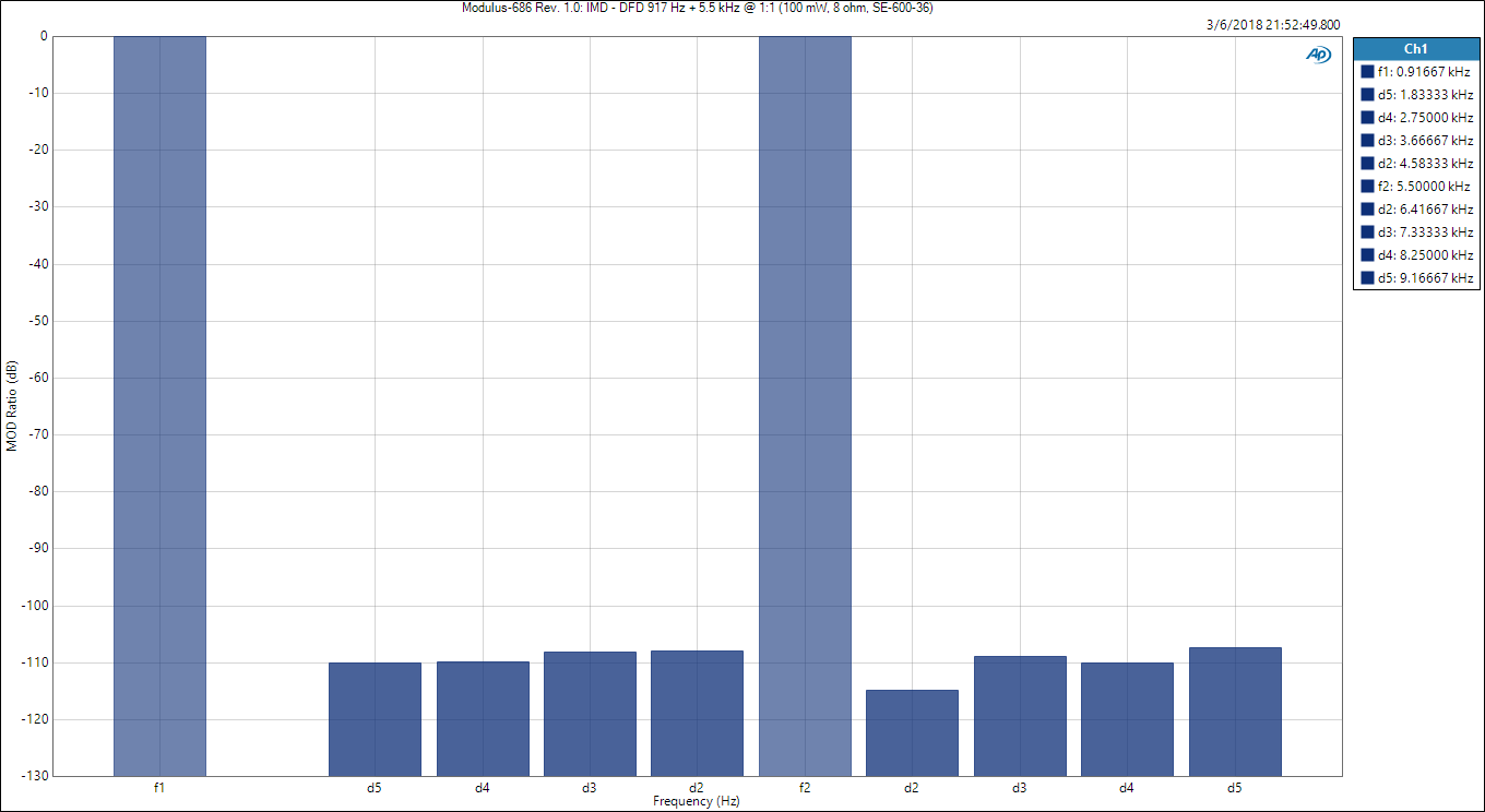

THD+N and IMD measurements.
The THD+N plots mostly show the THD+N floor of the APx525 signal source. The IMD plots are more interesting.
Siegfried Linkwitz speculates based on the Fletcher-Munson curves that a 1 kHz + 5.5 kHz IMD correlates well with the perceived listening experience. He performs this measurement at 100 mW and 1 W. The closest I could get with the AP was 917 Hz (5500/6 Hz) + 5.5 kHz. The Modulus-686 is about 20 dB better than the best amp shown on SL's website.

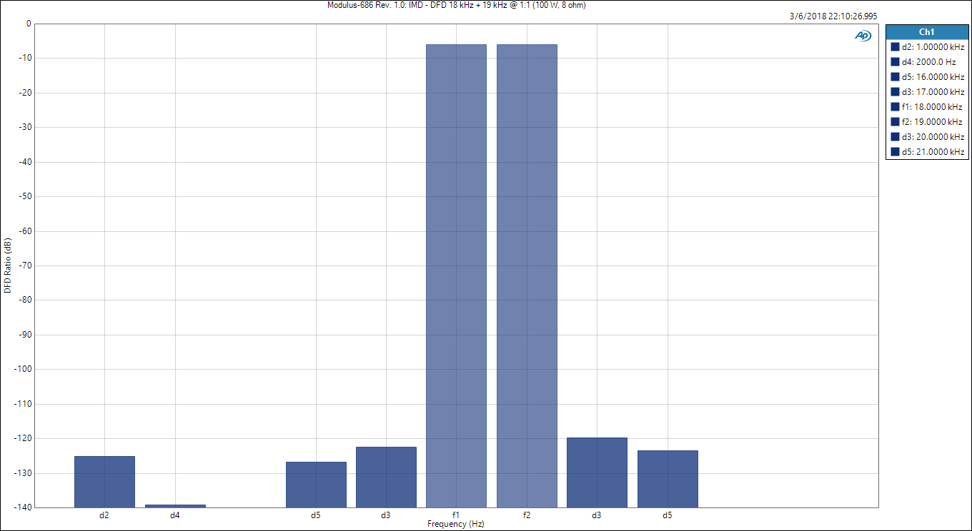

The 18+19 kHz and SMPTE show no surprises. Just rock star performance.
The multi-tone IMD residual of -110 dBV is rather spectacular as well.

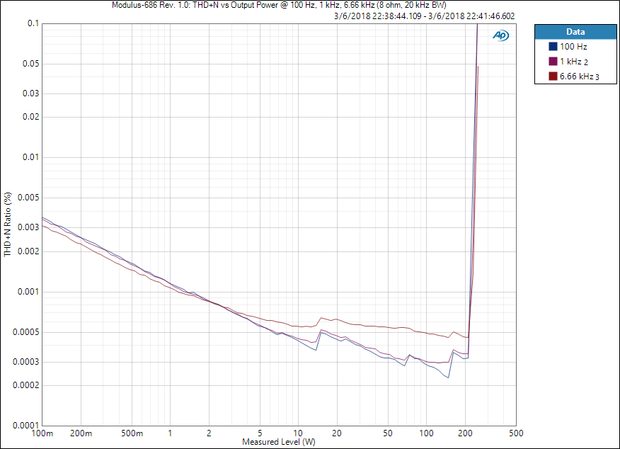

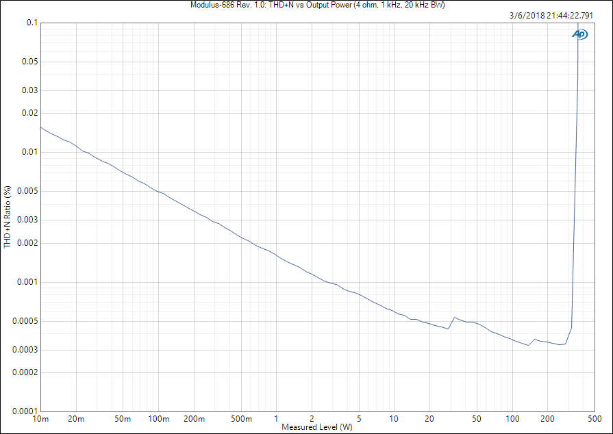

For fun I ran the 100 Hz, 1 kHz, 6.66 kHz THD+N vs Power sweeps (20 kHz BW). You often see these measurements for Class D amplifiers, so I figured I'd showcase the fact that the MOD686 is about two orders of magnitude lower THD+N than many Class D amps (specifically, I compared with the ICE Power 1200AS module).

Modulus-686 Rev. 1.0_ IMD - SMPTE 60 Hz + 7 kHz @ 4_1 (100 W, 8 ohm).PNG40.1 KB · Views: 200
Modulus-686 Rev. 1.0_ IMD - DFD 917 Hz + 5.5 kHz @ 1_1 (1 W, 8 ohm, SE-600-36).PNG40.6 KB · Views: 203
Modulus-686 Rev. 1.0_ IMD - DFD 917 Hz + 5.5 kHz @ 1_1 (100 mW, 8 ohm, SE-600-36).png41.3 KB · Views: 247

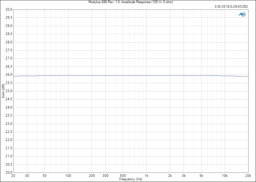

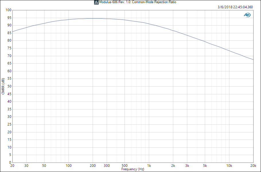

More measurements.

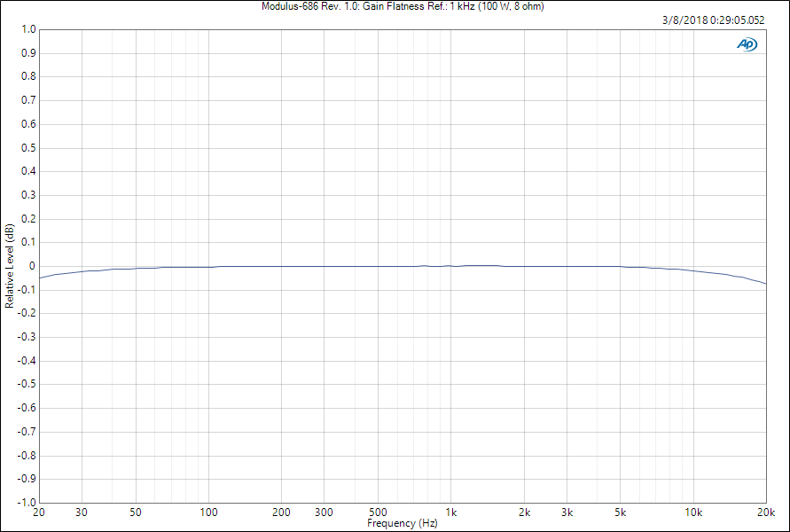

The gain flatness comes in at ±0.039 dB (20 Hz - 20 kHz).
The drop in CMRR at LF is from the input coupling caps. The CMRR is quite high across the board, so I'm not concerned.

Modulus-686 Rev. 1.0_ Residual Hum & Noise (1M FFT, 8 averages, MW SE-600-36).png49.2 KB · Views: 220

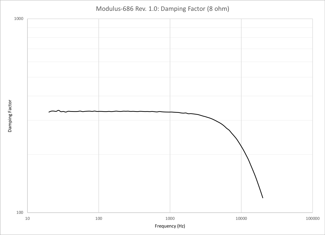

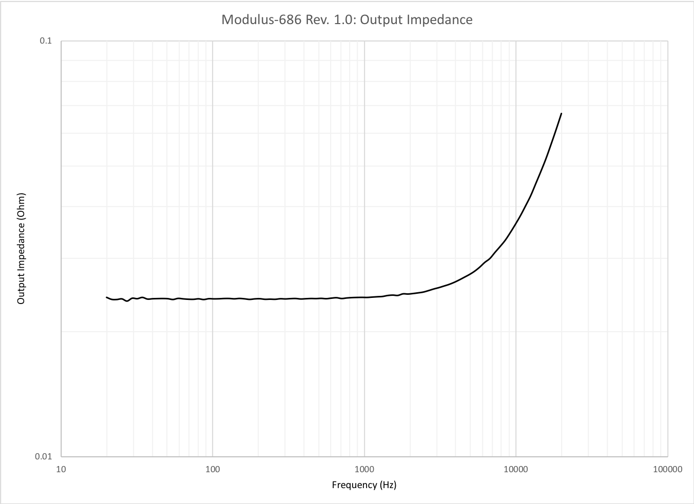

No 🙁
It's very good, but I remember a 12uV figure in the preliminary specs.
Can you do something to improve it?

The noise is just "good" 😉 Looks like mains hum (60hz in Canada i guess, we have 50hz in Europe) and I'm sure something can be done about it in the PSU rather than touching the amp.
Yep. Switch to 20 dB gain. That drops the noise to the 16 uV (A-weighted), 20 uV (unweighted) that you recall.
If that's not low enough for you, I suggest designing a system cooled with liquid nitrogen. It'll be a bit of a mess to operate, but the noise will be low. 🙂
