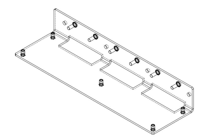

Why do you need the three cutouts?
To get the LM3886es mounted at the correct height, the mounting procedure is to drop the LM3886es into the board, attach them and the board to the bracket, and solder the LM3886es. The cutouts make it possible to solder the LM3886es after the board has been attached to the bracket.

8.35 x 1.25 inches. 0.081" thickness. Five #4-40 1/4" length standoffs on the bottom. Six #4-40 concealed head studs 3/8" length on the face. The four mounting holes on the face are 4.2 mm in diameter and will work with M4x0.7 mm or #6-32. All hardware is 300-series stainless steel.

All you need is a coat of thermal paste or phase change goop on the back of the bracket (between it and the heat sink).
If you'd like to know whether [whatever material] is better, I suggest you take the dimensions of the face of the bracket (8.35 x 1.25 inches) and the mounting pressure from four M4x0.7 (or #6-32) machine screws equally distributed across the face and work through the math. That's not an undertaking I have time for at the moment. I am plenty busy trying to keep up with my education and the development of the Power-686 and protection board. I suppose I should start writing the Modulus-686 documentation too... 🙂
Tom

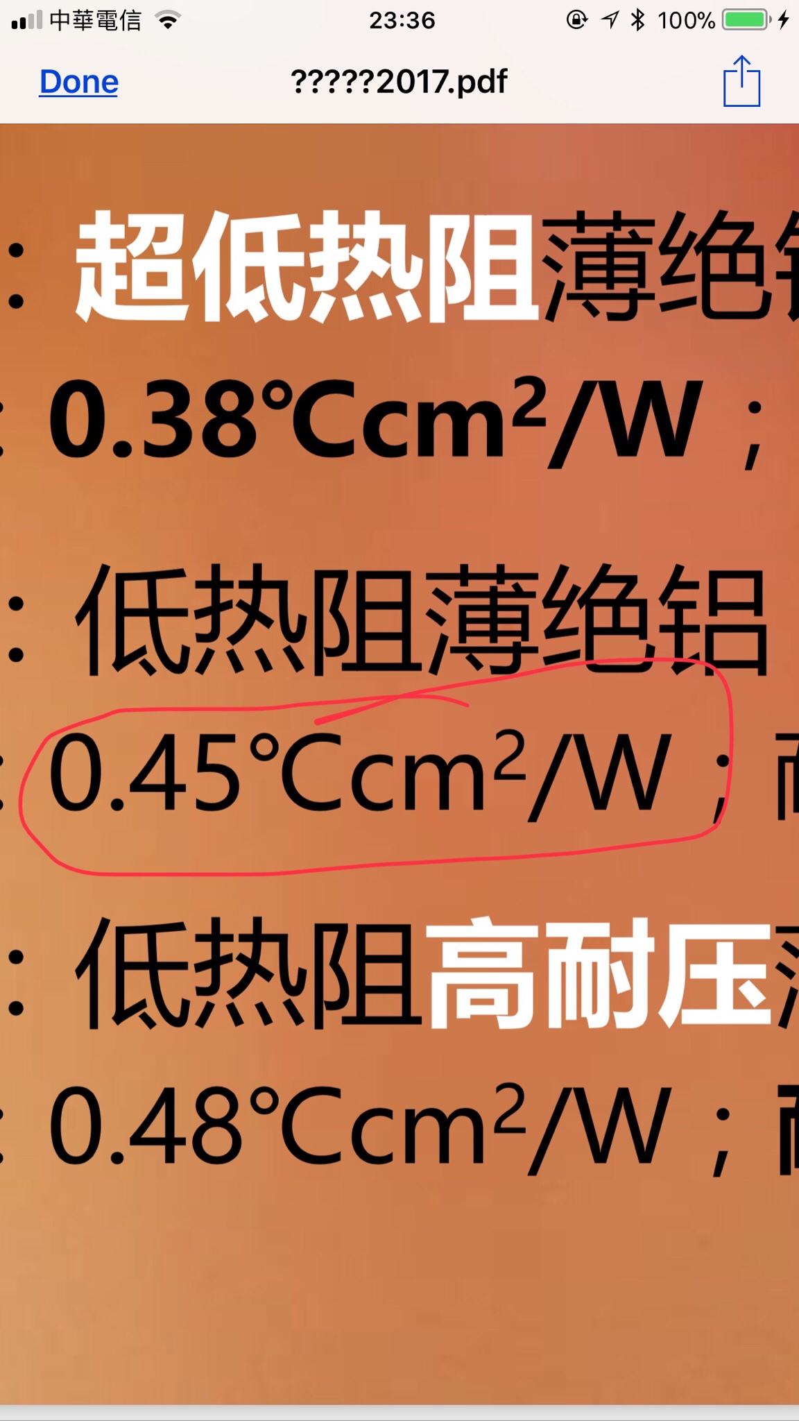

I was thinking using T package and replacing the normal thermal pads. That seems to be the critical area, and I am not sure what you were using.
I used some Bergquist K10 pads. You can see the spec sheet here: SIL-PAD K-10 - Thermal Materials by Henkel
Edit: I poked around a bit. It looks like there are all sorts of exciting phase change materials around. Some of these may be better than the commonly used SilPads. The key is that the thermal pad needs to be electrically insulating - not all thermal pads are electrical insulators. For me to recommend a specific pad, it also needs to be available at common electronic component distributors and reasonably priced.
Tom
Tom
I may just have to toss in some Wakefield-Vette P/N CD-02-05-264 phase change pads with my next Mouser order.
