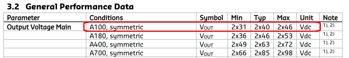

Thanks. I looked at that a while back. As always, the details are in the data sheet (which is available through the grey button in the upper right of the page you link to). Max output voltage is ±46 V, which is too much for the Modulus-686 (or any other LM3886-based amp).
Bummer... I was as excited as you probably were when I saw the ±36 V "spec", only to have that sinking feeling once I read the data sheet.
The data sheet says the typical output voltage is ±40 V, so I wonder how Hypex came up with the ±36 V figure. #whatever... Back to the Power-686 design. 🙂
Tom
Sorry for raising false hopes 🙁
