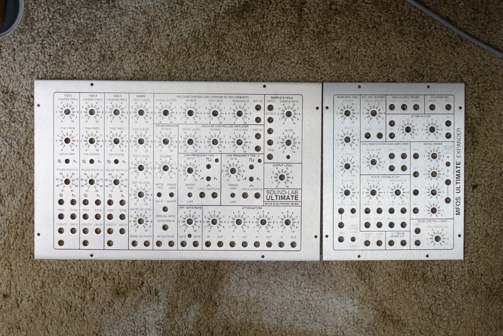

Somewhere around 2010 or so I ordered an Ultimate Synth board from MFOS and started populating it. A year or two later it became apparent that my long engineering career at Motorola would have a limited future, and we would leave the high cost of living area when the end came. Many unfinished projects got stuffed into boxes. In 2014 I moved everything I was willing to keep over 1200 miles north. I have not yet found that partially build Ultimate board.I bought a the MIDU Ultimate kit from SoundTronics in the UK earlier this year. I is based on Ray Wilson's Ultimate, but has full ADSRs, an echo unit and MIDI. Sadly this kit is disconitued but I hope at least the PCB or various files for making the PCB and fronpanels as well as source code for the MIDI-Atmega328 will be available.
Anyway, this was agreat kit, a complete kit except for the wooden cabinet (that was extra) with parts simplifying the construction.

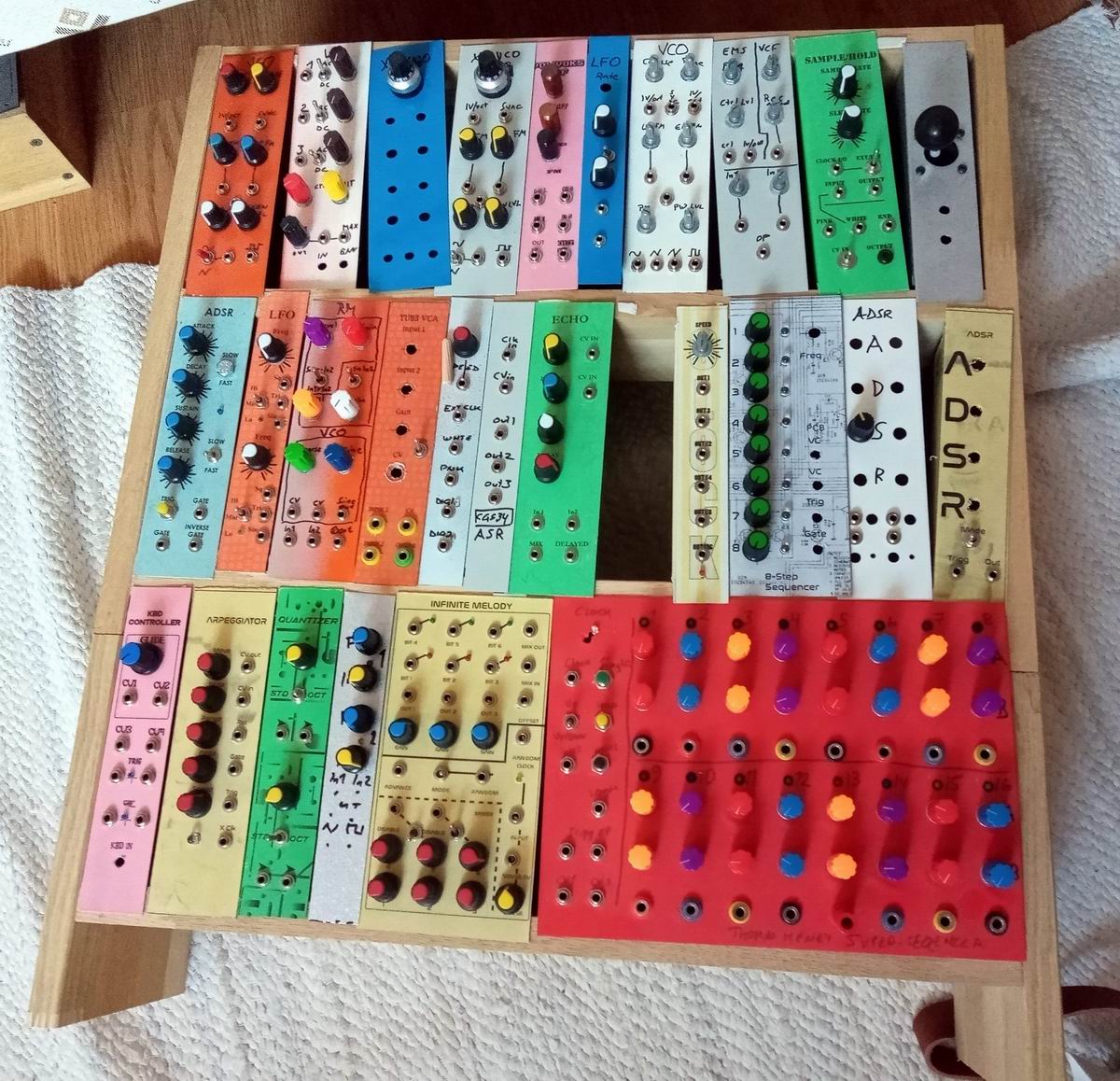

When the MIDI Ultimate is done I have to deal with my modular machine. I have just been randomly built modules that I though looked fun and I need some structure.
It also seems that my modular looks even more like a collection of randomly built modules, and maybe that's because it is. This is the third case that I have built for it, and it is still a mess. I think it makes sense to separate the eurorack and similar sized stuff from the large panel and other randomly sized DIY stuff. The completed MFOS synth will be quite large, so maybe it gets its own case, or shares one with the Behringer Deepmind and the old Roland JV-880. Most of my future DIY stuff will be eurorack size, or close to it.
I had an idea of just a few modules making up a "normal" modular synth. Not being someone who would sell and buy modules and with a free access to cheap sheet metal (alu/zink), I went for an odd 7U format. Also I had once planned to use the (original) Soundlab or Thomas Henry's SN Noise (or Voice?) as a sort of "core", but I will maybe just add the SN Voice-Noice. Probably I will have to build me a new cabinet.
I dunno if I've written about it, but I have the MFOS 16/32-step sequencer, Thomas Henry's 16-step sequencer with double row of pots for control of clockspeed, Practical Electronics 128-step (that needs a diode-coded kbd, but I wonder if I can simply have a single potentiometer or a rotary encoder) and the 4 knob sequencer from Barton. I am going for drone or repetitive "music" obvious.

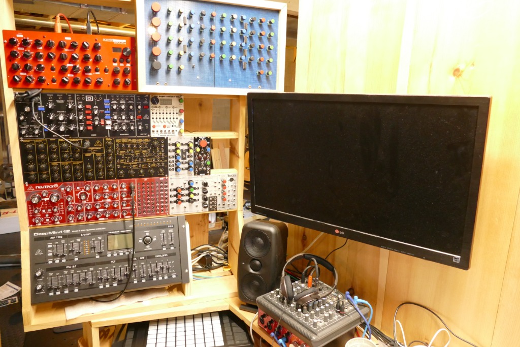

Finally I finished my Ultimate MIDI, but have some (a lot) woodwork left, but I can just screw the pieces I have together and start fiddling. Having something to play with is always nice.
Also I got a set of PCBs from Elby-Design of the Ken Stone (Cat Girl Synth) collection. Many of his modules are really cool and innovative but sometimes it takes some hard investigations to get things right as not always are documentation 100%.
The modules I brought back from USA are done but untested - well, I sold the Crave.
I have two problems to solve right now (or before April 1st). I notice that some modules run on +/-12V and others on +/-15V. That seems to indicate dual voltage rails ...

People either love the Behringer stuff or hate it. I'm kinda in the middle there. Where else can you get a good analog synth for under $300. On the other hand, cloning extinct synths and selling them cheap is cool, but ripping off a direct copy of Arturia's Keystep is taking things too far.
I either feed my modular rack MIDI and CV/gate from the Keystep and a Korg SQ-64, or from the PC interface from Ableton live. Another cool "MIDI mangler" is the Conductive Lab's NDLR. You insert it in the MIDI line going to your synths and when your long winded repetitive loop on the modular gets boring, you press a few buttons or turn some knobs and it changes the pattern, key, or note sequence for you in a musically correct manner.
I use the Deepmind or the old JV-880 for chords, the "D" for Mini Moog style leads or bass patterns, and the Neutron for sounds that only the Neutron can make. The lonely child in the corner of the room is the K2. I don't use it much.
The last rendition of my modular case used a pair of Meanwell 15 volt SMPS's for +/- 15 volts, and a pair of 12 volt regulator chips to make 12 volts from the 15 volt rails. So far everything plays well together.

Maybe I also have written about it, but I am struggling with a chissis for a remake of the Ultimate. It is based on the Ultimate but has full ADSRs, and added echo unit and MIDI input. All mounted one single board and semipatched using on-off-on switches.
