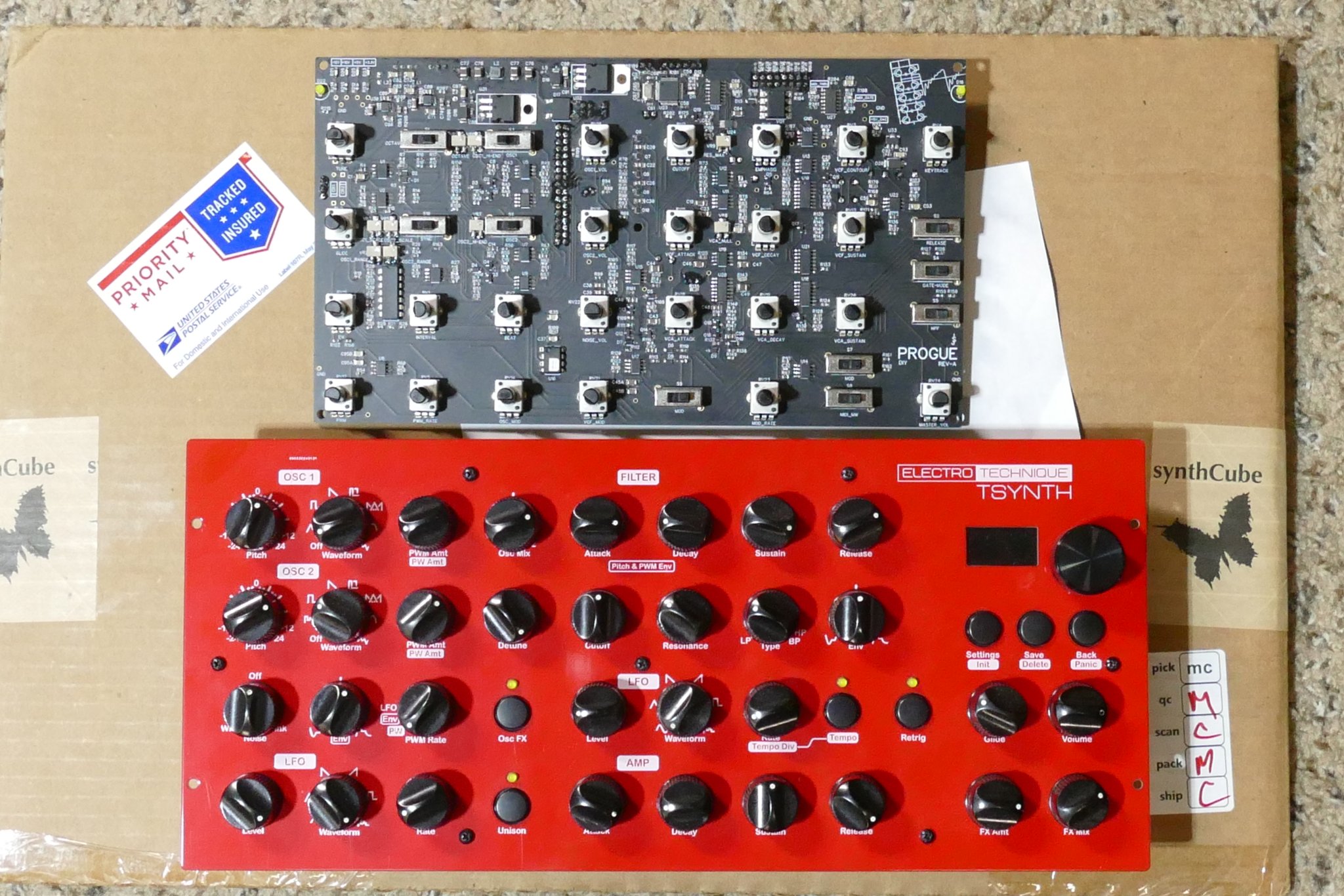

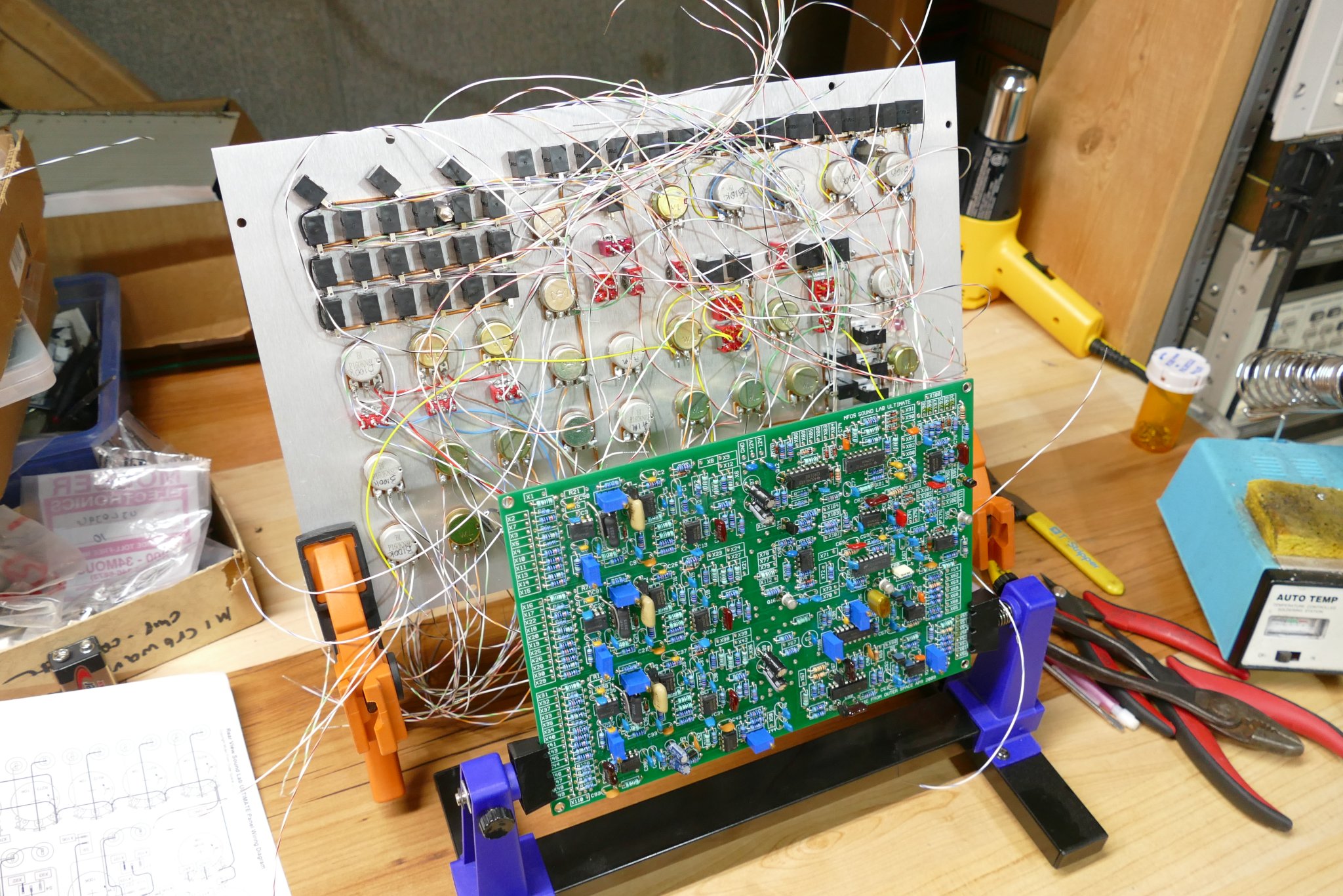

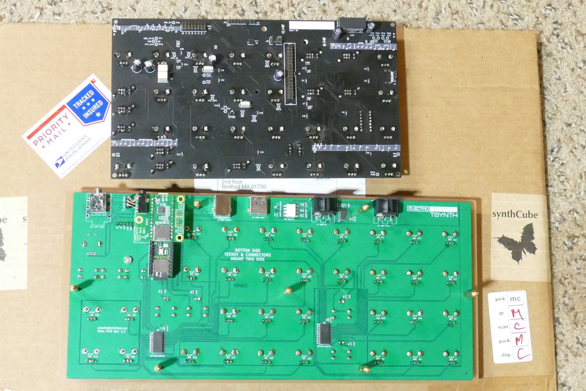

The red faced unit with a green board is a Tsynth kit from ElectroTechnique. It is a "virtual analog" with the usual knobs for oscillators, amp, and filter but all the sound is generated digitally in a Teensy 4.1 module and output through a stereo DAC board. I built it about two years and it works good. I took it down from its perch in my modular mess cabinet to take the pictures and upgrade it's firmware. I noticed that two newer versions have been posted on their GitHub since I built it.
The black board comes with a black panel. It is called Progue from JSI and it a clone synth, part Moog Prodigy, part Moog Rogue. It took me several months to populate about 500 mostly SMD parts on the board. I started this build during the great semiconductor shortage and it has never worked. I got some of the chips from Ali Express and at least one of the LDO regulators is bad or counterfeit since the DC voltages are wrong. Since then I have acquired some genuine TI chips so I will simply swap them all out and hope for the best.

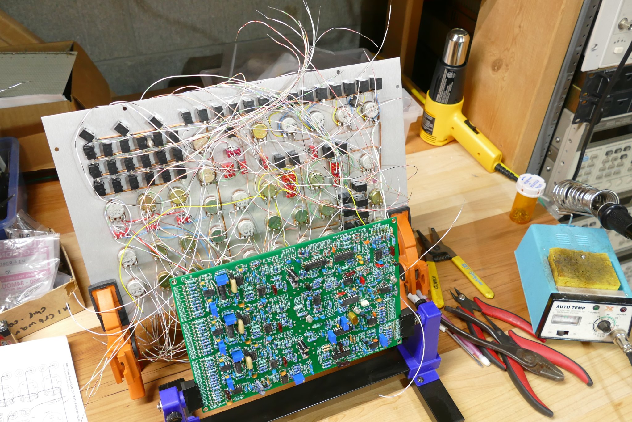

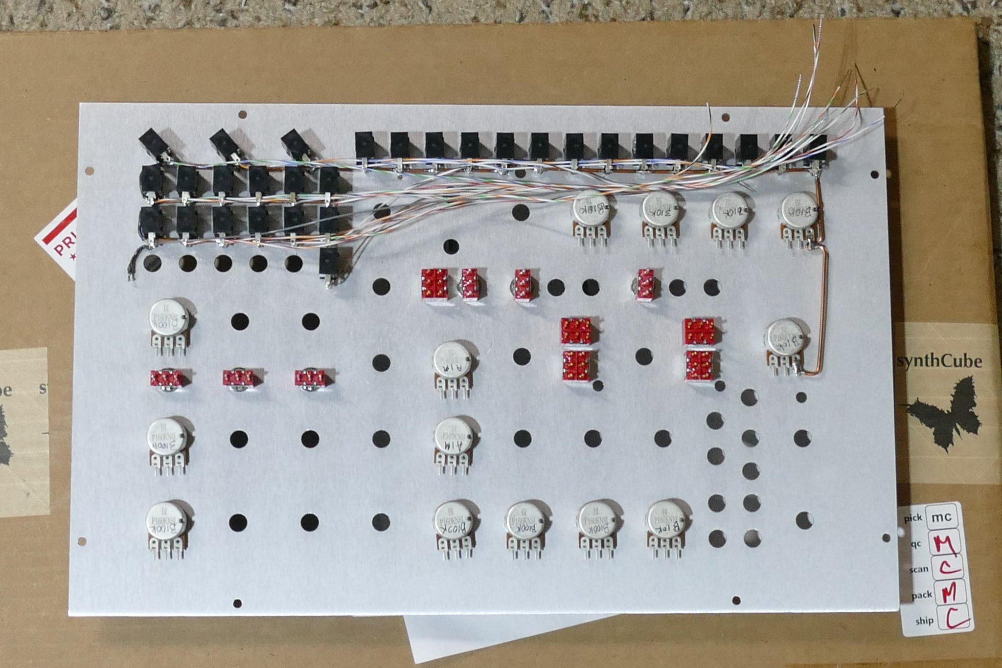

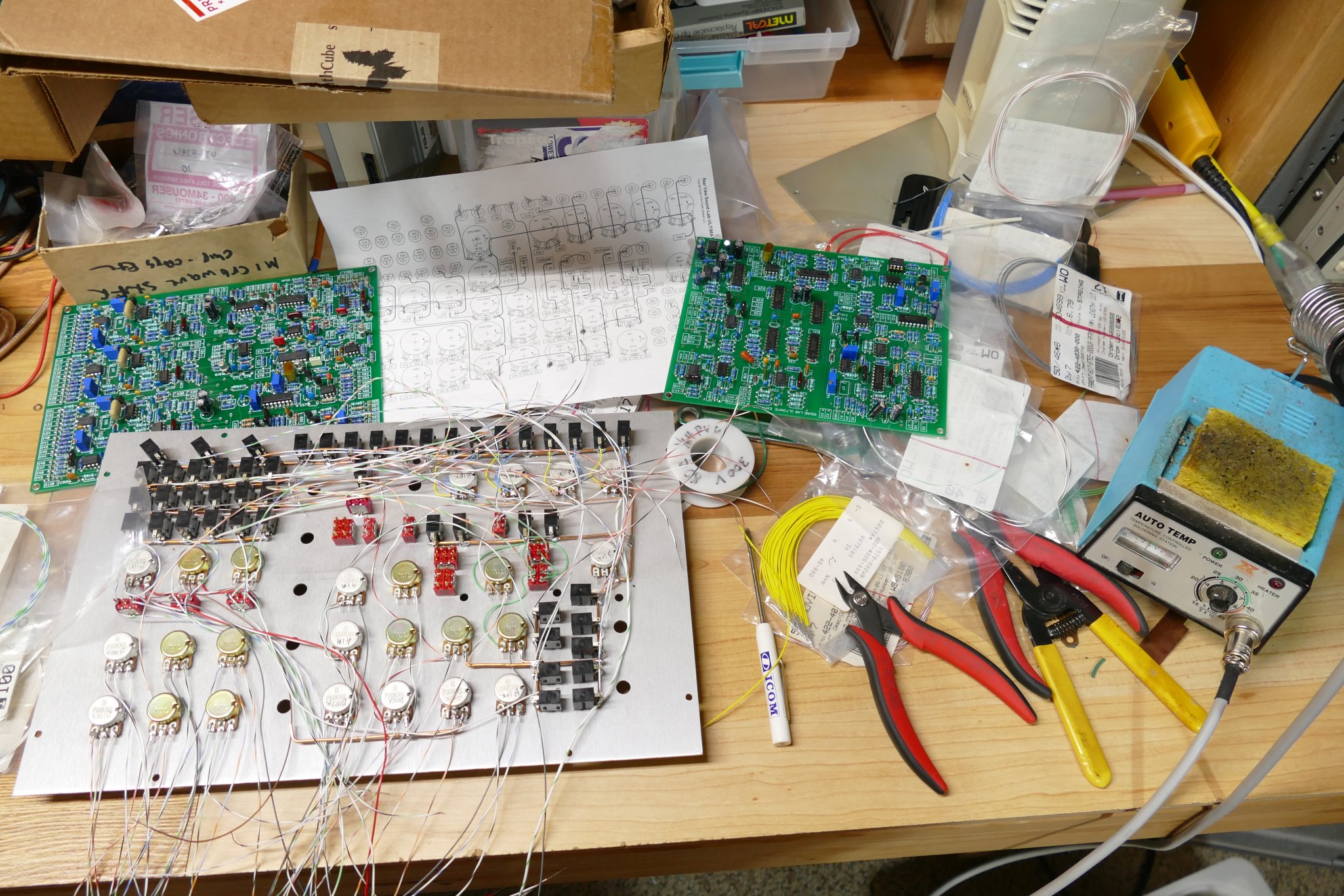

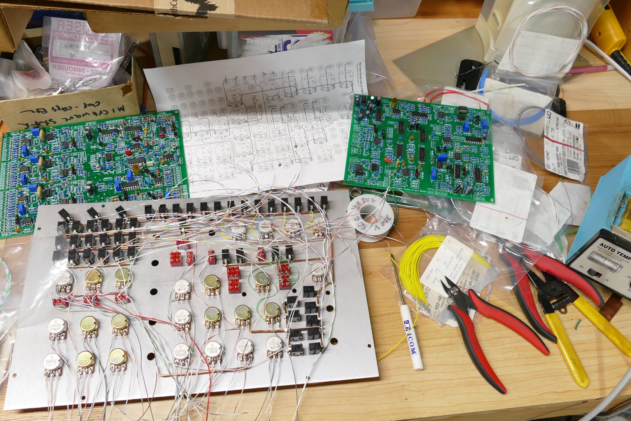

The shiny silver "rats nest" is the back side of the MFOS Ultimate panel. I installed the parts that I have yesterday and started soldering wires to them. More parts will be arriving in the next few days. The "jack field" at the top left must be populated one row at a time then wired up since it's too crowded for my shaky hands to solder the jacks without melting them. This will take a while to finish, then there is the Expander panel.

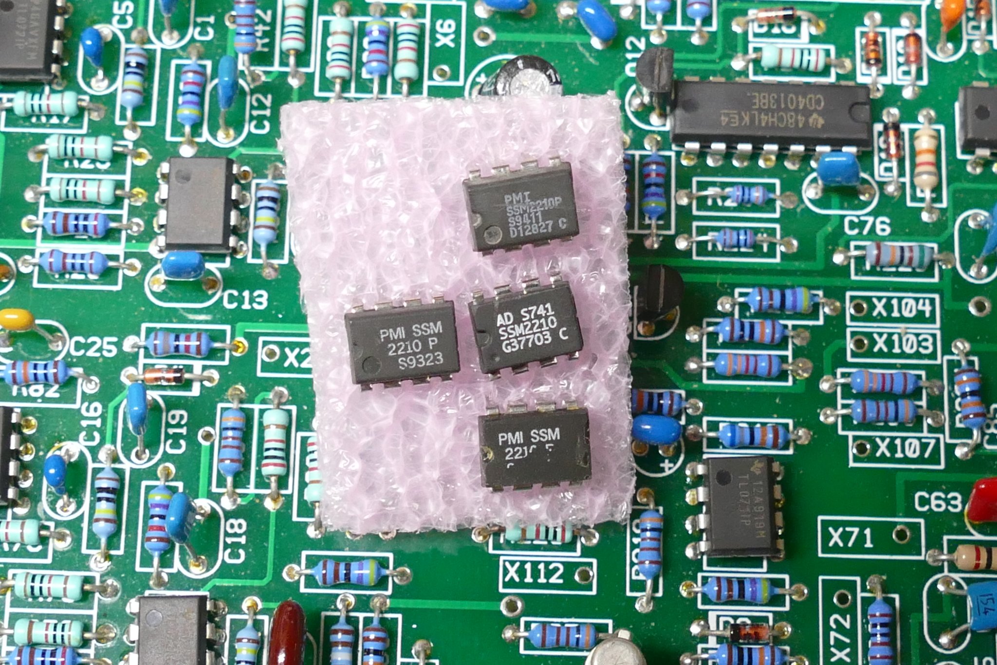

I soldered three of the suspect transistors into the PC board and I am about 1/3 of the way through the "wiring it up" process. This has taught me just how NOT to design an electronics kit, especially one this complex. I would use a PC board behind the panel, and plug the actual synth board into it, or put the synth on the back side of the front panel board.

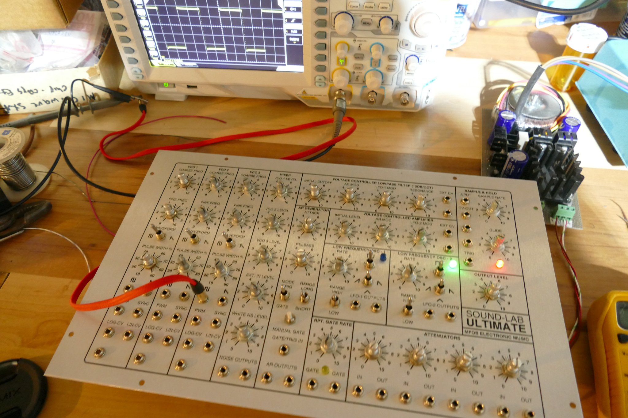

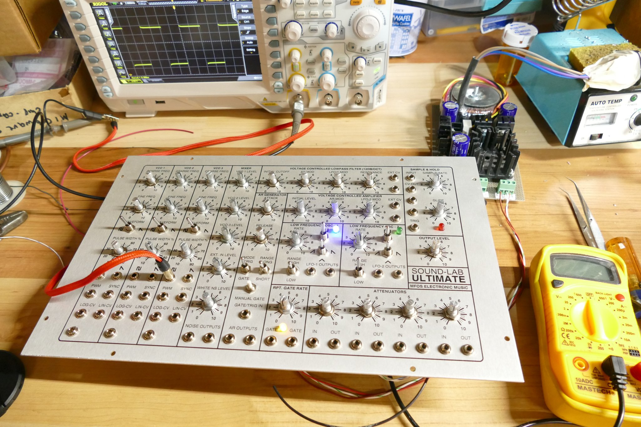

Well after fighting the flu and slinging solder for over a week the MFOS Ultimate got fed power for the first time about an hour ago. Nothing blew up or smoked. All of the front panel controls seem to work, all three VCO's work, but there is no audio output. There is likely something miswired, but I haven't got the patience to start digging into it right now.

In my last post, I had completed the MFOS Ultimate synth but could not get it to work. The next morning I busted out the scope and followed the signal to the VCA where it went in but did not come out. It helps to apply some "V" to one of the Control inputs, so the Amplification can happen. DUMM BLONDE at the controls, the synth works good, but I haven't taken the time to go through the calibration procedure yet.

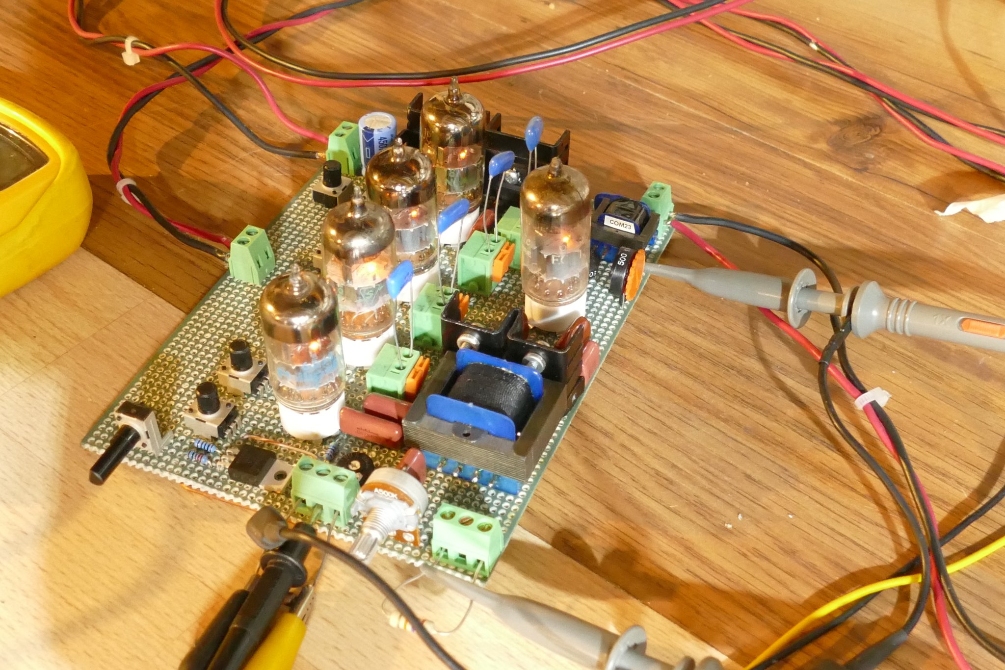

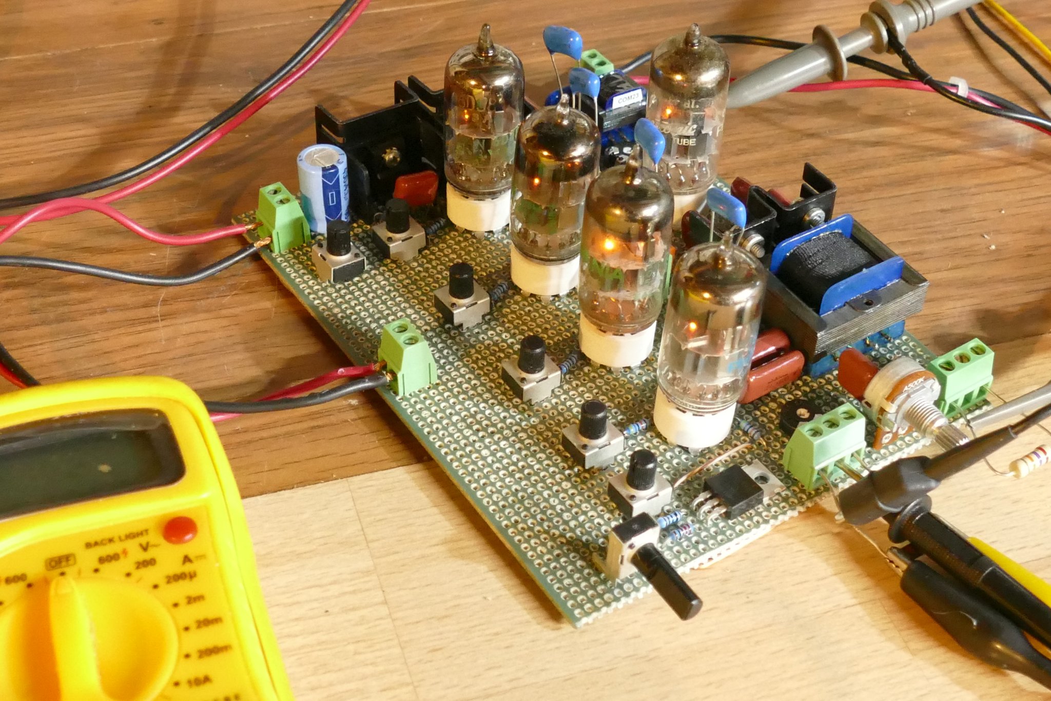

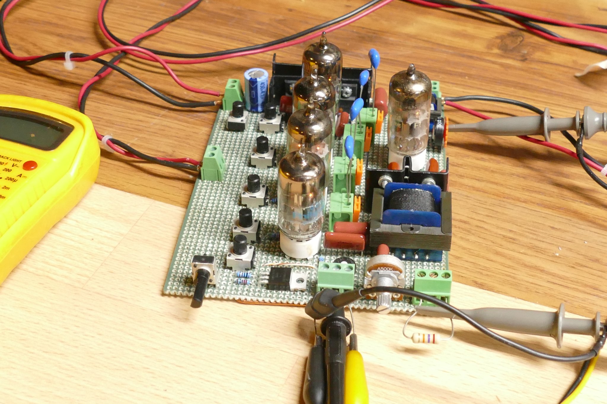

Could this be the elusive vacuum tube based Voltage Controlled Ampli-filter? Would those 4 identical tubes be wired as some sort of ladder? Could a project that was first seen in posts #20 and 25 have crawled out of the "box full broken dreams:" and been resurrected from the dead? Might the 5th tube be a modified version of the VCA seen in posts 39 and 56?

4-Pole Tube Ladder Filter?
That poor piece of perf board has been occupied with several iterations of attempts at a working 4 p[ole ladder filter. A couple months ago I rescued it from the "box of dead projects" where non functioning, boards, experiments, and electronic disasters go to be harvested for parts as needed. When I pulled it out of the box it was a failed attempt at a vacuum diode ladder filter. 6JU8 tubes are simply a pair of 6AL5 dual diodes in a 9 pin envelope. The ladder worked but failed to deliver more than two octaves of frequency range without feeding the board well over 400 volts. Most of the original circuitry was ripped off leaving only the tube sockets and the mosfet buffer. I created a new ladder from 9AJ based triodes with an IXYS 10M45S CCS chip at the base of the ladder for the CV controlled current source. There are 17 different tubes with the 9AJ / 9LP / 9EP basing that are pinout compatible with the socket wiring on that test board. Those 4 sockets are currently filled with 6DJ8 / 6922 tubes since they are known to work well at low voltages. I have over a dozen possible candidates to try. The VCA is currently populated with a 6ES8 tube. The board does show signs of life, but lots of testing needs to be done. At this time, I don't even have a schematic of what's on the board as I kinda made it up as I went along. I was surprised to see that it didn't self destruct on power up, but even more surprised when I found the filter and amp both exhibiting some functionality.

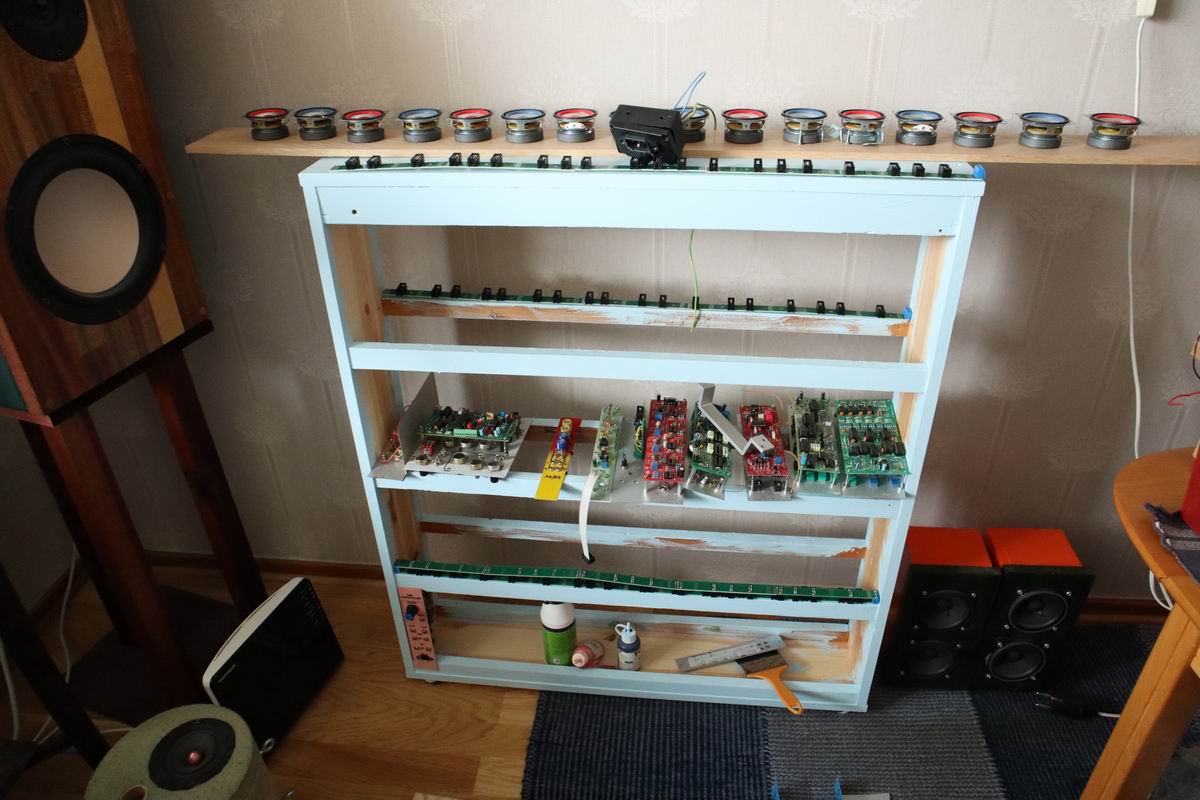

Been busy with my modular this Spring, but I never got far to get the whole che-bang together but:
  • Made me a bigger cabinet and painted it baby-blue.
  • Ordered simple "power rails" and a +/-12V PSU. The rails are screwed to my cabinet, but the PSU is difficult to fit in a good way.
  • Ordered a bunch of power connectors and have started to solder them to the PCBs.
  • Brought a number of PCBs back from my trip to Chicago this winter and have assembled them.
  • Have started a few more projects and have some new PCBs for a LPG, an odd LFO and a dual-AR.
  • Watched Barton's site and looked at his cool 8-step sequencer and have stolen most of the design to build a sequencer with 4 VC outputs that are two clock cykles apart.
  • Have to get the last pieces together in my Ultimate ("in-door" transformer, not the wall-wart), and adjust/trim VCOs, VCF and VCA.
  • Laid my hands on some nice heavy aluminium sheets and can make a panel to the T2000.
  • Finally stuff the boards back in the Polivoks and make things work.
  • Repair my MG-1

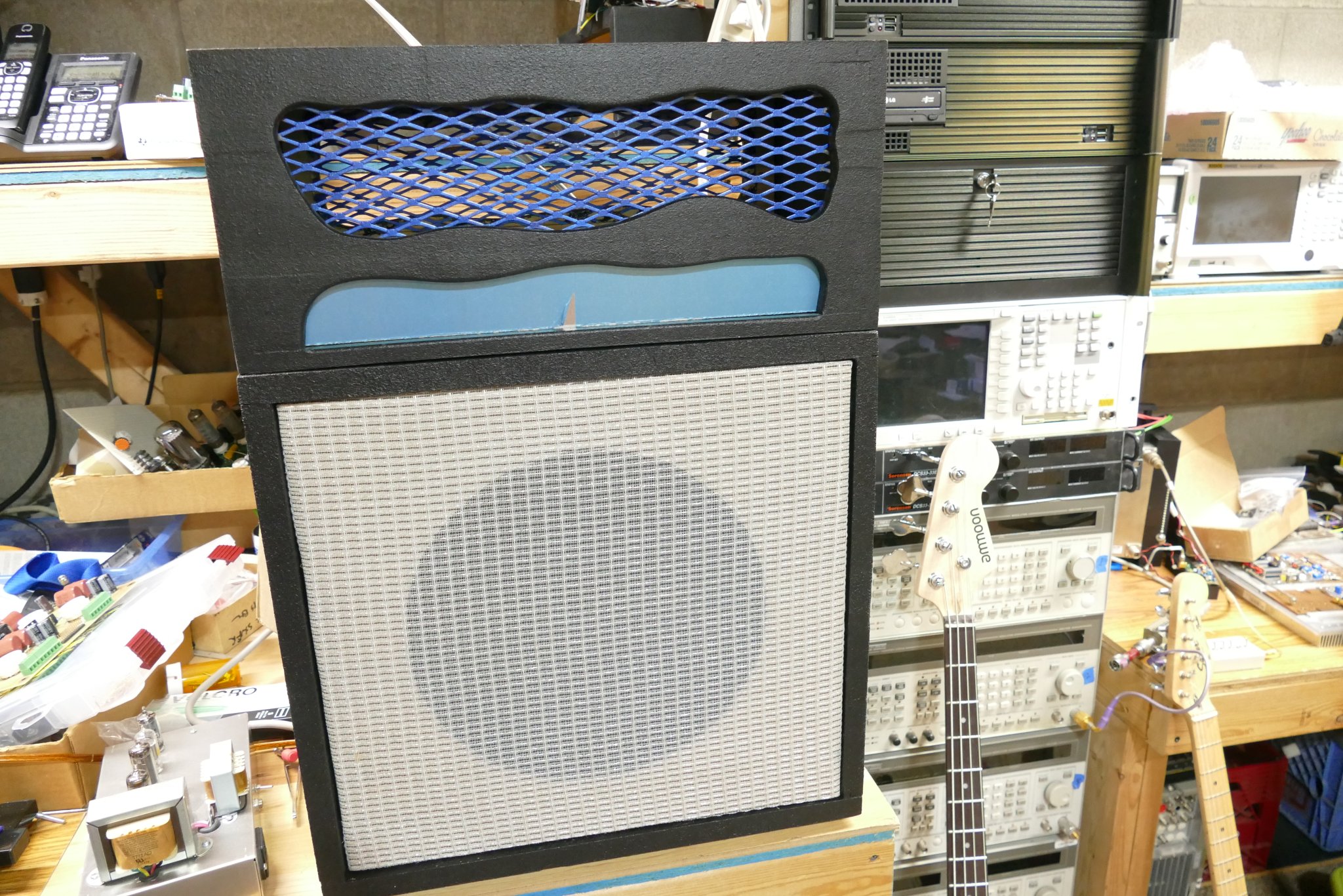

I have spent far too much time trying to reinvent the guitar amp and frying some parts in the process. The only thing that I have actually completed is the 1 X 12 inch speaker cabinet sitting under the amp head cabinet that I made several years ago. Meanwhile there is a new Behringer Kobol Expander sitting in its box because there is no room left in my modular cabinet without some serious rearrangement. The MFOS Ultimate synth still has no cabinet and there are two Eurorack module kits waiting to be built.

My synth will be sitting idle for a while longer. I have three different guitar amp ideas in process concurrently and also need to work my short, fat, and mostly non functional fingers daily so I can play the guitar for more than a few minutes at a time. I bought a cheap full length Jazz Bass clone a few years ago before I realized that I can't span 3 frets on the long end of the neck. I have several guitars that I can play, but for only a short period of time before my fingers refuse to listen to my brain. This is improving with effort though. Singing, never did happen, never going to happen. Singing into the DAW and playing with Melodyne or Ableton pitch correction is an exercise in futility. I have come up with some neat, weird sounds to play from the keyboard this way, but the best samples came from the cat!
Well over 10 years ago there was a challenge called the Hundred Buck Amp Challenge, now a sticky at the top of this forum. I have 3 guitar amps and some non-functional boards from my efforts in that contest. The last working amp has developed an intermittent condition and only works when there is a pair of Vise Grips hanging off of the volume knob. Thinking it was just a bad pot, I ripped it apart to find that the DIY home etched PC board is coming apart. That is also the case with one of my other HBAC amps. Some of those boards that I made in a hurry were pretty ugly when they were fresh. The shortest path to a working amp would be to just send the old Gerbers to a board house and get some good boards for a rebuild. Unfortunately, being an engineer, I just have to make it better which will likely result in some screw-ups. At least one out of the three should work, right? Can I squeeze 50+ watts out of a board that used to make 20?
