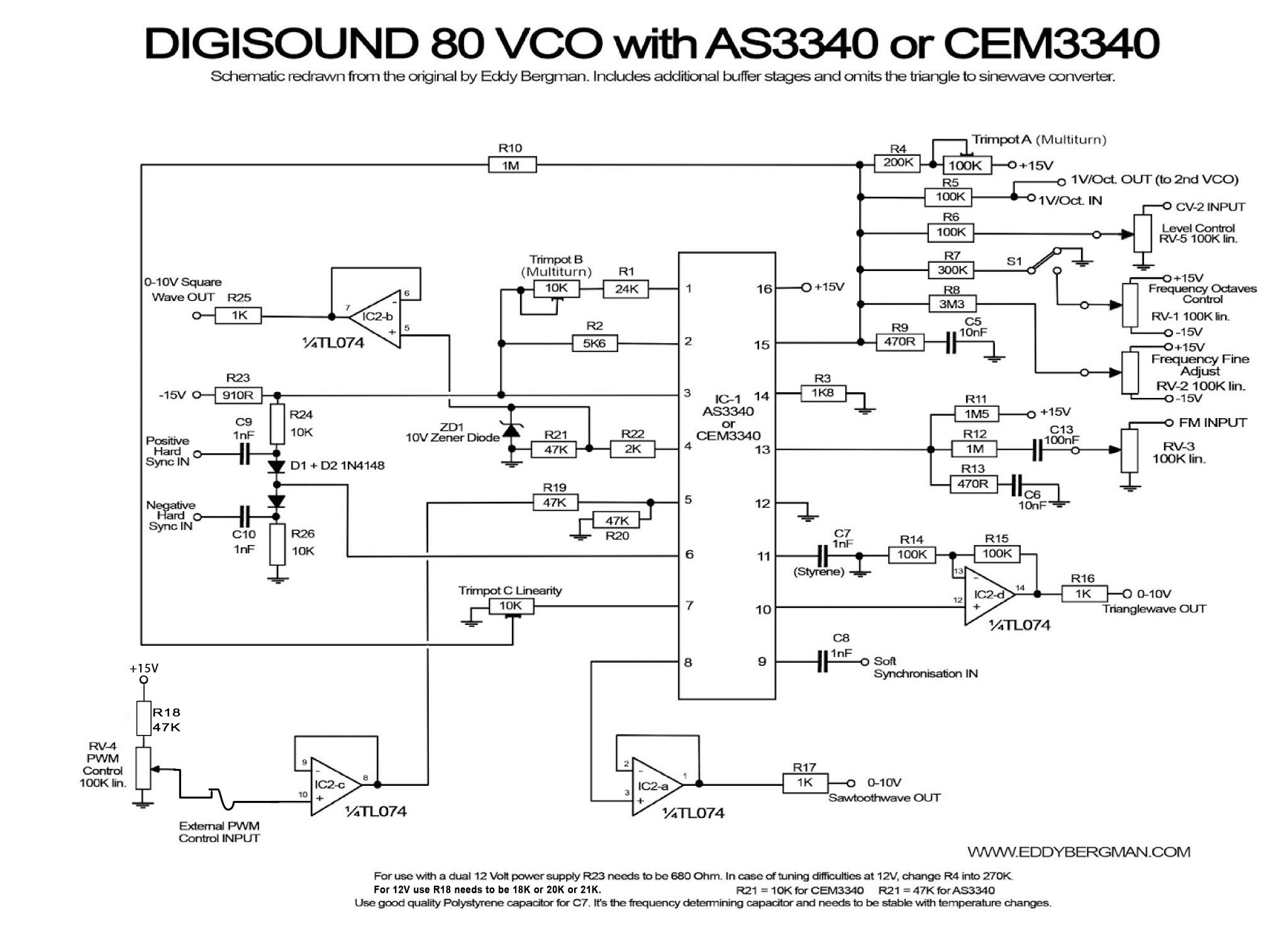

So , I think I can take my AS3340's (VCO - 1) , and make something better. Buffer everything with standardized +/- 5V. add the sine shaper...
A fully discrete VCO (below 2) is doable , but with the tempco and matching considerations.
Best to start with the VCOs , they are the "what you hear". Filters are almost as important....

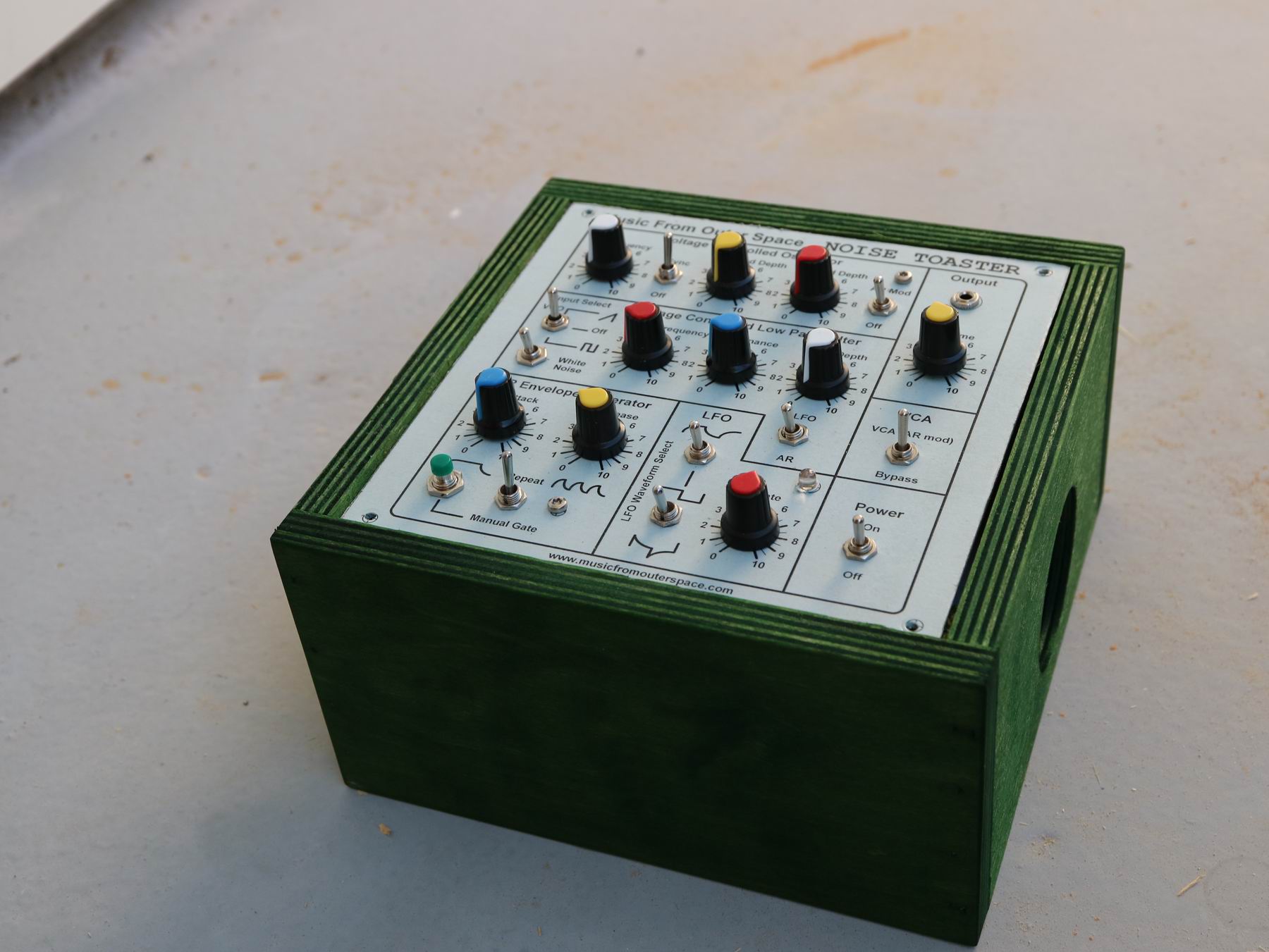

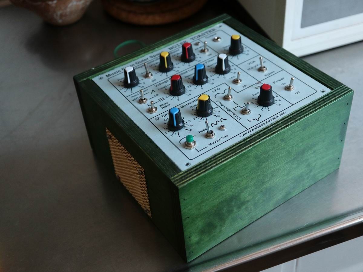

I am "struggling" with my second Noise Toaster. The first one, seen below, was given to two of my grandkids and the second will go to a grandson. However I have been using a cheap Chinese box (with crappy plastic) so it doesn't look that nice really, but I hope the adding of a PT2399 echo module will sort of make things up a bit.
The only wish I have is that someone could remake the PCB to have the potentiometers and switches mounted on that board, thus eliminating all the wiring.

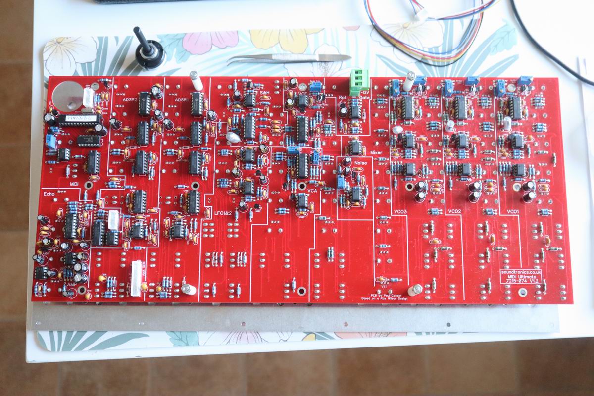

I have often made PC boards that do the pot wiring. This works and may be feasible for the Noise Toaster but the Ultimate would require a big board.
NOTE: If you have a board like the Progue Synth that has the electronics and pots on the same board, build it in this order.
Usually some or all of the small parts can be populated first. The Progue is mostly SMD, so it is best to do the SMD stuff first. Test fit all the pots and switches to make sure that they fit and are all the same height so that the front panel will fit properly. Some of the pots that I used on the Progue build were taller than the others, and the Ali Express switches that looked like clones of the Moog switches did not fit the board.
Put the all the pots in the board, but do not solder them. Place the panel onto all the pots and make sure everything fits, install a few of the pot nuts around the edges, then clamp or band the sandwich together, flip it over and solder each pot. Then install the remaining nuts. I learned this the hard way a long time ago.

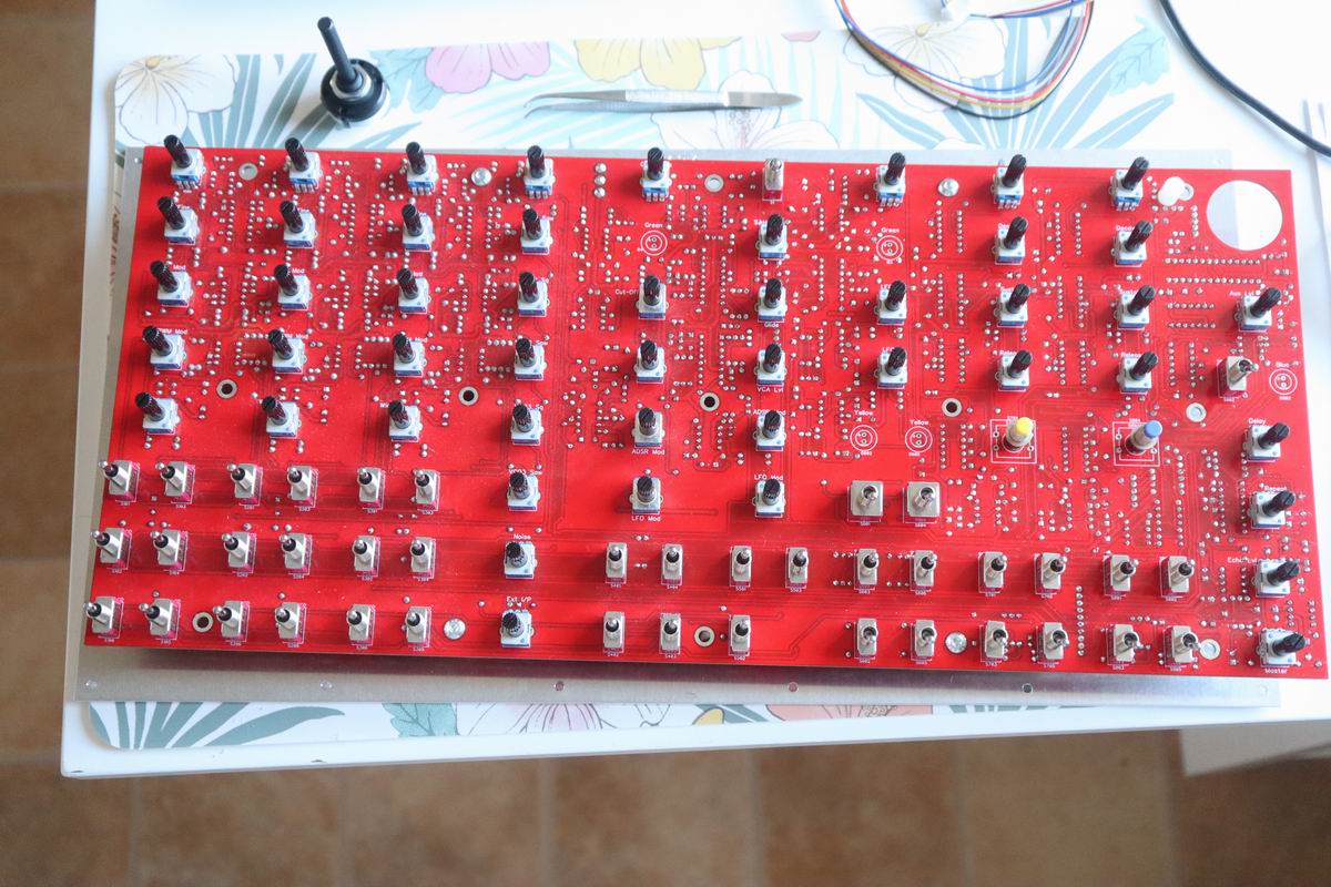

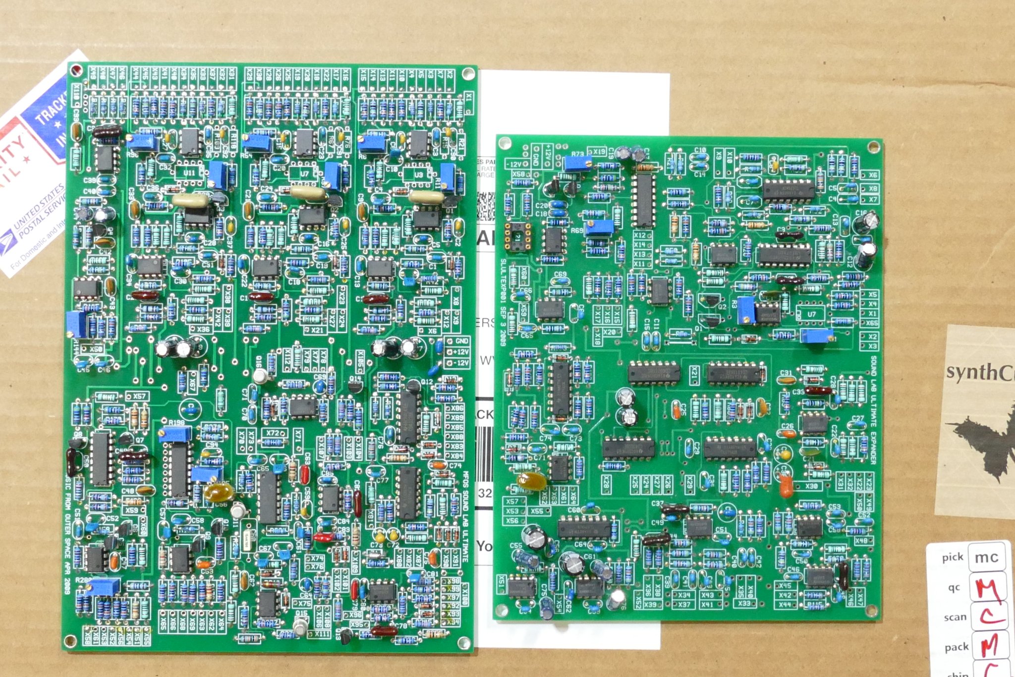

I got out the box that contains my unfinished Ultimate and Ultimate Expander. Upon opening I realized that yes, the front panel wiring is where the project stalled, but that was not the real problem. I have a large box full of pots that I have collected in 50 some years of hitting the surplus shops, and hamfests and stripping down old military electronics or test equipment for parts. I had prewired a bunch of those pots for the Ultimate, only to find that they will not all fit the panel. Those big old Allen Bradley pots are too large in diameter and some of their bushings are larger than the hole in the MFOS panel.
Looks like I need to buy some pots.

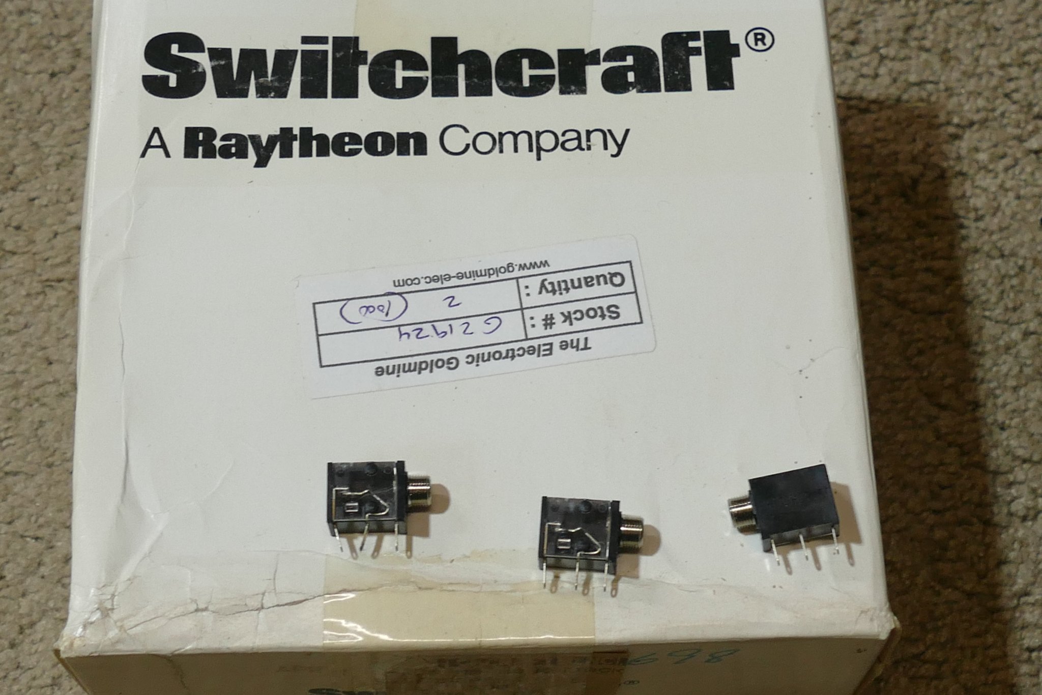

After spending several hours sorting through all the stuff in the box marked MFOS that's been sleeping on a shelf for over 3 years I realized that there were a few other reasons that the project stalled. A good lookover of the PC boards revealed three empty places where a part goes on the Ultimate board, and one on the expander. This turned out to be the SSM2210P dual matched transistors in the VCOs. The SSM2210 went extinct years ago. There are workarounds, the easiest of which is to substitute the SSM2212 which is now only available in SMD. The SSM2212 is about $9 each. Synthcube now sells the "extinct" SSM2210 for $15. The picture shows an unmarked 8 pin DIP package, so who knows what it actually is. Yesterday was the last day of their 25% off sale so I ordered 4 of them, the missing temco resistors and the pots that I couldn't find elsewhere for less money. I ordered a bunch of cheap pots from Amazon too since they were 50 cents each.
The original MFOS build used banana jacks for both the audio signal and CV jacks. Non shielded wire was used for the patch cords. I decided to go with 1/8 inch audio jacks similar to what's used in Eurorack modular synths. There were the usual reasons for doing that, but the real motivation is this box. There are 1000 good quality jacks in the box, and I have two boxes!
The pots and other parts should start to arrive later in the week. I have a few that will fit, and lots of jacks to mount and wire up for now.

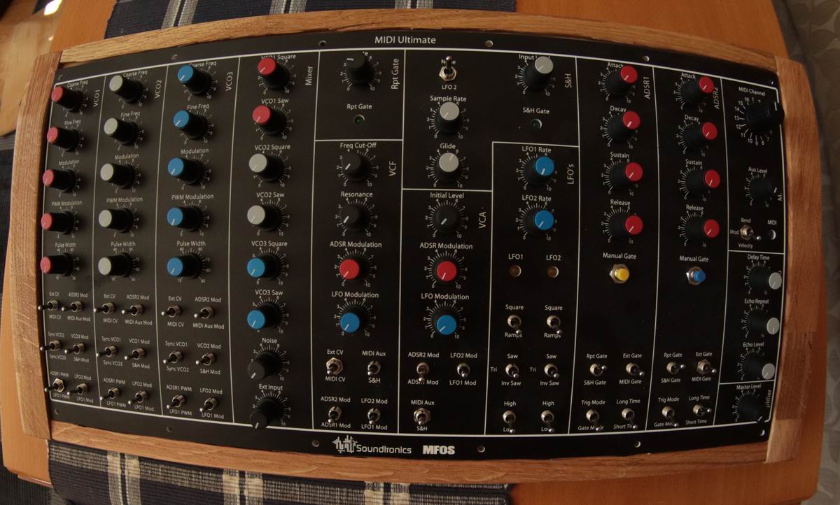

I started down the MFOS Ultimate path around 2010 when Ray Wilson was still alive. The Ultimate got my attention in a Youtube video, so I bought the board and started building it. I lost my job at Motorola in 2014 and moved away from the crowded and expensive south Florida area. The box with the MFOS stuff and a few other boxes were lost during the move.
