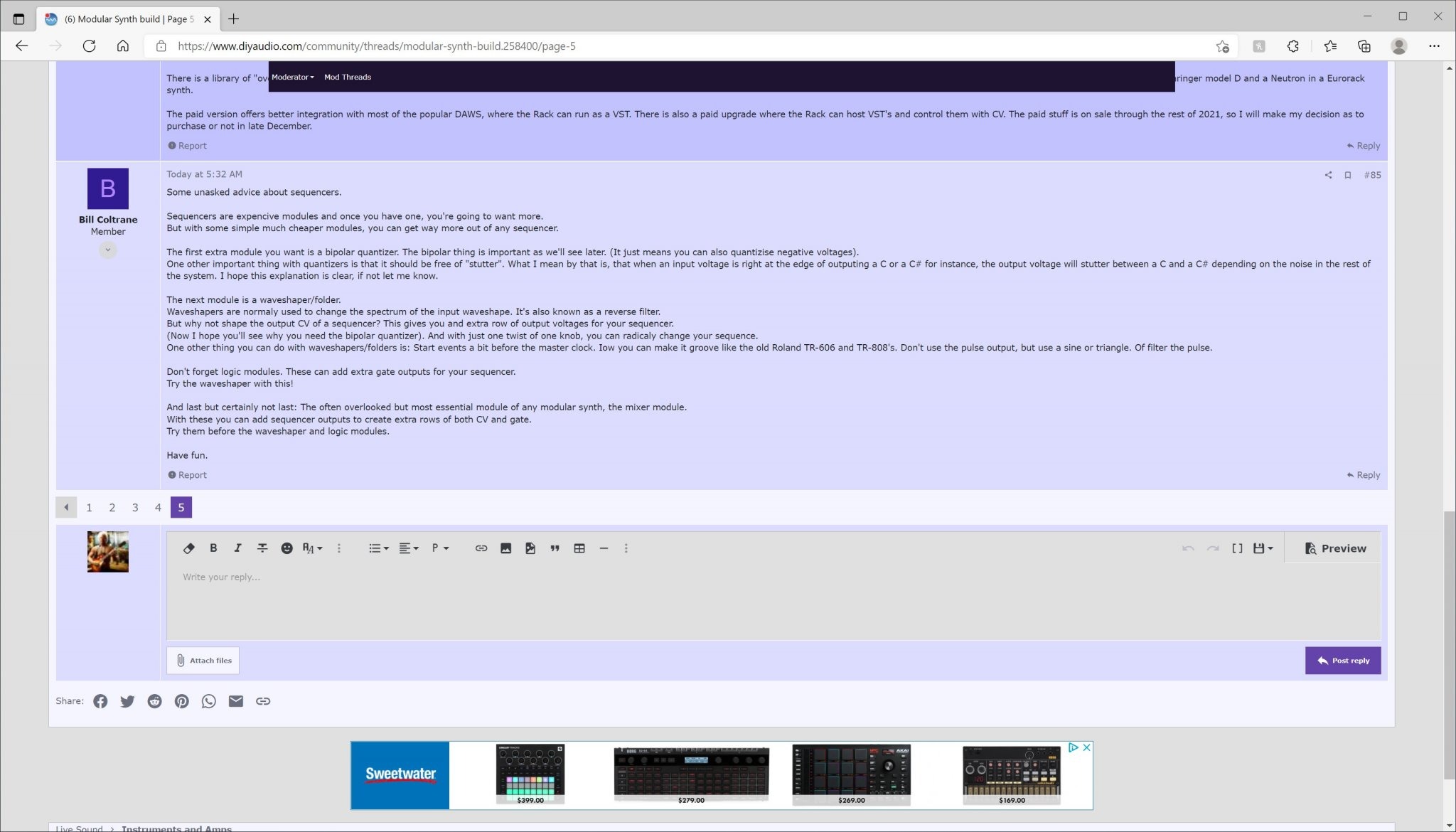

Some unasked advice about sequencers.
Sequencers are expencive modules and once you have one, you're going to want more.
But with some simple much cheaper modules, you can get way more out of any sequencer.
The first extra module you want is a bipolar quantizer. The bipolar thing is important as we'll see later. (It just means you can also quantizise negative voltages).
One other important thing with quantizers is that it should be free of "stutter". What I mean by that is, that when an input voltage is right at the edge of outputing a C or a C# for instance, the output voltage will stutter between a C and a C# depending on the noise in the rest of the system. I hope this explanation is clear, if not let me know.
The next module is a waveshaper/folder.
Waveshapers are normaly used to change the spectrum of the input waveshape. It's also known as a reverse filter.
But why not shape the output CV of a sequencer? This gives you and extra row of output voltages for your sequencer.
(Now I hope you'll see why you need the bipolar quantizer). And with just one twist of one knob, you can radicaly change your sequence.
One other thing you can do with waveshapers/folders is: Start events a bit before the master clock. Iow you can make it groove like the old Roland TR-606 and TR-808's. Don't use the pulse output, but use a sine or triangle. Of filter the pulse.
Don't forget logic modules. These can add extra gate outputs for your sequencer.
Try the waveshaper with this!
And last but certainly not last: The often overlooked but most essential module of any modular synth, the mixer module.
With these you can add sequencer outputs to create extra rows of both CV and gate.
Try them before the waveshaper and logic modules.
Have fun.
