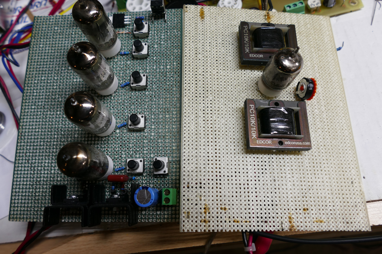

I have also been tinkering on and off with vacuum tube based synth modules. They are bigger, and need about 200 volts for the tubes, hence the "universal" power supply and big cabinet that accommodates multiple different size modules.
The 4 tube ladder filter seen in post #20 is in pretty much the same shape that it was back then, except for some parts changes that have made it work a bit better. Then there was this diversion to a Vactrol based ladder. Awesome sound, except for the delay when trying to slam the filter shut. More experiments are planned.
Another element needed for any filter is the VCA, so I decided to clone the best known vacuum tube VCA out there, the voltage controlled gain cell from the Fairchild 670 compressor. This is a most excellent place to start, but there is just one problem with it. The Fairchild gain cell uses 4 identical tubes per channel, GE6386's. They were pretty common right after WWII since they were used in some mitary radio equipment of that era, but were never made since then, current cost, about $125 EACH!!!!!! That makes this little baggie full of glass very valuable......
So, I simplified the Fairchild design down to it's minimum essentials for functionality, and ordered some budget friendly transformers, then built a one tube version.....It worked extremely well on the first try. Dynamic range was over 70 dB, THD in the 0.4% range at full output, rising to about 1% -50 dB and under 100 Hz......not bad but still too expensive.
Over the next few weeks I plan on fully optimizing it, and characterizing it over a wide range of operating conditions. I have 21 of the 6386 tubes, but only one has been tried in this board. It worked, so will the others be better, worse or the same?
After that, I will be working on making it work with a tube or tubes that costs $5 or less. I have several candidates to try already.

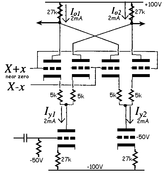

> That circuit uses a 6K7 tube for it's gain cell.
There's two kinds of "VCA". A radio takes a variable small signal and makes it uniformly big. A volume control (or a synth) takes a known-level signal and makes it as small as desired.
These two applications typically lead to very different implementation. The radio (or music limiter) often starts from a naked device(s) with no NFB. The synth-type would often start from a high-NFB amplifier and use current-steering to divert signal.
A tube current-steer is probably obvious/trivial to you, but here's a sketch for those following:
I looked at that schematic when you posted it last night. It looked familiar and sort of reminded me of something. The 6AR8 sitting on the bench crying out "Try me" captured my attention, so I mentioned it and went back to rewiring my breadboard to test a long list of 7 pin remote cutoff pentodes in the same circuit that I used to test all the dual triodes.
Later last night while drifting off to sleep, that annoying light bulb in my head that keeps me awake at night lit up and told me ....hey idiot that's the multiplier circuit that you spent about a year optimizing for UHF mixer / demodulator use. That was an all mosfet design which is now buried many layers deep inside one of the chips in Motorola's latest police radios.
I may stick it into LT spice later and see what the simulator says. If there is some light at the end of the tunnel, I'll build one. Three tubes VS one or two, space, heat, and heater power are concerns, but so is performance.
and CV linearity is good (but is that important?)
CV linearity isn't too important as long as it's somewhat consistent. There will be a microcontroller present to deal with MIDI data. It converts MIDI to CV so some math can be added to the conversion as needed.

> It looked familiar ....hey idiot that's the multiplier circuit that you spent about a year optimizing for UHF .... an all mosfet design
If you peel the WhiteOut you will see I snagged a MOSFET drawing and pasted triodes over it.
The linearity can be good-excellent when you have enough supply voltage to use large cathode resistors. Then you can use any darn tubes. Two 3-T Compactrons if you swing that way. There could be price/linearity advantage using MOSFETs for the upper quad, keeping thermionics in the lower pair for "great tube sound".

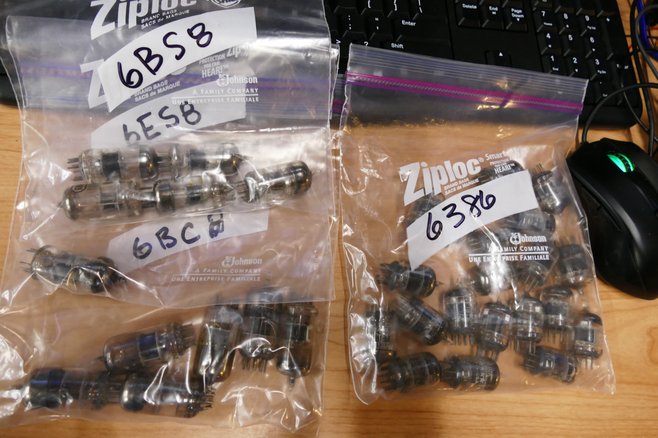

I ordered a box full of tubes from ESRC so that I can try several different designs of vacuum tube VCA's. So far I have toyed with a simple twin triode diff amp with $12 Edcor transformers on the input and output. It's basically a simplified version of the gain cell lifted from the Fairchild 670 compressor. I ran at least a dozen different twin triodes through it, and none come close to the 6386's.
I then rewired the board for with two 7 pin sockets, and was going to try some of them, but to my dismay my large collection of 7 pin tubes is gone...... I now vaguely remember trading it for a guitar at a hamfest in Florida 5 or 6 years ago. So I just ordered a box of small tubes.
So I rip it up and rewire it again. This time for some 6BV11's, a dual pentode intended for color TV demodulation. This works quite well until I get down to some losses in the -30 db range and the distortion goes up. I am in the process of some serious knob twiddling when there is a bang, the distortion drops to below 1% and smoke is coming from my board.

There are 3 12BA6 tubes and some 7 pin sockets sitting on the bench waiting to be tested. There are 20 or so different 7 pin tubes with similar pinouts such that they can be easily accommodated in the same test setup. I will get to them when the box of tubes I ordered arrive.

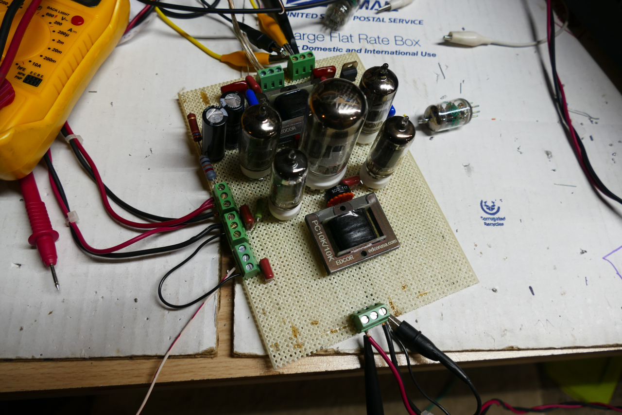

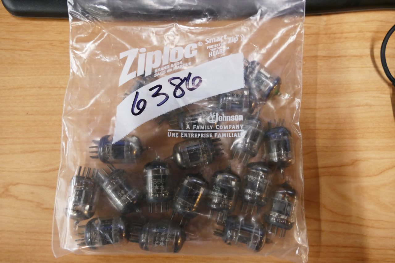

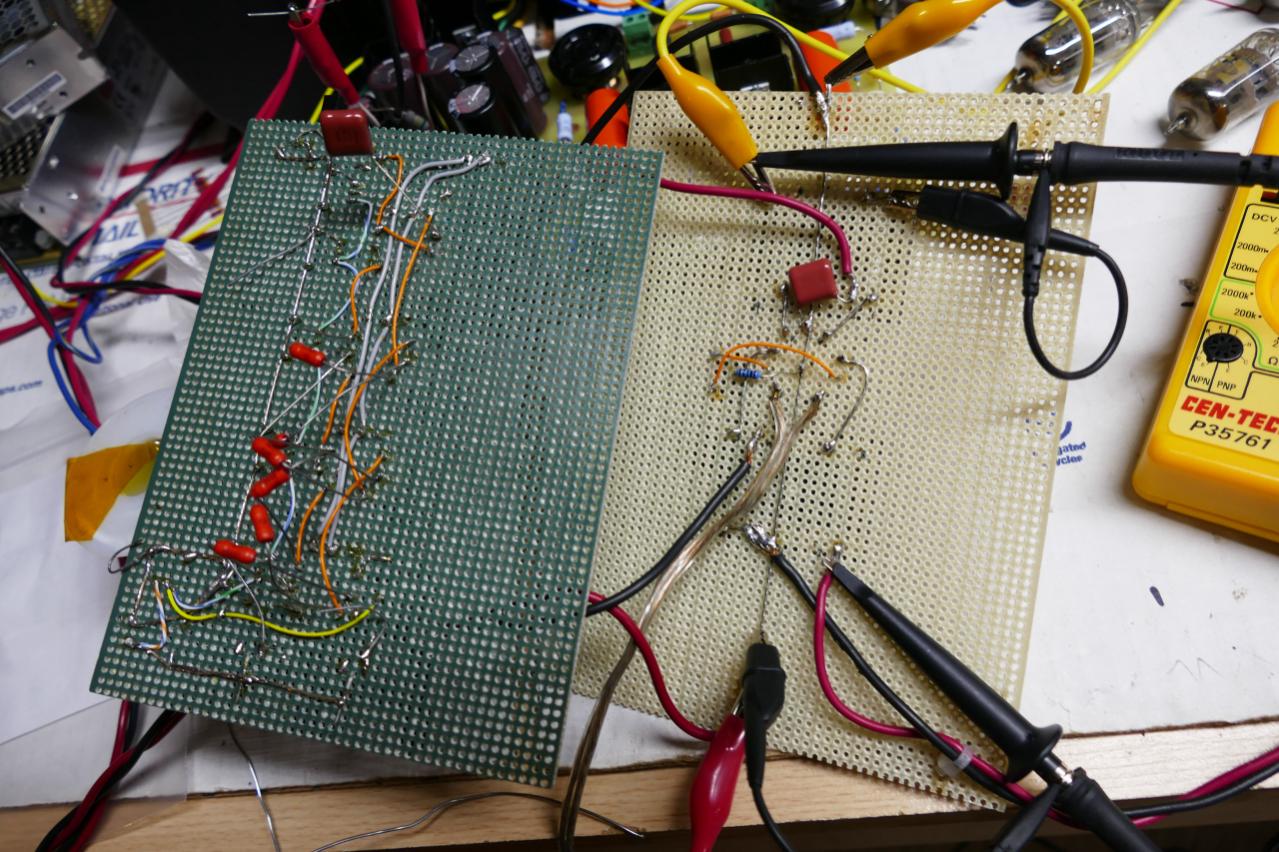

I have been tinkering with this Variable Gain Amplifier / gain cell design off and on over a period of a few weeks. Perhaps half of my box full of tubes have been tested....but some new discoveries will probably force me to start over. So what have I learned?
I started out with a simplified clone of the Fairchild 670 made with ONE 6386 instead of 4 in parallel as in the Fairchild, and I used some $10 Edcor transformers. It worked very well at 1KHz with about 60 dB of dynamic range The THD at 10 V RMS output is less than half a percent at 1KHz. It rises at each end of the audio spectrum, but that's not the real problem. The frequency response sucks to put it mildly. Loss at the low end due to transformer saturation was expected. Severe amplitude loss at each end of the spectrum was not.
The -3dB points are 240 Hz and 3.3 KHz at 100 mV output....not even good enough for guitar or synthesizer use, forget HiFi audio. At first I blamed the cheap transformers, and went on testing tubes.
My first breadboard had room for one 9 pin tube socket. I started with the 6386, and 5670 since it has the same pinout. Then I rewired to socket such that I could stuff in one of a few dozen dual triodes with the 9AJ pinout, including some remote and semi remote cutoff triodes seen in other compressors like the 6BC8 and 6ES8. These were all dual triodes, some from each cutoff characteristic were tested. None of these worked as good as the 6386, but the 6BC8 came close enough for a music synth. The frequency response varied with each different tube, and always got worse as the gain went down, really bad at negative gain. In these tubes, the plate current, and thus the Gm is reduced as the grid is made more negative, reducing the stage gain. As the plate current is reduced, the plate resistance goes up. Could this increase, coupled with the parasitics of the cheap transformers be responsible for the bad FR?
I dig through my junk box and find an old UTC interstage transformer, and wire it in with clip leads. Things get better, but still not good enough. At this point I rewire the socket for the 6386 and stuff one back in the socket. The response with the UTC is much better, but still not good, so....I sky wire another 6386 in parallel with the tube on the board, and things get better.
It seems that Fairchild used some pricey transformers that were maybe a wee a bit better than my $10 Edcors. they also use 4 X 6386 tubes in parallel. Could this be needed? I wired up a second 6386, and yes the frequency response got better. Four in parallel would probably get me in the ball park. OK, so to clone a Fairchild 670 I would need 4 X $120 tubes and probably the same $$$ worth of transformers....for ONE channel. I guess that's why old 670's fetch upwards of $20K!!!!
I ripped out the 9 pin socket and wired in a 12 pin compactron socket, as it was the easiest way to test some dual control pentodes because I have 10 NOS 6BV11's. The dual control pentodes work by deflecting plate current back to the screen grid. As you crank G3 more negative the plate current goes down while the screen current goes up. Again these were probably good enough for a music synth, except for that nagging frequency response issue.
The 6BA6 has been mentioned as a possible replacement for the 6386, and has been seen in some Fairchild and Gates clones, so I rip out the 12 pin socket, and wire in two 7 pin sockets. I didn't actually have any 6BA6's. I had 3 used Zenith brand 12BA6's that looked like they came out of old radios. They worked pretty good, but these, and nearly everything else that I tried made 40 to 55 dB of control range with THD's in the 1 to 3% at negative gain, but all had the variable frequency response issues, albeit in differing amounts. So while I have the 12BA6's in the hot seat, lets try wiring them as pentodes. Gain control is better, maybe 70 dB, but the frequency response and THD is MUCH WORSE, especially at negative gain.
Up until this point I had been just blindly testing tubes to find a cheap 6386, but there is clearly another problem that needs to be addressed. Trying the 12BA6 as a pentode made it perfectly clear. The plate resistance and the transformer imperfections are sucking the life out of my signal. I had to remove this variable to move forward with the testing.
Frustration with my test board led me to rip it up, make it bigger and wire in 5 tube sockets. 2 X 7 pin, 2 X 9 pin, and 1 big fat Compactron socket. I also added some mosfet followers to go between the tube plates and the cheap transformers. Variable plate resistance no longer matters.
This time I stuff in some $1 semi remote cutoff pentodes that I have a few hundred of. WOAH, 85 dB of gain control, zero point nuthin for THD, rising to 0.9% at the lower limit of measurement (about 50 mV). and fairly constant frequency response from 30 Hz (transformer saturation limited) to nearly 30 KHz.
I try lots of tubes.....ALL work to varying degree....but now I need to take all the measurements over again. I believe that this can be made into a useful circuit. It's already plenty good enough for the music synth. Some more Edcor transformers are on order, so that I can make another one of these setup for whatever tubes / circuit I chose so that I can get back to the vacuum tube ladder filter VCF.
I never tried the current steering circuit, or the BDT's and SBT's, nor have I run sound through this and put the output through some speakers to listen for thumps / pops and other sonic weirdness More testing is needed, but time is rather short right now.
No, you don't stuff all 5 tubes in at once, but it makes for a better picture, since it hides some of my ugly wiring. Unfortunately, the only tubes it can't test now are the 6386's and the BDT's. Depending on how long Edcor takes to make the new batch of transformers, and how much time I have for this, I'll either rip it up again, or build a new one.

> The -3dB points are..........
A transformer needs a "low" impedance for good bandwidth.
A VCA can often run with low max gain (follow it with fixed gain as needed).
My crayon scribbles often include few-K resistors across the plate winding.
This is especially important with pentodes and their infinite rp.
This also swamps the rise of triode rp as tube goes to cut-off (negating some of the drop of Gm).
Obviously the resistor reduces output level and raises THD, so much fiddling may be needed.
