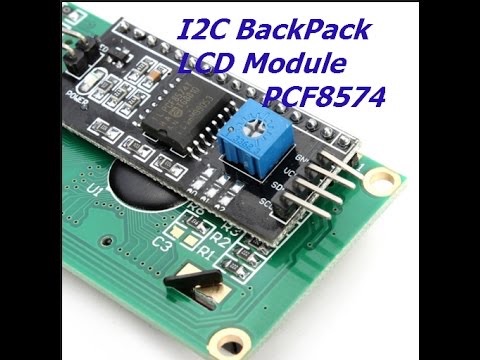

There is no need to develop a "clip on" board to convert i2c to something LCD for the Basic Display Board as these already exist, are readily available and inexpensive. Indeed, many sell LCDs with the 'backpack' already fixed making them i2c based LCDs. I am shortly going to try one of these backpacks on an alphanumeric OLED display that works by HD44780.
Which is awesome... the only issue is how to connect it. I doubt it has a pin-compatible IDC socket. So perhaps we don't need a piggyback board, but instead we need a "chain breakout board".

All the i2c to LCD 'backpacks' I've seen have four pins (GND, VCC, SDA, SCL) sticking out the end, spaced at 2.54mm - so easy to connect. If you need to chain it, rather than it being at the end of the chain, then a trivial bit of veroboard will suffice. The attached picture is of a backpack fitted to the rear of an lcd.
Perfect, so a chain breakout board would be ideal here then. Less work and far more useful!
