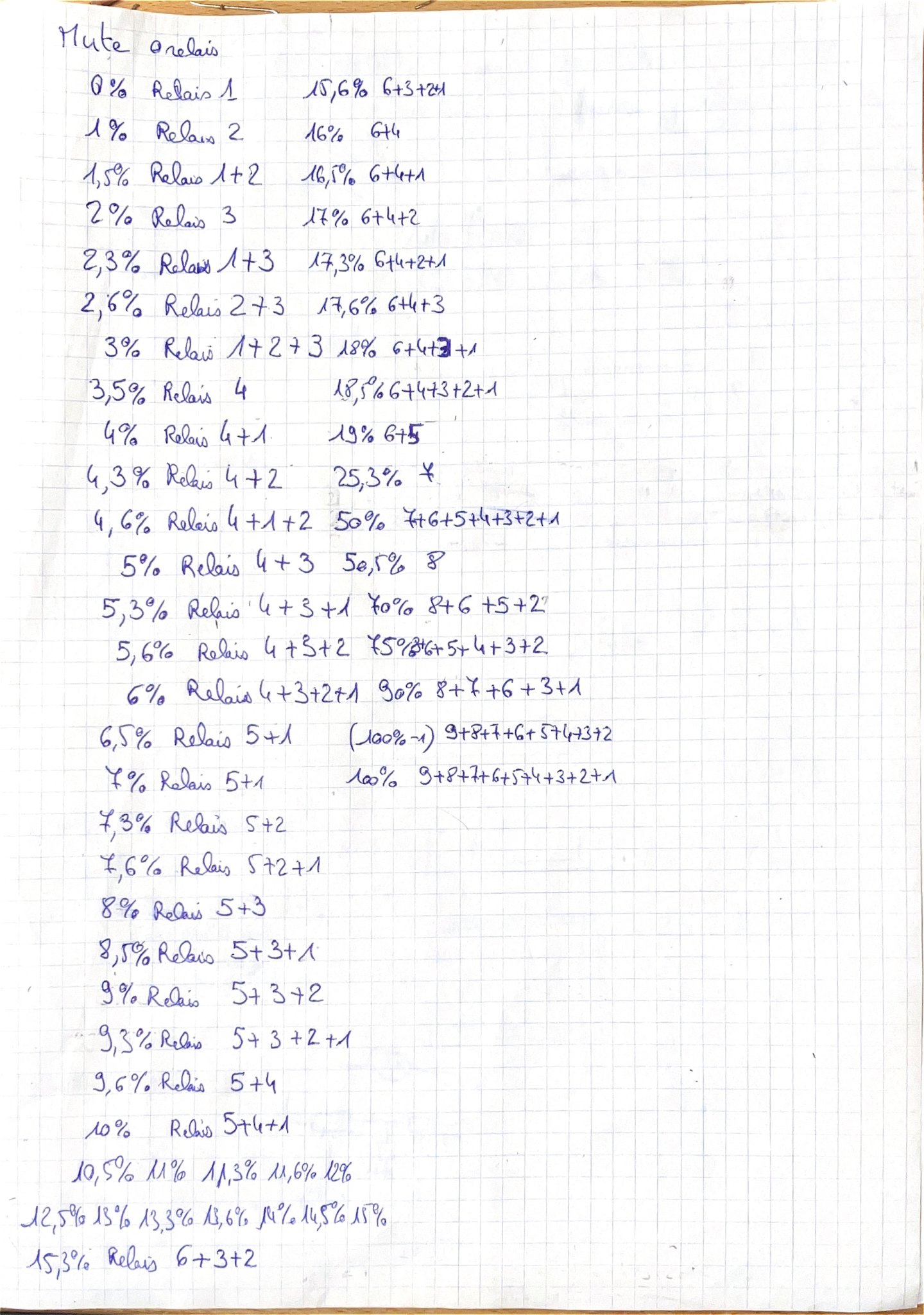

I did the sequence of relays to understand a little more.
We see that the problem starts from relay 7.
In my opinion the program is not the right one or the diagram is not correct.
Can you give me the compliant versions?
In Mute position the equivalent resistance is 103.75R
At 1% 101.1R
At 3.5% 94.45R
At 6.5% 87.35R
At 15.3% 74.9R
At 19% 67.75R
25.3% 79.45R
50% 24.9R
At 1% 101.1R
At 3.5% 94.45R
At 6.5% 87.35R
At 15.3% 74.9R
At 19% 67.75R
25.3% 79.45R
50% 24.9R

Are you only having problems with the volume?
Is everything else working fine (input selector, web interface, etc.)?
Unfortunately I don't understand programming, I hope someone from the community can help us.
Regards
Yes, after several checks, the problem isn't the programming, it's the calculation of the resistor scaling.
I have a Chinese model, but with 7 relays, it uses different values.
It works fine with the same programming.
I don't know how to calculate the 8th value.
R1S=2.74k,R1P=825k
R2S=5.49k,R2P=402k
R3S=10k,R3P=200k
R4S=18,7k,R4P=82.5k
R5S=30.1k,R5P=33.2k
R6S=42.2k,R6P=9.31k
R7S=487k,R7P=1k27
R8S=???,R8P=????
Rfinal 50k
