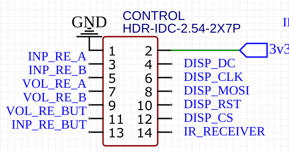

On this same Easy EDA diagram, there are several terminal assignment errors. Does anyone know how to read the Arduino program to understand which inputs and outputs have been assigned? For example, there is an inversion between the flight encoder and the pulse button.
On my view screen board 1.3 I have 14pins from this link http://bit.ly/pa-01-adb

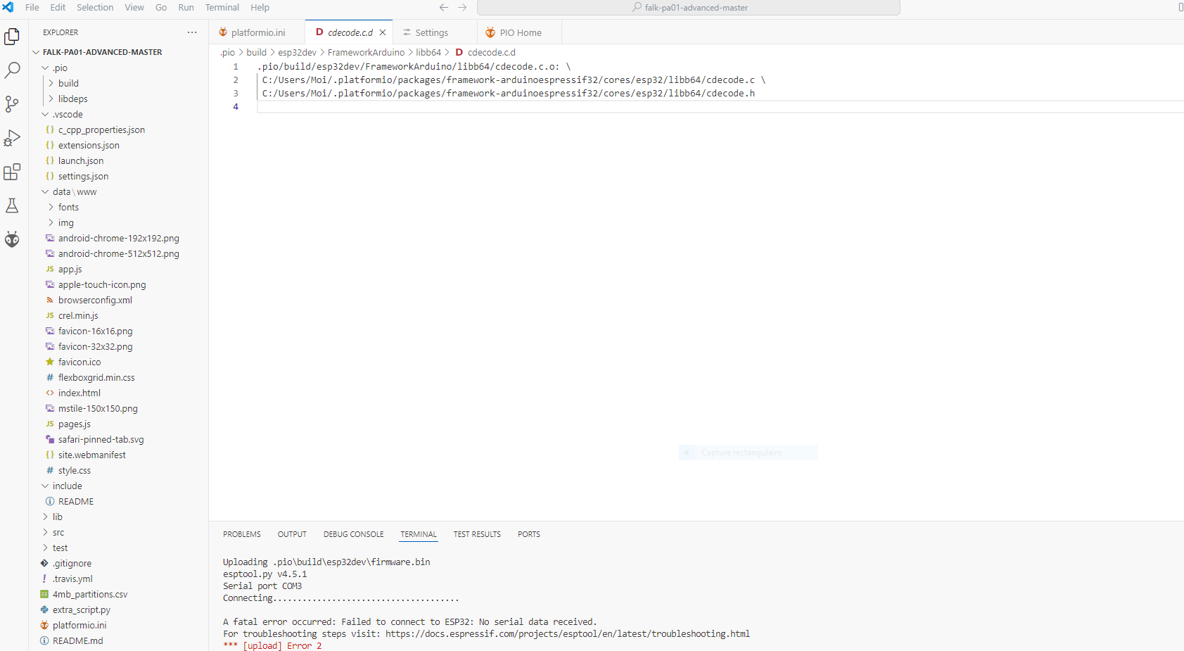

In visual studio can someone help me find the state of the inputs and outputs? I attach a screenshot
I found for pin assignment in the program. Under Data->src->falk-pre-conf
// ====== DEFINE PINS ====== //
#define WIFI_BUTTON 35
#define SCREEN_CS 5
#define SCREEN_DC 15
#define SCREEN_RST 13
#define MUTE_BUTTON 34
#define INP_ENCODER_A 14
#define INP_ENCODER_B 27
#define VOL_ENCODER_A 26
#define VOL_ENCODER_B 25
#define POWER_BUTTON GPIO_NUM_33
#define POWER_CONTROL GPIO_NUM_32

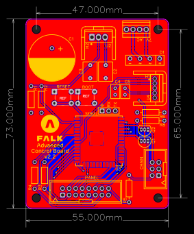

My screen does not light up. The rest of the preamp works via the web address.
The screen is connected in serial 4 wires, after checking I have no wiring problem.
Could someone help me to make a test program to be able to test.
Hey, apologies for the delay, I wasn't getting notifications!
It sounds like you have two different versions of the boards:
Otherwise the two boards are the same though. As long as you have pins 1-14 connected correctly, I can't see why the screen wouldn't work. For the screen to work, you really only need
The pin assignments should all be correct, as I run this firmware on my preamp. Can you tell me which pins you think are wrong?
These are the pin connections for the display board
These are the pin connections for the control board. Note that pins 1-14 are the same
Do you have the rotary encoders connected? If so, do they work?
Some photos of what you're working with will make it a little easier to troubleshoot.
I will also upload the newer version of the display board to the GitHub repo (https://github.com/gilphilbert/falk/tree/main/pa-01) tonight, I didn't realize it was missing. The files are much easier to manage from there.
- The control board is the 16-pin variant, which includes power button and LED connections
- The display board is the 14-pin variant, which doesn't include those connections
3v3
, GND
and the DISP_
connections - in fact, you can even wire them directly to the display if you use dupont connections.The pin assignments should all be correct, as I run this firmware on my preamp. Can you tell me which pins you think are wrong?

Hello, I am really happy to read you.
Incredible thing today, just before your message, I managed to debug my card.
I had trouble understanding that all the outputs could not be referenced in the program. I did not know that libraries were loaded at the time of download, affecting these connections.
The fact that it did not work for me is that I remade a single card connecting the screen, the buttons and the ESP32.
As I took as a reference the mix of old card with new ones. I ended up with the volume and input selector inputs reversed.

Great, so you have the display working?
The button is a simple momentary push button, just needs to be wired across PWR_BUT and 3v3. When it goes high, the ESP32 will go into sleep mode (
