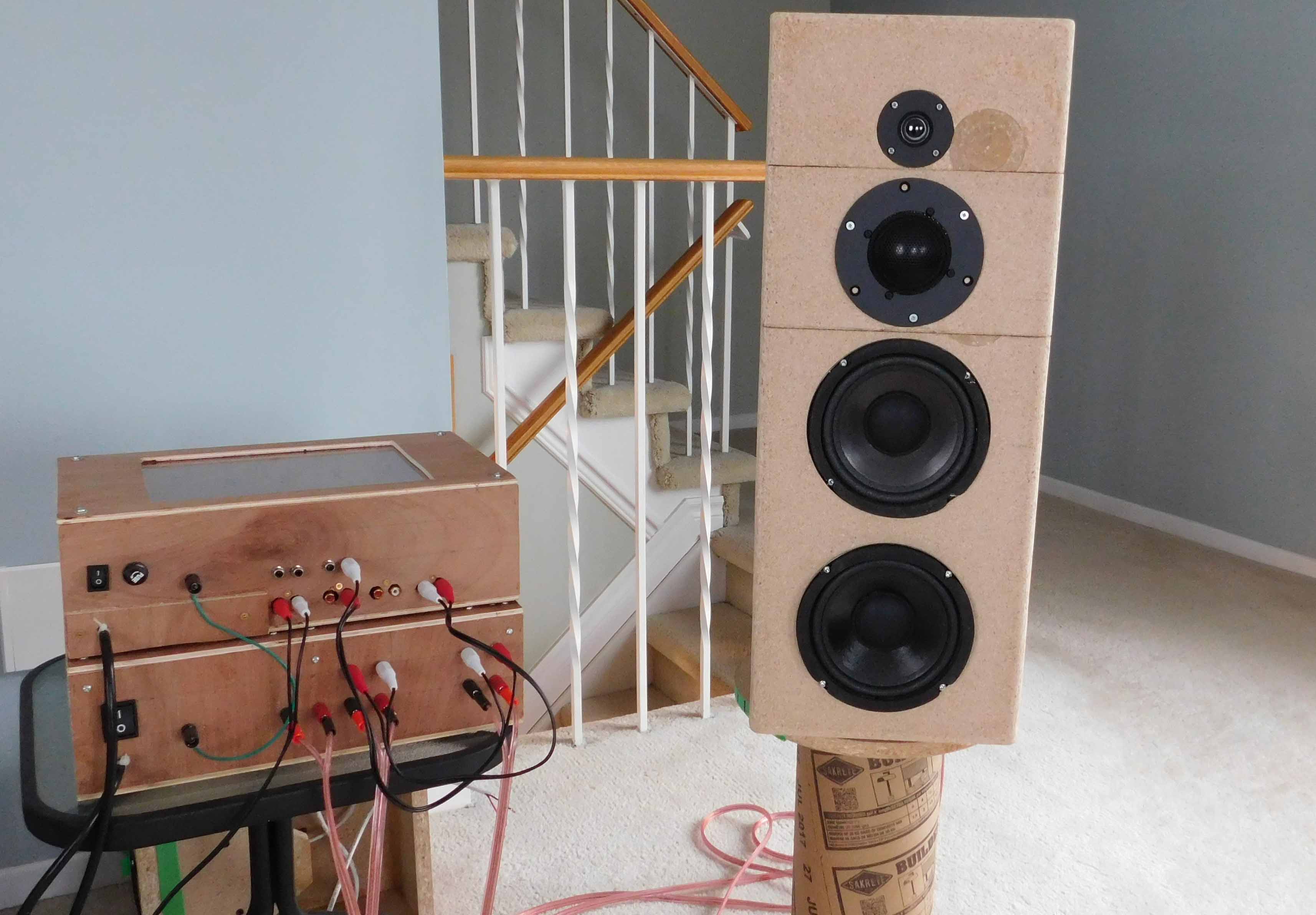

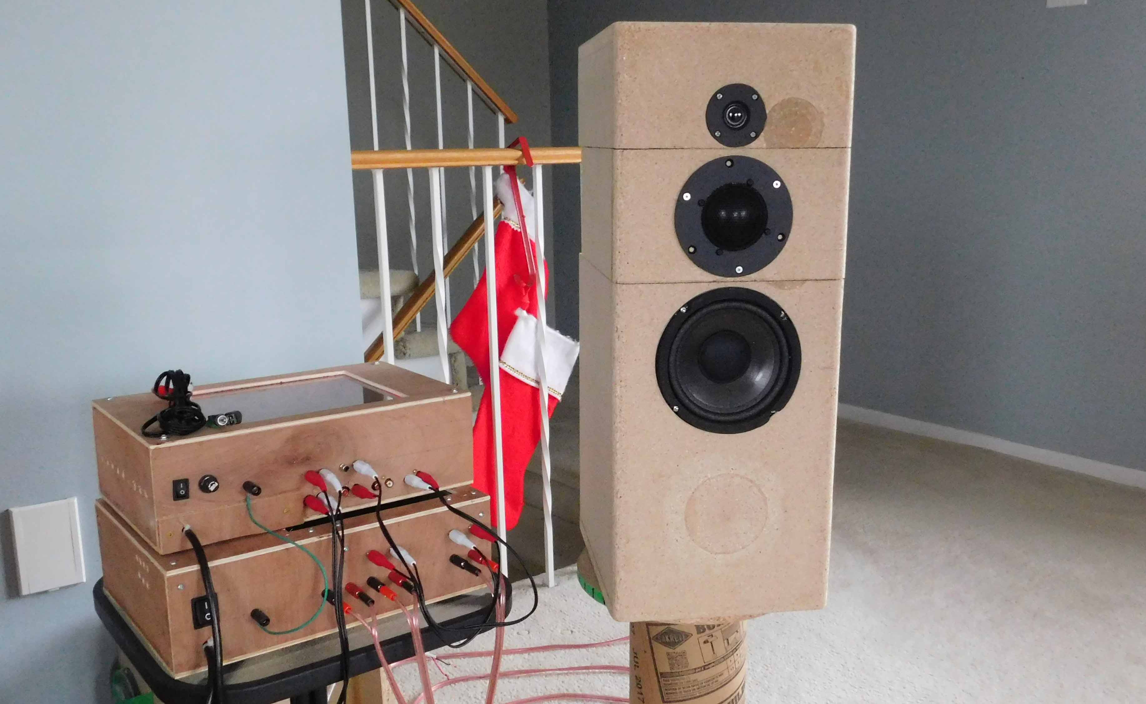

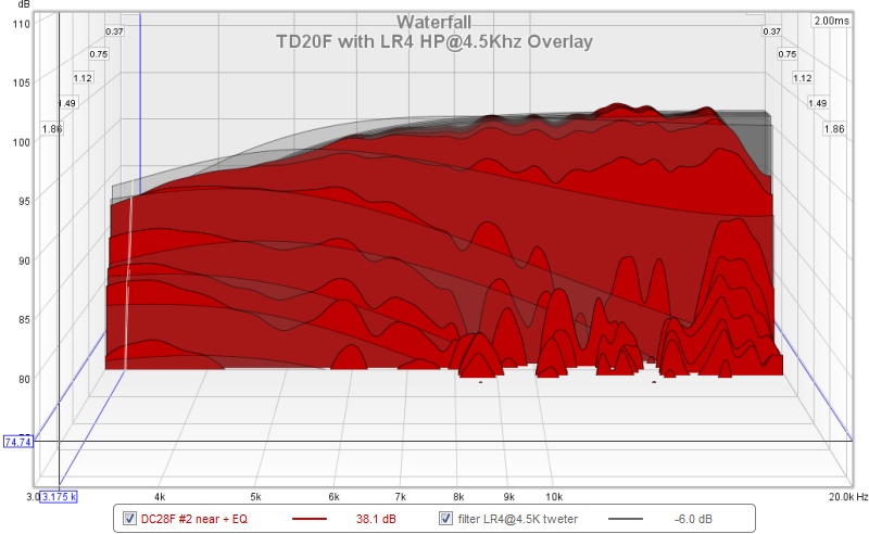

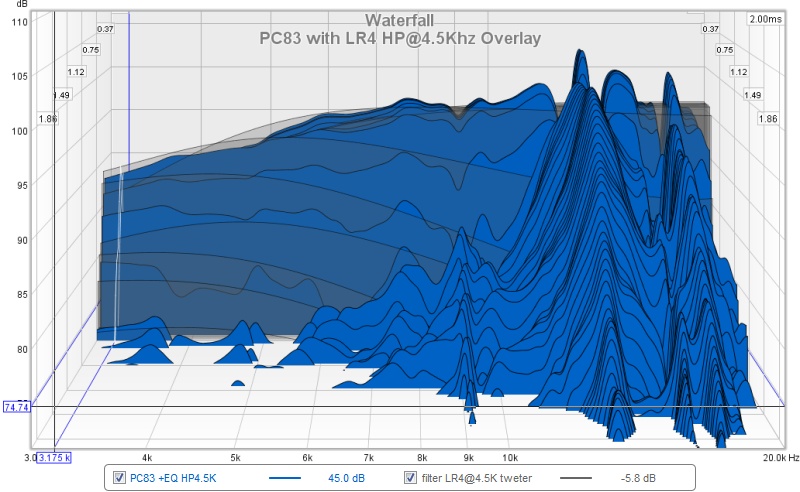

I connected the PC83 fullrange to the HP output to compare it to a TD20. I would expect a tweeter to make a better tweeter, but was interested to see the comparison. Both measurements are same distance and EQ'd flat to match the LR4 curve. The LR4 is added as an overlay in both.

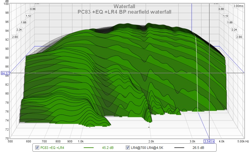

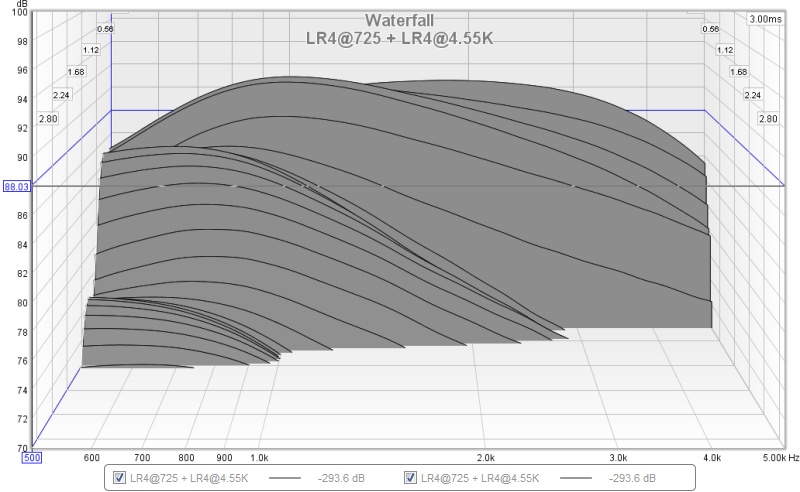

RS52AN dome midrange

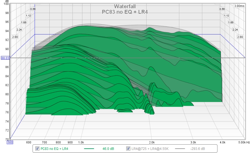

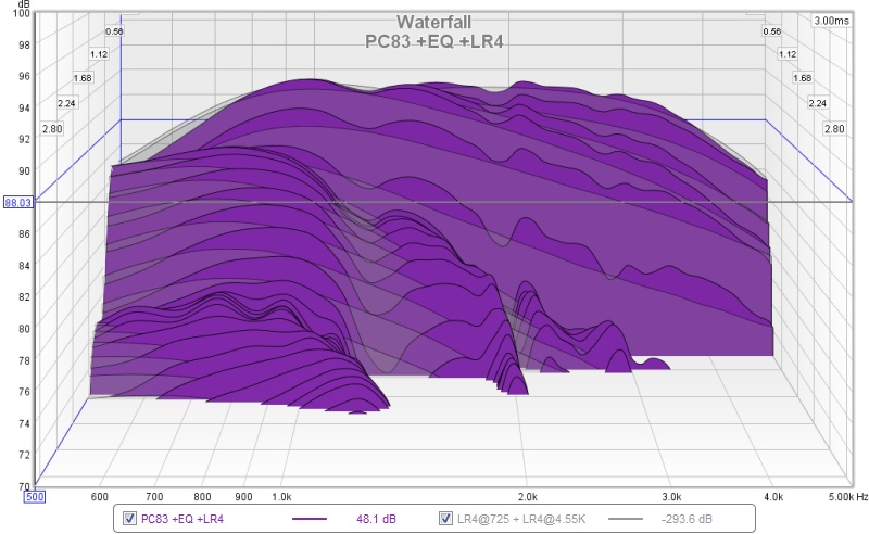

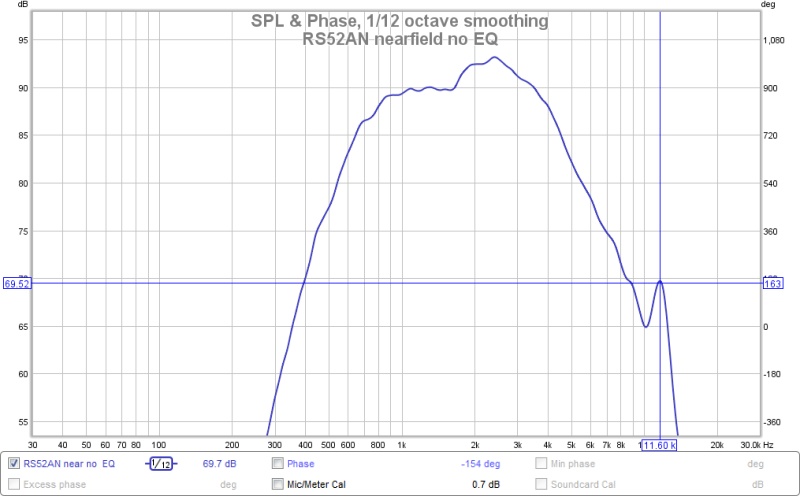

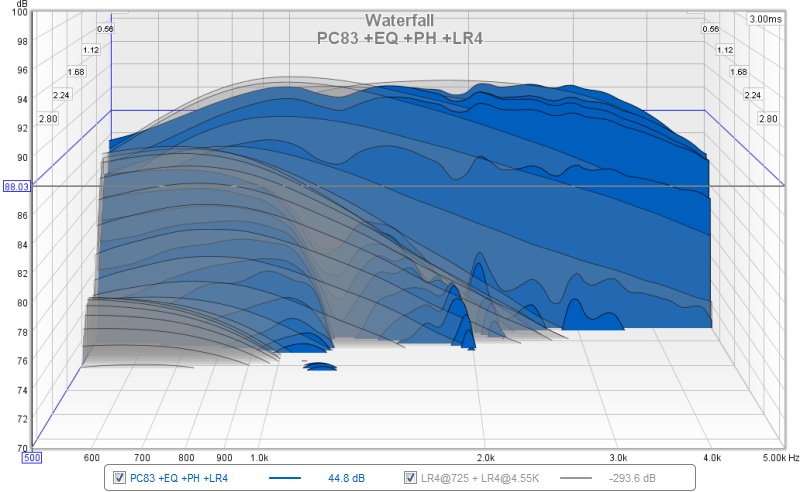

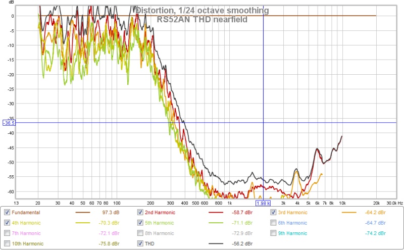

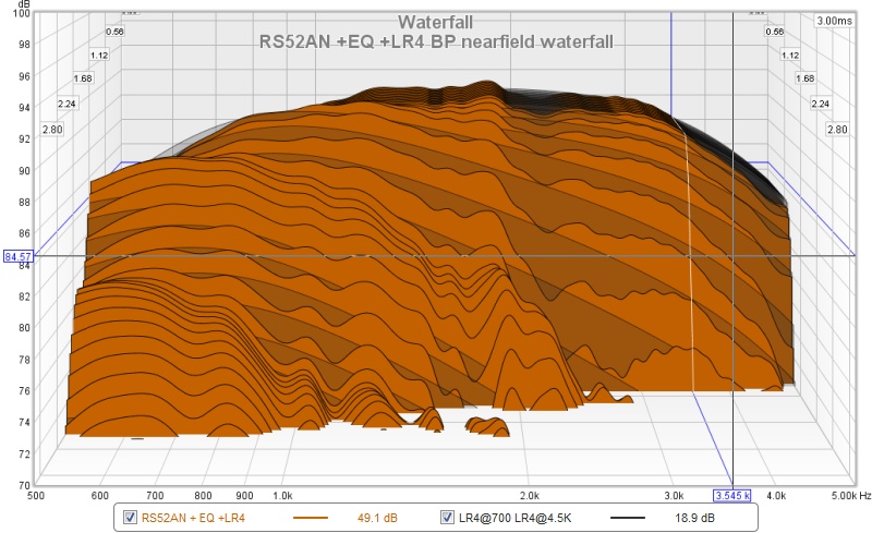

I picked up a couple of RS52AN (2" AL dome) to compare to the PC83 (3" poly cone).
The raw RS52AN driver response + LR4 BP and THD are the 2nd & 3rd graphs. The amp was used to SPL level out the sensitivity differences with the woofer and tweeter. The RS52 has surprisingly low distortion and it sounds detailed and clear.

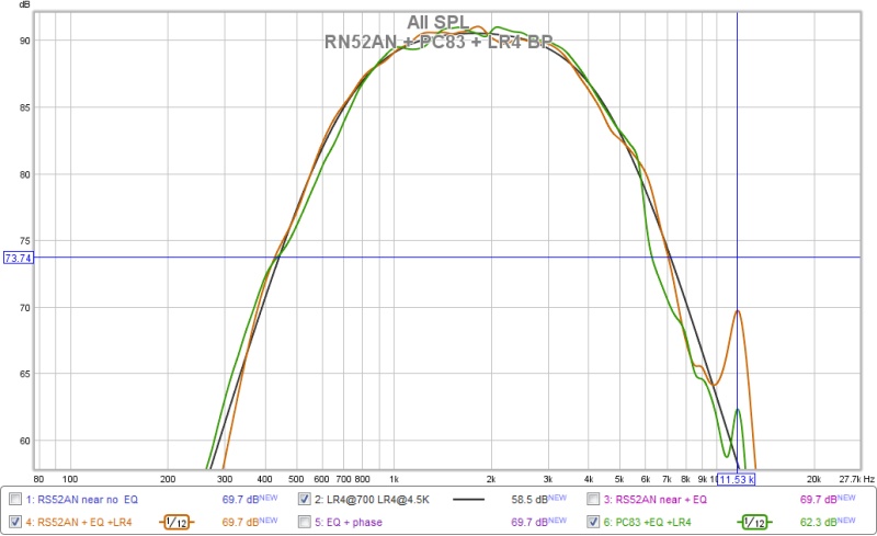

After EQ both drivers follow the LR4 BP fairly closely (pic#4) and their waterfalls (pic#5,6) are also very close and without issues. The dome sounds better IMO but its hard to get that from the graphs.

Looks very respectable Don. The PC83 as a tweeter graph shows your waterfall graphs are working as they should! Really shows up high freq resonances!!
Tony.
Tony.
Very nice results, using a good logical methodology ! Thx for sharing.

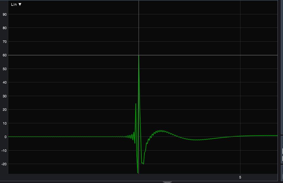

You found the same as i did, about the look of LR impulse responses.
Below's a summation of a 4-way crossover from a high-quality active x-over.
So electrical xover bands summed together only, no speaker involved.
Can only get worse looking with a speaker in play Lol
LR24's...100, 650, and 6300Hz xover freqs.
FWIW, the difference I've found between using FIR to correct a speaker's entire mag and phase output globally, vs correcting mag and phase driver-by-driver individually before then adding linear phase crossovers is:
Both methods can give near identical results tuned to one spot (usually on-axis).
Both can look near perfect.
But the global correction's measurements will fall apart off-axis (off the tuning spot), much more so than the driver-by-driver method.
Acoustic summation through x-over holds up considerably better at different angles, when adjacent drivers have a smooth phase relationship between each other.
Tony.
Thanks. I'm now finding CSD a useful view as it can find issues not detected by the FR.
The midrange FR and CSD for the PC83 and RS52 are very similar so I can't easily differentiate them graphically. I have a definite preference for the dome, so I'd like another measurement / test to show that difference. Suggestions ?

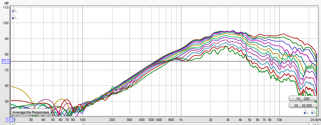

Attached is a graph of one of my DMS37 tweeters on axis through 110 deg off axis (in 10 deg increments). It seems reasonably well behaved I think.
One important thing is when you are rotating the speaker it needs to be rotating as if the centre is flush with the baffle and running down the centre of the baffle (if that makes sense).
I made my own rotating speaker stand, but it has some issues, mainly with tilt when the weight shifts due to rotation (center of rotation flush with the baffle presents some challenges!)

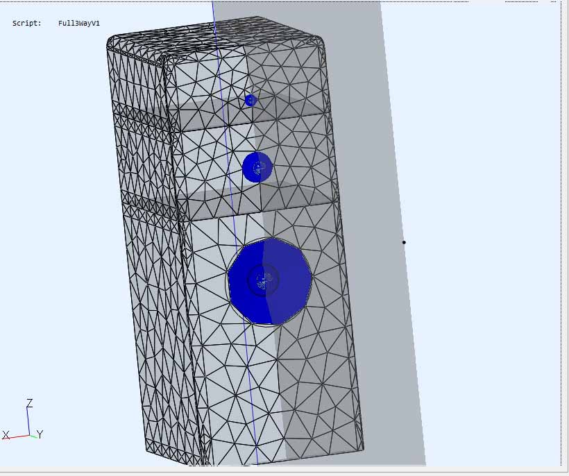

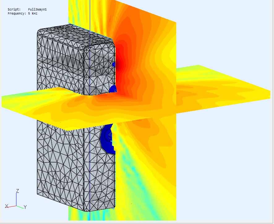

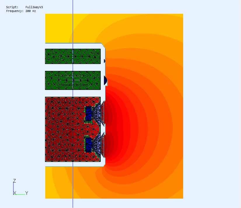

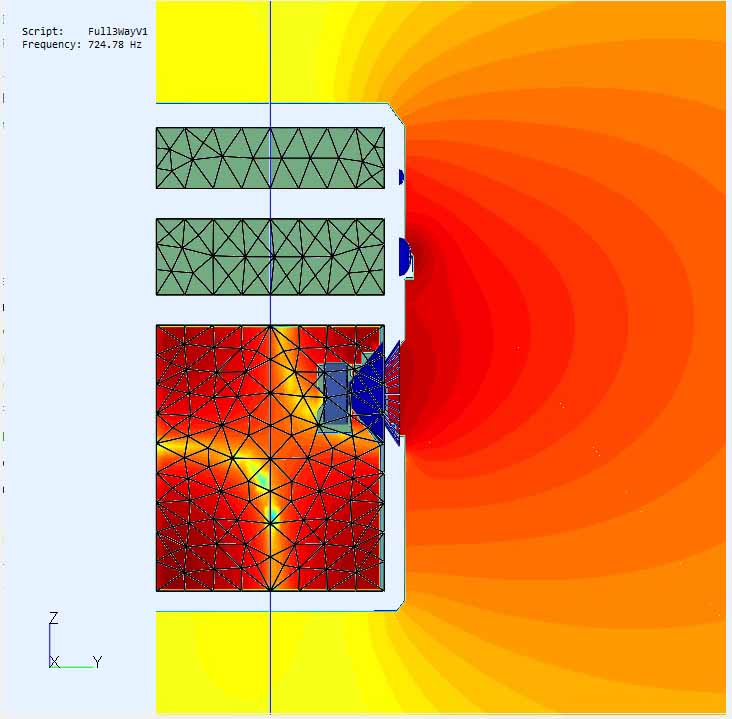

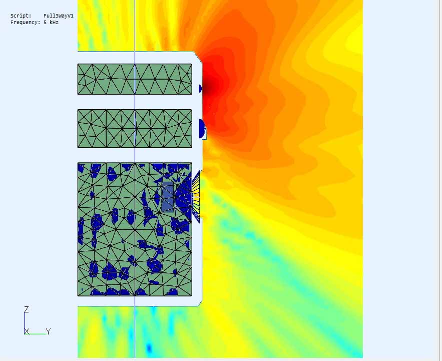

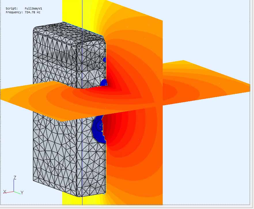

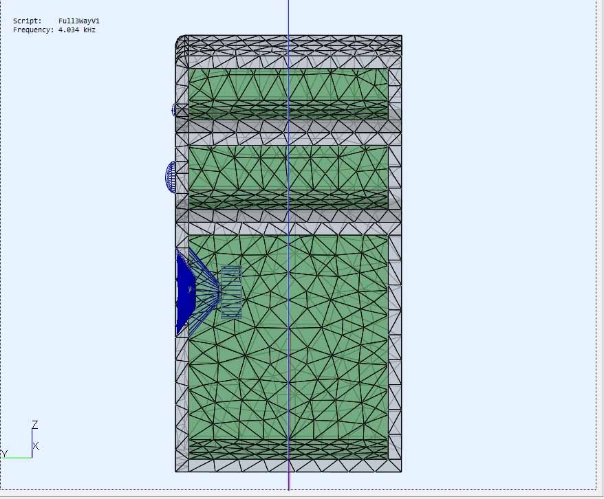

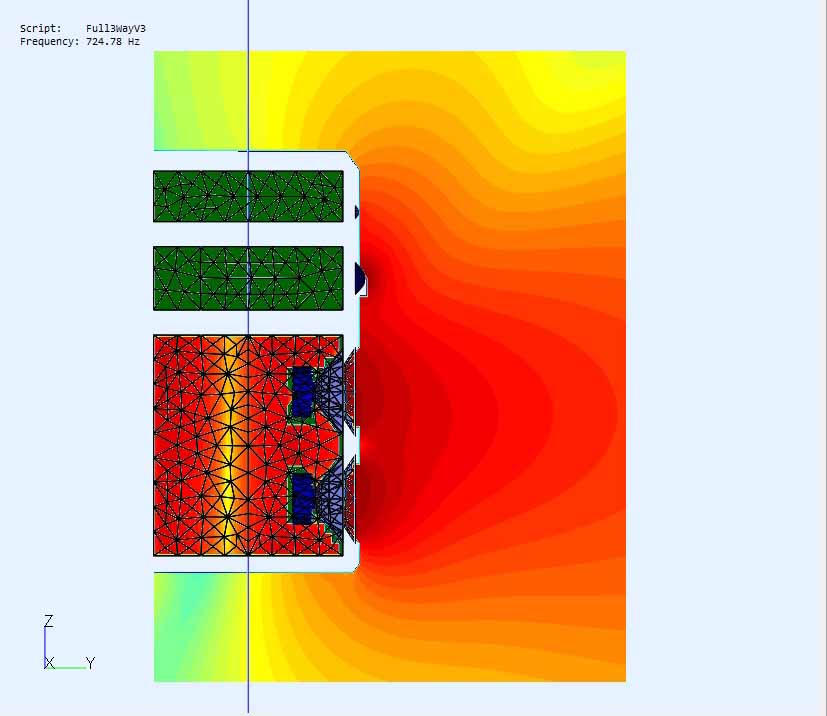

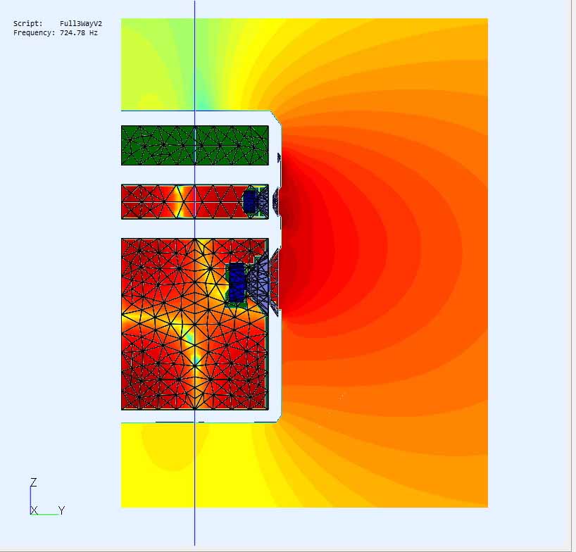

I had some time to start an ABEC3 model of this speaker so I can compare/adjust the field shapes from the entire speaker. The ABEC model is modular just like the sandbox and includes the active 3way XO [725Hz, 4550Hz]. This model does not have interior box modelling for the TD20F tweeter or RS52AN midrange boxes because these drivers have sealed backs.
I'm trying a few sims trying to understand why I prefer a midrange dome to the cone even when I can make their FRs equal. These pics are speaker cross sections with wavefronts at the XO 725Hz.
The first is uses the cone with the rear chamber so its sim'd as well. The dome has a closed rear chamber so just the front is sim'd. They both look fine.
Maybe its the polars that are difference.
Interesting Don! I'd looked at ABEC before but never tried to sim anything (I have played with akabak).
The dispersion at 725hz looks excellent, 5Khz in the first post is starting to look a bit less so. How long did it take you to get up to speed using abec?
Tony.
Tony.
ABEC3 supports Boundary Elements (BE) and Lumped Elements (LE). The LE engine is very similar to (the son of ?) AKABAK. It's fairly easy to do the syntax fixes and get the older AKABAK scripts to run under ABEC3.
Tony.
There are 3 tools required for this acoustic sim. The mechanical dwg is done in FreeCad [8hrs to learn basics], the mesh is created with GMSH [1hr for basics] and then ABEC3 [40hrs to learn basics]. There is an additional VACS tool [2hrs for basics] used by ABEC3 for plotting FR, polars, etc. It would take less time if there were a good video series on ABEC3 instead of deductive learning via it's examples. There is another thread on ABEC that has a good tutorial by Gaga. ABEC experts - help!
It seems that rounded corners on a box are sufficient at the low->mid freq, which is no surprise. The effort will be constructing a baffle shape to get clean integration with mid-high performance.

The pictures are SPL fields around the speaker (y=1m@right side) at a particular frequency. I was interested to see how the different midranges interacted with the woofer(s) and projected sound from the cabinet. The "red" level is +100db and "yellow" is around 80db and "blue" is 60db. I removed the outer case so you can see inside as well as outside the speaker. The simulation includes the XO, driver models, and cabinet construction (baffle roundovers included). The ABEC simulation itself uses BEM to solve the Helmholtz integral for each finite element (mesh triangle) pressure and velocity.
