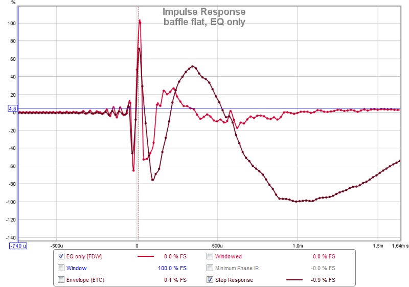

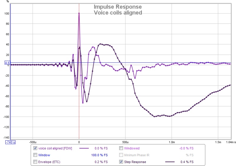

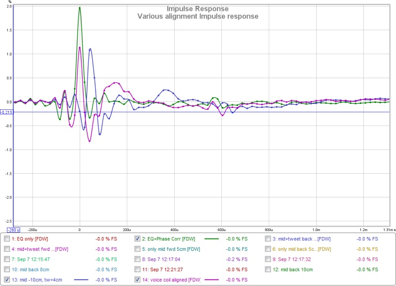

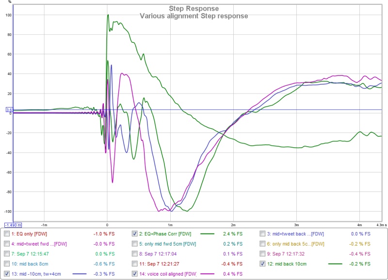

I was curious to see if I could effect the same IR & Step cleanup by shifting the drivers to time align them. The problem is a single distance but the wavelength variation is infinite. Pics#1*#2 show the drivers are shifted in the Z-axis only.

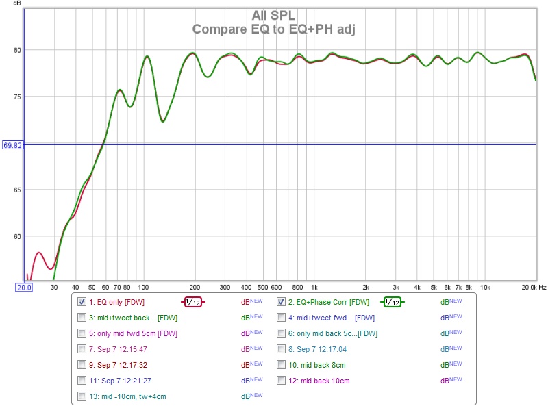

Pic#3 is the FR with EQ only, then overlaid with the EQ+PH corrections on. You can see that I can change phase without effecting the FR shape.
Pic#4 & #5 are a comparison with flat baffle vs voice coil alignment. It makes a little difference but not much. I require more phase adjustment than simple driver shifting can provide. It also is causing more diffraction and a bumpy FR from the front steps. Pic#6 & #7 are just some variations in IR and Step from various combinations that I tried. Notice aligning VC's is a move in the right direction but it's not enough and it would only be the right correction for a narrow band(s) of frequencies.

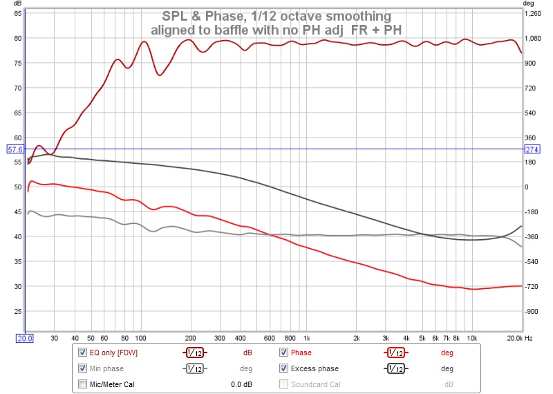

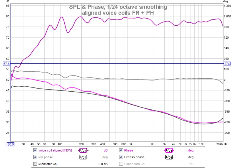

Interesting! Could you also post the comparison of the FR with the phase. I'm assuming that with the phase adjusted it is pretty much a flat line across.. Much less of a difference with the time alignment than I was expecting 🙂
Tony.
This is the graph for aligning the voice coils and is very similar to the aligned to baffle graph. You can see the amount of phase adjustment required to get back to a min phase response.
The LR4 may be phase aligned, but not in the same cycle. The LP shift is +360deg (4 * 90deg per order) and the HP is shifted -360deg, so there is a 2 cycle difference (-720deg LP to HP), even if they are "in phase".
Interestingly, you can select a distance that causes two drivers to be out of phase at a particular frequency and generate a null. Might come in handy for resonant drivers.
Late post : sometimes REW is off by a cycle, so in the 2nd graph the min phase should be centered on 0deg not -360deg (diff 1 cycle) and same with excess phase is sometimes 360deg (1 cycle) off. Don't know how to adj it, as all the curves move when you "add phase, +/-360deg".
REW unwraps the phase based on the cursor position is when the phase is wrapped. In the charts above it appears the cursor was at 20Hz when the phase was unwrapped.
The desired result should be achieved if the cursor position is nearer the top of the frequency range when the phase is unwrapped. Try 10kHz instead of 20hz.

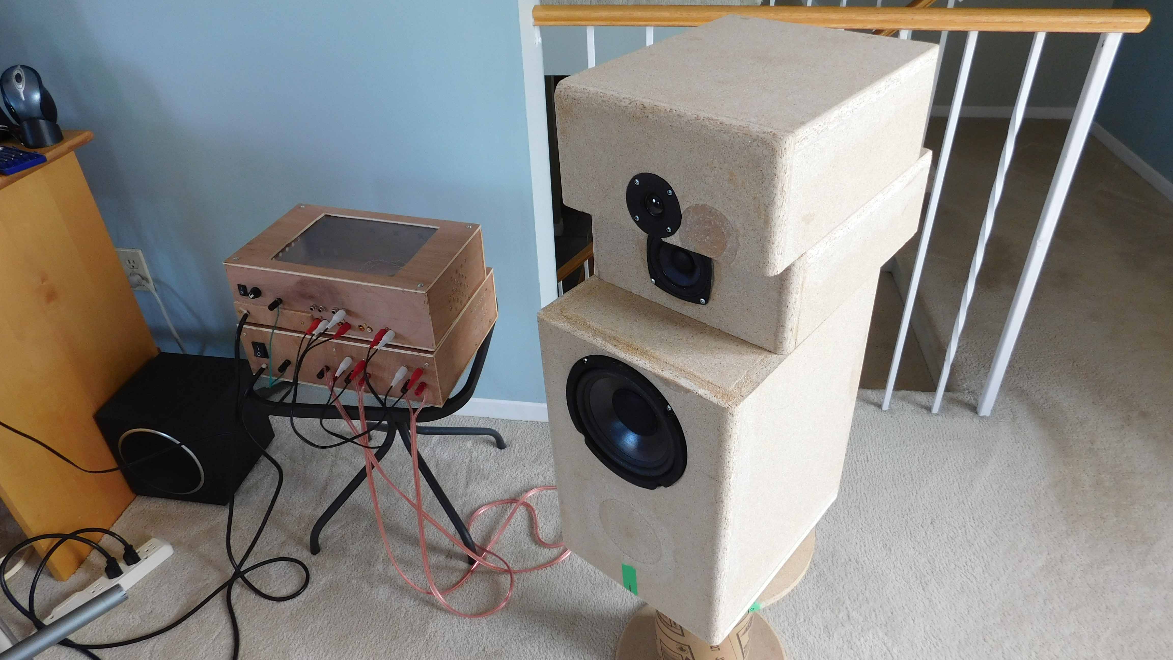

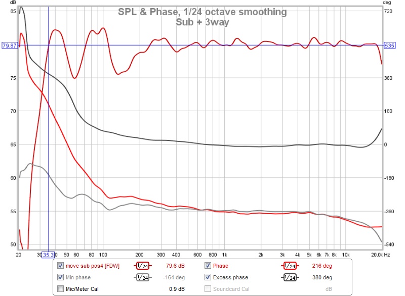

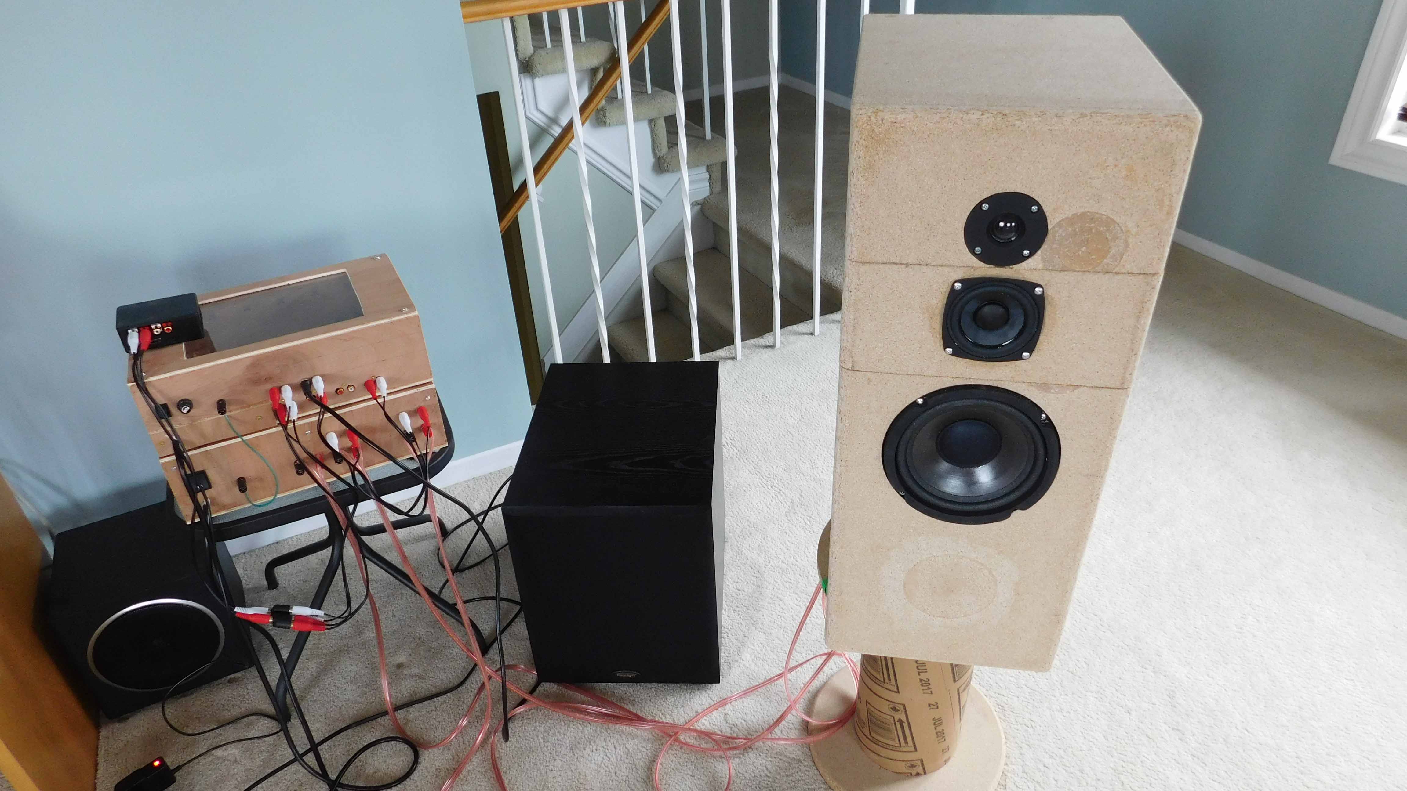

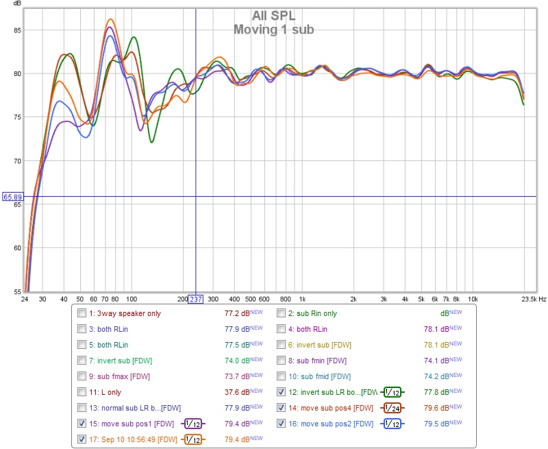

Adding a single sub + RPI

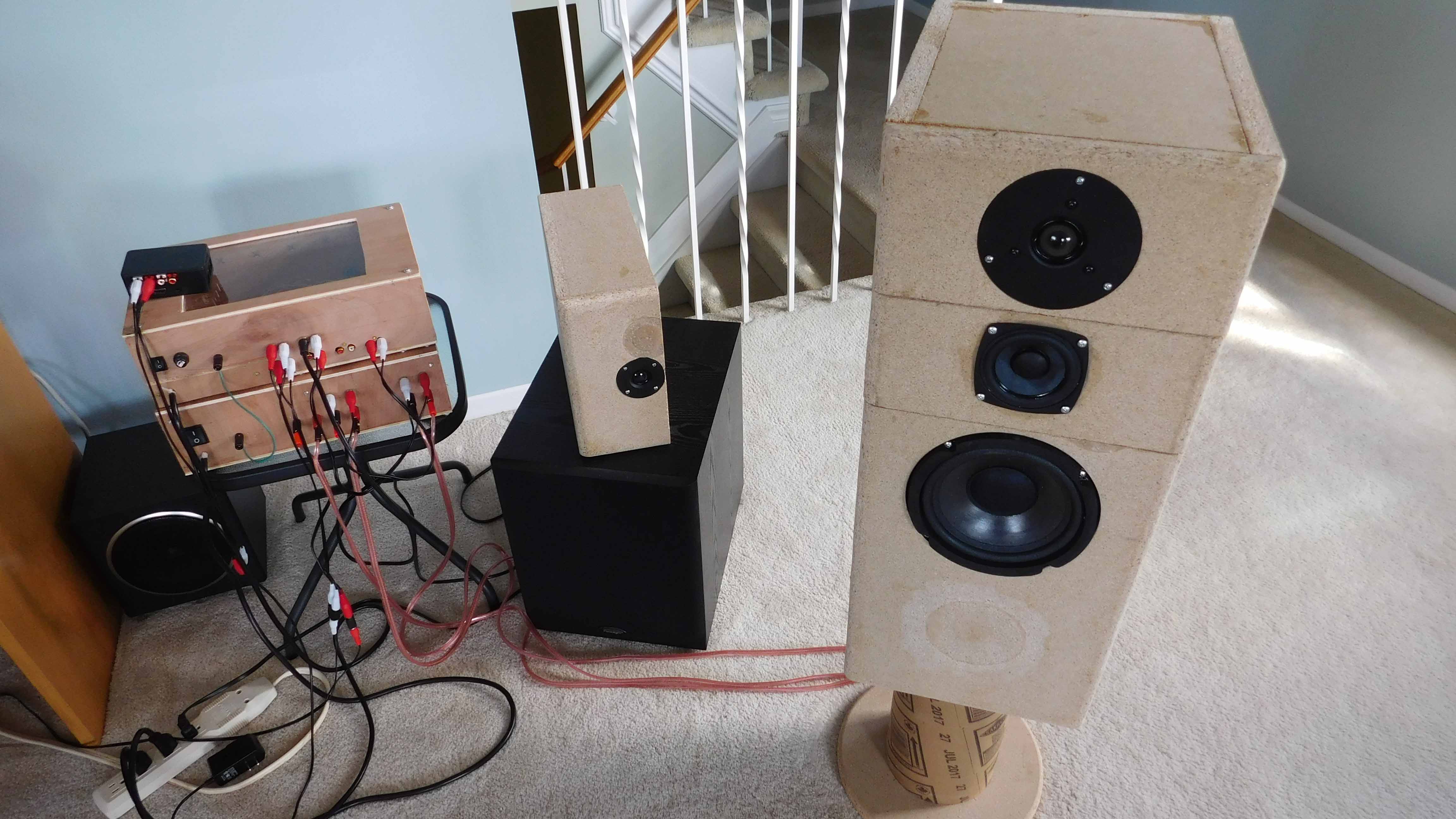

Next up, filling in the VLF by adding a single subwoofer (pic#1). I have room modes that are hard to suppress with only 1 sub (pic#2). I can get better (more even) with 2 subs, except I'm short an amp channel until I build in more. I used a PDR10 (built in amp) to start filling in the VLF. Pic#3 show the variation as I move the single sub around (within 1m dia circle). Sounds much better but it needs my other sub (BP6).

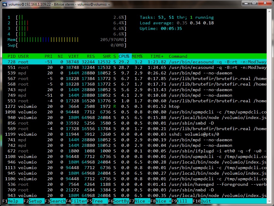

Then I moved the EQ and FIR filters over to my RPI3B. It's a headless and wireless media player running Volumio (player), Ecacound (EQ), and Brutefir (FIR). It's currently running its Piano DAC in 2.0 mode so I can use my analog sub bandpass. Attached pic shows light CPU loading on the 4 cores.

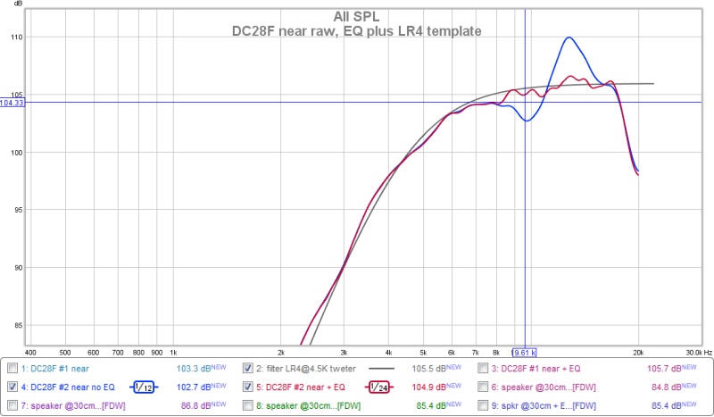

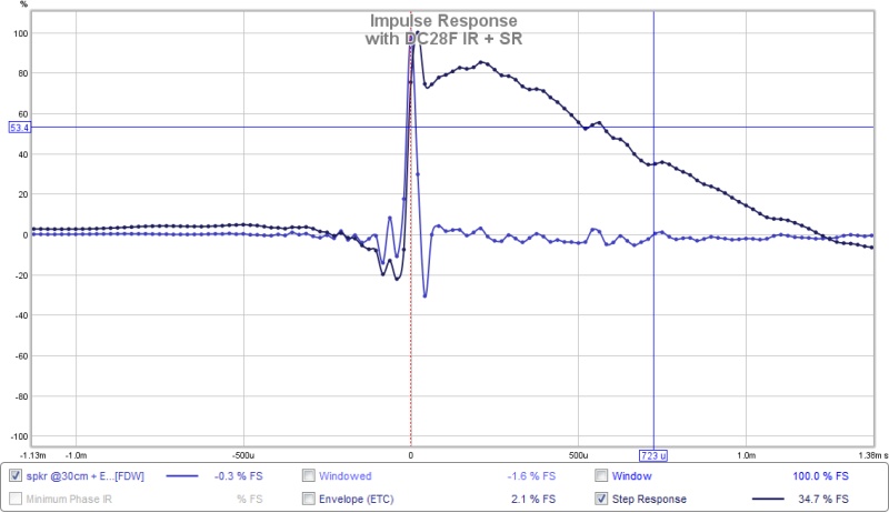

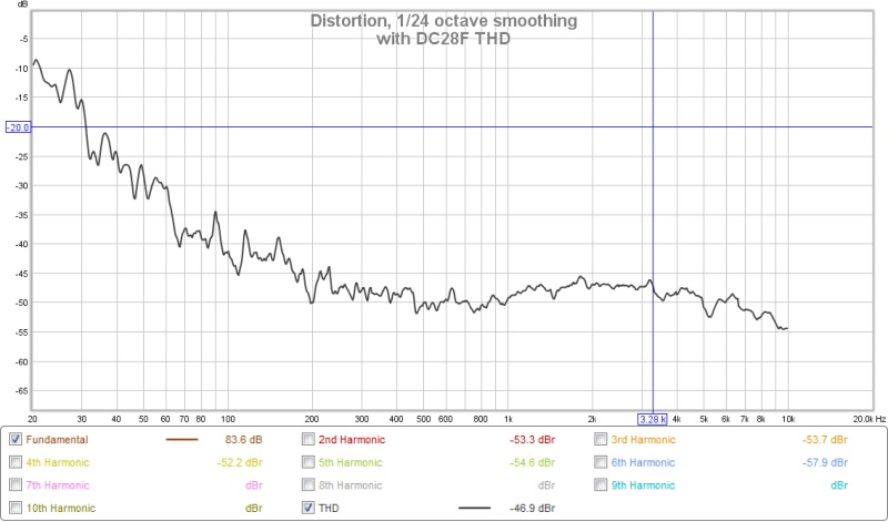

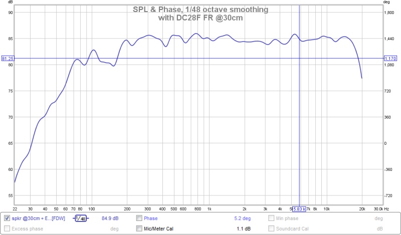

trying a different tweeter, DC28F
After a week of listening its time to change the configuration and try a new tweeter. I did like the previous configuration (TD20F tweeter) and would like to compare it to another (DC28F tweeter) that I have. The DC28F has a large faceplate that I did not remove, and it results in a large 10cm C-C spacing from the midrange.
Pic#1 shows the top slice that was replaced. The new tweeter (DC28F) was EQ'd to flatten it and there's a LR4 template curve @4.5KHz for comparison. I have 2 of these tweeters and they both measure the same. The entire speaker's FR (without sub) measured at 30cm to check the integration. Interestingly, I did not adjust the FIR phase adjustment, I reused the last one, and it came out reasonable looking.

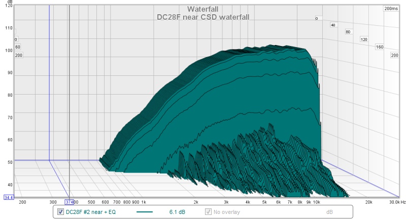

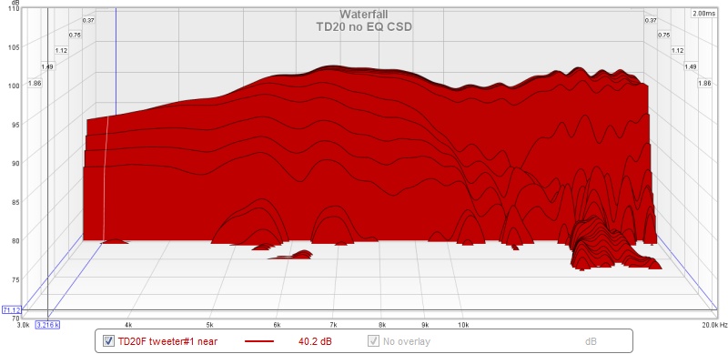

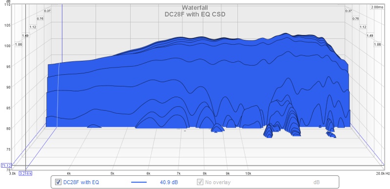

tweeters compared
I level adjusted and flattened the FR before comparing these tweeters. There is nothing dramatically different between them and both sound good to me. I do think the TD20 is slightly better sounding and only because I can get it closer to the midrange.

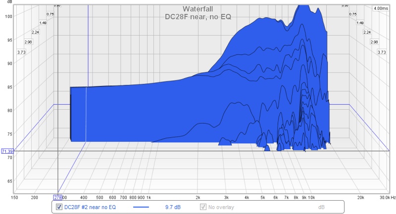

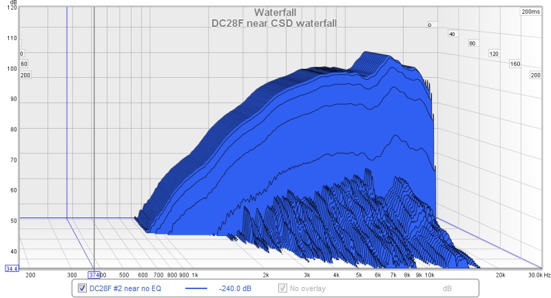

I posted a couple of near field waterfalls for these drivers with my XO in place. The first 2 are the drivers with no EQ drivers, and the last one is DC28F with EQ.
I can't extract any insight from them. Except maybe that EQ does not change the underlying resonances in the driver, because the CSD tail is not effected by EQ.

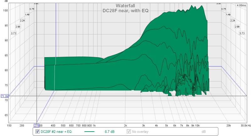

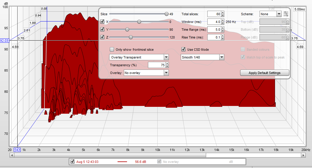

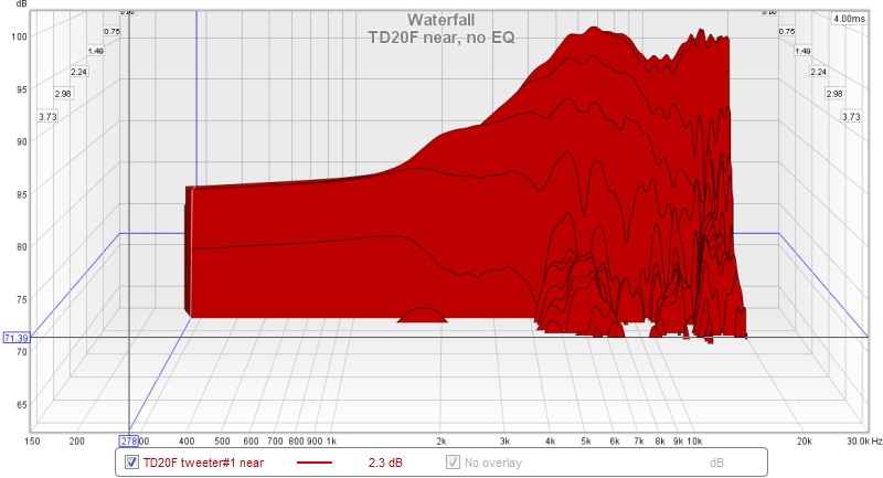

Hi Don, you need to use different settings. the defaults are for room modes. attached are the settings I use to try and get plots like stereophiles.
This was for a dms37 tweeter outside at 1M.
Only put in 25db range from the speaker measurement too.
Tony.
OK thanks Tony.
Here are the same graphs with your recommended settings. I'm still not sure what to make of them. I think I need to do more research.

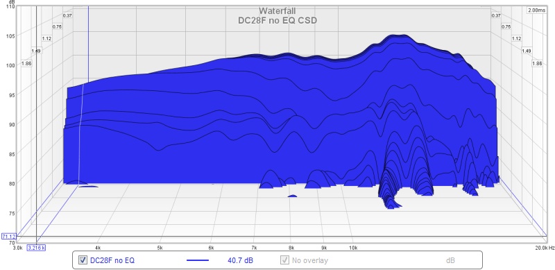

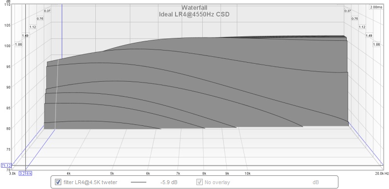

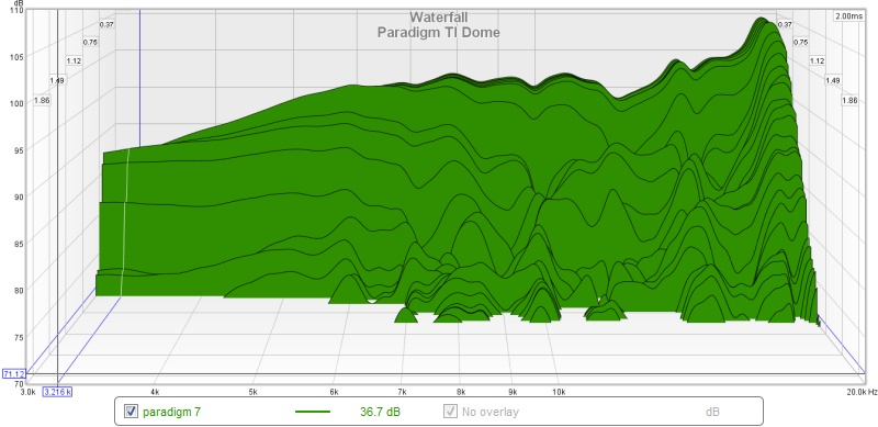

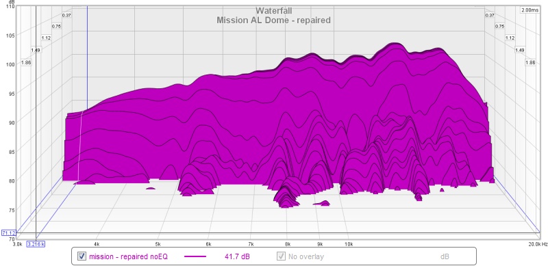

comparing CSDs
Thanks Tony for the link. I read all 3 parts and a bunch of other stuff and had a look at other tweeter CSDs. My settings are tweaked a bit more [Slices=60, Range=2ms, Window=5ms, Rise=0.2]. All graphs use the same settings and SPL.
I also included the results from a few more tweeters. The TD20 and DC28 look fine. I was surprised at the Paradigm titanium dome because I was expecting better and Mission aluminum dome (repaired) because I was expecting worse.
