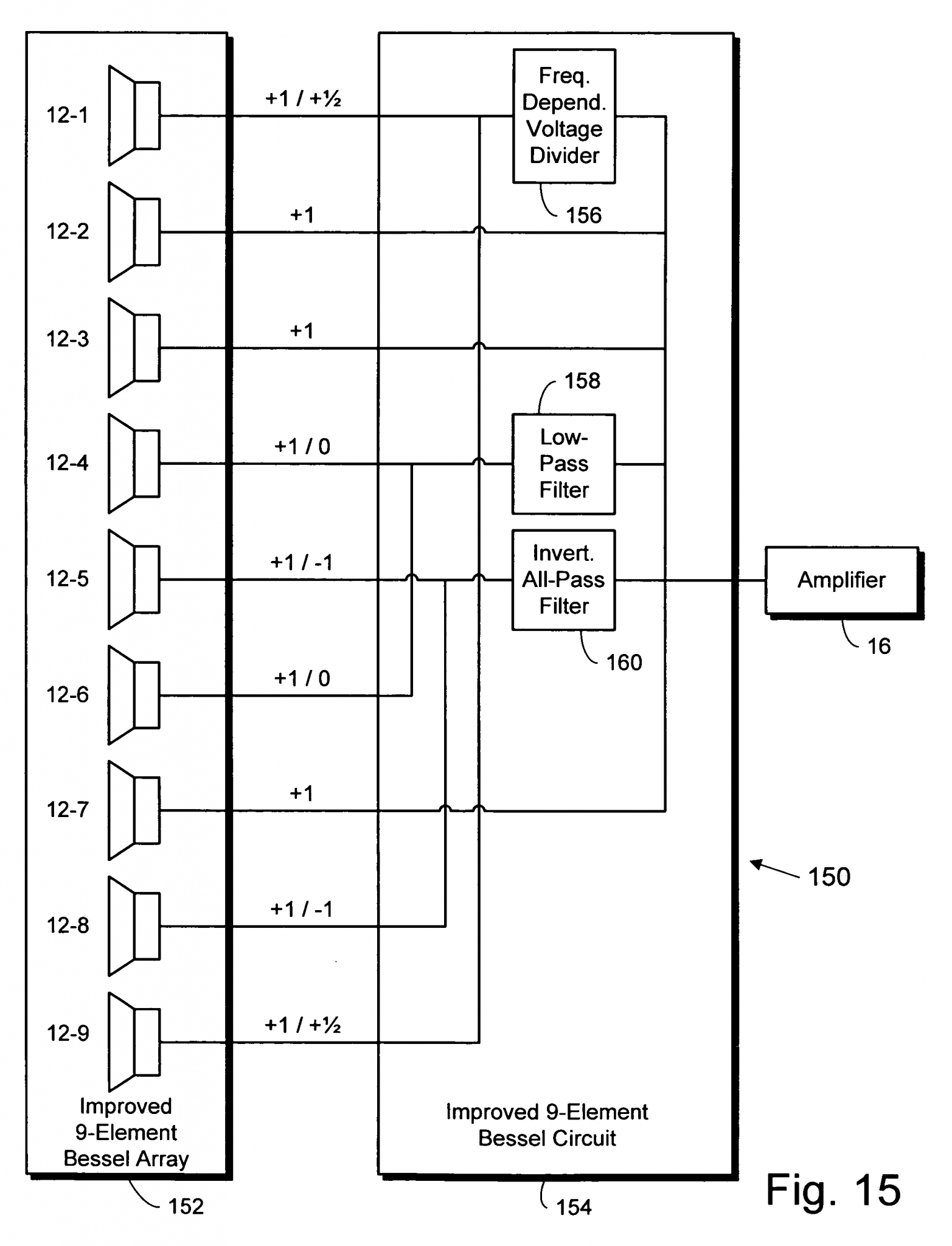

In the meantime I read something interesting about and "improved bessel array" (US Patente 20060159289A1) that can solve some off-axis issues. I know that you guys worked a lot on large line arrays so maybe you have never considered investigating this kind of solution because it does not make sense for floor-to-ceiling array.
Any thoughts about this? I can try a Vituixcad simulation to see how it performs.
Thanks,
Manuele
The Bessel array will perform as claimed, directivity wise. Its compromises have to do with dynamic range kind of things. Instead of all drivers working together, some are opposed and some aren't driven at full strength. which reduces maximum SPL. This is a stronger effect in a 5 element Bessel than in a 9 element. Its not that hard to make it Bessel only at mid to HF so as not to lose displacement at LF, e.g. just cross to a sub at the base of the array.
No harm in seeing what it does within Vituixcad. Indeed it doesn't have the same advantages as the regular array.
I know Patrick Bateman has simulated a few Bessel arrays a while back, do you have enough information about the
frequency dependent voltage divider and low-pass filter?
Do I see a division here in two parts? Left part (all +1) being bottom end and right part (Bessel) for top end? Is that
what it's supposed to tell us? That would explain the voltage divider and all-pass filter. Meaning 12.4 and 12.6 do
noting on the top end, 12.5 & 12.8 is inverted from a certain frequency and 12.1 and 12.9 are at half output on top end.

Took me a while staring at the picture what it should mean 😉. I didn't read the patent. That's when it hit me that theyWhat do you specifically mean with this sentence? With the improved array the lost in sensitivity is much less than a standard bessel array...The off-axis seems really good (at least from the Patent, haven't seen any other measurements of this kind of array).
combined a Bessel with an ordinary array. I didn't check yet how the wiring works to be honest. It does seem to have
a lot of parallel connections or they just left out the specifics in the diagram.
Curious to see the resulting vertical coverage. As the Bessel used to aim to get the same coverage of a single driver.
That wouldn't have my interest, as that's not what I want from an array.

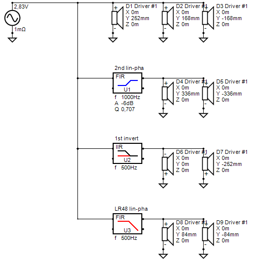

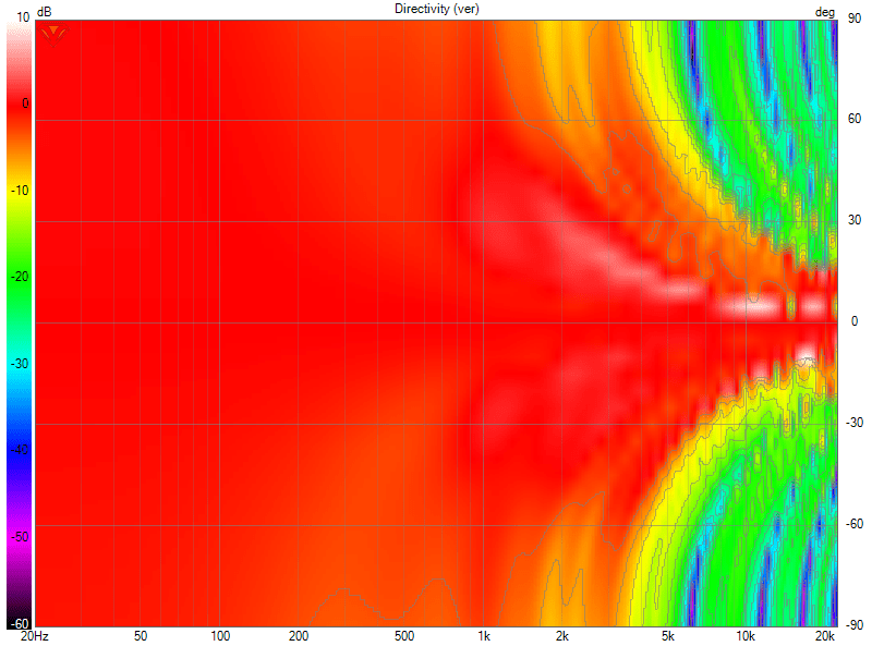

Ok ok, one very quick sim of a 9 driver Bessel (not improved)
Hope I didn't make a mistake somewhere but as predicted: not the kind of top end I would be looking for. (mimicking a single driver)

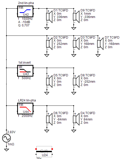

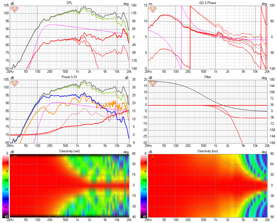

I tried to simulate the "improved bessel array" but, if the crossover schematic is not wrong, I don't see any advantages over previous simulations.
Very low impedance in this configuration (2.5 Ohm minimum). Crossover complication. Directivity worsened.
I think I made some big mistake =)
Manuele

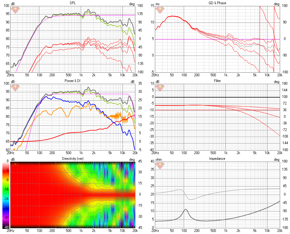

The vertical pattern is very narrow and constant from 2KHz and above. Does the improved bessel array give a narrow directivity? Is it by design?
No, a Bessel gives about the same coverage as a single driver, see post #86 which is a pure Bessel. The improved part is meant to connect all drivers

I don't think the (original) schematic is quite right, as that group of 3 will have a different impedance, which would not correspond to the +1 noted.
It's incomplete so to say.

Looking at the phase plot in your Vituixcad sample @Ethloas, it looks like the inversion you used is doing the exact opposite of what was planned.
I see two drivers that are out of phase at bass frequencies, Yet it is there that they all should be in phase. If you invert those two drivers, what does
that look like? I can see the drivers that are working at -10 dB and those that don't add (are crossed with LR24) above 2 KHz. But the inversion seems
to go wrong.I can't figure out why using 3 drivers in a group isn't visible as a different powered group in the filter graph, becaus these drivers can't
all be receiving equal power as the other groups of 3 drivers, right? (they are all in parallel, that's why)
I'd definitely try to invert D5 and D8 to see what happens.
The inversion is happening too slow to have any benefit. The point where we let the drivers change from 9x parallel to Bessel is showing a break in the pattern.
In short: I don't see much benefit for this at all, most certainly not the 9 drivers in parallel connection creating a very low impedance load for the amp.
I tried several crossover points for all filters but see no clean way out of this...

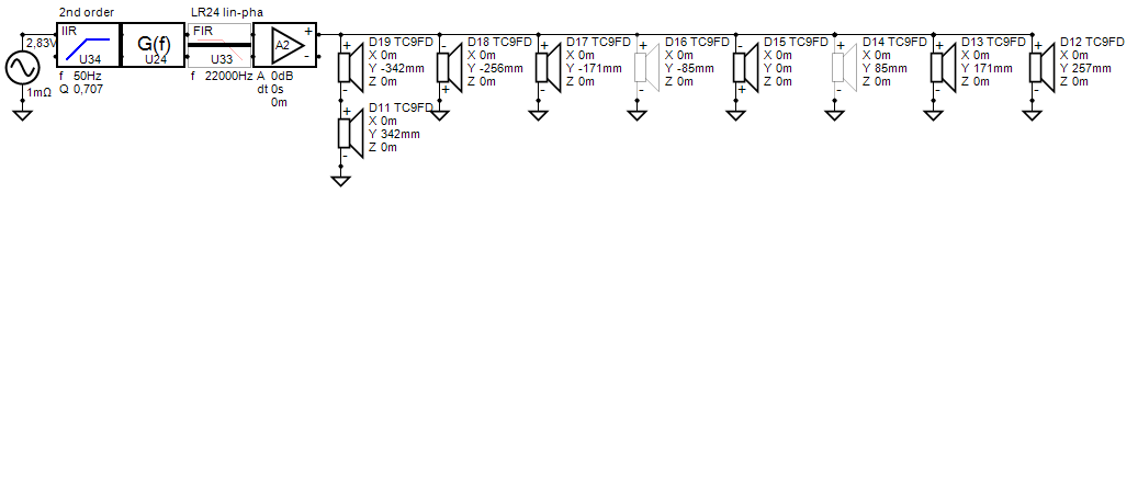

I played a little bit with some CBT-Straight-style simulations, trying to adopt the same approach of the JBL CBT 50/100 to see if the vertical coverage can improve.
According to this article published by Keele, to have a vertical coverage of at least 25 degrees, I need a "virtual" CBT of at least 39 degrees (64%), with a radius of curvature of about 1m. In order to increase the vertical coverage (-6dB SPL), a smaller radius shall be used.
Following the guidelines of the paper I calculated the delays for each driver pair (using the same numbering as in post # 87):
Actually, I have simulated the CBT-Straight style using the parameters of the crossover (ladder delay network) used in the JBL CBT 50, but this corresponds (according to the specifications published by JBL) in a vertical coverage of about +/- 10 degrees between 1.5 and 16 kHz. No attenuation of outer elements.
The vertical directivity seems a little bit cleaner, even if is still very small and with various dips from 2kHz to 20kHz...
Have any of you ever simulated a CBT with VituixCad? Did you find the same results published by JBL / Keele?
I'll post other "variants" for more vertical coverage asap.
Manuele

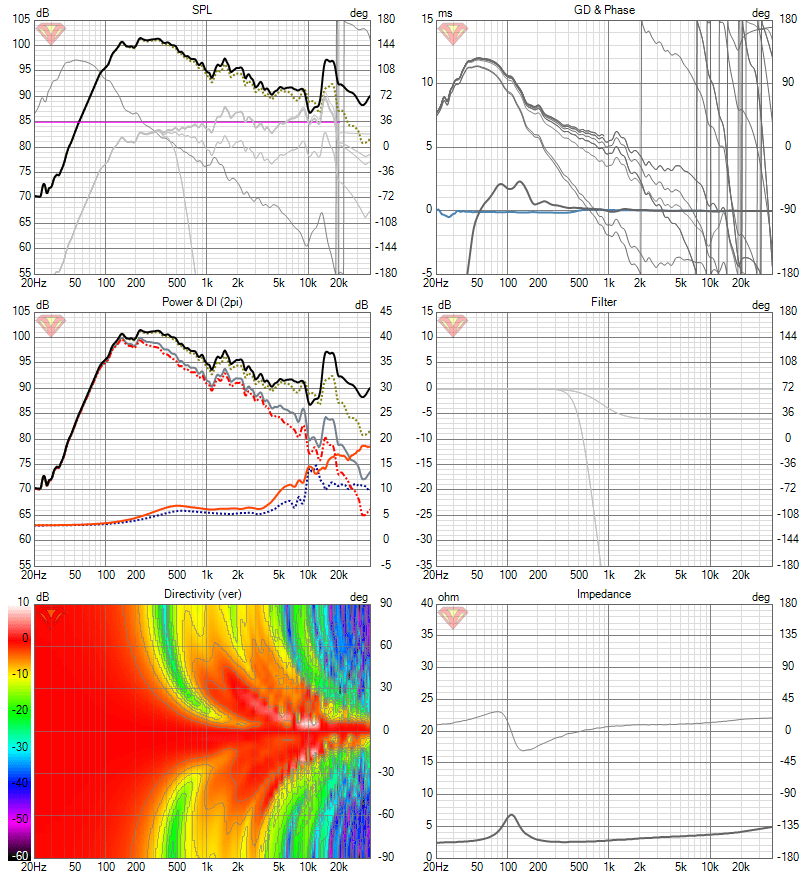

- Drivers D1 & D9: delay of 149uS (~ 51mm)
- Drivers D2 & D8: delay of 83uS (~ 28mm)
- Drivers D3 & D7: delay of 37uS (~ 12mm)
- Drivers D4 & D6: delay of 9uS (~ 3mm)
- Driver D5 (central): no delay.

I did not try short CBT array simulations. I wanted to see if their top end was better than the shaded array I had created.
So I simmed a big CBT with shading. I also simmed a focused array, all out of curiosity. I think it's still there somewhere
in my thread, I didn't even bother to save the models. It's top end wasn't any better than my proposed 25 driver straight
array with frequency shading. So that's all I needed to find out and where my interest in the CBT ended. It doesn't work
that well with 3.5" drivers for tall arrays. A true multi way CBT (small tweeter top end) would be a different animal.
Your result here looks fine, though do try all distances of interest to view the frequency curve and compare to the design
distance. Also check at the height(s) you need. I wanted good/acceptable output when standing and excellent when seated
for more than me alone (different length family members 😉). Also good coverage along my entire couch.
I've got what I wanted, the tonal balance is steady over a large area. large enough to have a pleasing outcome when
moving about and have excellent output in or along the sweet "area" (being the couch).
I've checked this extensively and compared to the unshaded array, which did quite well by itself over a large area once
you mask the parallel planes (damping panels at first reflections). Lived with that setup for years and the frequency
shaded array should be an improvement over the unshaded array on all counts. I can confirm that even without proper
dial in (this has yet to be done). I can tell the difference in sound which is difficult to put into words. I'll wait till I've
done all of my processing to really try and name the differences. I have renovated my room and have a different ceiling,
things like that matter too. So the sound was bound to be different even if I didn't add all those filters. Less "live room"
sound is all I want to say right now.
