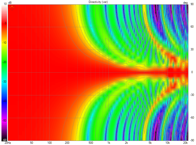

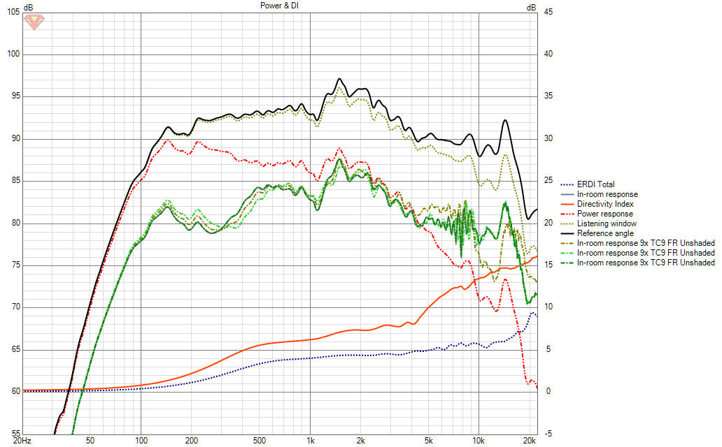

I think the results look pretty normal and comply with the sims. Which would make me rethink running these
arrays without any filter.
I think the 'needle like' directivity we get at 3.5 meter really is not that useful...
Unless all the people in the household are exactly the same length 😀.

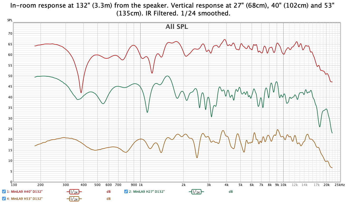

Even though, checking plus/minus 10 cm looks kind of ok-ish (within +/- 1 dB up to 10 K):
These are the responses at 3.3m at various heights. In-room.
The results look quite independent from the listening heights, don't they?
I think I'll try them with a simple 3x3 series parallel connection...

I don't think they track each other all that well, but then again... that's a pretty wide margin to check, I think about 20 cm above and below the center of the array would be the listening window that tracks best (according to the sim). Try to smooth these plots with the Psy smoothing and put them on top of each other to compare. If they deviate over a larger area than it could be quite audible. if they continue to meet each other in the middle while deviating a bit up and down, that's way less audible.These are the responses at 3.3m at various heights. In-room.

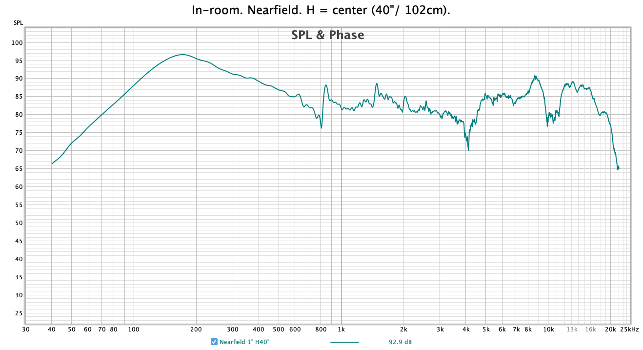

Basically the worst spot to measure an array like this. This is where there are the largest differences between the drivers, thus you'll see dips and peaks.This is the response.
The weird peaks and dips are still there...
Any idea?

At several frequencies the drivers will be out of phase from each other.
But... stuffing the cabs can help cure the dips/peaks that come from within (internal reflections) and they can largely be avoided. Check the impedance 😉.
I agree @wesayso .
My array should be listened at least 4/5 times its length for better results. I measured the nearfield because @TNT asked and also for my curiosity 🙂
I'll try to re-measure in +/- 20 cm range around the array center and plot the results.I don't think they track each other all that well, but then again... that's a pretty wide margin to check, I think about 20 cm above and below the center of the array would be the listening window that tracks best (according to the sim). Try to smooth these plots with the Psy smoothing and put them on top of each other to compare. If they deviate over a larger area than it could be quite audible. if they continue to meet each other in the middle while deviating a bit up and down, that's way less audible.
I apologize for the confusion.Was it really near field? How close? The picture said 102 cm...
The measurement was taken 1 inch away from the center driver.
The height of the microphone is 102 cm from the floor which corresponds to the center of the mini array.

Et voila' 😉.I'll try to re-measure in +/- 20 cm range around the array center and plot the results.

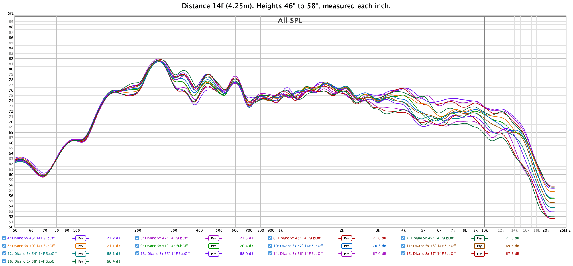

I measured the vertical response at 4.25m (14f) at different heights, from 46" to 58" every inch (2.5cm).
For space problems I cannot measure below 46 "or above 58".
I have already measured the horizontal response for the whole listening position (more than 2m) and there are no significant variations, so I decided to measure the vertical response at one position only.
Quite tiring to do, but I think I got some important information.
The maximum gap is around 5 dB between the highest and lowest (12" of vertical response).
Manuele
I do see some perceived tonal differences in these graphs. Up to 3 KHZ things look fine but a deviation over such a large part of the frequency spectrum (3K +).
The lower top end would be darker in timbre and I bet it isn't hard to perceive.

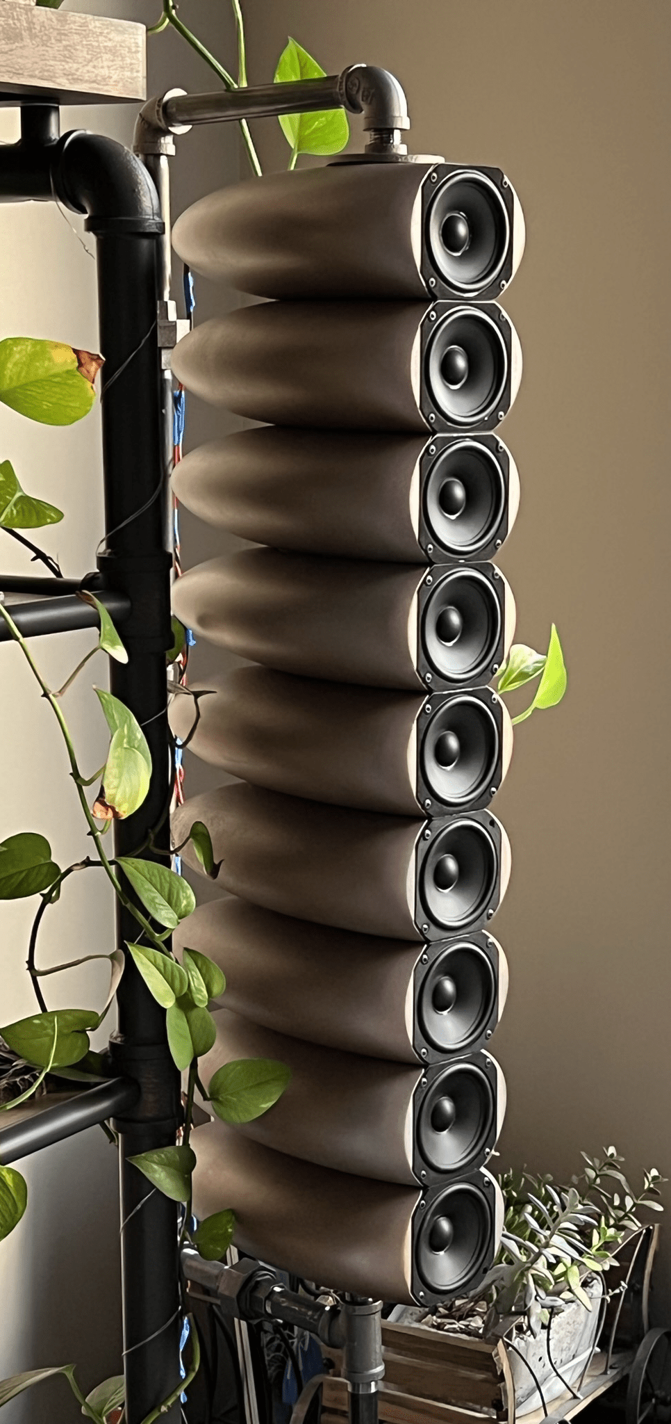

Back from vacation a little while ago!
Just a photo of the completed "9 Cells Pipe Array" in place.
At the moment I must say that both my wife and I are quite satisfied with both the aesthetic result (the one that interested my wife most 😉) and acoustic.
Soon I'll take as many measures as possible to understand how and where I can intervene to improve the polar response.

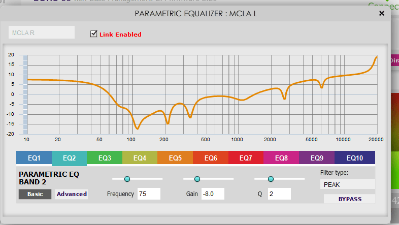

For playing, I like the minidsp products. The 2x4HD is on their lower end of the budget, can take optical or usb in, then 4x analog out. If you like your DAC or want to play with DACs (like me) then its a bit harder. But that would let you optimize each line array, and add a sub or two if you want.play a bit with DSP
For my full range line array, the mindsp software looks like this:
There are upgraded units that can add Dirac on top of manual PEQ, Dirac was a big sound quality improvement I felt.
Eventually I will go the @wesayso route and do convolution based EQ in a HTPC. Minidsp was a great starting point, but I am ready to graduate. The good news is, there are a lot of free options for computer based DSP, that could compete or beat Dirac in sound quality (I feel).
